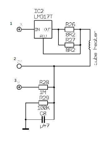

Thanks for your help.
My intention, atm is to learn the schematic capture software and how and why this implementation is held in such high regard, and at a later stage to try and build it. I have no equipment or funds to do this any justice atm. And if I wanted to build this in a hurry I would just use the French PCB and modify it to get closer to Allen's recommendation.
So just looking for the how and why.
I'm going to try and get the book I think.

IC2 is CCS for heaters , giving I=1V25/(8R2||8R2)=304mA
good for PCC88 (7DJ8)
for ECC88(6DJ8) recalculate R26,R27 for approx. I=365mA , having in mind to achieve 6V3 across hot heater
elevated from ground on potential (node 3 ) of Ub x (R29\R28)
R26,R27 need to be at least 1/2W each , other two plain 1/4W ones
