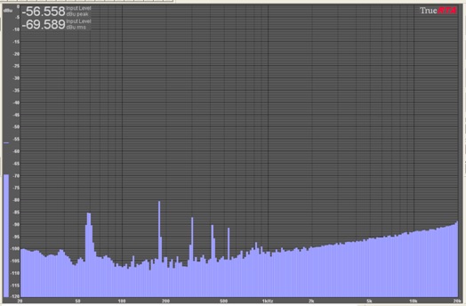

Here is mine attached. The strange thing is there are almost the same amplitude harmonics at 120,180 and 240 Hz. I found in one post a statement that 6DJ8 is famous for those harmonics, and the next reply was it is not true. I was hopping there is a possibility to theoretically identify the reason for that, or a part of schematics responsible.

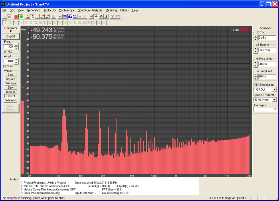

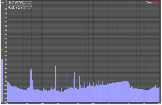

Just wanted to report some results.
First, thank you all for input and good advises.
Today I tried a few fixes. First, I tested heater schematics. That was a direct hit. Even with simple connection of heater ground with common circuit ground via 0.22 uF capacitor lowered main 60 Hz harmonic by more than 10 dB, and totally removed 120 and 240 Hz harmonics (picture 1, compare to the spectrum in the post #427). Maybe applying +40 V would lower it even more, but I did not try it yet.
Then I tried a new (better) set of tubes I bought recently on ebay. It gave me additional 4 dB (picture 2). Finally, I tried to put screens in different places. Screen on the tube itself did not work, but screen over power transformer lowered hum by another 1 - 2 dB (picture 3).
That would be it for now.
I think I have an answer to my original question. With totally disconnected (floated) heater two different tubes even with identical gain measurement would produce different hum level due to the different physical position of the heater in relation to cathode inside of each tube.

nice but please
make a elevated voltage, not to stress the heater cathode isolation and to block the micro diode between heater and cathode, 30-40V is fine with a voltage divider from filtered B+ and some capacitance.
the differences you see is due to different constuction and tolerances of tubes
