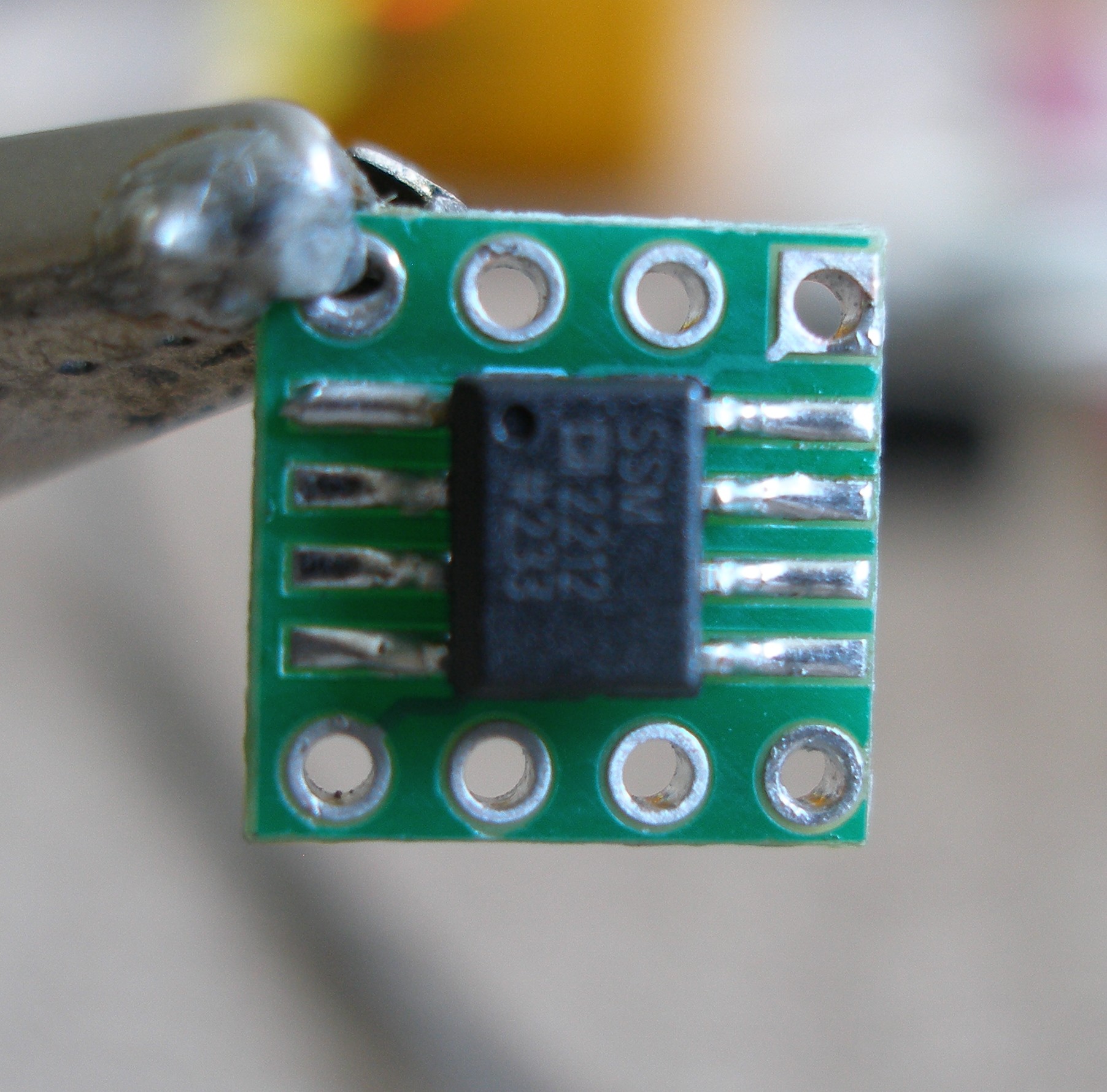

Hi Alex.
Finally got the phono boards sorted! I replaced the 2SK170BL's with the SSM2212's from Farnell and, taking your advice, changed the current source resistors to 500 ohm pots. I'd originally had 330 ohm resistors in there, as per the schematic, which I'd later paralleled to 165 ohm to get more gain, without success! I have had to take the pots down to 50 ohms to get sufficient gain, around 40db, for my MM cartridge. This resistance does seem a little low for that gain but the tubes may be tired. I'll try a few different ones now it's working. Incidentally, I don't think this was the cause of the original problem as I'd tried it shorted and still didn't get the gain I needed. What resistance have you got in there?
Also replaced 330 ohm grid stoppers with 1K0's and placed 330pf caps across the input as recommended by Allen.
I also discovered that I'd had a moment of madness and put in 2 x 47K resistors at the input so I've corrected this and put in a pair of 24K9's instead. (close enough for now for the 47K0 cartridge load) The layout is more logical now with shorter paths from input to SSM2212/tubes, and I've tweaked current and pots to get 65 volts at the anodes. The voltages were slightly unbalanced before and were up around 72 volts.
All in all it's sounding good but I'll leave it to burn in a while before I try the AD797 swap in the regulators.
Having problems attaching pics to this post so I'll try later.
Regards, Dean

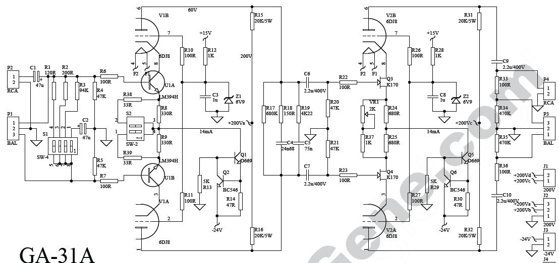

Hi VTR,
thank you for your response. Maybe you can give more specific advise using schematics attached?
That is a printed board already grounded in one point only, heaters are DC, voltages are fine.
Key feature is it is a low hum with equal spectrum at 60, 180 and 240Hz that is changing as I replace a bulb.

schematic looks fine
i would not use all the cartridge loading stuff, btw 47uf looks too much usually its pf...
is your dc heater voltage elevated? (should be 30V above ground) with a well filtered voltage divider and then test each stage alone where the humn coms from, chassis is grounded as well?

Here is the only one suspicious for me part of schematics. If you look into second stage, you can see that both cathode resistors R24 and R25 are bypassed by one trimmer VR1. Could it be a place that created some sort of positive feed back? Or that is totally stupid suggestion of mine? I can add additional trimmer in parallel to R25, and have original connected in parallel to R24, so each half of the tube would be regulated independent.
As for the input:
I am using right now for testing 5mv MM cartridge, but have a plan to make a fully adjustable from the front load selector from 10 ohm to 96 kohm for both balanced and SE inputs.

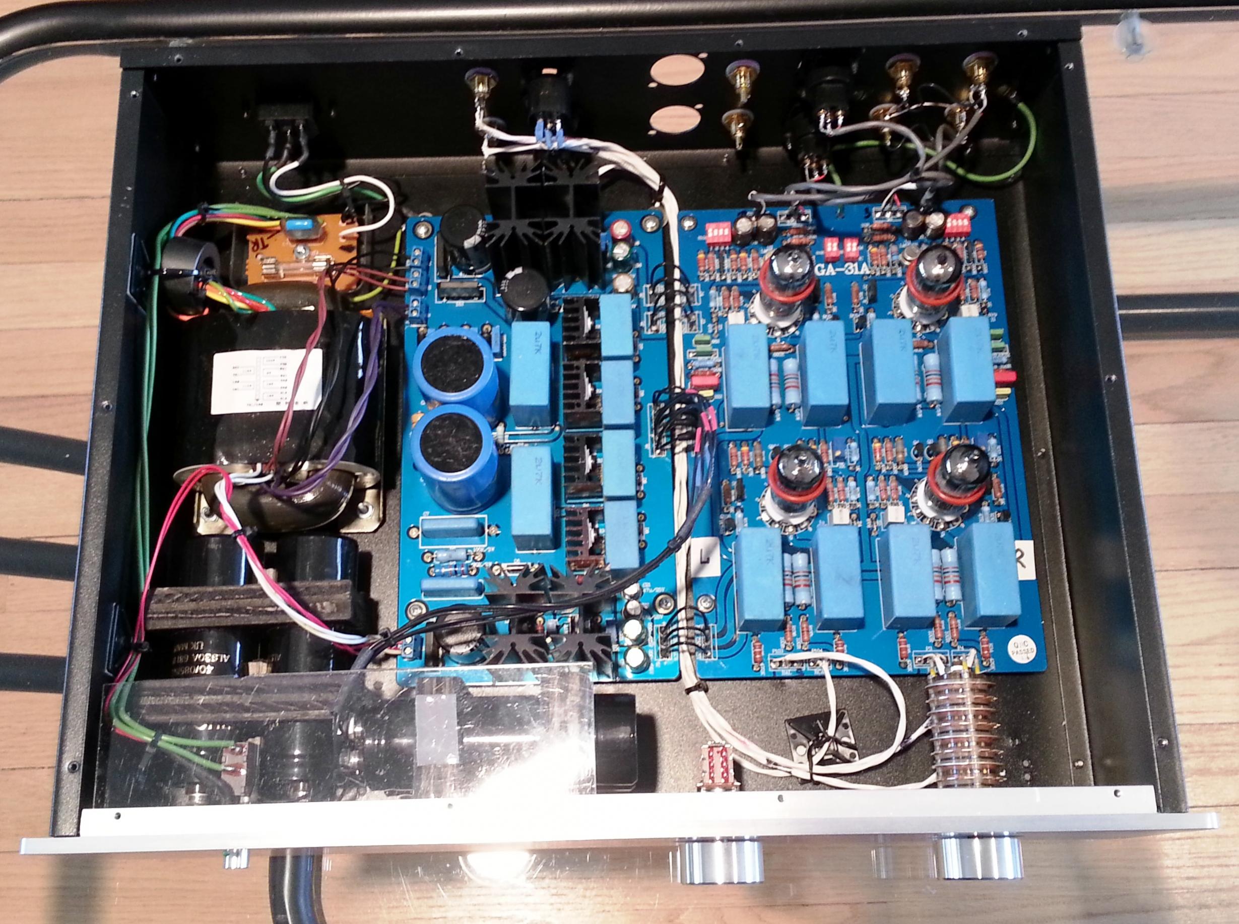

Thank you all for comments and recommendations.
I will try some this weekend. First, rise the heater, then adjust grid voltages to match anode voltages, try variations of grounding, shield tubes, etc. Plus, I have ordered four new (from ebay, I know) tubes claimed to be good to see if there is difference.
Input schematics is fine. I can use switch SW4 in the balanced position, and the cartridge would be connected to the + and - of differential stage directly. Order does not matter b/c I am going to have a polarity switch for the input.
I use 100W R-Core Transformer from the same Lite Audio. Looks like a well made. See picture attached.

VR1 looks to me as if it's used to balance the second stage. It doesn't seem to have enough adjustment to alter the gain much but I'll stand corrected on that. Have you checked anode voltages as you tweak VR1?
On the first stage, am I correct in thinking that the switch SW-2 is for setting up the input for either MM or MC? Just a thought, but could you replace either R8 or R9 with a 500ro pot to balance up the stage and see if the noise level drops?
I'm running PCC88 tubes in mine at around 6.5 volts so they are not overly hot.(heaters have adjustable current sources so it's easy to swap tube types) Even so I'd be a little concerned about wrapping foil around my tubes, other than for experimental purposes, due to potential heat issues. I bow to superior knowledge on this one though! To be fair I have used tube sockets with screening cans on other gear without problems but they were designed for them. Just thought it worth a mention!
