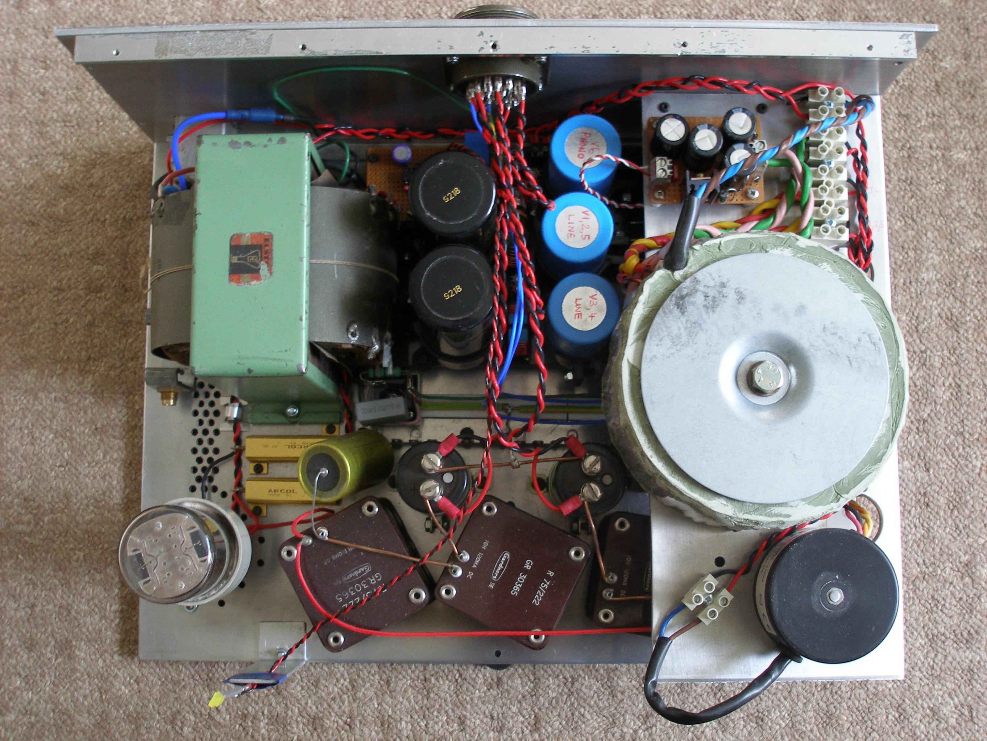

I'm a bit strapped for space in the PSU (I'll post a piccy of the completed PSU when I get time tomorrow) but I could probably get a couple of largish caps in there before the regulators. They would be lower capacitance though so ripple would go up and it may lead to some ringing, I'd have to check PSUD2. I have used motor run caps in other gear, my power amps use ASC's from Percy Audio. The Obbligato Film Oil Caps from DIYHIFI supply look OK and are the right price but I haven't tried them. They do get some good reviews though.
As for recapping the SuperRegs, they're onboard the amp chassis so space really is at a premium. Changing the LF351 op amp on the shunt to an AD797 and getting rid of the LM317T for a fixed resistor would possibly make more of difference and wouldn't need any more space. The 797's are waiting in my parts box but I just wanted to get everything else working right first!
Priority at the moment however is to get the phono board working. I'll be taking Alex M's advice and popping in a couple of BJT's to see if that makes a difference and checking some measurements. I had a quick look at it yesterday and one half of one of the valves was misbehaving so that's a start. I need to order a couple of AD SSM2212RZ's from Farnells because if I've got to take the boards out I may as well ditch the 2SK170's. Anyone else used these dual NPN, low noise, chips?
BTW Happy New Year everyone!!!
but-its not expensive, go for motorstartcaps in surplus market, upgrading my superregs from elkos to mundorf mkp (standard one) was a major improvement
and you have the space for caps in your power supply
Hi VTR.
Not too much space left!! I'll check sizes of other caps though and see what will go in. Like you say, it would be better to ditch the electrolytics.
Just in case anyone else is thinking I'd had a drink when I fitted the chokes, because they are close together they interact with each other so, with power applied, I measured the ripple and re-orientated them to get the lowest measurement. Not as neat but made quite a difference. I've found neat doesn't always make for better results!

Hi RTP3D builders,
I am currently starting with the planning for building and RTP3D. I red the thread, browsed the net and haven't found information about the Power Supply, but there are still a lot of unclear parts for me.
Therefore I like to ask following questions:
- I saw on the schematic a LL1628 Choke, but on some picture a LL1685.
I asked Lundahl about that, but they don't know anything about the LL1628. Some thoughts?
- Heater Choke (6mH/12mH)
I can't figure out which brand to use. Anyone any hints?
- Trafo for TR2 (100VA/420V)
Seems on the pictures like it is the same brand as the heater choke. But I can't figure out what it is
Any hints or ideas would be very welcome!
Many thanks, Tom
Hello, Tom.
I can confirm that the schematic does list the B+ choke as being LL1628, but it is definitely an LL1685, a 10H, 160mA common-mode choke.
The choke for the heaters that is no longer made by FG Elektronik was a double choke: the 6mH and 12mH windings were wound on a common core.
The label on the choke reads as follows:
TRV65/BV 3503
gn-bn=12mH 1,4A
sw-rt=6mH 2,8A
This choke buzzed very loudly and I had to abandon one of the windings. I substituted the 6mH, 2,8A winding with a Lundahl LL1694/2A choke (with the windings connected in parallel).
The 100VA/420V traffo was made by FG Elektronik. It is a double C-core.
