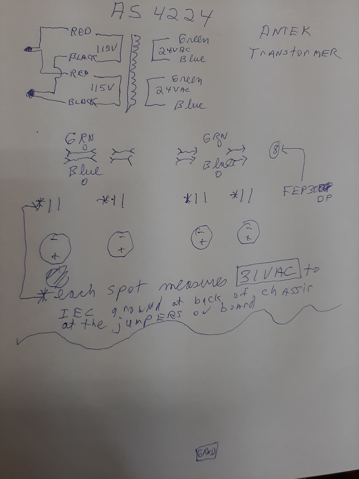

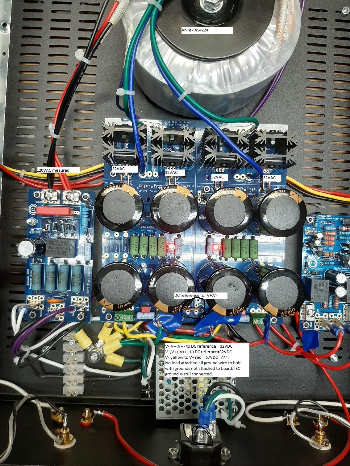

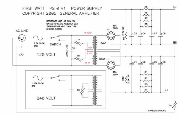

A question or two on what voltages I should be reading mainly at the 24VDC end of the power supply board. Attached is picture and some values. When I read 67VDC from 24+ across to 24- did not think I wanted to hook up the aleph j boards. If I hook up the two aleph j boards will that make the DC voltage correct? As it is with yellow wire -24VDC to red wire +24VDC I would have the measured 67~VDC to the boards and would be fried.Yes don't look at the soft start resistors as they came that way. (cough cough) Thanks for any input.

Measure from positive to ground and then negative to ground.
Also, you can expect some voltage drop with load.
For what reason did you purchase a 24VAC transformer?

I will do that. Maybe I purchased wrong transformer. I thought it was 24VAC secondaries was required. Will look at BOM again. See attached schematic with +24
You get somewhere around input voltage times 1.4 after rectification. Most people are using 18V - 20V secondaries on their transformers for FW amps.
Thanks for the information although with the schematic of the aleph j showing 24 volts it would seem most would use what is called out in the schematic. Anyway will look into it and thanks again.
Yes this schematic shows a transformer with secondary18vac output. This schematic then would not apply to aleph j schematic boards seeking a 24 volt use. Do all pass power supplies ask for 18 volt secondaries for all of the boards? If so I stand corrected. thanks over and out.Take a closer look at the voltage of the transformer secondaries on this schematic.
The Aleph J schematic shows +24V and -24V. They are DC voltages. The transformer secondaries output 18VAC which is converted by the power supply to approximately 24VDC.
