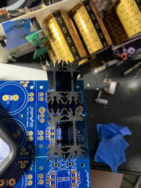

Im starting to build an Aleph Jzm with the universal power supply pcb. Ive had thsese Ohmite heatsinks in my parts bin for years As you can tell by the picture, their is a paper thin gap between the heatsinks. Probaby a no-go???? what say you experts
Can anyone recommend a proper sized heat sink as the BOM reccomended ones are out of stock
