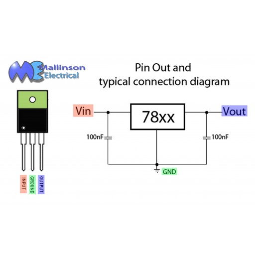

The circuit with 7812 is incredibly simple, just a small cap (value not very critical) on each side of the regulator. If you get one in TO-220FP (the plastic insulated version) you can just attach to the chassis floor for heatsinking. The caps and wires can be attached directly to the pins.
