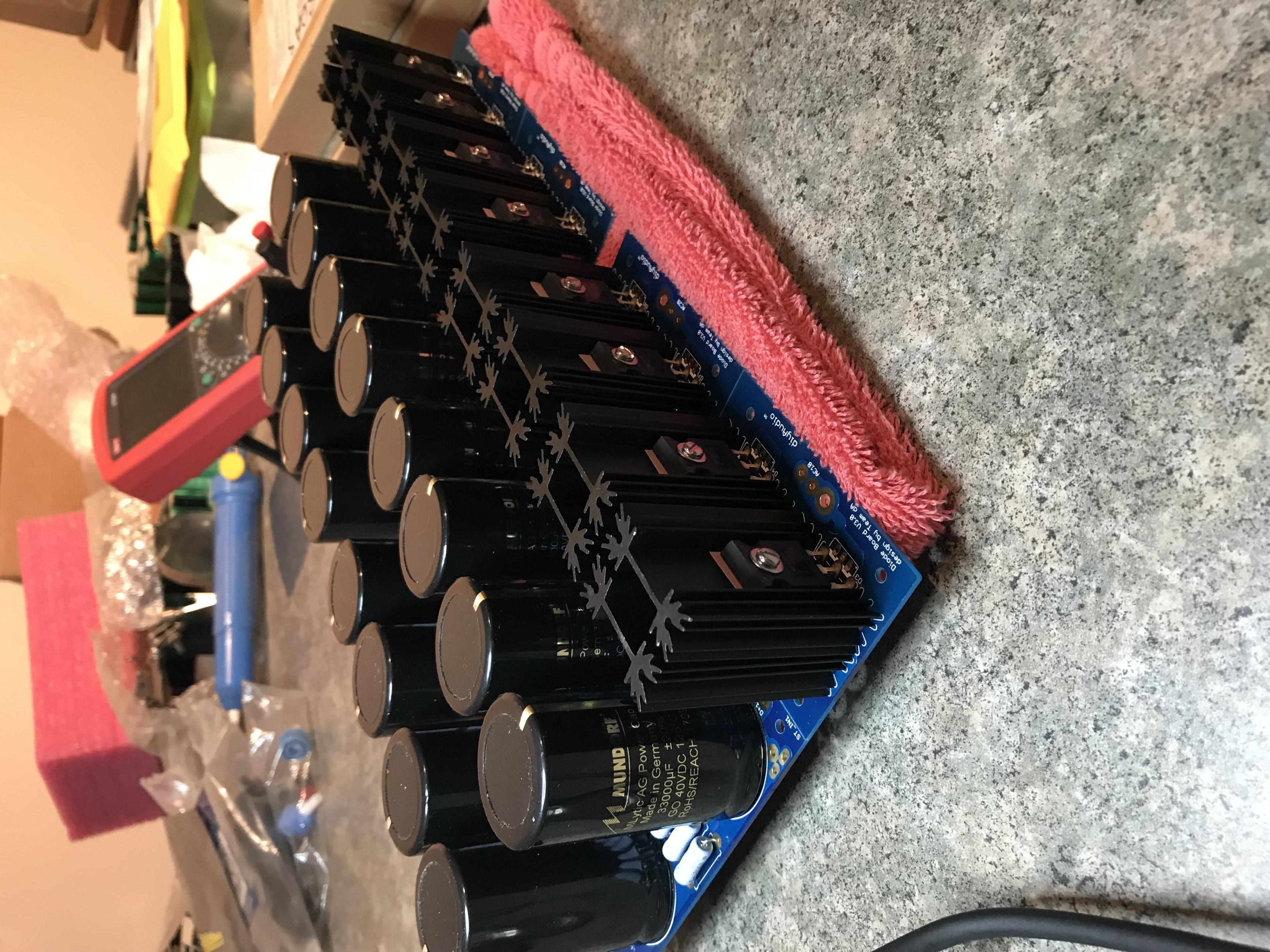

I am almost ready to solder up my PS boards for the F5 Turbo. I want to make sure I am doing things correctly. I am building a full dual mono stereo amp in a Deluxe 5U chassis.
I have two 1000VA 24v secondary Plitron transformers. I have two universal PS boards with 16 Mundorf caps along with a set of DIY speaker protect/soft start for each channel. Do I fully populate both PS boards(all resistors) including all of the the rectifier boards? The idea being one Universal PS board per channel.
Any advice would be greatly appreciated as I want to do this correct the first time out.
Wire up your transformer first.
Power it up via a Mains Bulb Tester (MBT). Check the voltages are correct.
Then add on the bridge rectifier. Power up via MBT. Check voltages.
Add on the Smoothing Capacitors. Power up via MBT. Check voltages.
Once you have capacitors fitted you must discharge them (every time) using a resistor after testing.
Add on one channel of amplifier. Check that the VR are set to draw minimum output current. Power on via MBT. Check voltages.

Power supplies for both channels are now completed. Thanks for the advice.
Todd

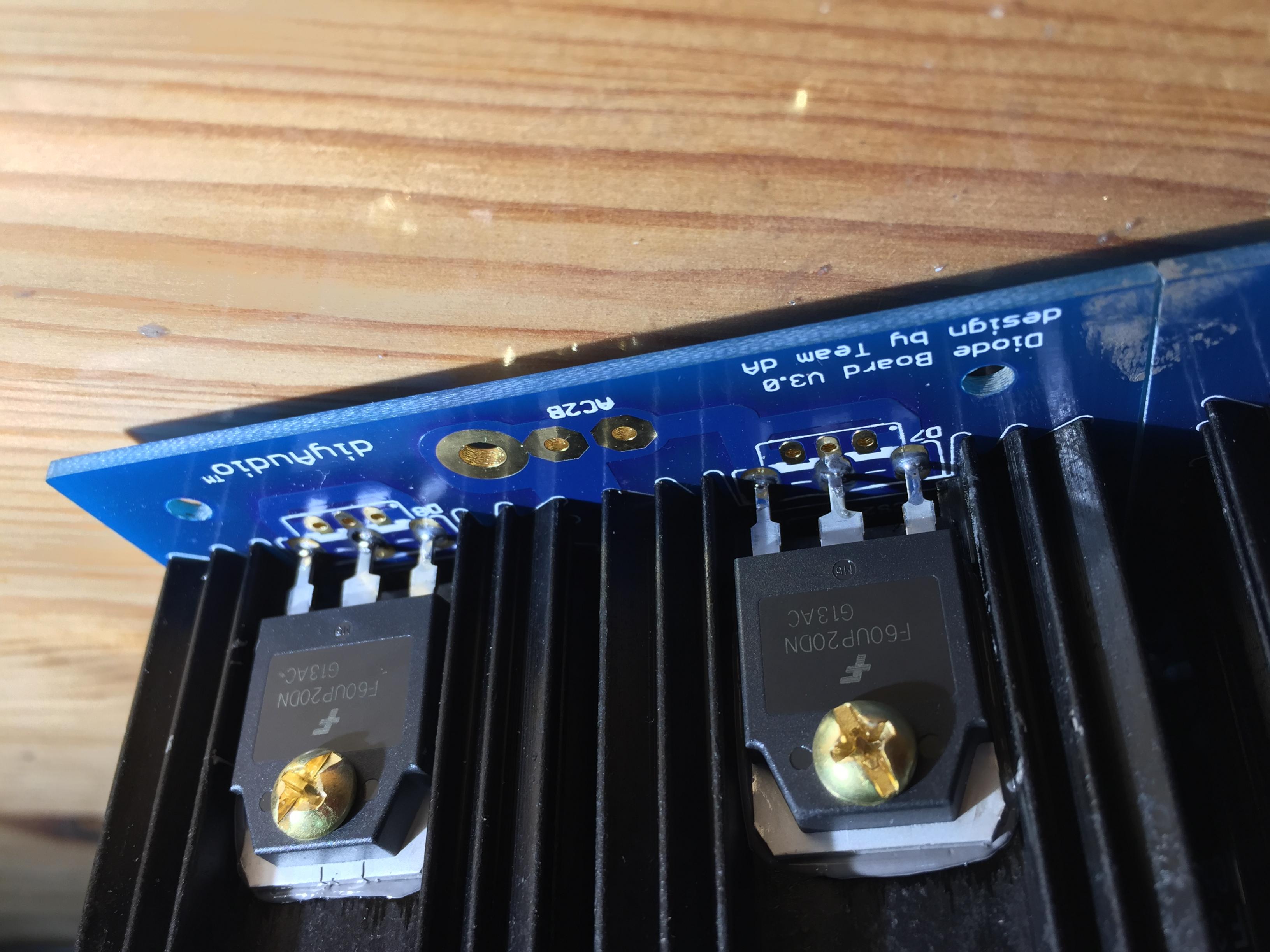

No voltage output forgot the cut Center 3rd leg of diode
18 V in 0 V out also noticed drop resistor for LED runs burning hot was smoking a little.
I think I noticed my mistake my diode package was the T03, I was getting carried away with soldering looking back at the photos illustration guide I noticed on the TO220 package diode’s the center leg was cut off on my board I left the center leg on my diode’s is this my problem ?.
Taking voltage out readings at AC 1A and AC 1B
