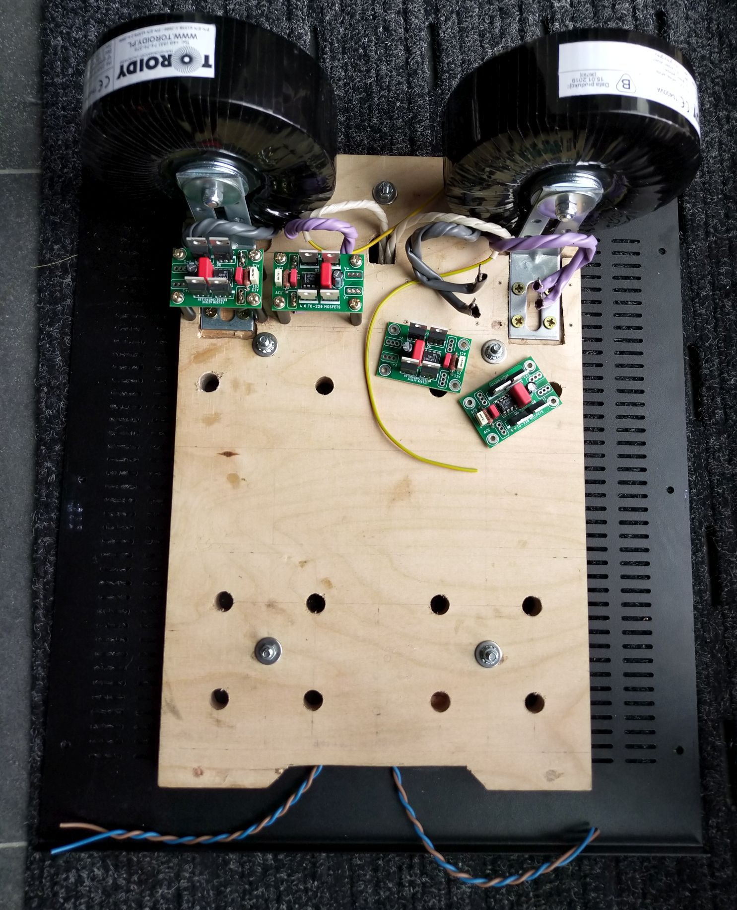

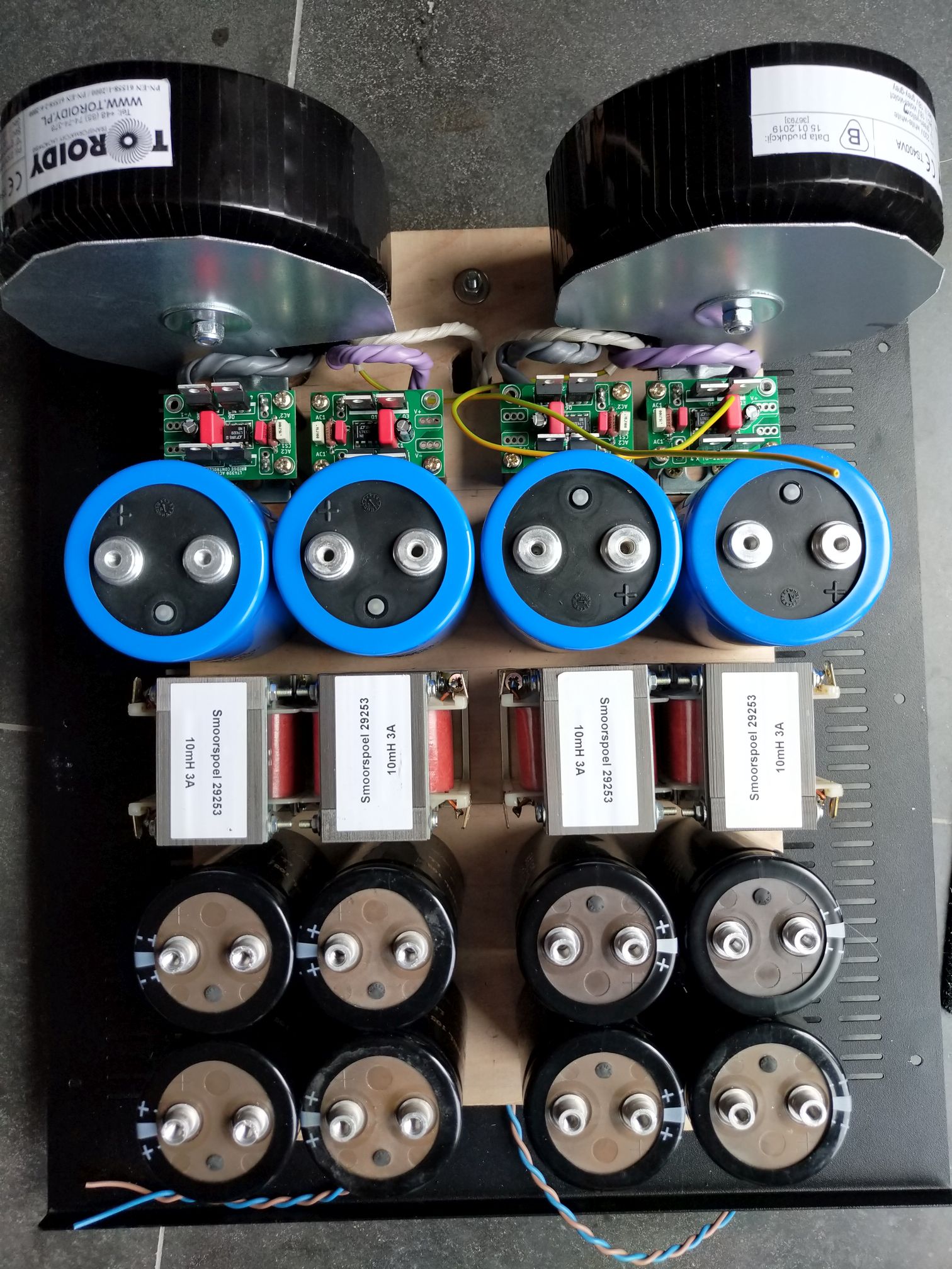

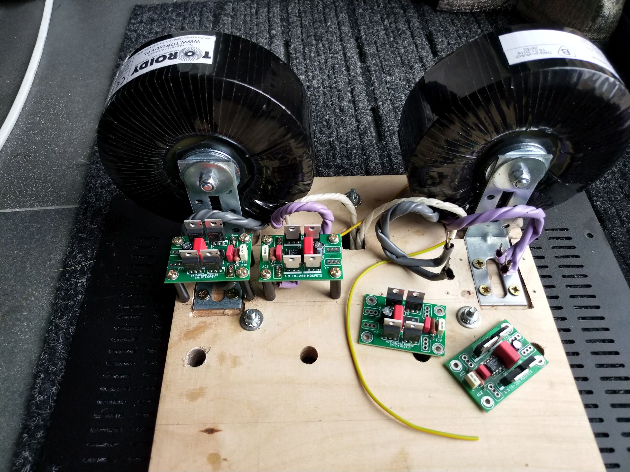

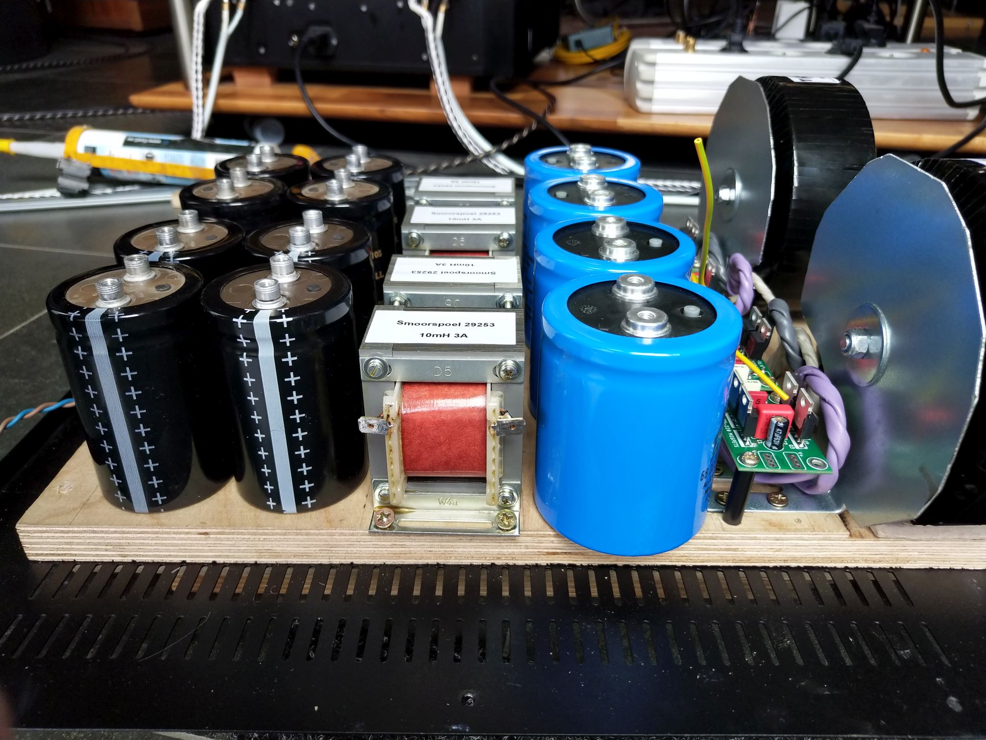

I finally started with the build of the USSA-3 🙂
The PCB is almost all populated, now building the power supply,
putting all the PS stuff on the bottom plate,
AC mains is routed beneath in a metal tube.

Hi Danny_66
Better late than never😉
I am glad some peoples try out other versions than the USSA-5.0.
Is it original version 3 or 3.1 or 3B?
So you are using an “ideal “bridge for your PSU with well regarded Toroidy transformers. This is a good start. 🙂
For the amplifier pcbs do not hesitate to ask for questions - if any.
Thanks for sharing.
Fab
Hi Fab,
Yes, fine tuning my speakers took some more time than expected, as always 🙄
It is the original 3, since I already have the input jfets and mosfet drivers.
I have the USSA-3.3 2018-06-25 manual rev 0.6p, is this still valid ?
An "ideal bridge" is really a free lunch, no voltage drop (so no heating) and no switching noise.
Really ideal for class-A low voltage, high current.
Now everything PS related is screwed in, next is the wiring.
Danny

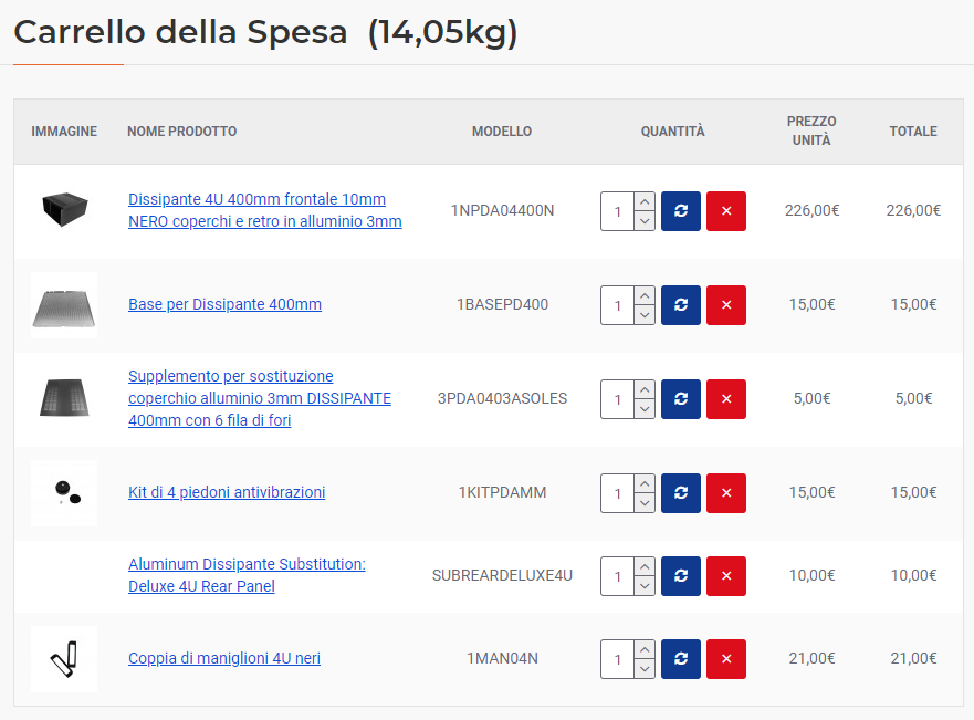

Finally I started to do some soldering on the USSA-5 pcbs - I follow the instruction from the very good manual of Fab and get some outstanding support from a very nice diyaudio member via e-mail and skype. 🙂
I've to say that this is my first amp project.
Ordered the chassis directly from modushop - as I'm doing dual mono with two SLB psu so I need some space... there is a summer sale at modushop for a week - fyi!
