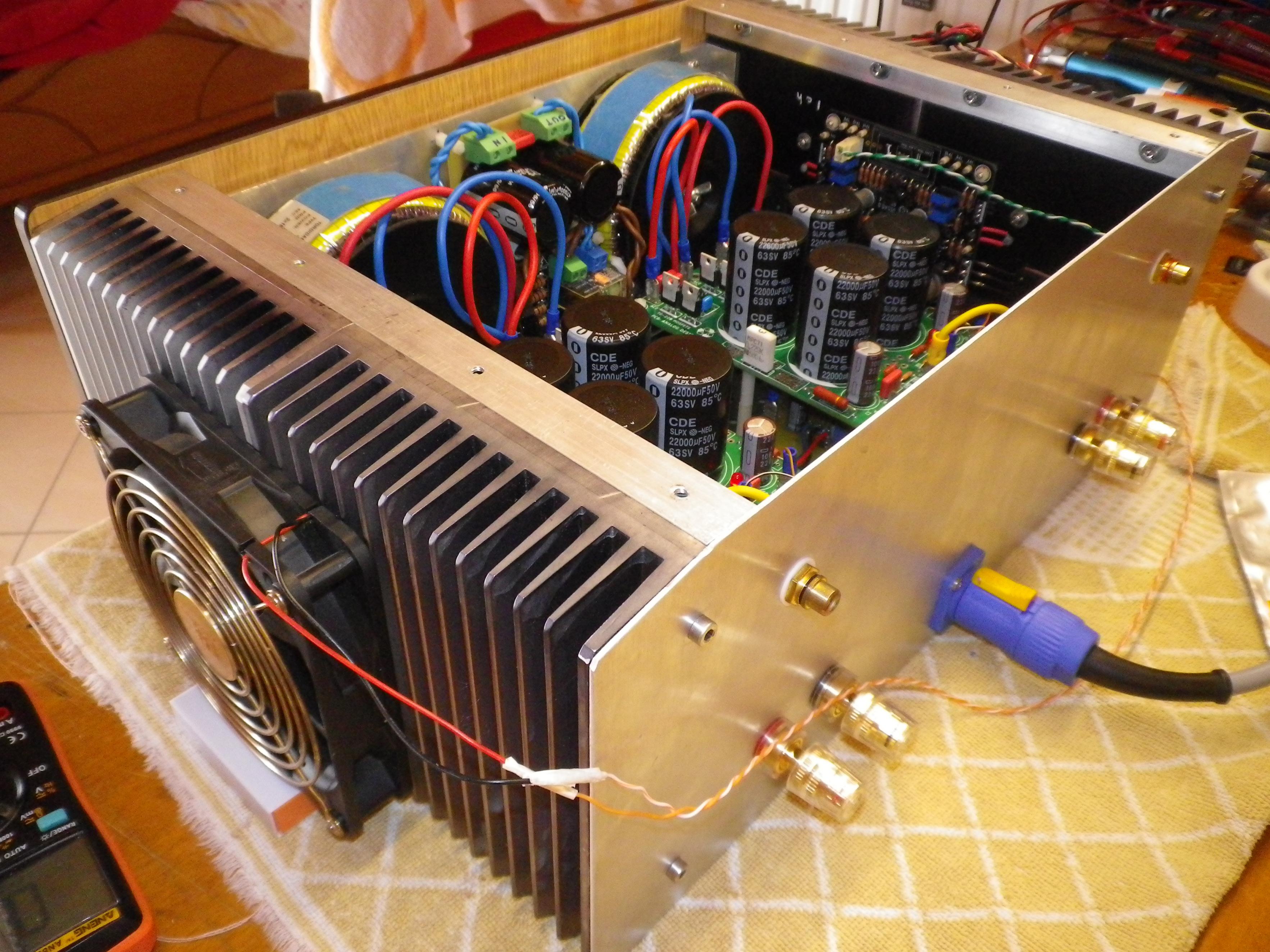

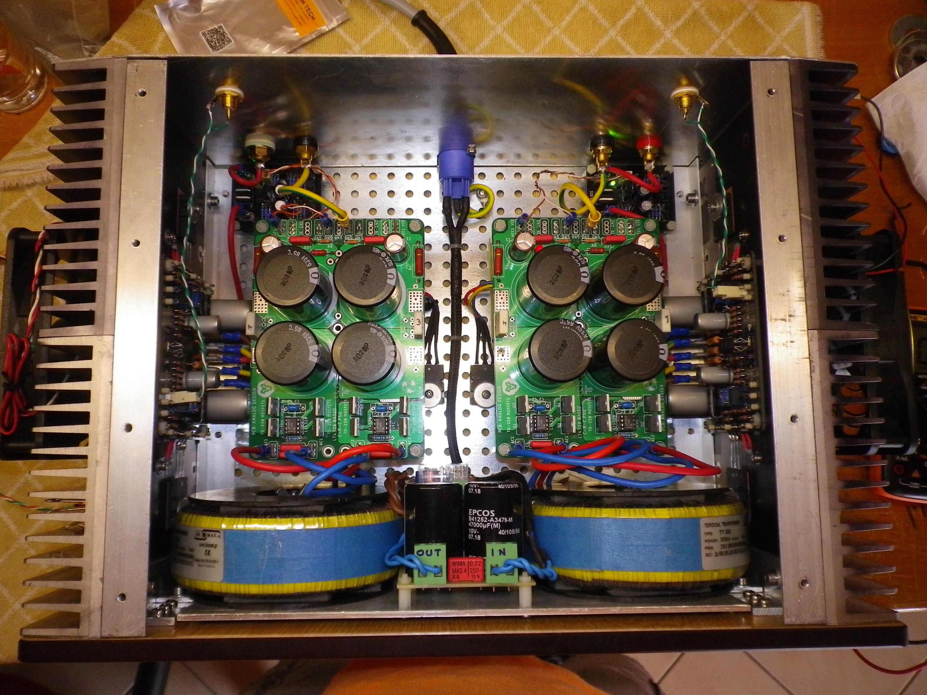

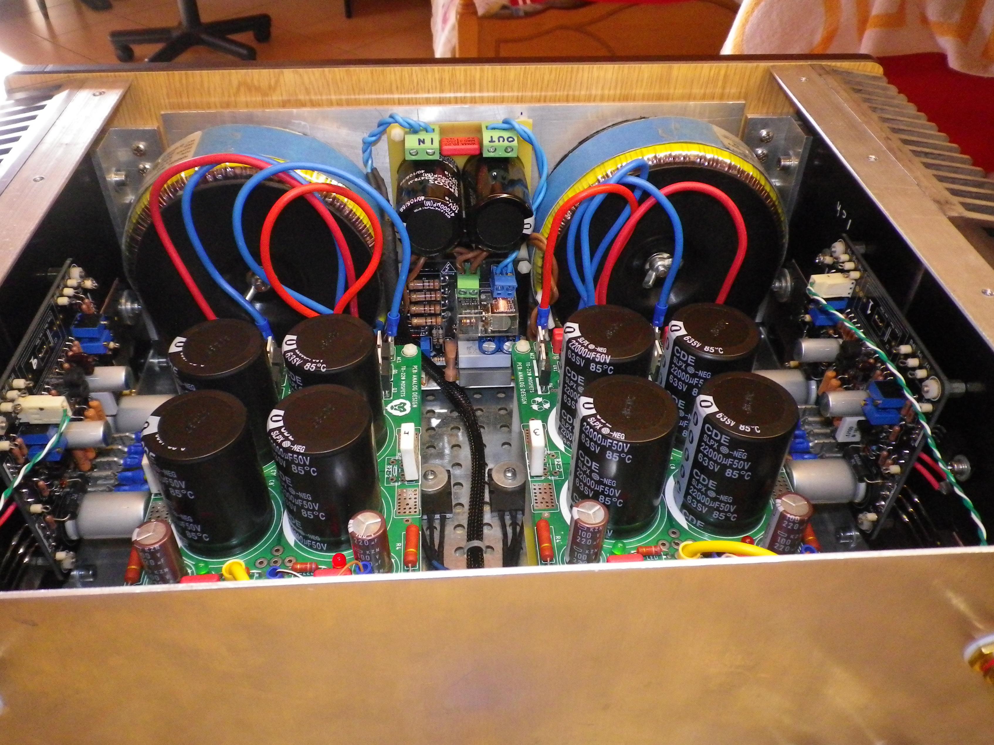

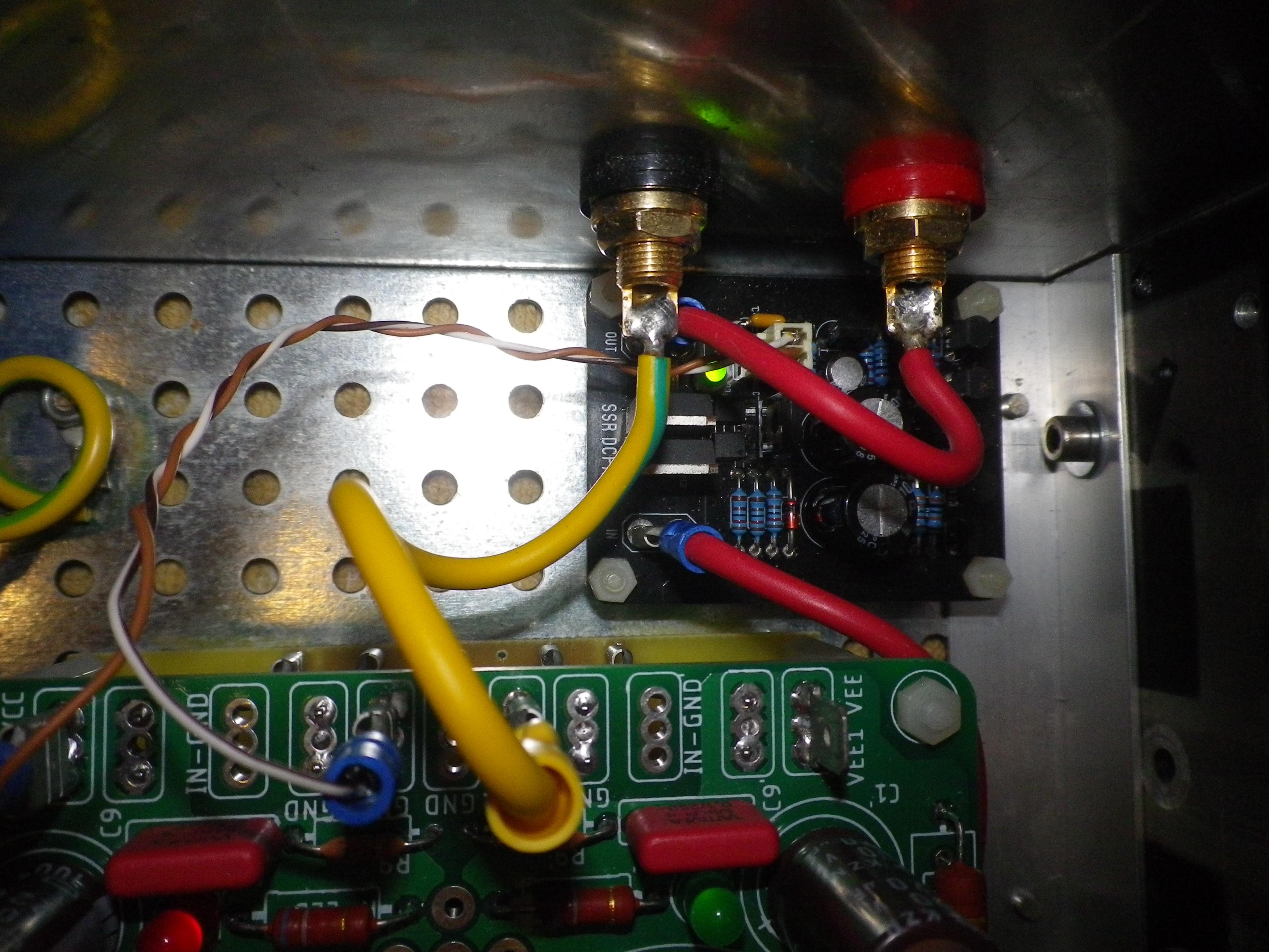

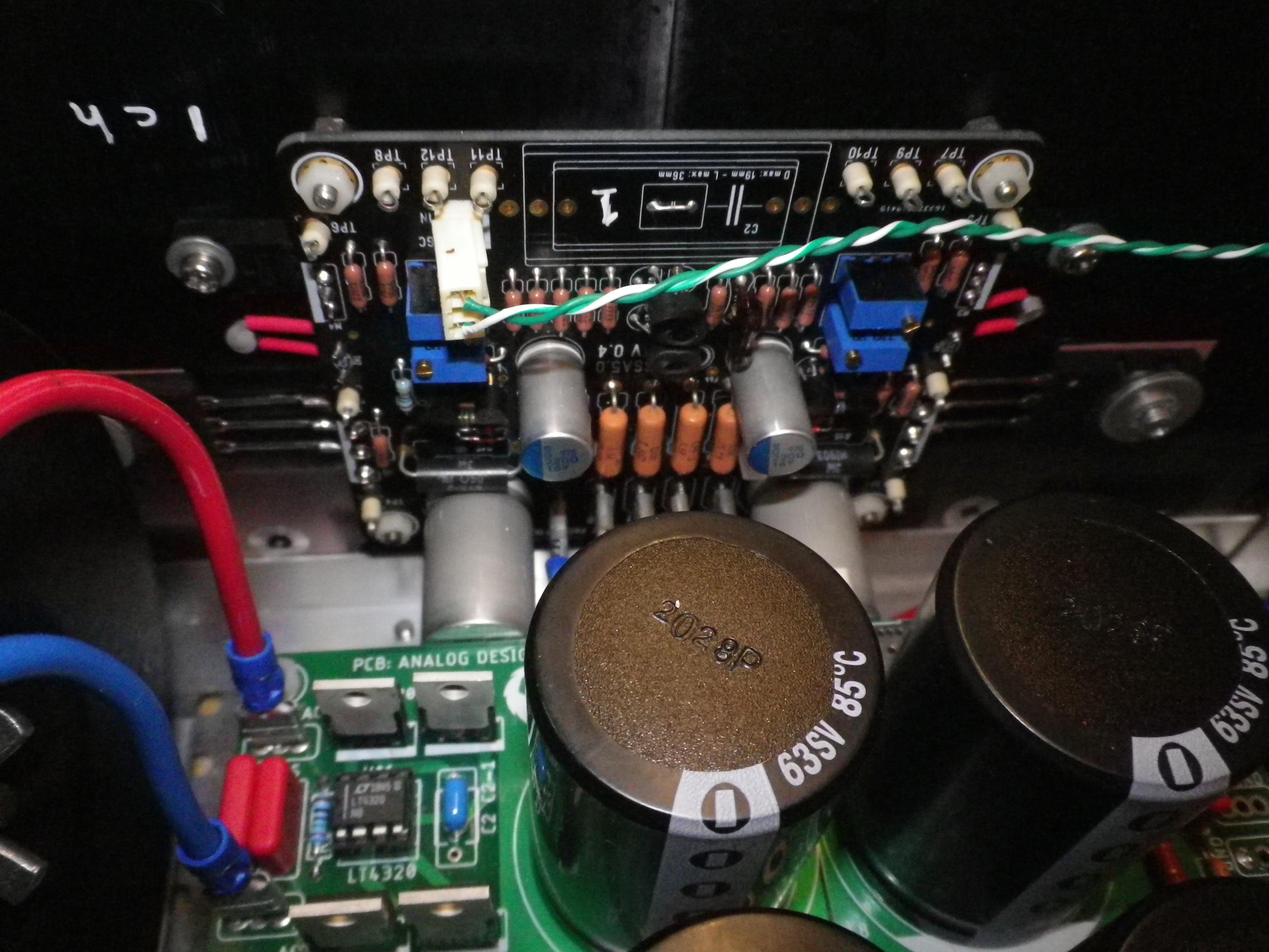

After a long time, I was finally able to complete fabulous FAB USSA-5 amplifier. First of all, many thanks to FAB, not only for this design and boards, but also for excellent QOS and his willingness always answer the questions, even though they could be asked many times by many members before. Many thanks to other members for sharing their knowledge and inspiration as well. Here you can see some photos of my amp.
Hi Amadeus00
You are very welcome 🙂
This is an exquisite built for sure. :cheers: your amp clean construction is a lot better than mine.
What bias current have you used for final adjustment? With these heatsinks you can go up to 2A with +/-24VDC supply!
One tip is that you probably could have a visual mean to differentiate between V+ and V- wiring from psu to USSA pcb since they are the same colour. That may prevent connection mistakes 😉
As for the speakers they are probably good for their category but based on your well regarded DAC you definitely should consider a speaker upgrade to get the best of the source and amplifier combination...and of course a DC protection for your speakers.
Keep us posted on your impressions after the break-in.
Thanks again for sharing your build pictures.

For a long time I wanted to ask the following: since the temperature here in Greece go up sharply to 28 C degrees of room, and I get 48-50 C degrees on heatsink in my amplifier.
What is the safe temperature in degrees C value that mosfets should reach their housing ? my bias is 1.3A heatsinks are 28cm x 15.5cm x 4cm .

I am using 1,1A bias current. It is my first proper Class A amplifier and to be honest I was a little bit afraid of the temperature. Lower temperature should be better for transistor lifetime. I am using TOROIDY audio grade toroids, 2x19 VAC which provides something 27,5VDC without any load. If I decided to increase bias current to 1,4A or 1,5A, would it have also impact on sonic performance?

The parameters you have used are quite correct. Semi-conductors generally can reach up to 150C internal for destruction. Of course at the package body the temperature is less than that. An audio amplifier with reasonable expected good service life should last at least 30 years or more (excluding the electrolytic caps of course). Lower temperature extends life but really < 60-70C at the transistor body is not a problem. Normally with main heatsink being <=50C the transistor body should easily be <60C unless you have a bad interface ( non linear surface and/or missing grease, or inefficient pads).

1.1A is sub-optimal with your actual heatsink. Class A amps have lower THD with increasing bias current (especially mosfet). Higher bias can allow you to stay deeper in class A region at high power and/or low impedance of speaker at specific frequencies. Also, increasing the output bias in that topology means increasing input stage and output stage respective gain which increases the damping factor. Depending on your speakers and taste you may prefer either a lower or higher damping factor. In any case, the USSA-5 damping factor should stay in the “good” range for an home amplifier.
You can always try it out to see what suits you best but do not worry about breaking something if you stay < 2A bias.

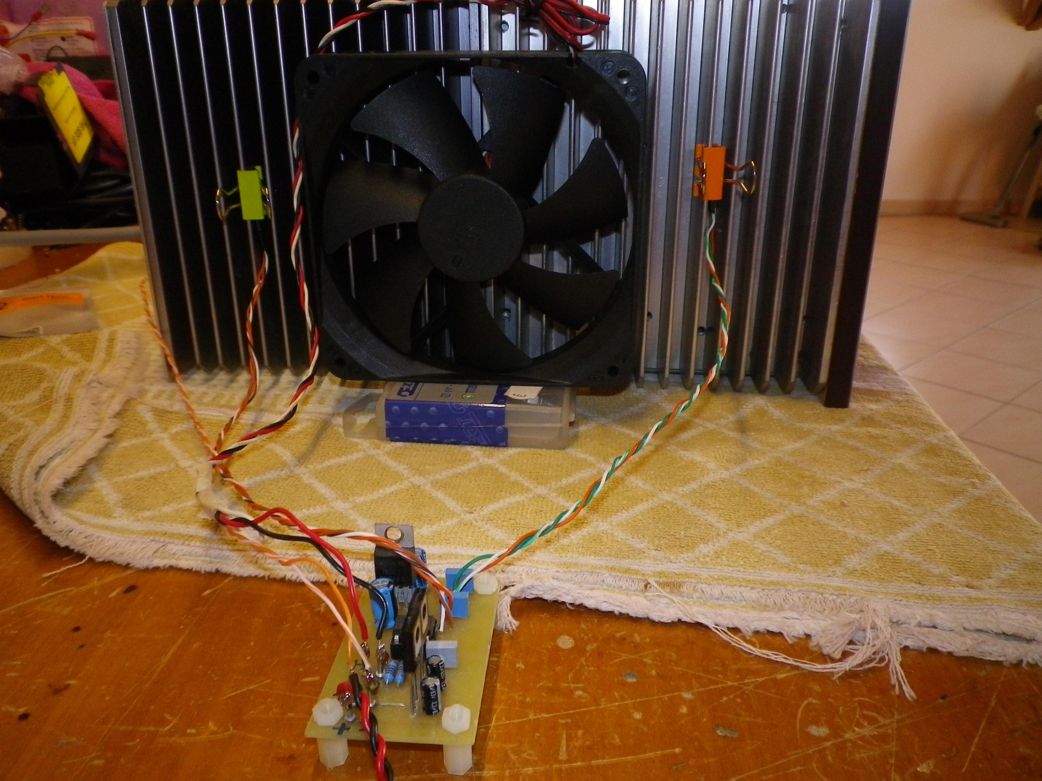

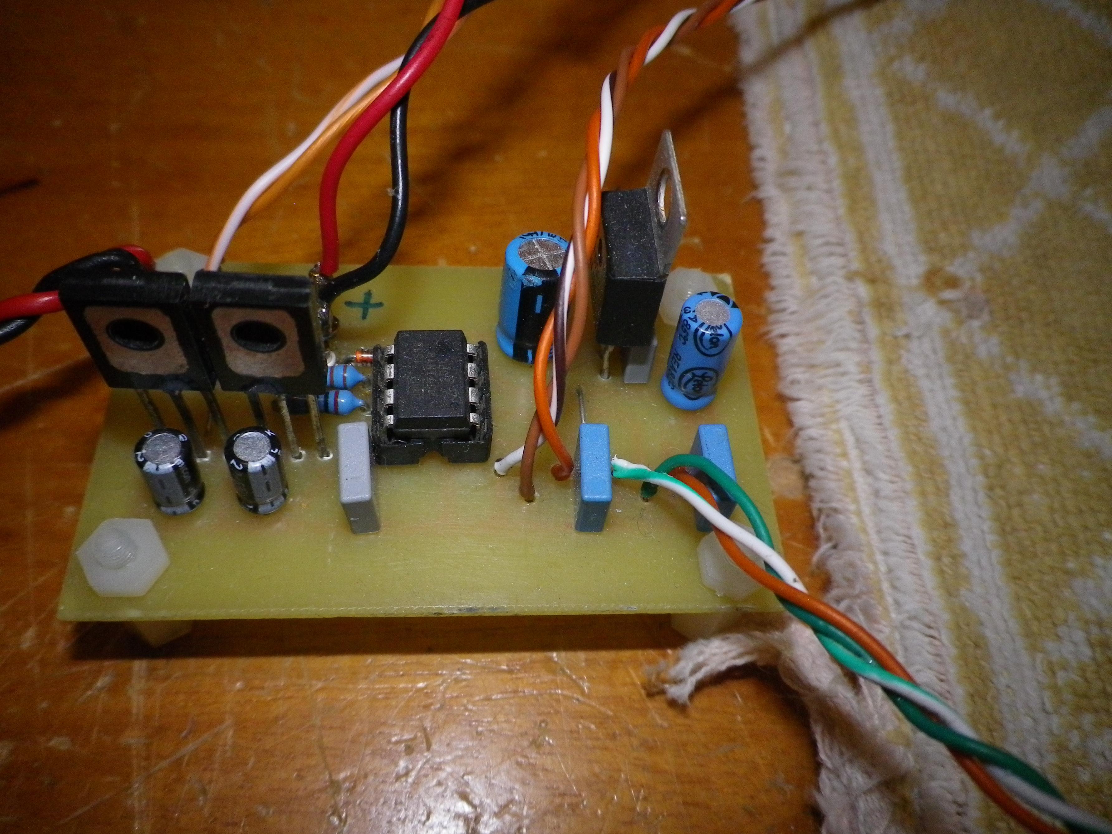

I try to manage the temperature with external fans through a processor which will start starting at 5 volts completely silently the start is programmed internal chip at 45 C

This circuit with the two fans after monitoring keeps the temperature of the heatsinks constant at 43 degrees Celsius with the temperature in the housing of the mosfet at 55 degrees Celsius .... I have seen my amplifier rise to 52 degrees in the heatsinks I guess in transistor housing definitely 60 plus degrees Celsius .
I believe that everything inside the amp will work more comfortably in such a low temperature of about 43-45 degrees ....
I will place it inside this circuit maybe together with a converter step down 24V to 12V like this....DC DC 5 32V to 12V3A Automatic Voltage Stabilizer Power Converter Regulator Dropshipping|Voltage Regulators/Stabilizers| - AliExpress to power it from the main power supply, I hope it does not affect the sound of the amplifier, since the auditions are over two hours each time and I want to not worry about the temperatures in summer.

@Amadeus. Gorgeous build! What PSUs are in use there? Very compact.
If I am not mistaken, these PSUwere developed by PROJECT16. You can find his thread here on the forum: CRC Power Supply (Class A amplifier). I am not sure why later PROJECT16 was not organizing group buy for these boards, but PRASI was selling them. At first, I ordered 02 boards from PRASI in 2019. These were well made, however when I started building my amplifier, I wanted black PSU boards in order to match USSA-5 black boards. I contacted PRASI and asked him if black colour is also available, or if he can get them and I would pay him additional cost. In the end PRASI sent me gerber files, so I sent files to manufacturer (seeedstudio) and ordered 05 pieces. I know that there might be some ethical issue ... PROJECT16 is the author, however I made them just for my needs, still got 03 spare, so if somebody is interested, let me know 😊 Second thing is that I should opt for thicker plates, these boards are 1,6mm thick with 2oz copper plating and normal HASL type of finish. Definitely not the quality provided by FAB. Reason why I choose 1,6mm was mainly the price, since I was ordering the smallest possible batch (still quite expensive). Long story short, these are CRC Power Supply (Class A amplifier) developed by PROJECT16
