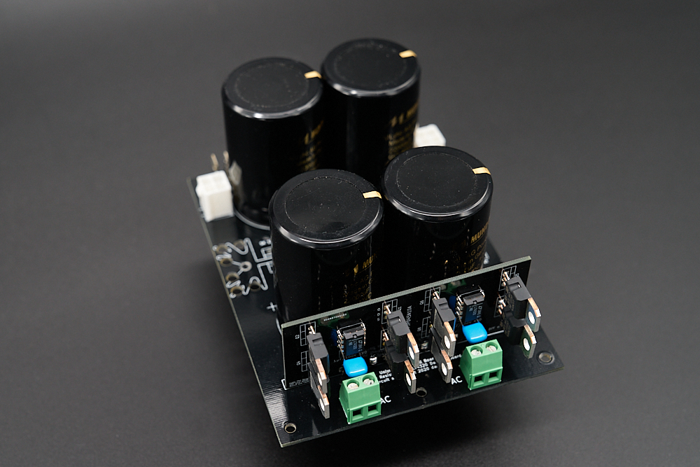

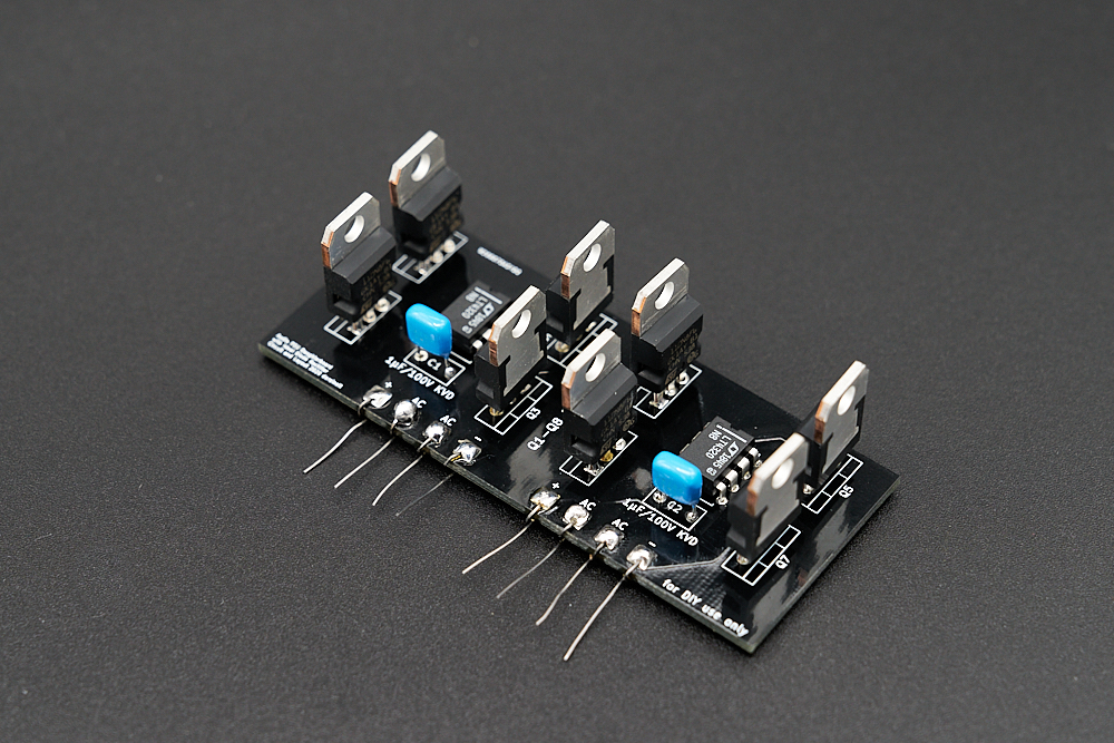

Nice PSU board you have with ideal bridge. It seems compact. Where did you source it?

I've designed them and they were produced by PCBWay. Some people learned new languages during lockdown, I decided to go with layouting and KiCAD 😀.

2oz copper on the boards, relevant traces are crosstalk-optimized (mainly between LT4320 and mosfets)
When the LT4320 daughterboards are working as they should I could upload the gerber files so that diy'ers who want to can send them to a PCB-house of their choice.
The "mainboards" could be used with TO-220 resistors on a heatsink or via an extra connector to small capacitancemultipliers (one positive, one negative). The capmx-boards could be mounted on the main-heatsink for example. Each amp-board will be connected via a molex-type connector.
My USSA5-boards are waiting for their powersupply. More progress on saturday.
