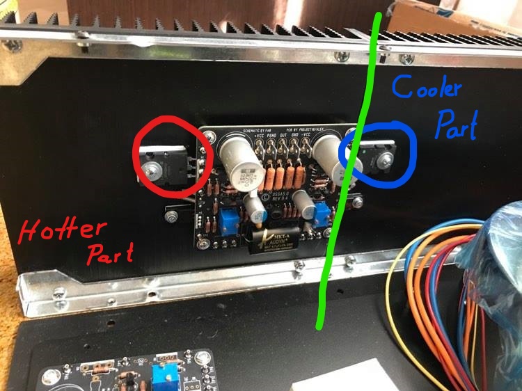

I tried to use UMS heatsinks in my build, but had to return them. UMS is not compatible with USSA-5 PCB layout. One side of chassis is composed of 02 (sub) heatsinks, since it is 400mm in length as stated by VUNCE. I bought normal 04U 400mm unit and taped holes by myself, BUT I also had to buy benchtop drill (another piece of my economical suicide when building USSA :) )
The heat dissipation is quite a strange thing for me… I did not measure it by thermometer, but one sub heatsink is always hotter than another one. The component of heatsink where power transistor is attached more to the edge is cooler than sub heatsink where power transistor is close to the centre. It same for both sides of chassis (both channels), and since there is mirroring effect, polarity of transistors have no effect on it. Quite strange for me.

Heatsink temperature.
Little visualisation.
I think your temperature difference is just normal since your output transistors are not centered on heatsinks.
