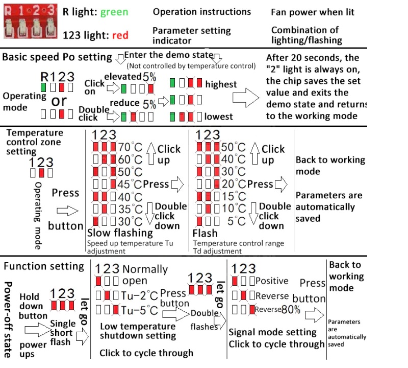

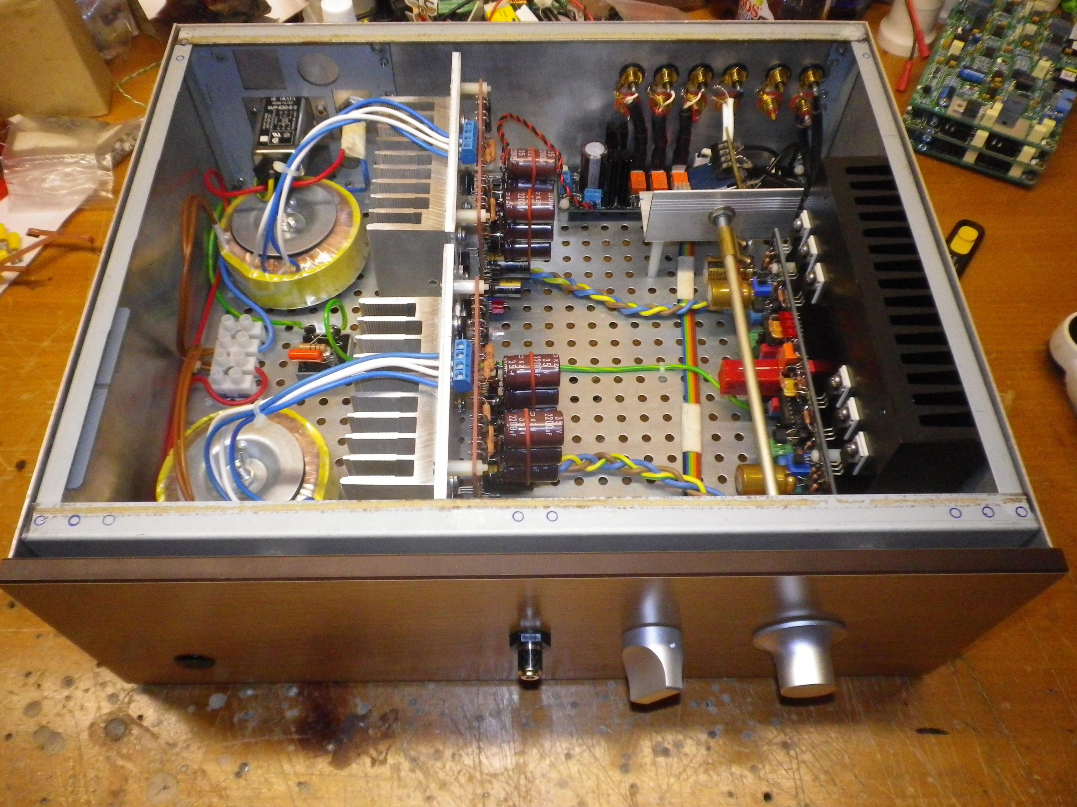

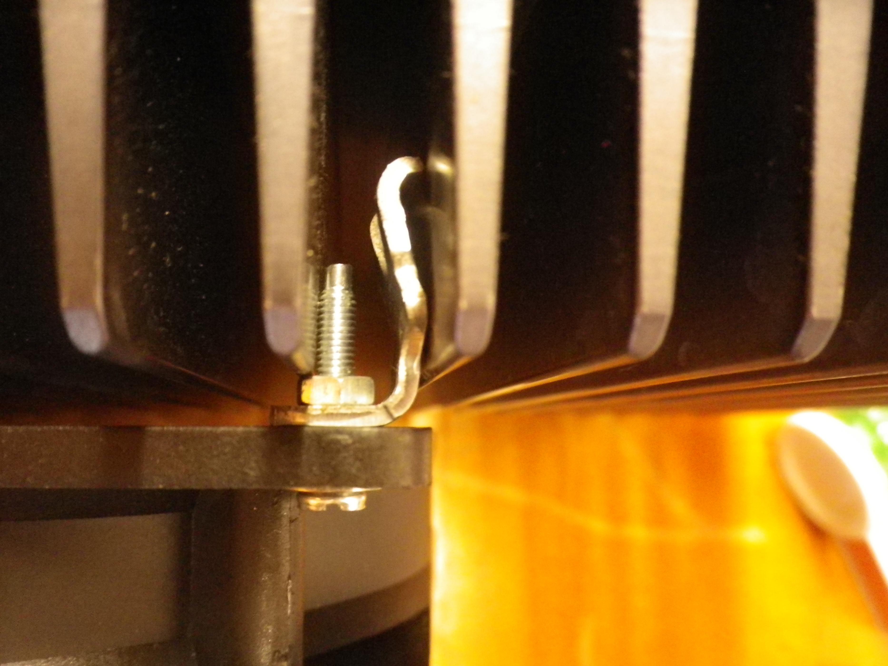

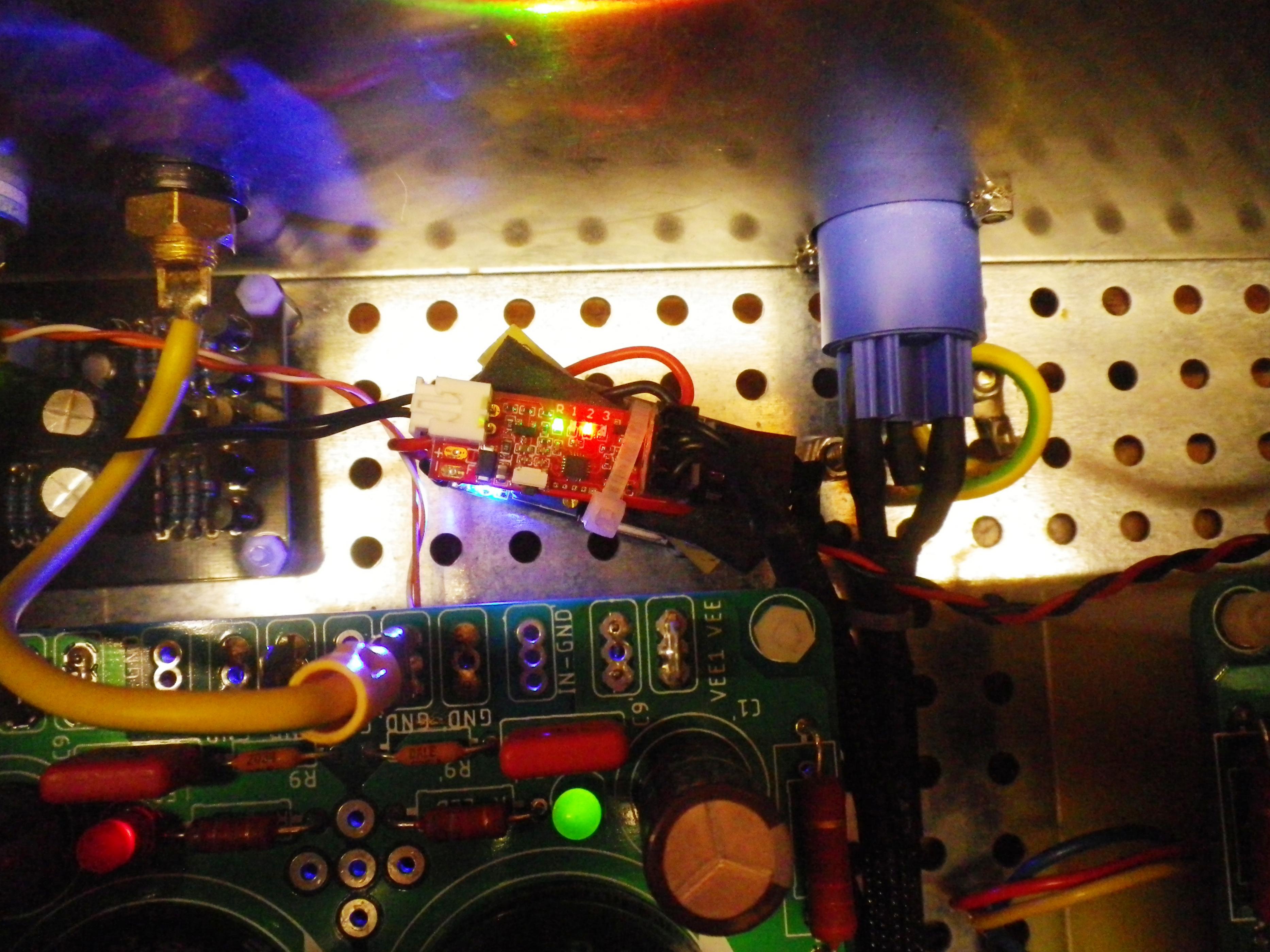

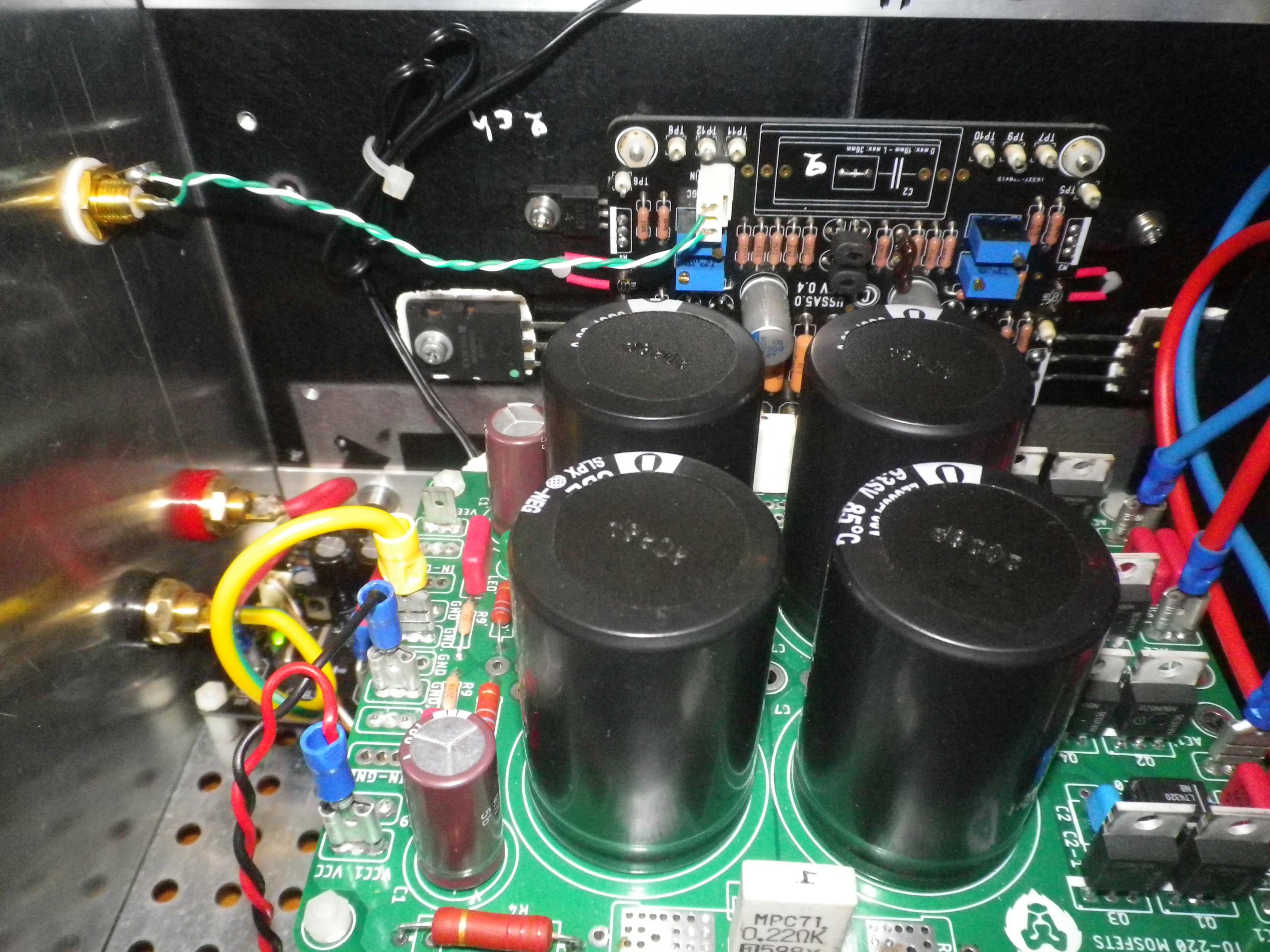

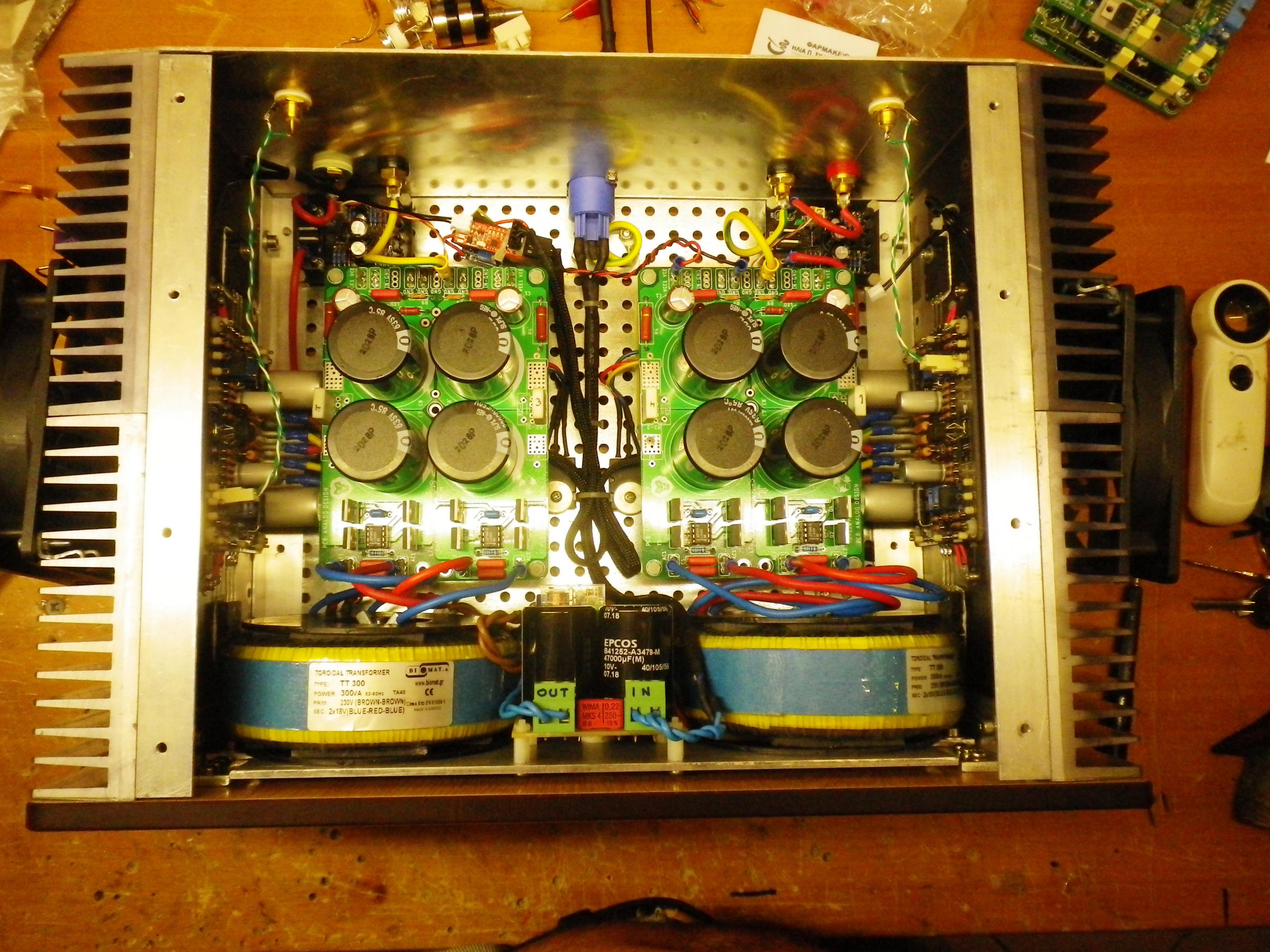

Hello, I made some changes in the bias from 1.3 A to 1.4 A with the help of two 12 cm PWM fans on the outside of the heatsinks. The temperature changes do not affect the stability of the bias or the offset (1-3mv), im playing with no entry Cap . I have set the start to 45C and the stop of them at 43 C . the internal temperature in the box did not exceed 40 C. Ambient temp about 30-31 C. Very very pleasent Amplifirer!!!

Hi Niko
Yes indeed nice implementation.
You can also try one or more tweaks to your boards:
1) change source resistors value form 0.05 ohms to 0.02 or even 0.01 ohms. You will get even more class A envelope for the same output bias. Ensure to readjust bias accordingly.
2) increase driver current to about 50ma. Reduce driver resistors value keeping the same ratio between positive and negative sections.
3) use a slightly different current for input current sources for positive and negative sections. This will change H2 level without affecting other harmonics. Refer to build manual for USSA5.1 version, section 19.1.3.1 note.
4) reduce slightly both positive and negative input current to increase damping factor.

Very nice Niko. I run mine at 1.4A and like you, I enjoy this amp.
Are the fans noisy or don't you hear them when music is playing?
Ηi my friend Harry.
the fans is very very quiet(only PWM fans) you can also adjust the rotation force to 10 levels I use this...
DC 5V 12V PWM Speed Controller Fan Speed governor 2 3 4 Wires Computer Temperature control Switch for PC CPU Cooler Fan Alarm|Switches| - AliExpress
Slip Stream 120 PWM - Scythe EU GmbH : Scythe EU GmbH
Νothing is heard you have to approach at a distance of 30cm to hear the rustling of the air not the fans ....
