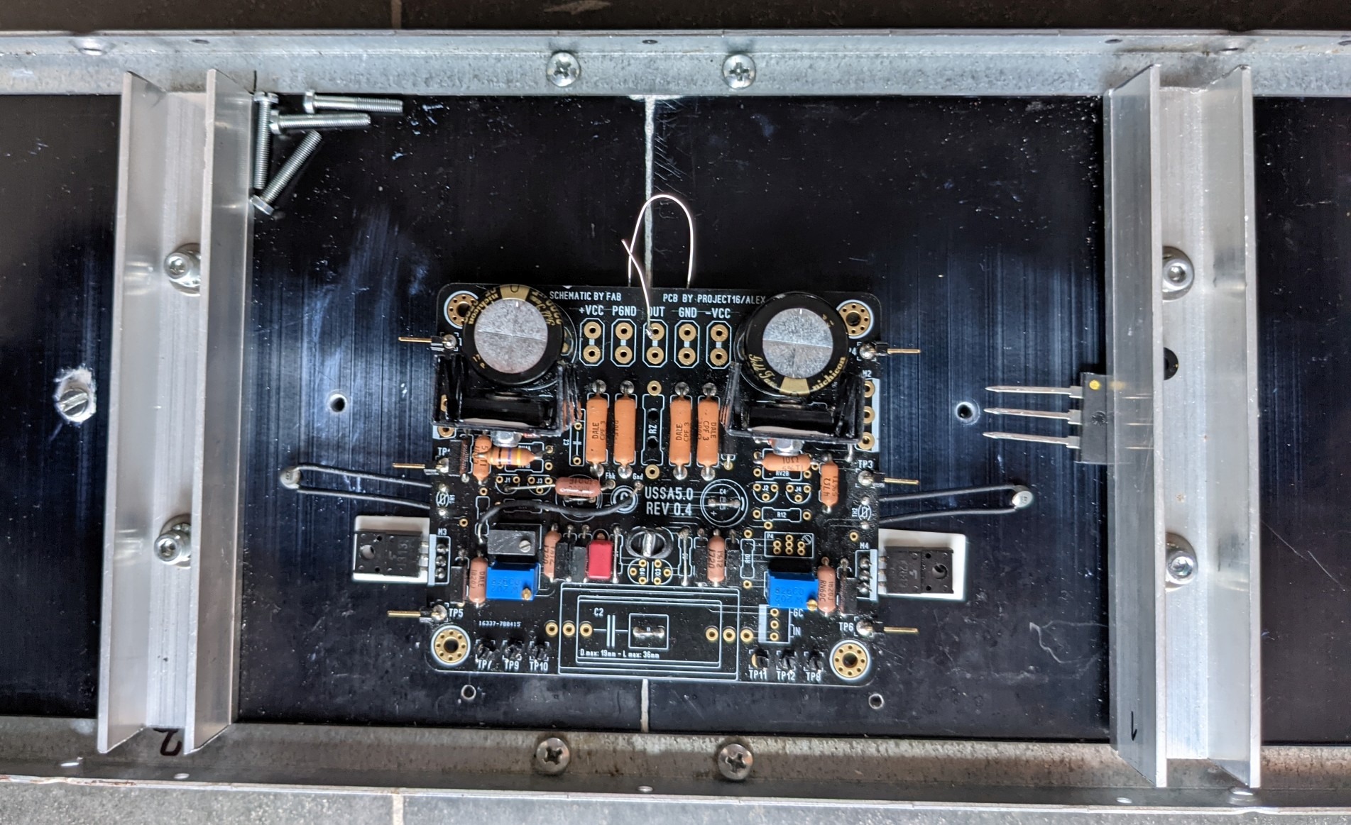

Thinking more about it, if you followed the manual (section 20.1.3.1 and 20.1.3,2) then it means that your Jfet current sources values were correct. Thus, please report your steps results (either « ok « or the value) here :

I have put in bold instructions so you always connect both grounds so no issue can arise from one missing ground.
If you had succeeded at step 20.1.3.2 to obtain 180mv there is no reason why you cannot get 200 or 260mv across R15 or R16 at steps 20.1.3.4….
Also, ensure you really have 0.2 ohms for R15/16 and not 0.02 ohms.
Ensure Q7 and Q8 are in the right position.
Ensure the thermistors are working well because they are absolutely mandatory for the USSA5B! This is preventing thermal runaway.
At step 20.1.3.2. You can set a lower bias with 20mv for example to see how it goes.
Also I cannot see if R4 is installed from your picture since you seem to have 2 xC1 caps installed.

- R15 and R16 are 0.22 ohm in my case. I could not get 0.2, so I got 0.22 ohm 3W resistors and they actually measured 0.23 ohm on my cheap component tester. My DMM is not accurate enough for such low resistance. I used the component tester also to measure hFE and match Q’s 1 to 4 (BC547 and BC557)
- I will check again, but almost 100% sure that Q7 and Q8 are in the correct positions
- R4 is mounted, but hidden behind the C1 caps. Yes, there are 2 x 110pF caps in parallel. I could not get 220pF mica caps at the time
- Measurements went well with sections 8.7 Current source adjustment and 8.8.5 Adjust current in input stage.
- Up to this point only V+, V- and PGND was supposed to be connected. I did not connect PGND, so only V+ and V-
- My problem (smoking resistors R15 and R16) started when I connected V+, V- and GND to attempt measurements for section 8.17.1 Adjust output Mosfet current close to intended final bias. At this point I should have skipped to Section 20.1.3.3 of Addendum 2.

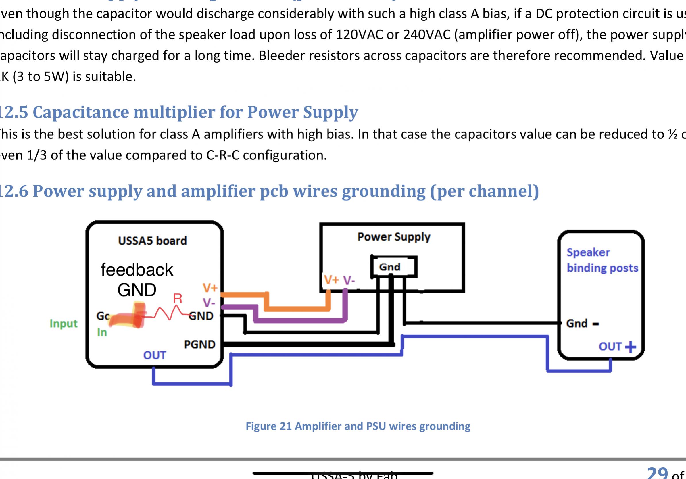

- Maybe my problem is that I don’t understand the difference between GND and PGND in this case? Maybe I switched them around? I assumed that for a dual polarity PSU one refers to the outputs as V+ / GND / V-, and that PGND is only connected to the earth on the supply and to the wall socket in case of a short circuit?

I think per Fab and the manual, one of the GND or PGND has a floating ground via a resistor. Which means that you should connect both the grounds to the PSU ground for proper measurement and setup. One of my channels blew up after an year of play because the PGND spade cable because of frequent plugging and unplugging had come out loose and the adjacent resistor blew up. Based on Fab's suggestion now I have made sure that I get a slightly higher wattage 2w resistor and also made sure that the ground cables from the PSU board are tight fit.

Gnd and PGND
See below extract of manual where I just manually added the isolation R between input/feedback and GND pin. Then you need to connect GND and PGND at the power supply central ground connection. During testing, you can omit PGND in the first steps of the manual but not when you go back. Therefore, I recommend that you always connect both GND and PGND pins to the PSU gnd.
Fab
