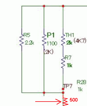

Hi Fab,
I'm busy with setting the bias, so far I needed to change the resistors R5 and R6 from 2.2k to 2.7k,
otherwise I couldn't get the bias higher than 1A.
Resistors for the drivers will be about 57R and 35R,
the cardboard is for putting pressure on the driver resistors that I plug in (no soldering), fast and easy to determine the values 🙂

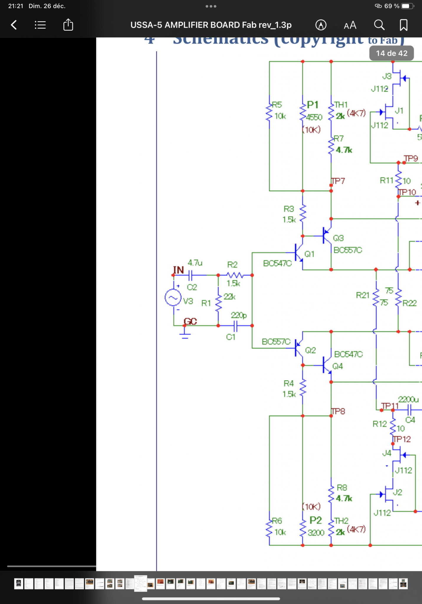

Hi Danny
I am confused since R5/R6 are 10k ohms each on the schematics and BOM. Only in USSA-5B version the R5/R6 value is lower in the 1K and 3K range….
Can you clarify. You can send me all your measurements taken at each step and I can double check them.
Fab
Fab
Hi Fab,
It's the USSA-3 that I'm building with 2SK170GR and 2SJ74GR
I'm using the doc "USSA-33 AMPLIFIER BOARD Fab rev07.pdf"
R5 and R6 at 2.7K is just enough to get 1.2A, but not for 1.3A
then I need to change the pot, and thermistor R7/R8
or put a resistor in series of 500 before this block? see red markings that I added:
