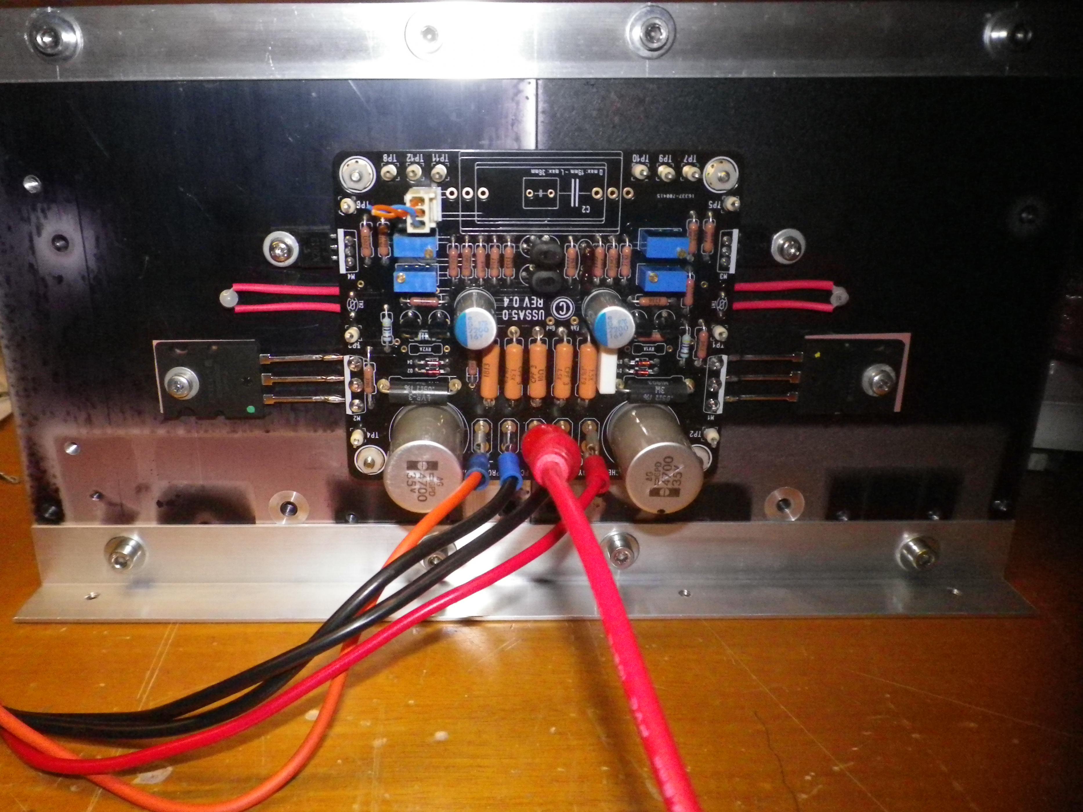

And the mosfets arrived.......

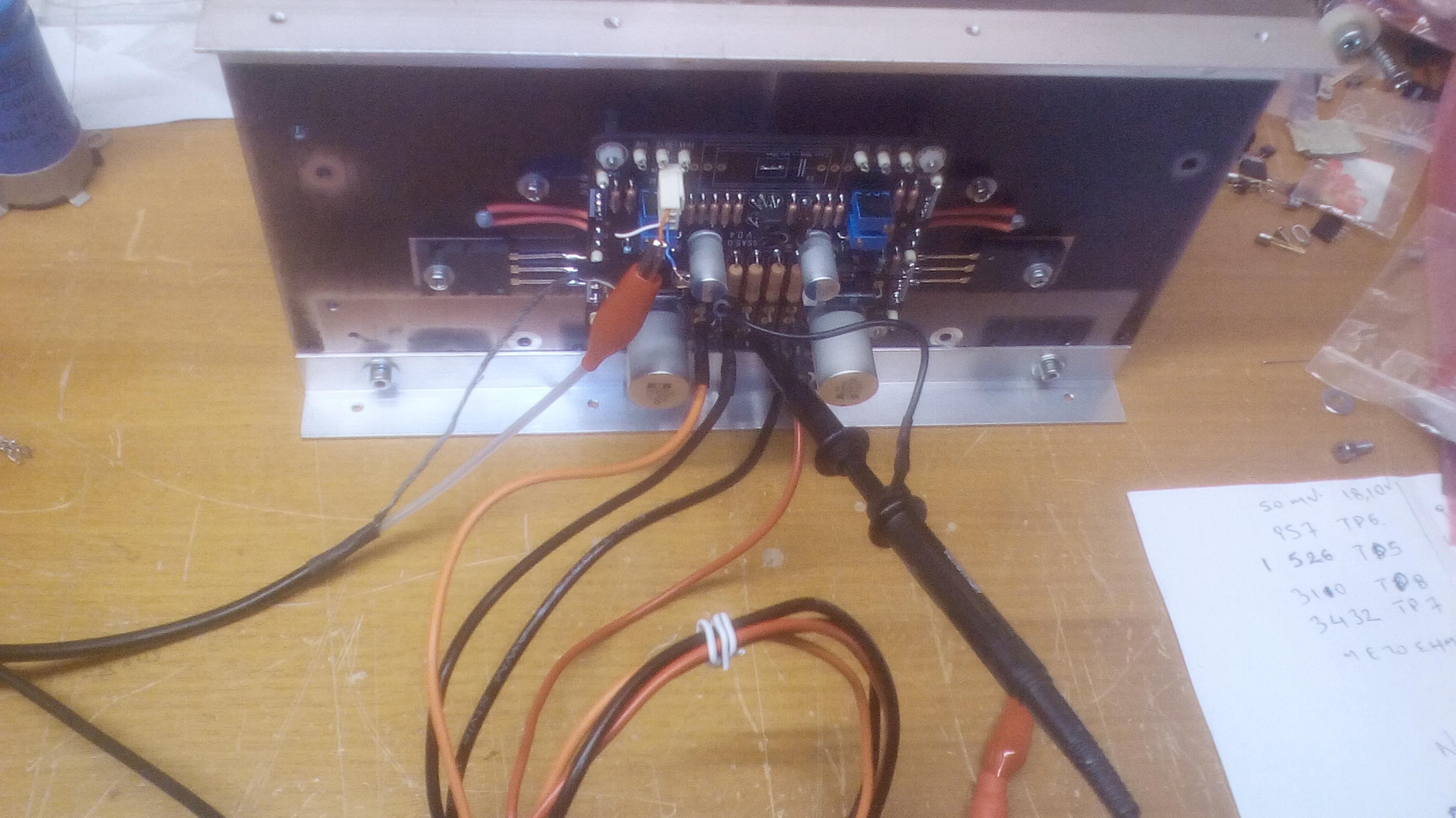

Some first measurements....

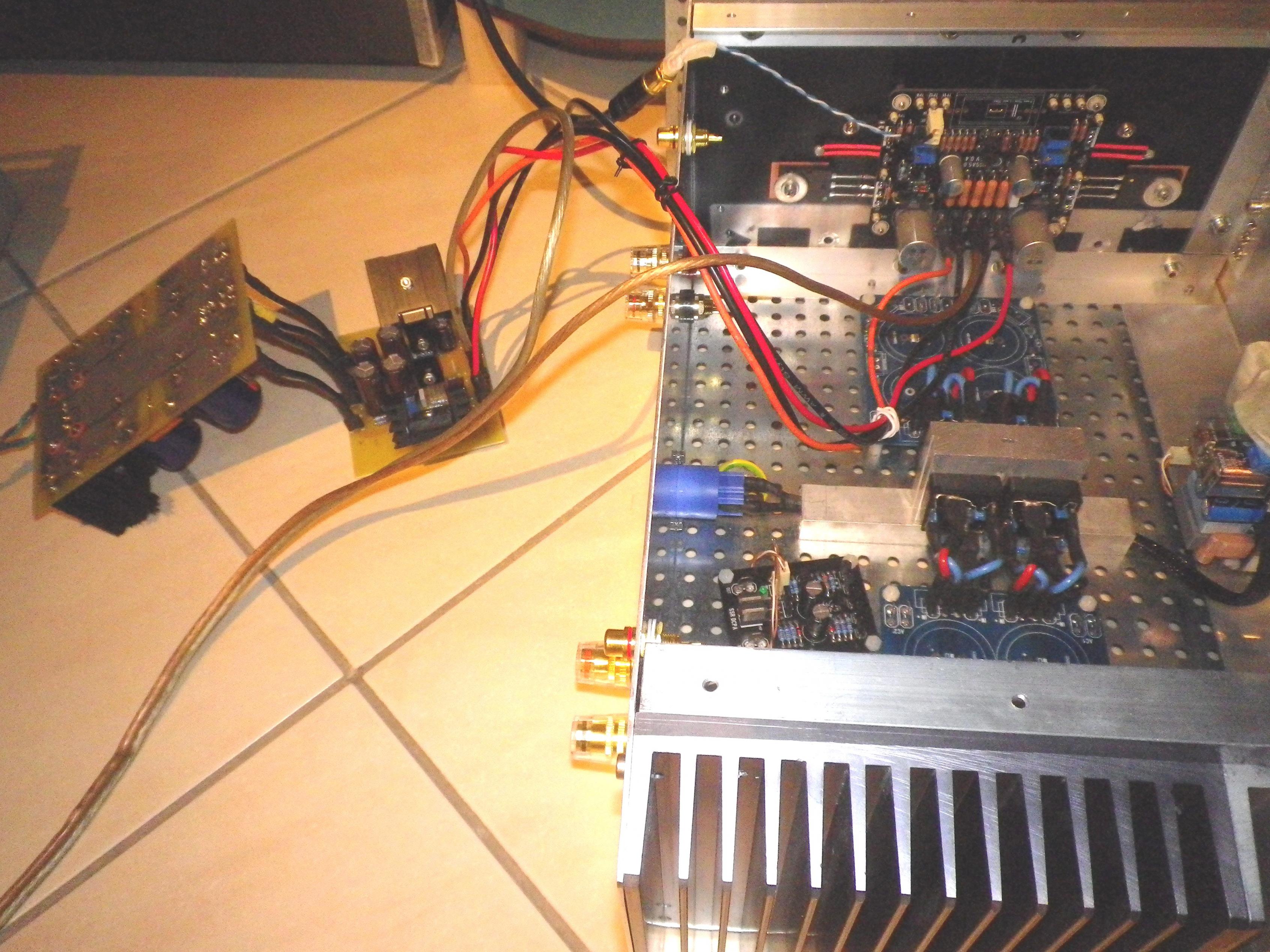

@nikosekey,
Can you share with us what is your bias level, heatsink and ambient temperature?
@ Μeanie my pleasure ....
The dimensions of the Heatsink are 15.5cm X 27.5cm X 4cm fins.
I tested the amplifier with transformer voltages of 18 volts DC and 26.5 DC volts at ambient temperatures about 20 C. The bias level 60mv about 1.20A , Temp on heatsink with +/- 18V dc 1.2A bias about 38C. Temp on heatsink with +/- 26.5V dc 1.2A bias about 45C...
I haven't decided the voltages of the transformer since I don't know if I'll go beyond the main power supply CRC and ripple eater ...
I still haven't read any reports about any differences between CRC vs CRC with Ripple eater here in this thread ....

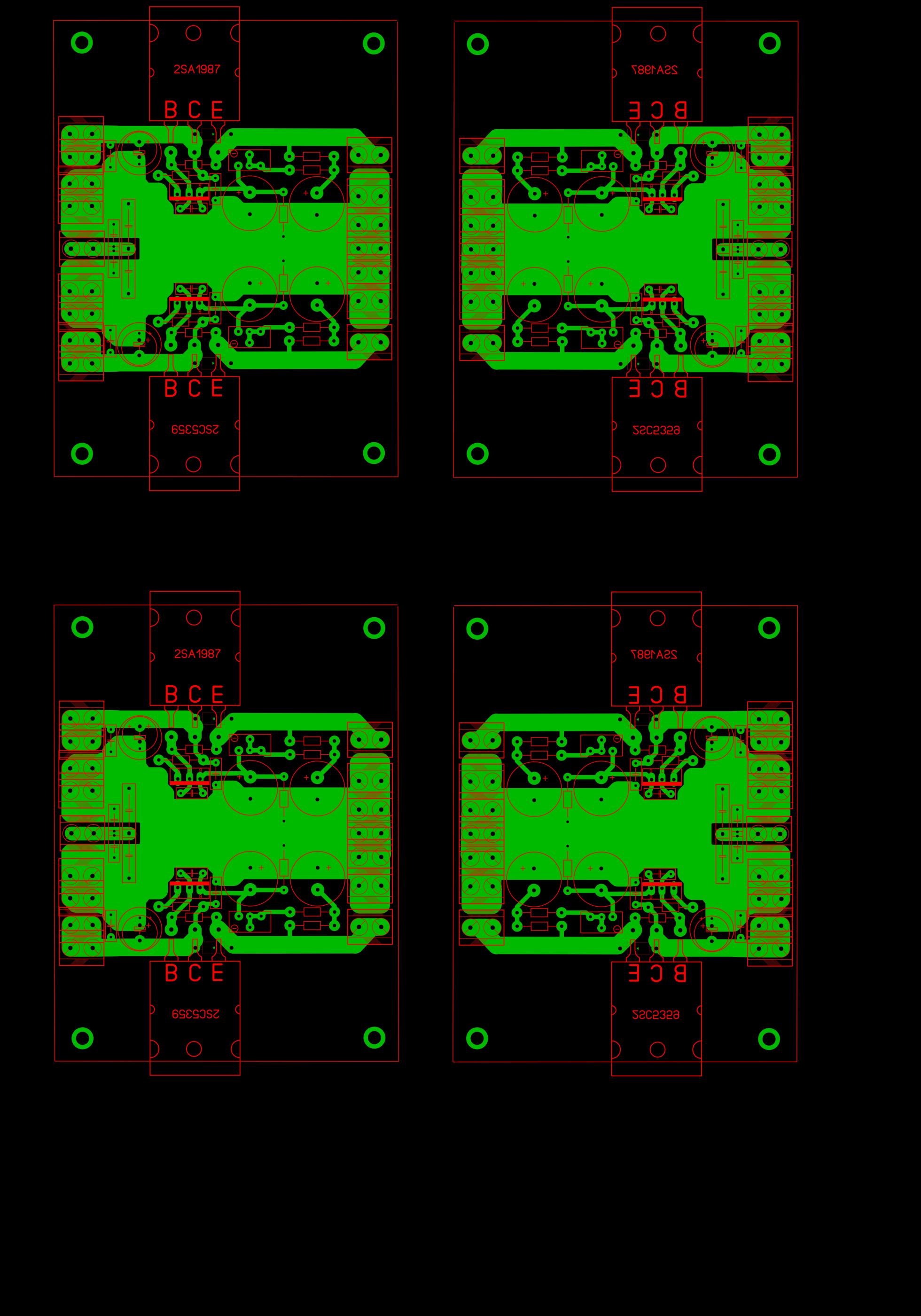

Levendi Niko,
have you got Gerber files or a black and white image for the ripple eater PCB?
Regards
Harry
Regards
Harry

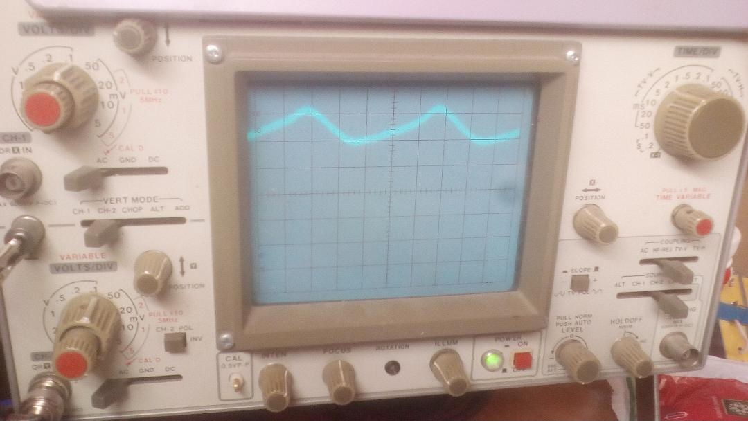

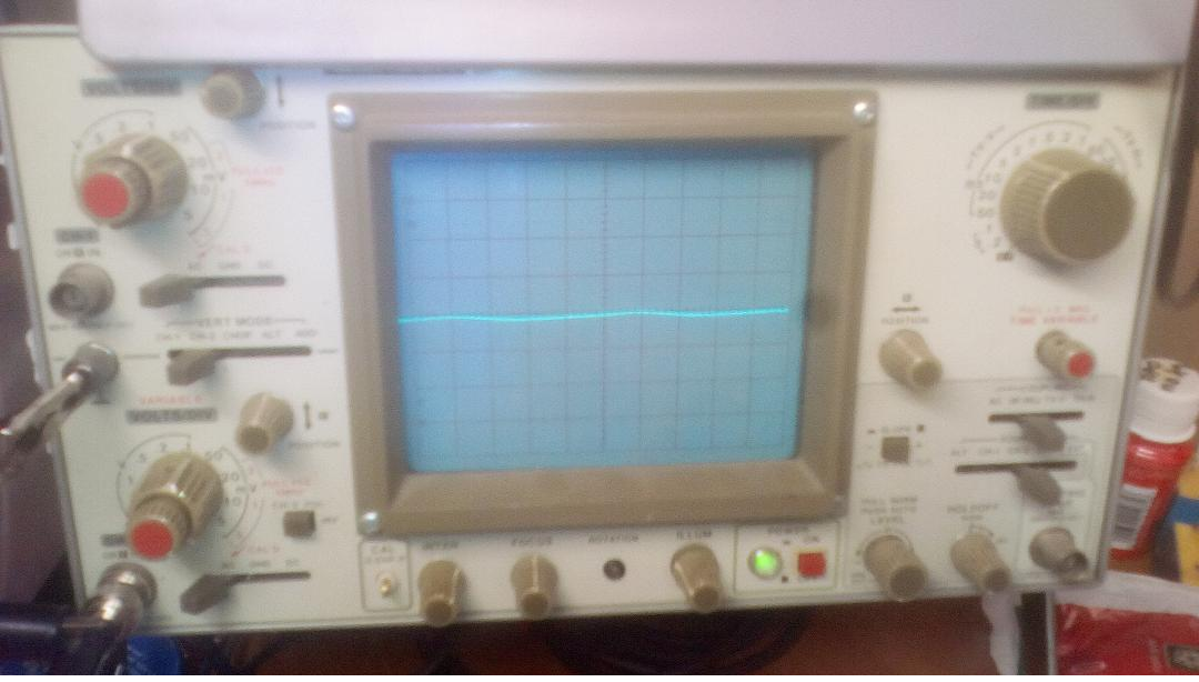

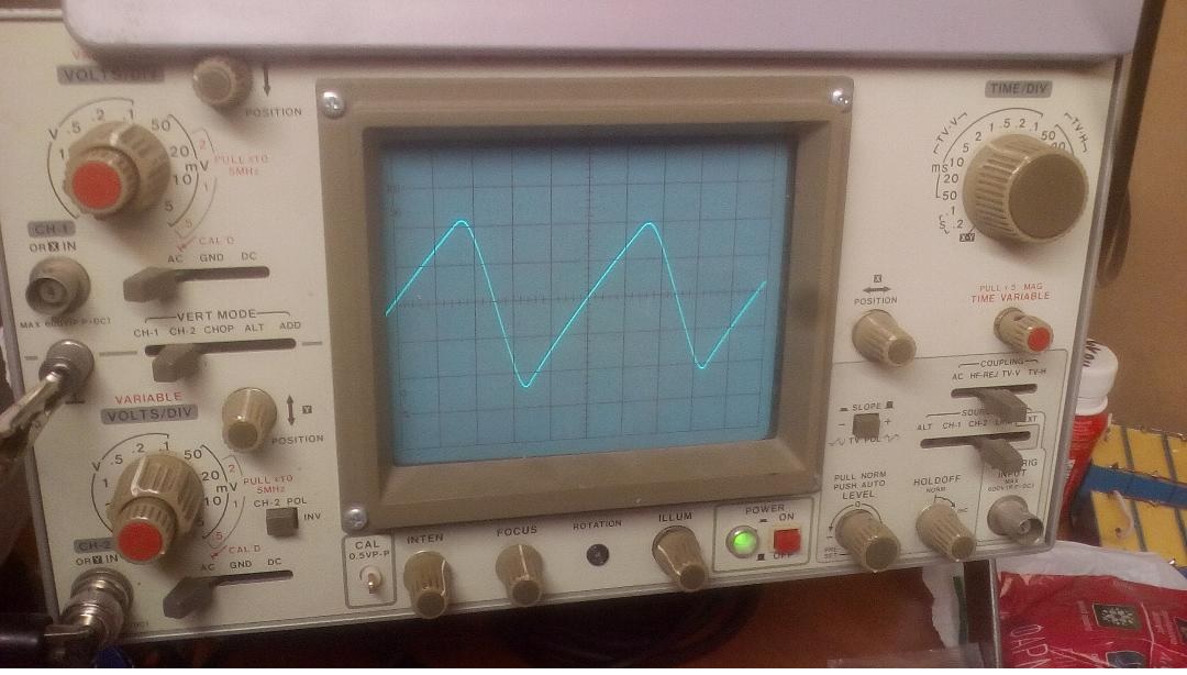

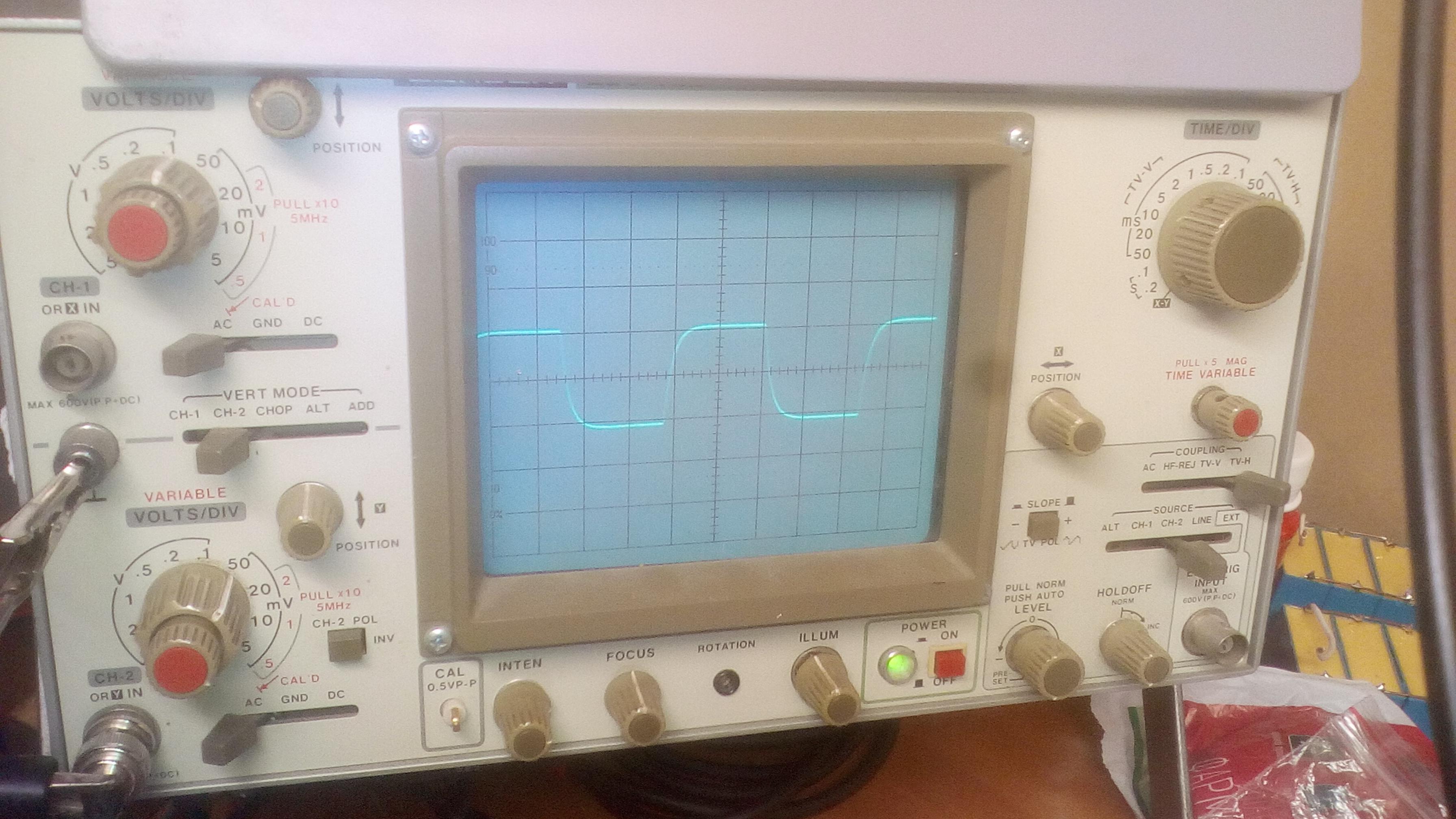

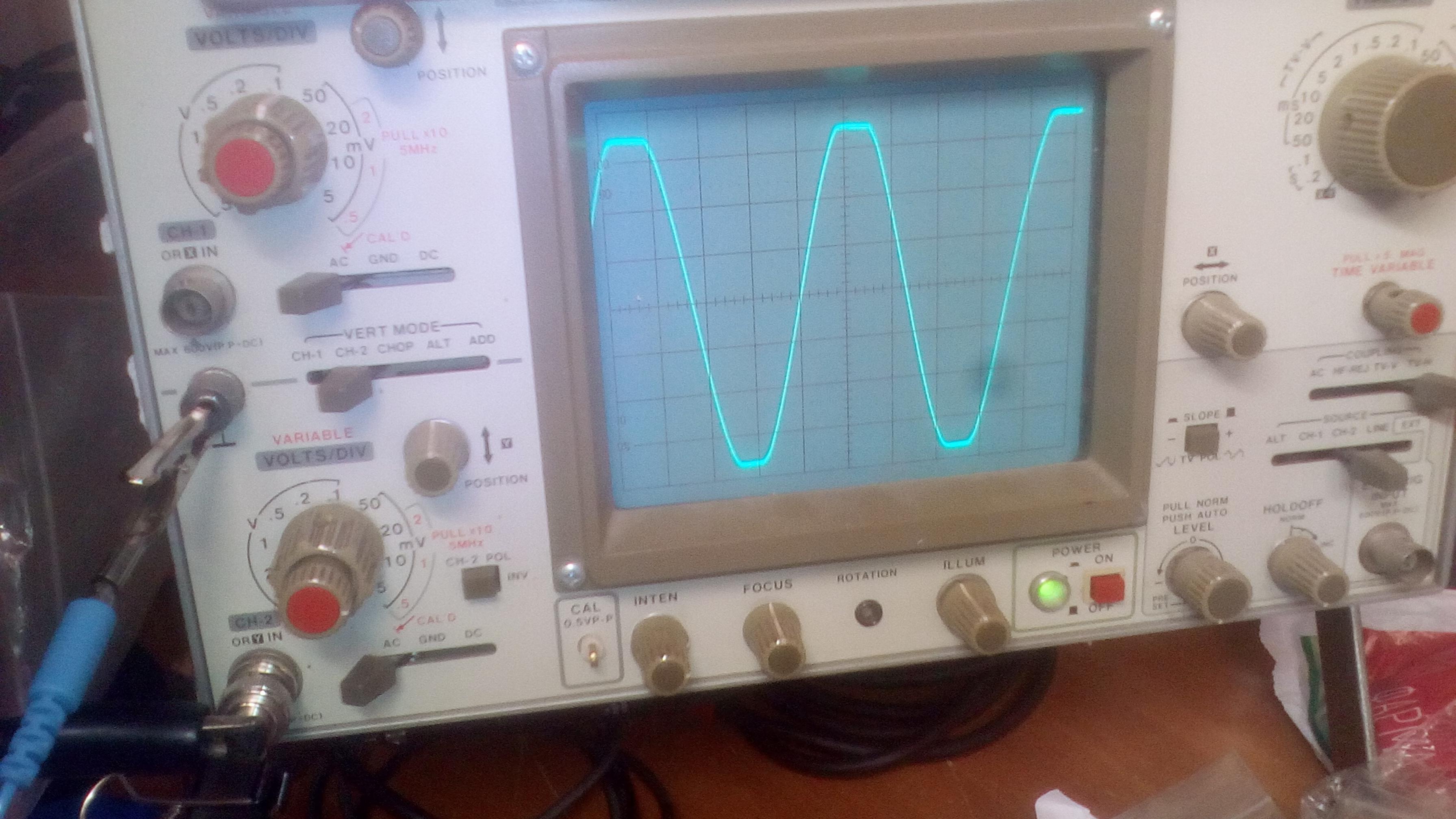

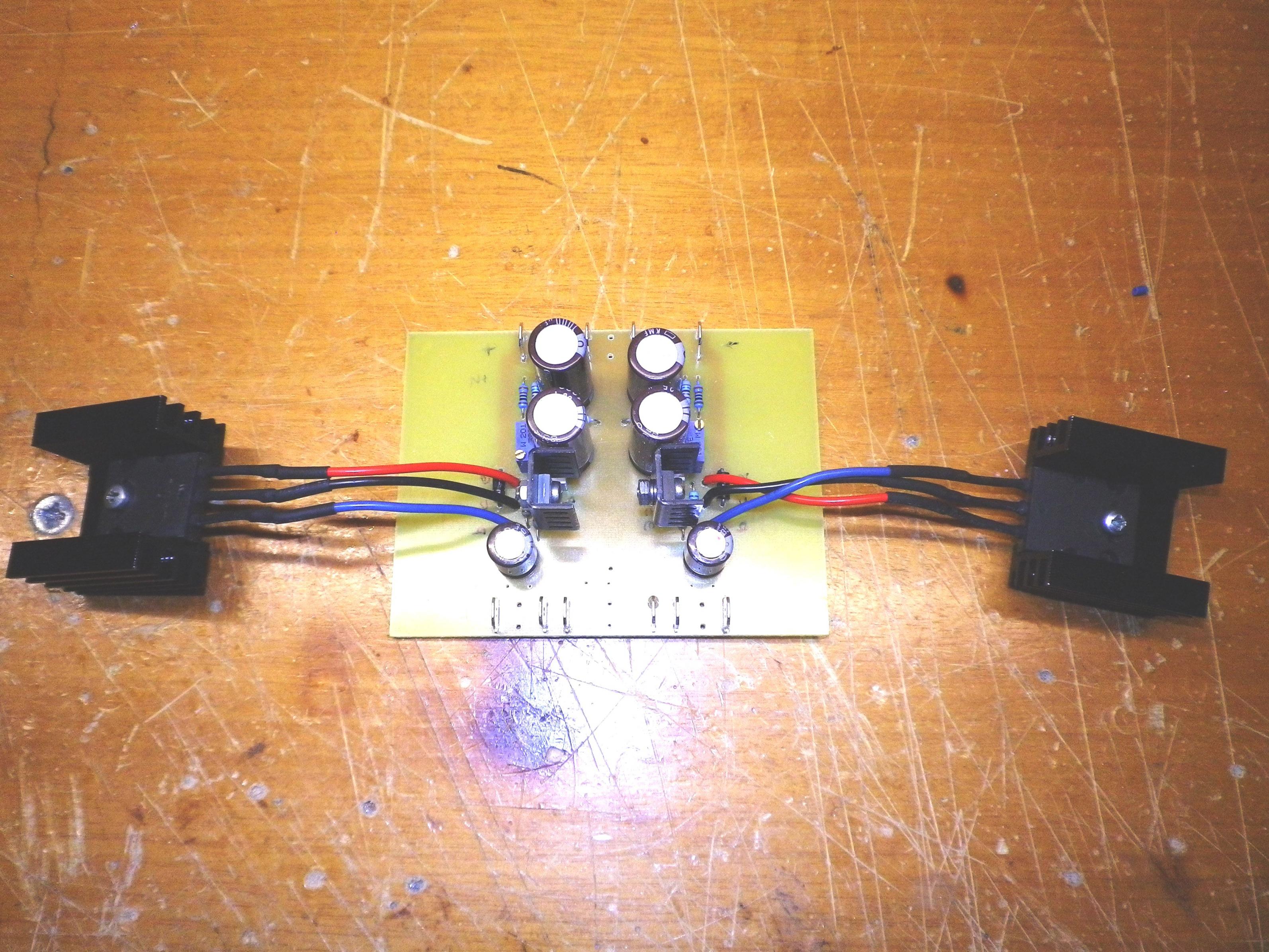

Ripple Eater some measurments .....Oh amazing .....
Ηi
i have some explanations about my above measurements ... my main power supply
CRC consists of two 4.700uf caps per rail with a trafo 2x15 V 200VA, bias of the amp about 1.25A , i measure with my old scope 0.2V /Div about 850mv ripple pk-pk as the photo simulation ... after the Ripple eater scope 5mv /Div looks about 2-3 mv.... the other foto of my scope is with magnifier knob pull out X10 ..
Also i listening music with and without ripple eater ....mmm this amp promise me very good acoustical results i prefer to write my impresions with a good CRC over the amp...
After a year, since I first contacted FAB for his PCB and awesome build manual.
I finally completed this fantastic power amp. Along the way, I kept changing power supply during bench testings, and I decided to use twin SLB, and build it as a twin monobloc in a compact chassis, and SSR for speaker protection.
It took about an hour to reach full working temperature of about 53degC, its slightly high on this compact chassis, it was 48degC on a Conrad heatsink 350x150x50mm.,with an ambient of about 22degC. Bias was 1.35A on a rail of +/- 23.8Vdc.
So for anyone that is going to build this amp, my advice would be, to first read FAB's manual front to back a few time, make sure you know what is the next step beforehand, it will save you from any headache. It is a comprehensive manual written in a systematic way of approach. As long as you follow the steps, you can't go wrong!
Time for some serious listening... Thanks, Fab!
