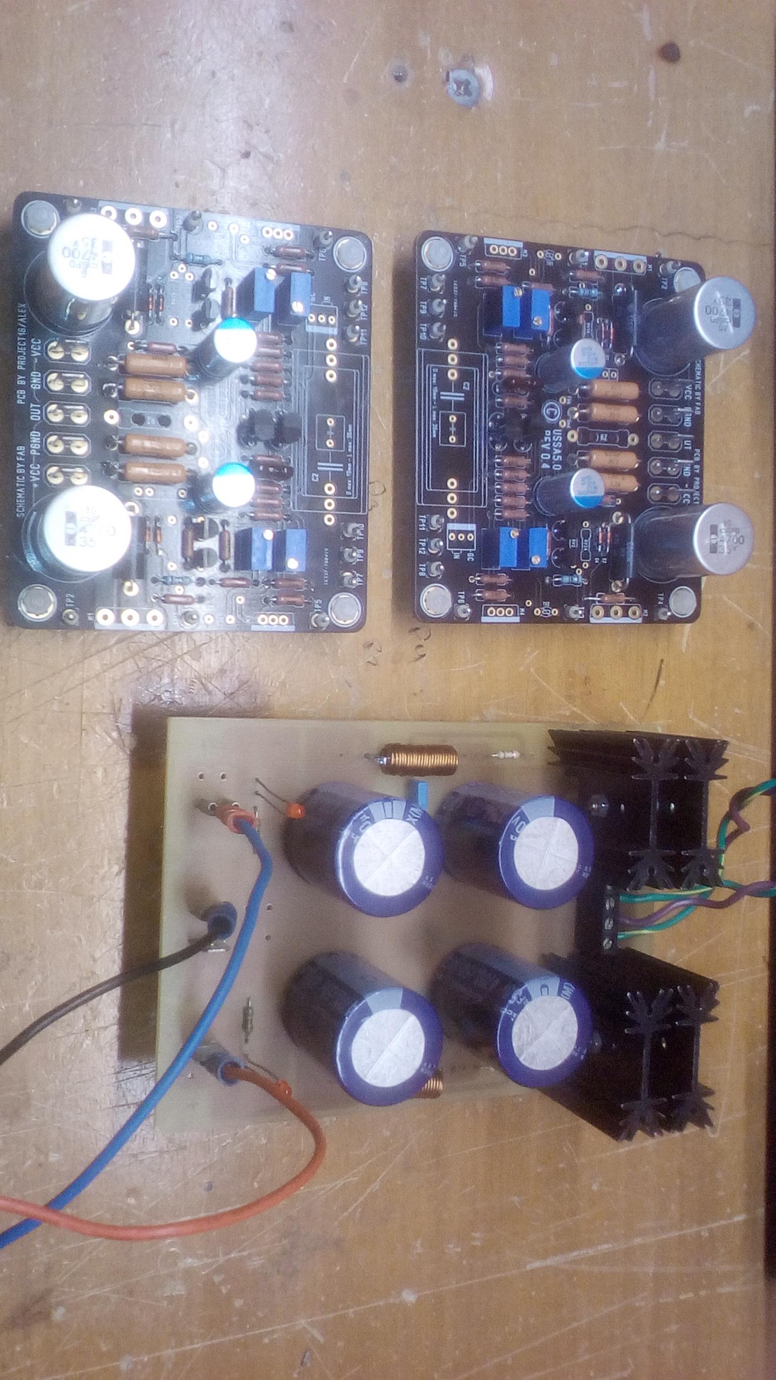

I test them with my jfet tester all gives me 4.6ma at the beginning and stabilize at 4.1-2ma
So far so good, I ajust the boards at 2.5V
Tomorrow morning thermistor and mosfets drivers installation adjusting for 3.0V.

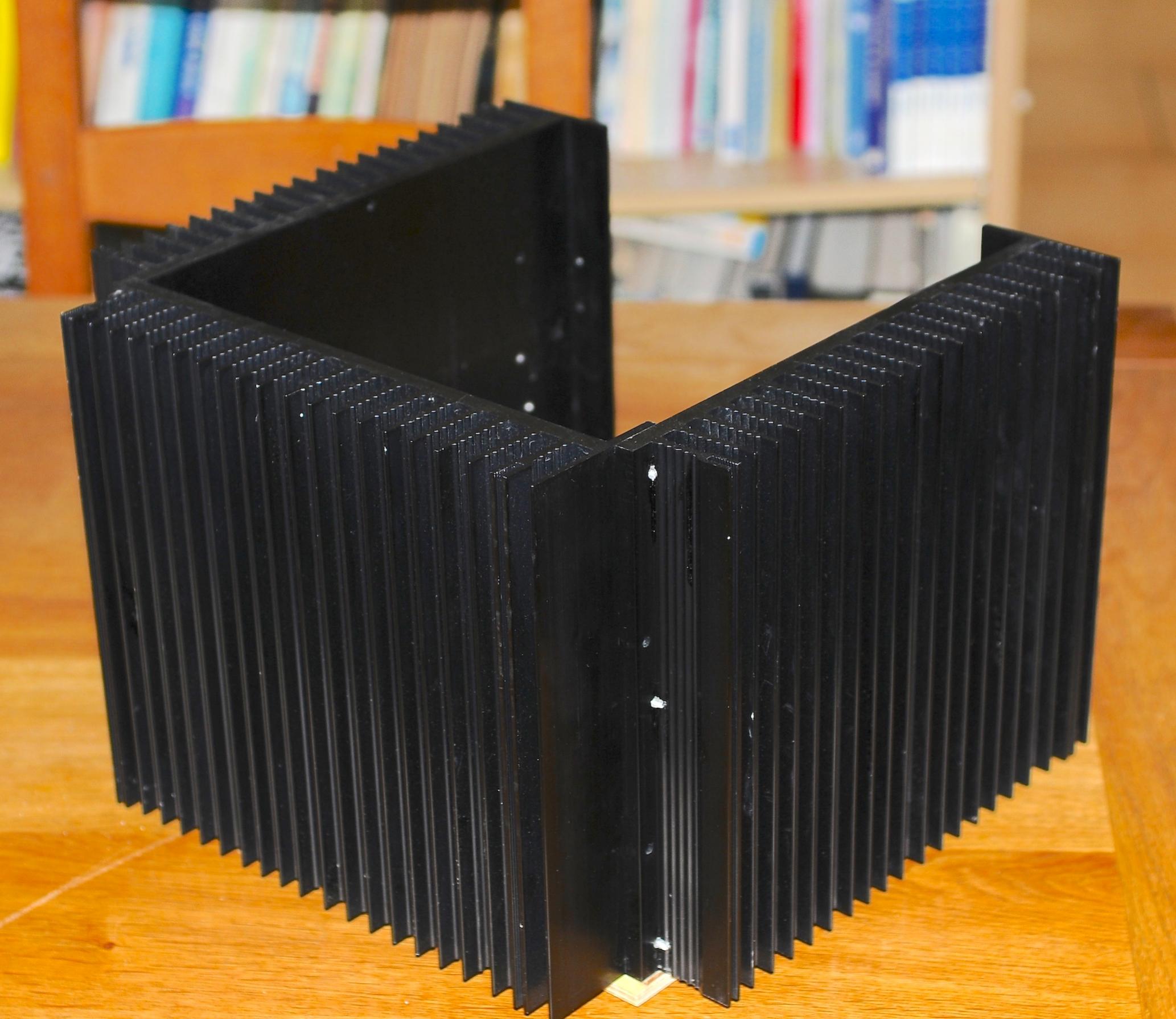

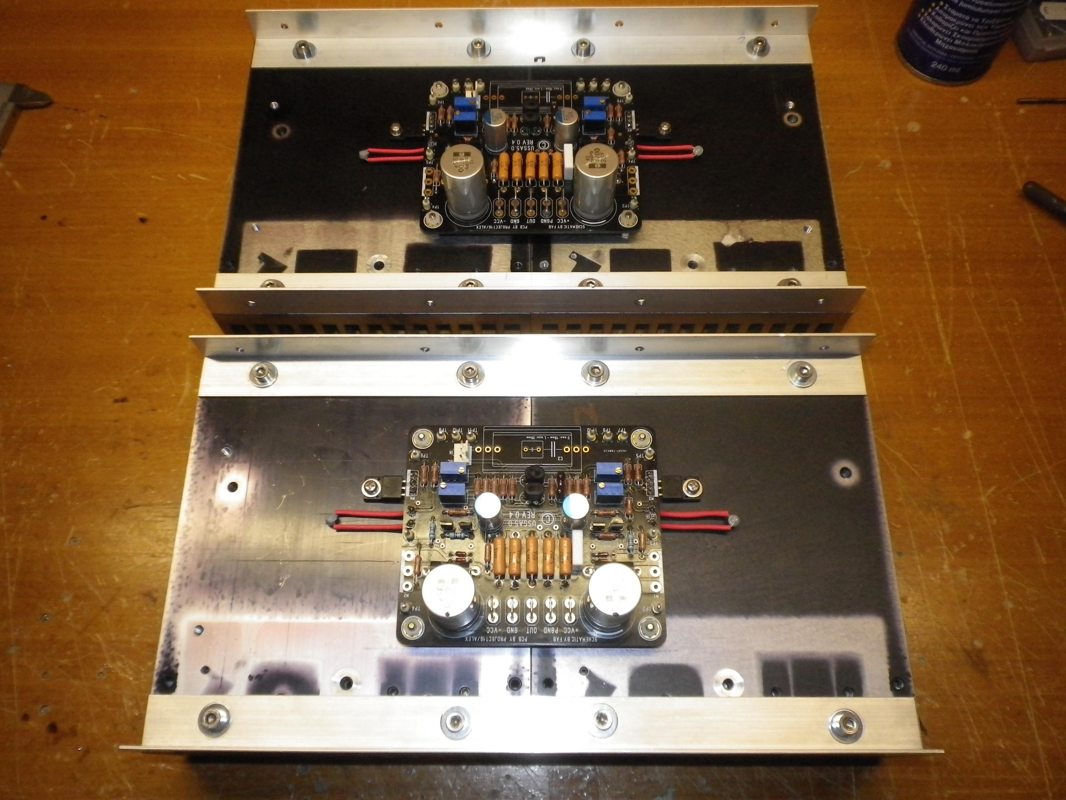

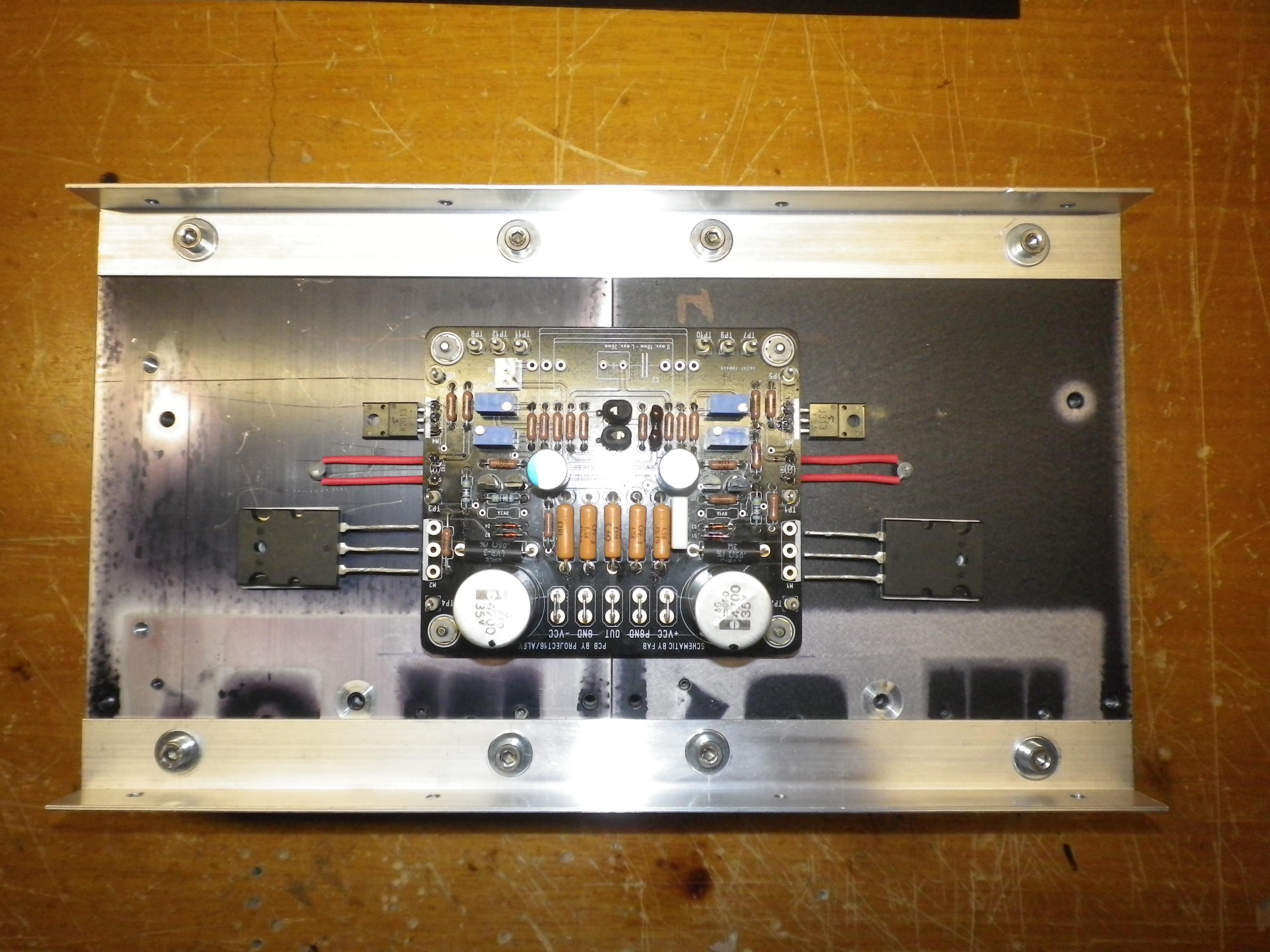

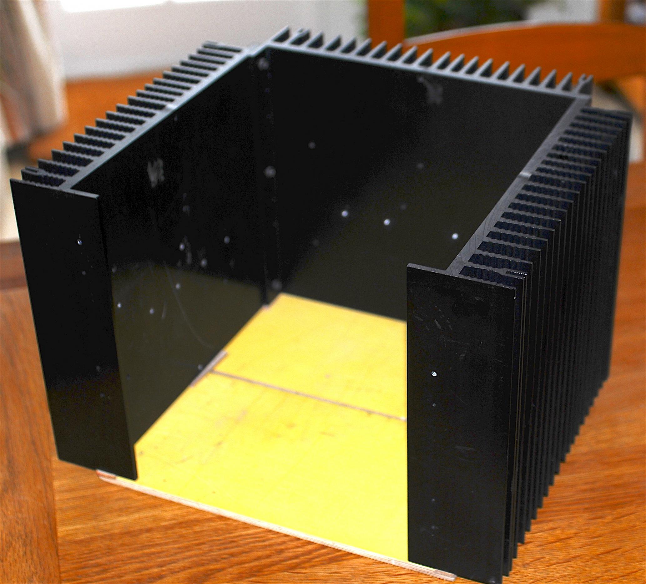

Will be taking a similar route! I already have x2 of these Krell Clone chassis! Was thinking of using two heatsinks with a 5mm top, bottom and rear panel and 11mm front panel. These should make x3 stereo amps
The individual sinks are 228mm x 250mm net of flanges and are 40mm fins + baseplate & top from 8mm plate). I would also use a 10mm heat spreader.
Is this enough cooling for one board per heatsink? I am reposting a pic as it now stands with x3 such heatsinks.
Thanks.
On re-reading the above quote I found a couple of measurement typos! I have corrected them in red in the quote above. As it was well outside the 30min editing opportunity I think that this is the best way to correct the post and also to get some response.
Many thanks 🙂
brianco,
Looks like you have enough heat sink there. The area you have with 228mm x 250mm heat sink is larger than the 300mm x 165mm heat sink of the 4U Deluxe chassis available at the diyA store.
The fins also have nice little corrugations, helping increase the fin surface area and heat dissipation.

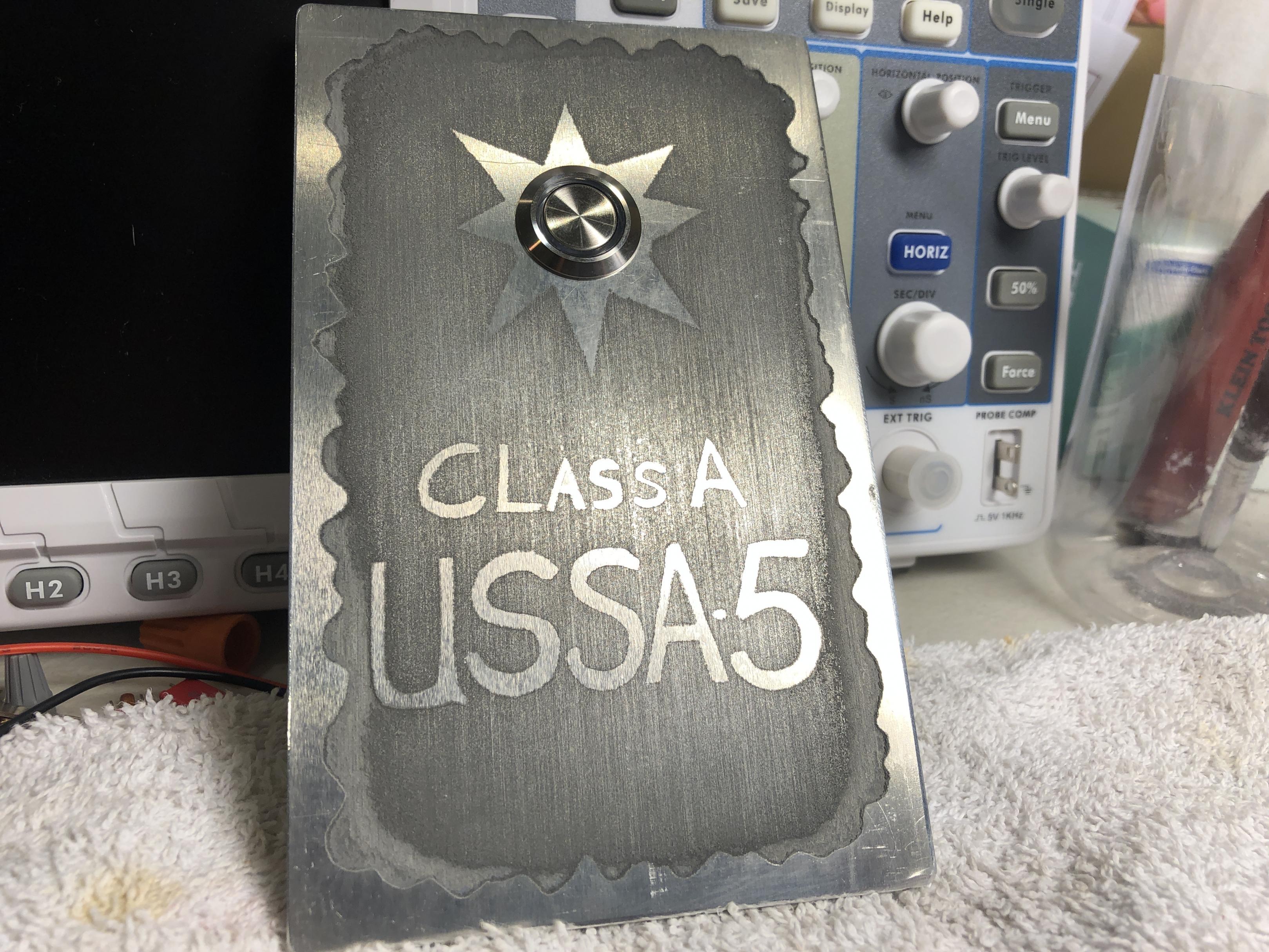

Nice DIY badge Vunce. By the time you've completed the chassis work, you will have a unique looking amp 🙂
After several attempts etching, I have a front badge for the USSA5, Yahoo!!
Mmmm i like it Vunce .. looks vintage ...🙂😉
If one day your USSA gives up, this badge can be used as a tombstone! 😀After several attempts etching, I have a front badge for the USSA5, Yahoo!!
