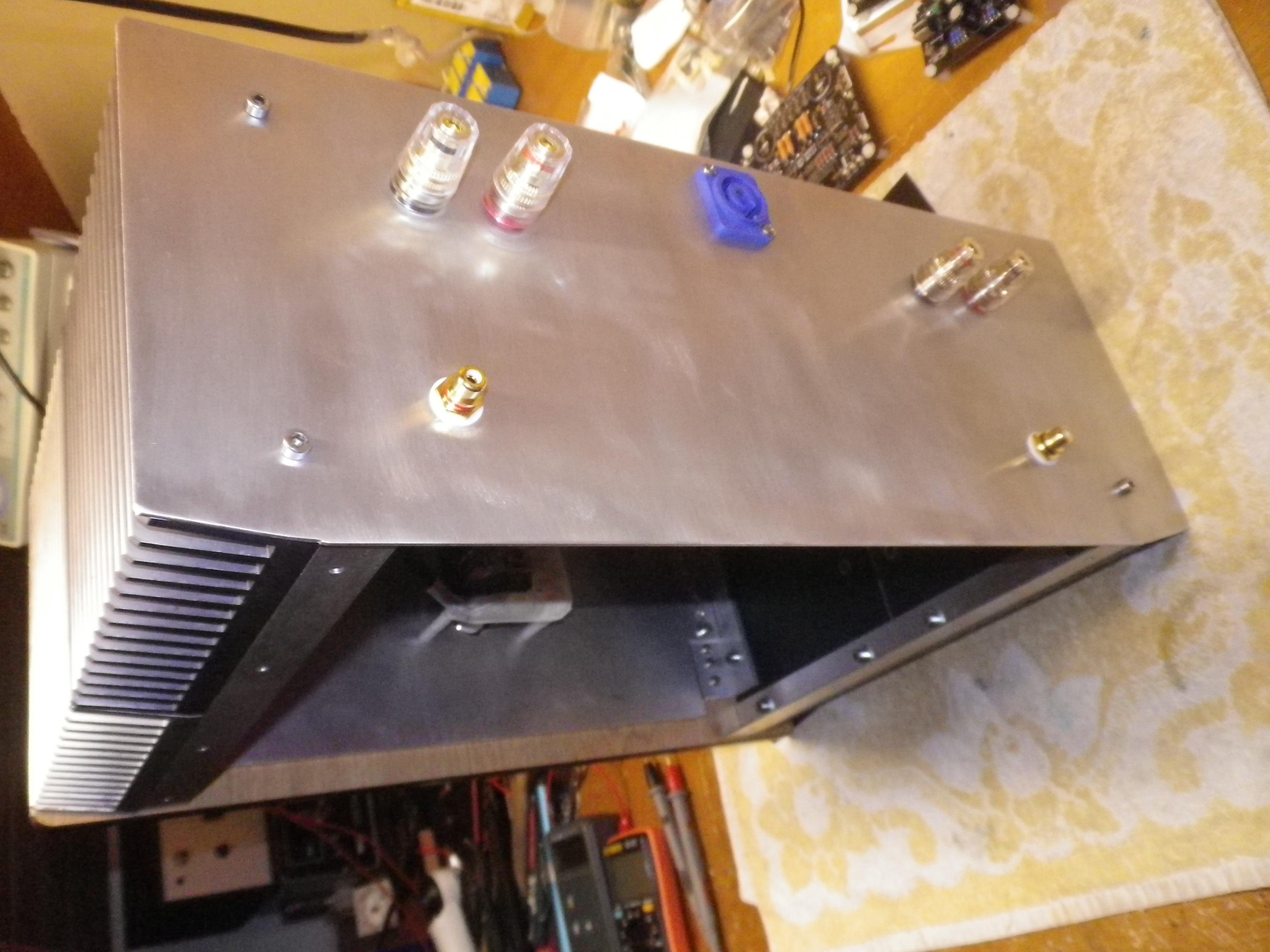

There is a lot of volume inside the chassis, but with only 10.5” x 11.5” workable floor space, components get tight quickly.
@Harry3,
Yes, the only way to get a dual mono psu with capMx to fit in the limited space was to utilize the SLB. Counting the heatsink fins the overall footprint is nearly 17” wide, I didn’t want to go any wider.

Hi X,
I pick them up from eBay, I believed they were reclaimed heatsinks from solar power inverters. It’s deceiving in the pictures, it does look like a cube but if you looked at the footprint from the top it’s definitely wider than deep. (17” x 12.5”)

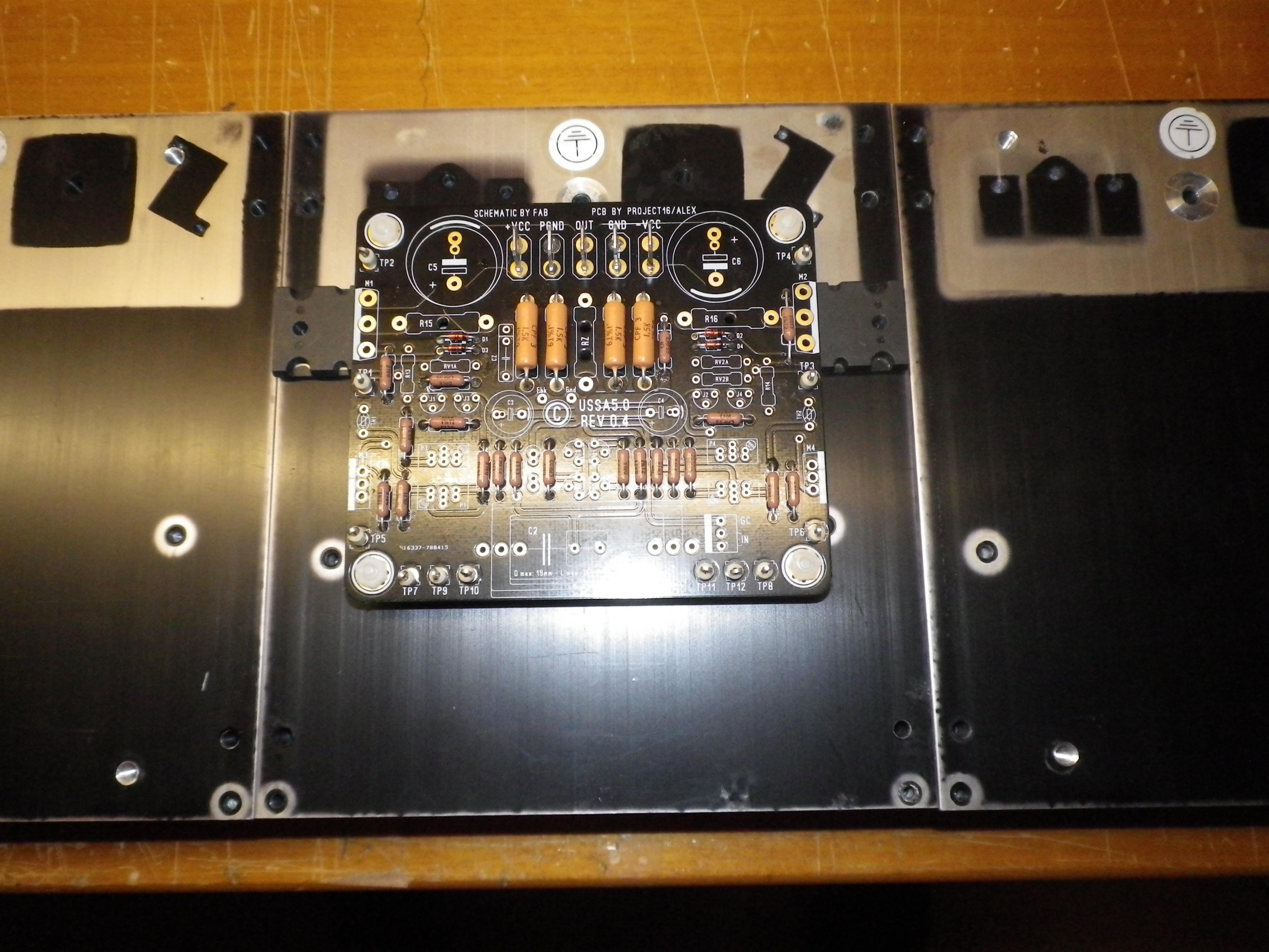

Will be taking a similar route! I already have x2 of these Krell Clone chassis! Was thinking of using two heatsinks with a 5mm top, bottom and rear panel and 11mm front panel. These should make x3 stereo amps
The individual sinks are 220mm x 24mm net of flanges and are 40mm fins + baseplate (8mm plate).
Is this enough cooling for one board per heatsink?
Thanks.

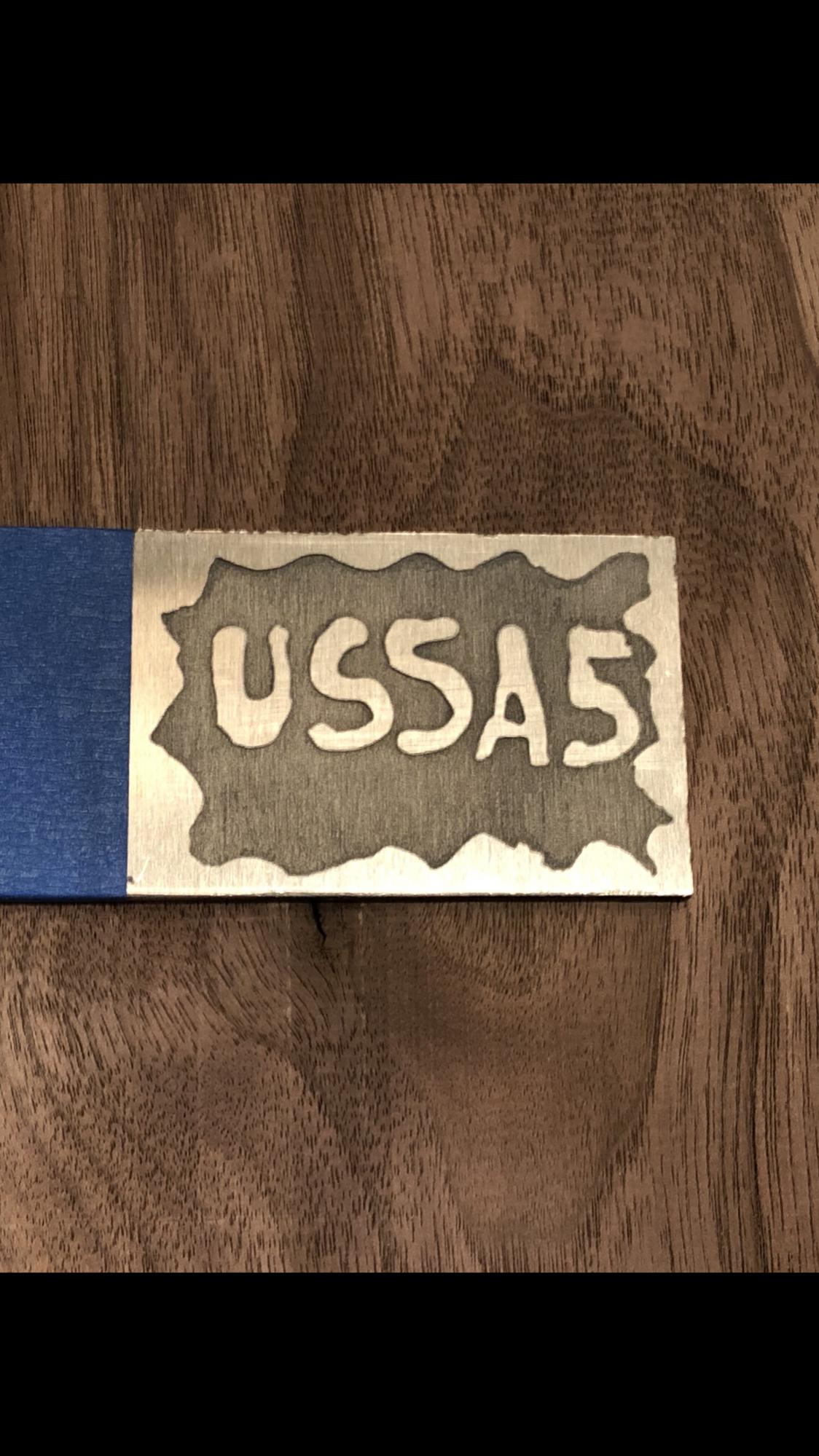

I’ve been working on the finishing details for my USSA5 amp and took a shot at salt water aluminum etching. I think this technique has real potential for the look I’m going for.
With some real stencil work the name plate should look pretty cool 😎

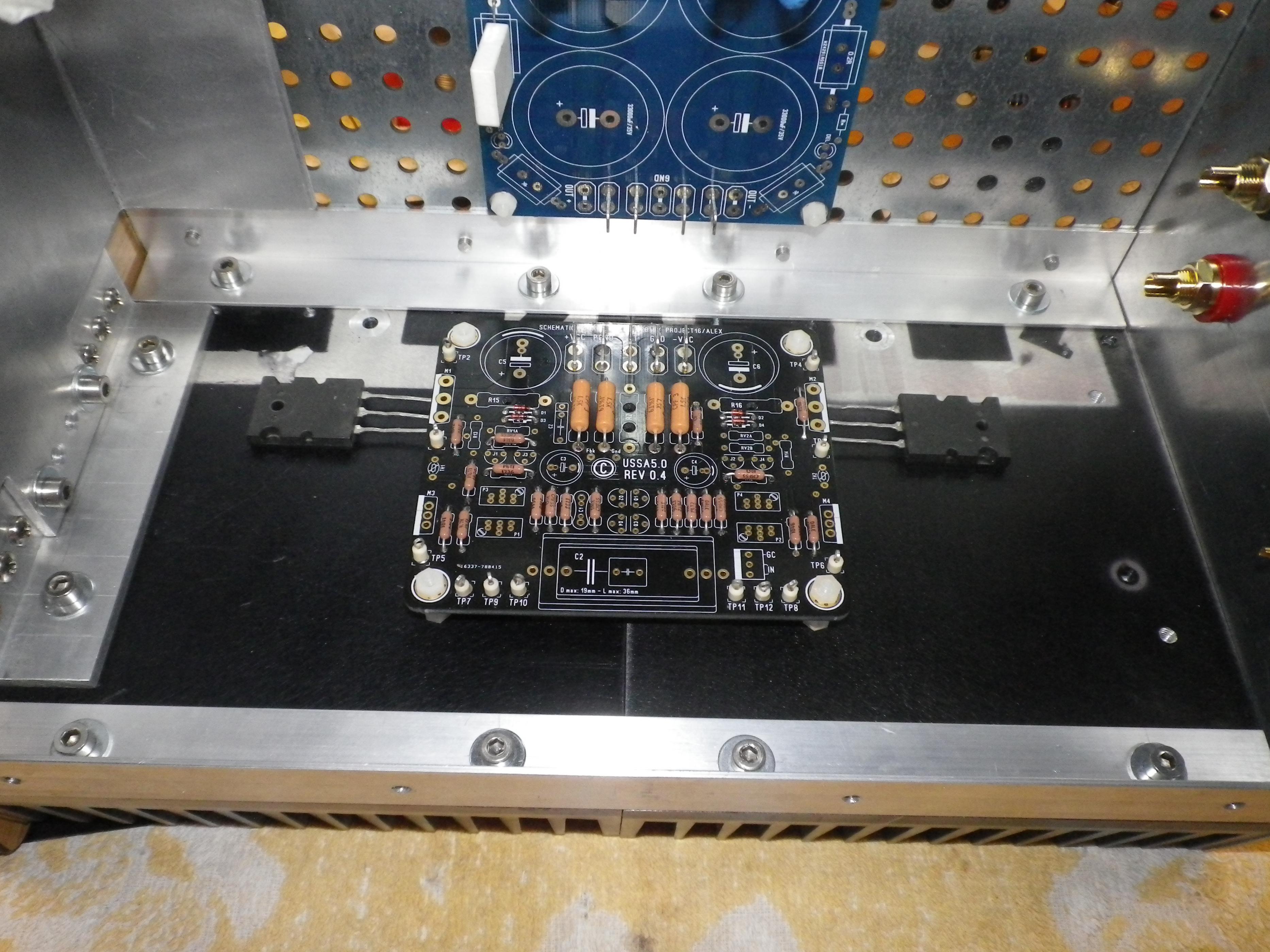

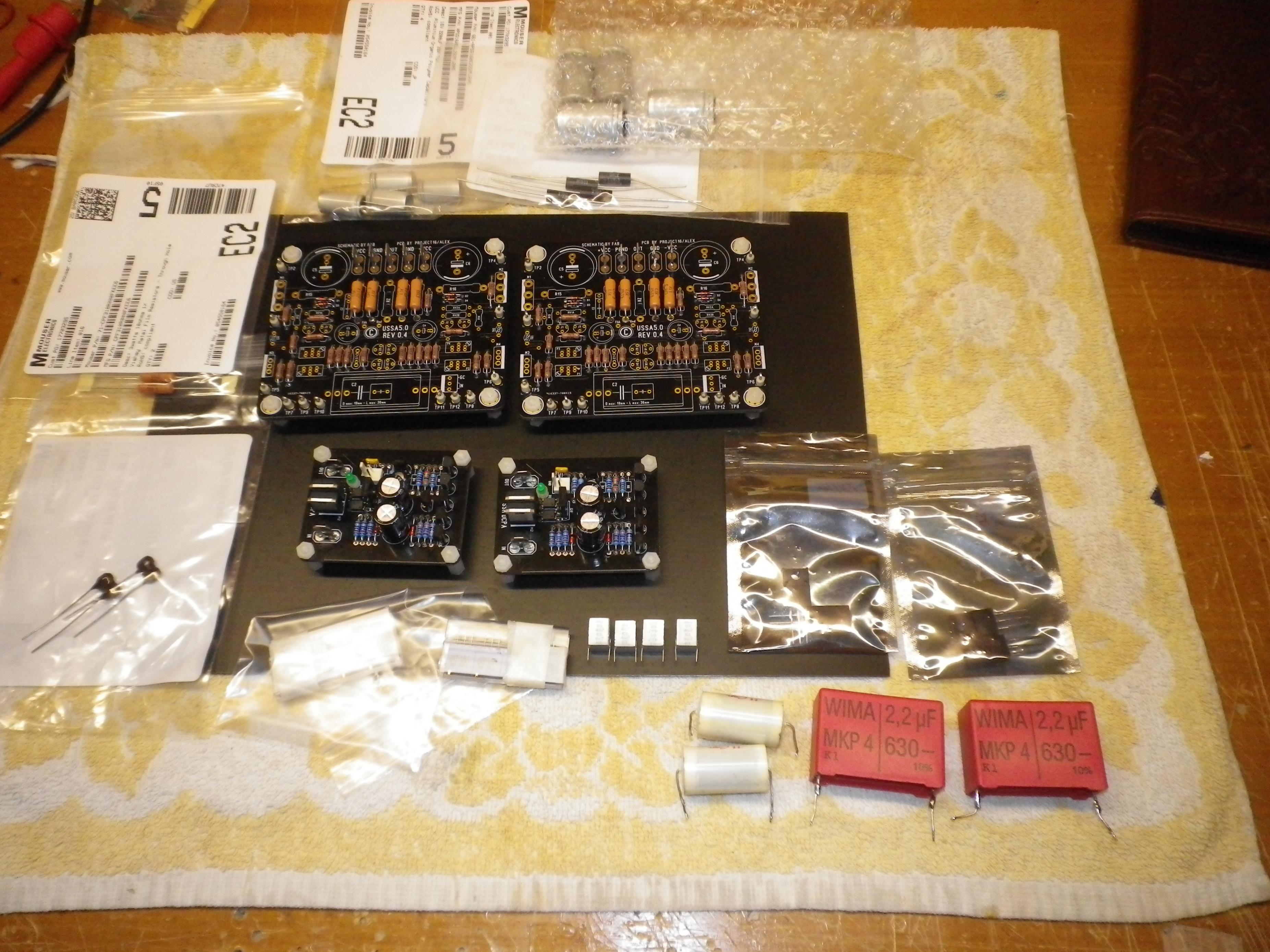

Hello to everyone...
Ι would like your opinion about the mosfets mounting on the heatsink.
in case if needed to add another module heatsink to reach the length 41cm X 15cm x 4 cm, you see the temperature in Greece in the summer it reaches 33 C.. room temp
Ιn the first photo, it is too long to mount the mosfets? the drivers stays as they are?
I don't like to squeeze the legs mosfets as the second photo ...
Μy priority is to not use it at all the C1..

@Zman01, we do have pretty good main supply from the PowerCompany here in Singapore.
@Nikosokey, Sorry for the confusion. I loaded the SLB with a resistive load and adjust for 1.4A. Because due to double decking SLB, i got no way to adjust the voltage once everything is installed.
My Ussa5 is running at 1.3A.
This chassis has a smaller heatsink than the Conrads, its temp is 55 degC constant, after an hour's operation. On the Conrads, 350x150, temp is 50 degC.
My ambient temp is 23 DegC air conditioned environment.
