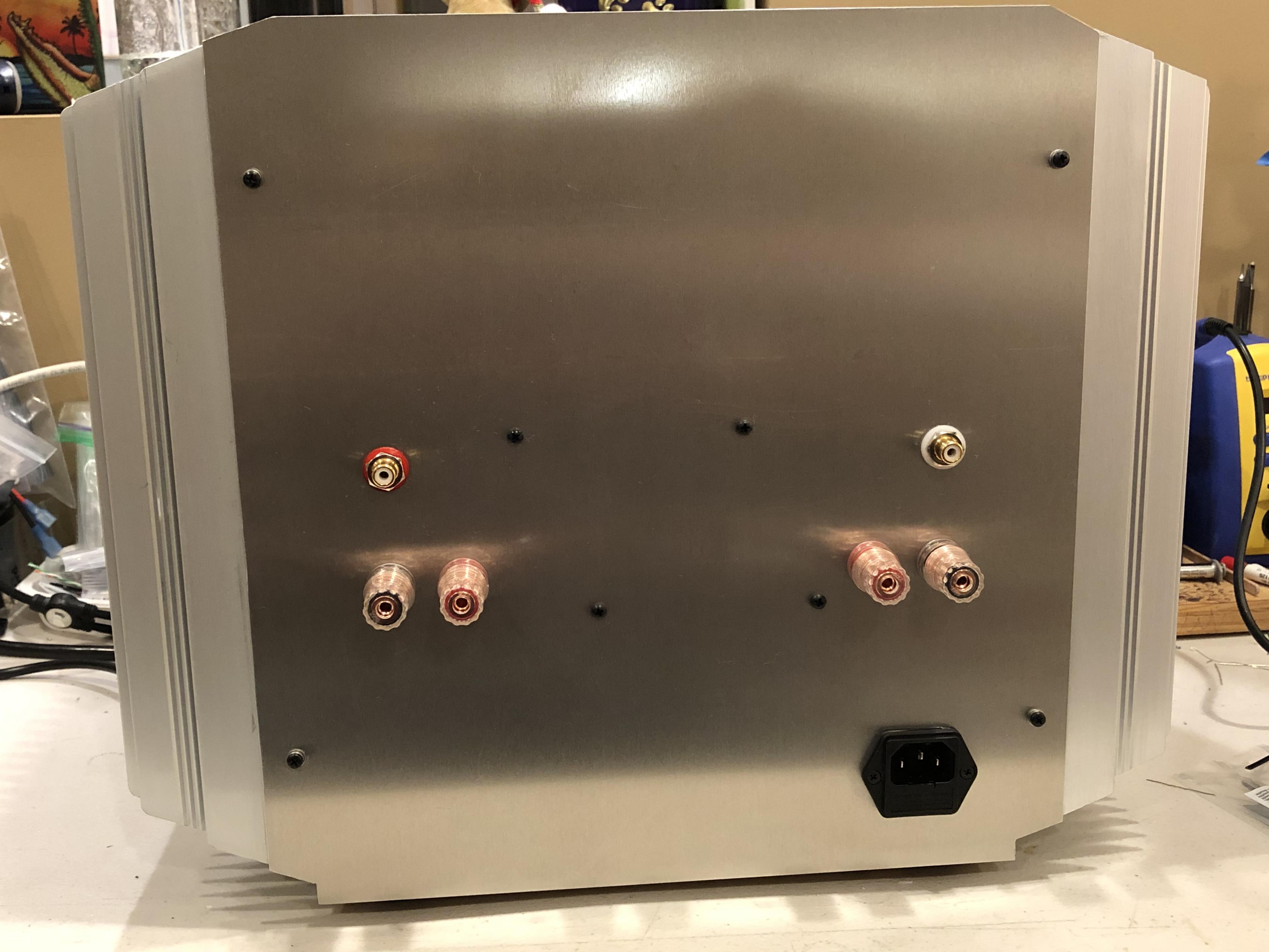

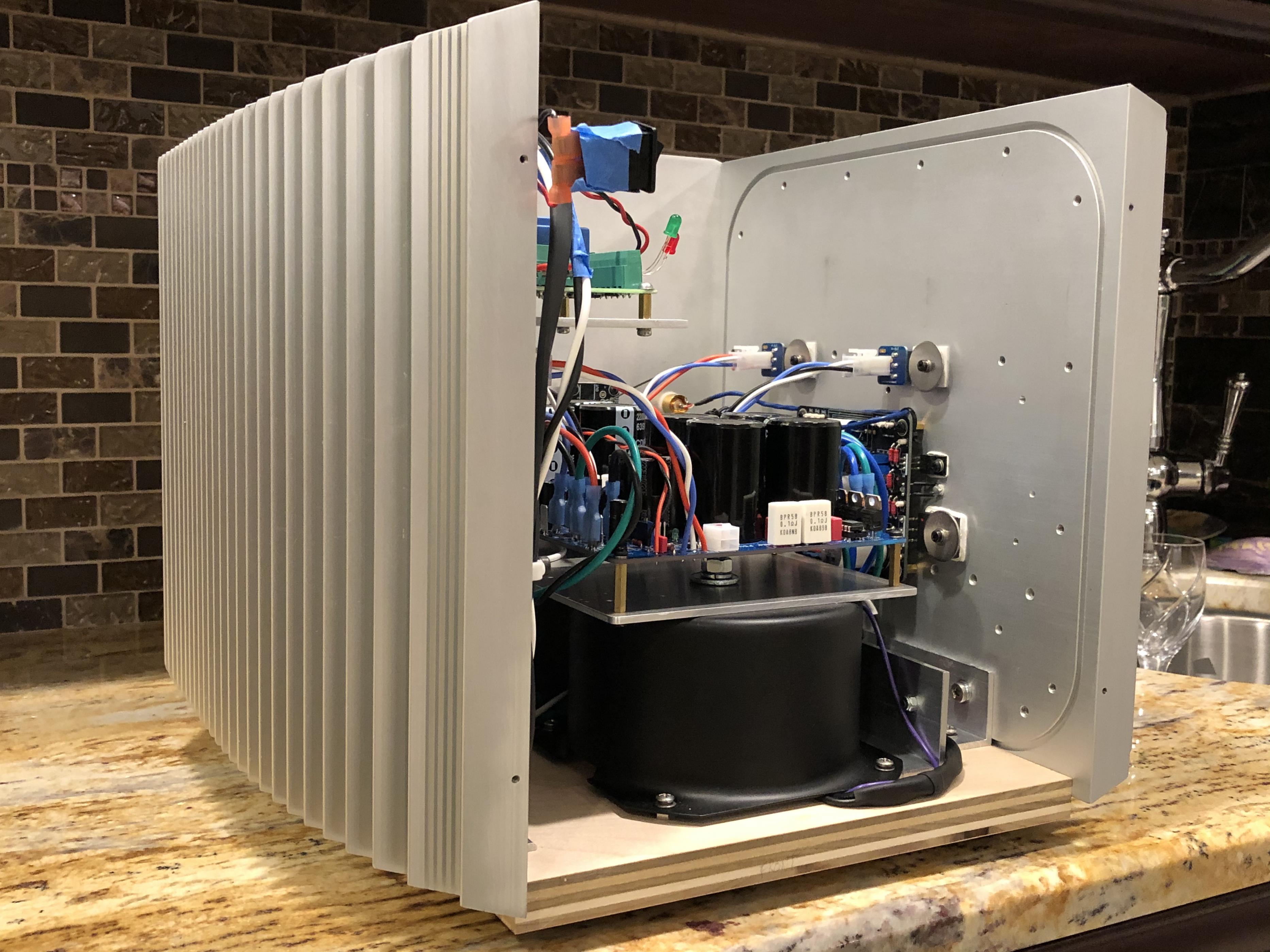

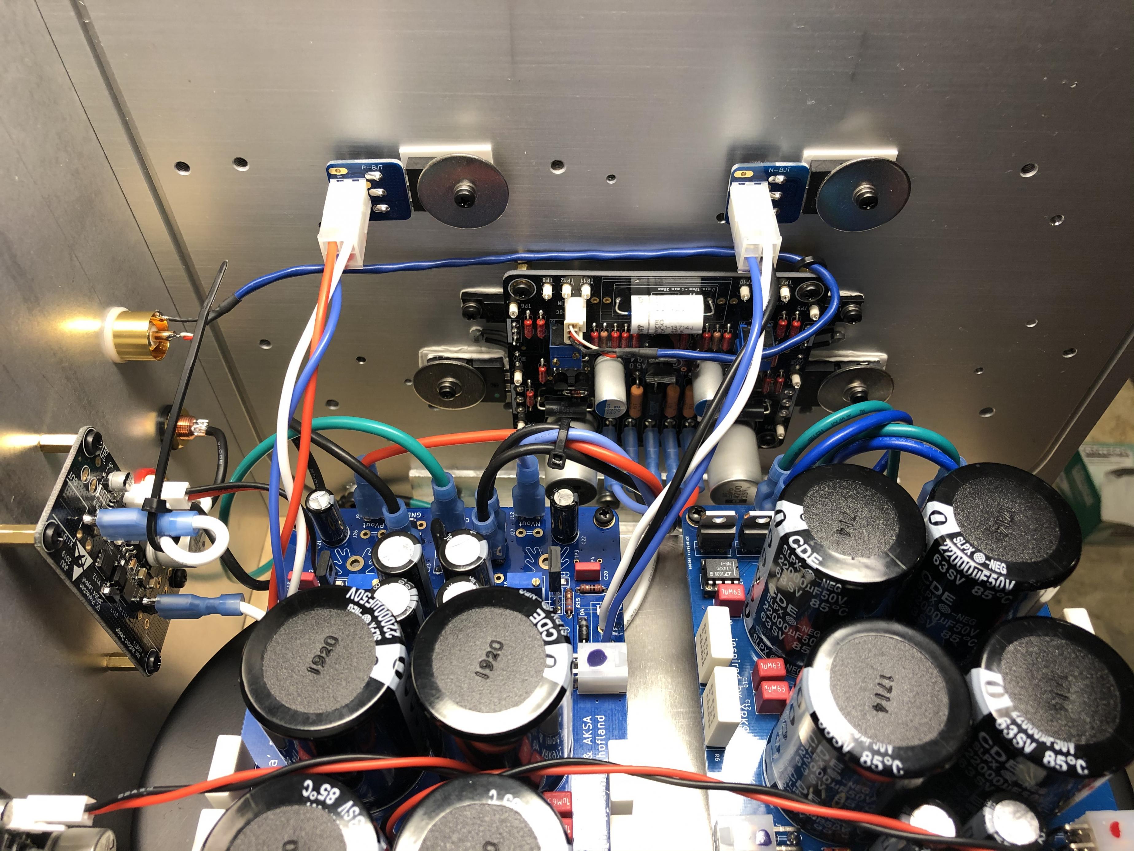

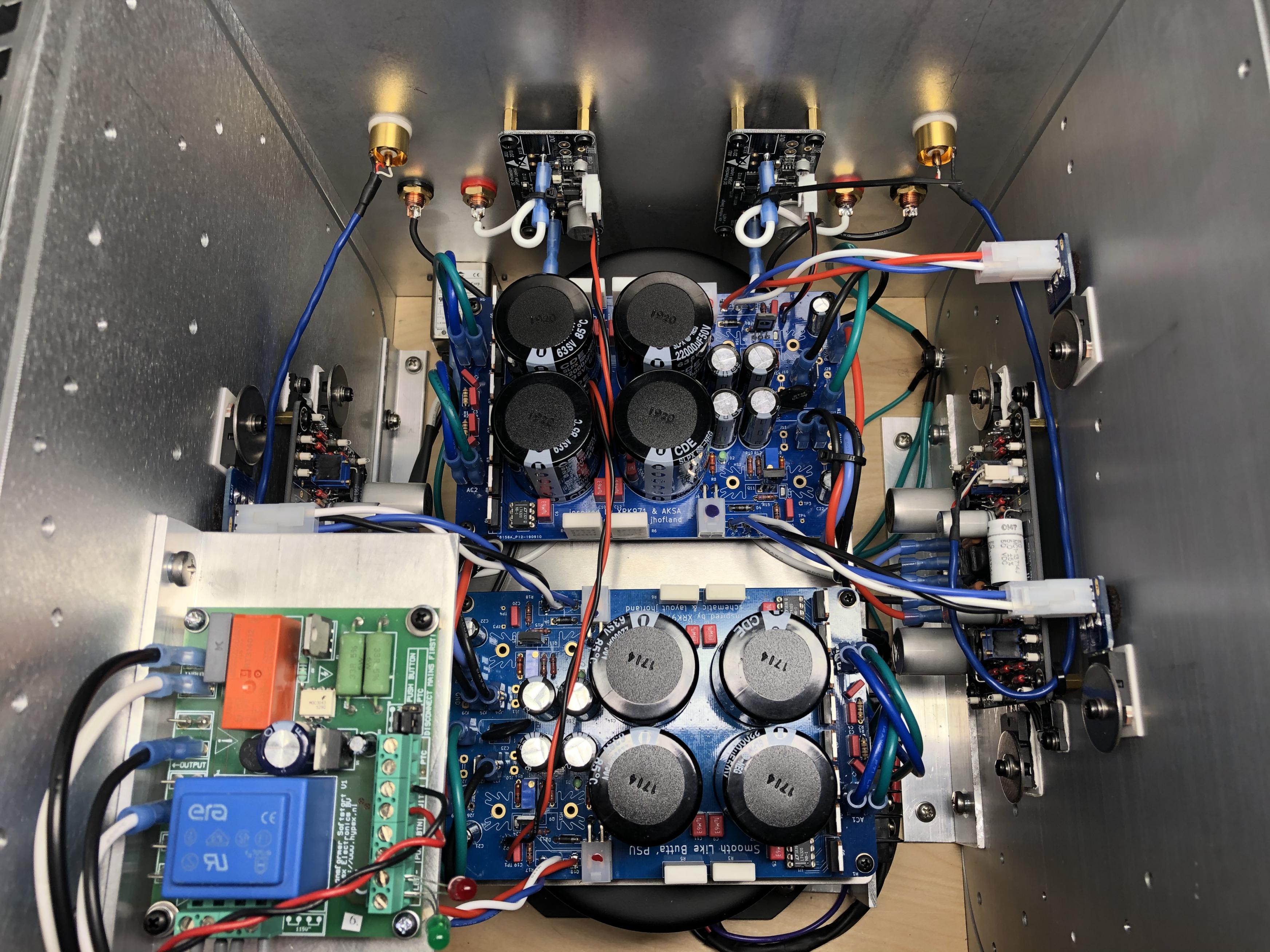

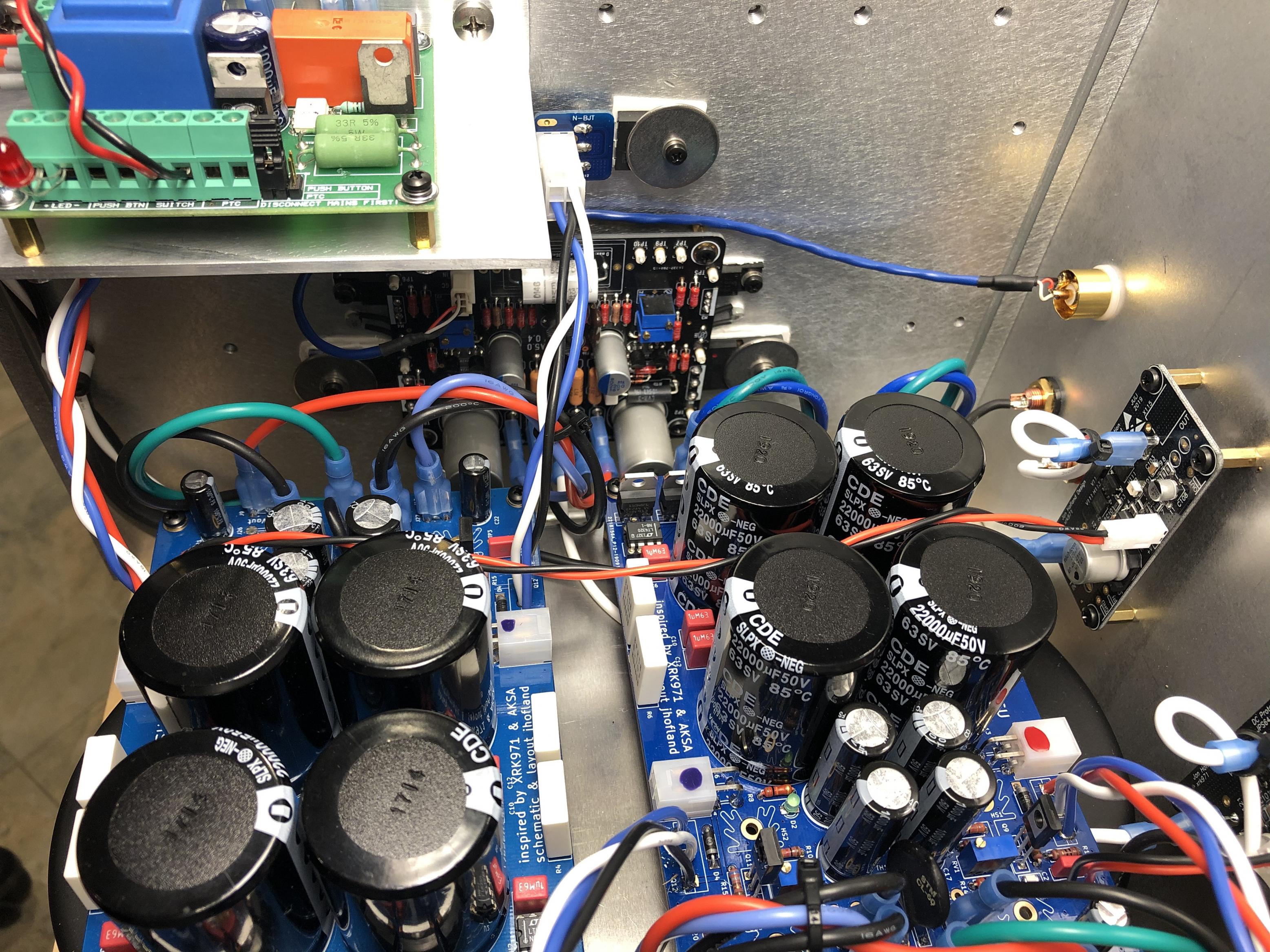

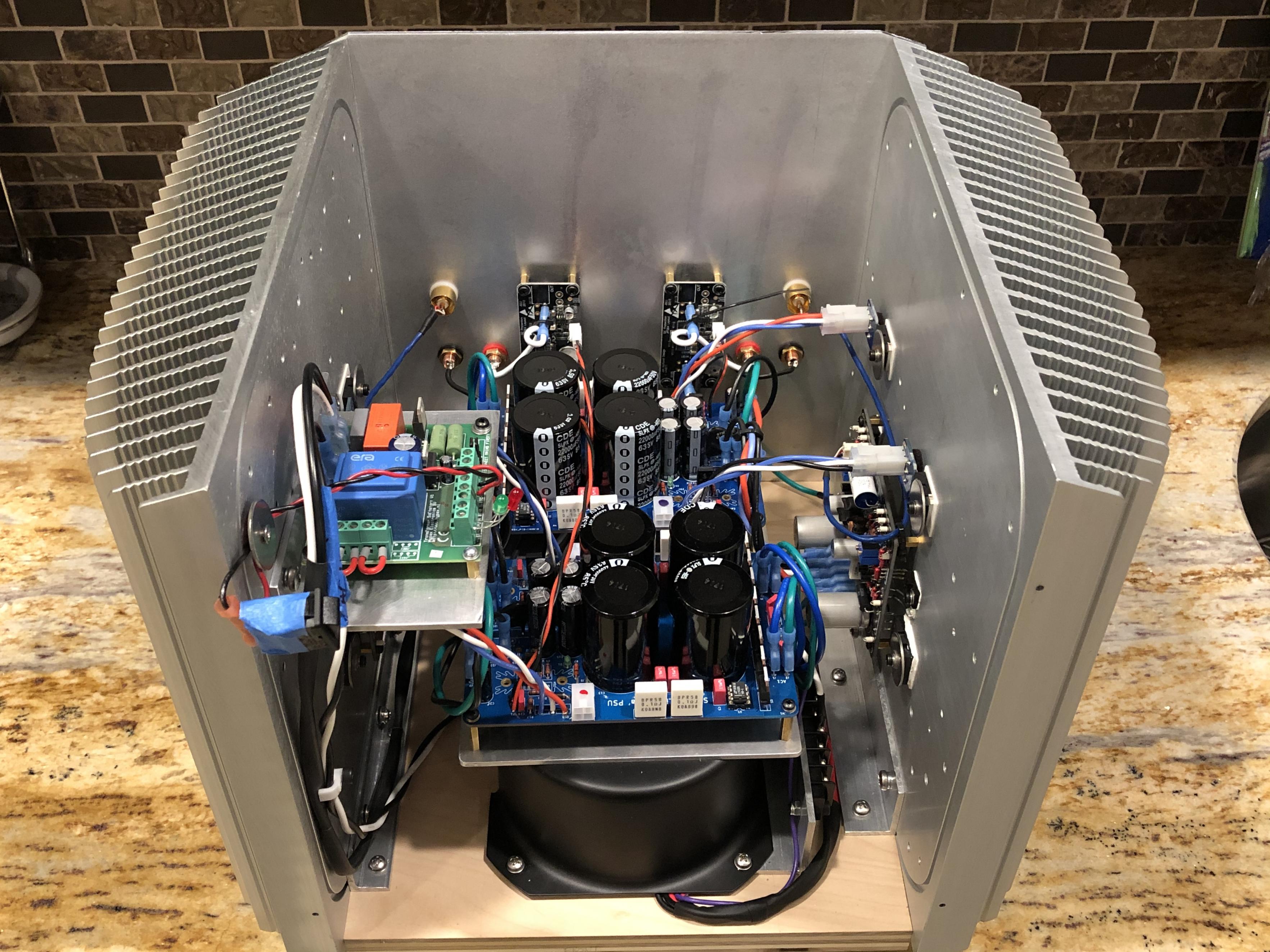

USSA-5 Amplifier is Born!!
It’s been almost 1 year of possessing Fab’s USSA5 amplifier boards and finally I have it built and singing away!! This project snowballed from a basic single CRC psu to a full blown dual mono SLB psu, softstart circuit and solid state relay speaker DC Protection/delay boards. Actually, my delaying this build improved the overall outcome because the development of the SLB and SSR boards happened during that time.
Assembling the amplifier boards and step by step adjustments along the way was made extremely easy with Fab’s well documented build guide. Thanks Fab for your support during this process. The toughest part about this build was the chassis layout and fabrication, it just kept taking longer than anticipated . I’m still not 100% complete, the top and front panels will be made from wood. I like the contrast of the aluminum with some warm wood tones.
I’ve had the USSA5 in the main system for just a couple of hours and first impressions are very good! With 99dB efficient speakers there is absolutely zero noise of any kind, even with my ear pressed up to the speaker grill. The amp also has a very powerful presentation, seemingly more than 25wpc. Maybe the slight increase in voltage (27vdc@1.3A) has some effect. The heatsinks are massive so the increased voltage is handled without a problem.
Thank you ALL for the tips help along this journey The journey is not completed, but I can enjoy the USSA5 as the final details get buttoned up. Time to let the amp settle in and ENJOY

Congratulations Vunce on completing the build.
A project long time in waiting, but looks like it was worthwhile given the end result.
Good work on your DIY chassis - the big heat-sinks give you plenty of thermal headroom plus space inside. Look forward to more updates on your listening impressions once you have more hours of play time, and also on the final look of your amp.
