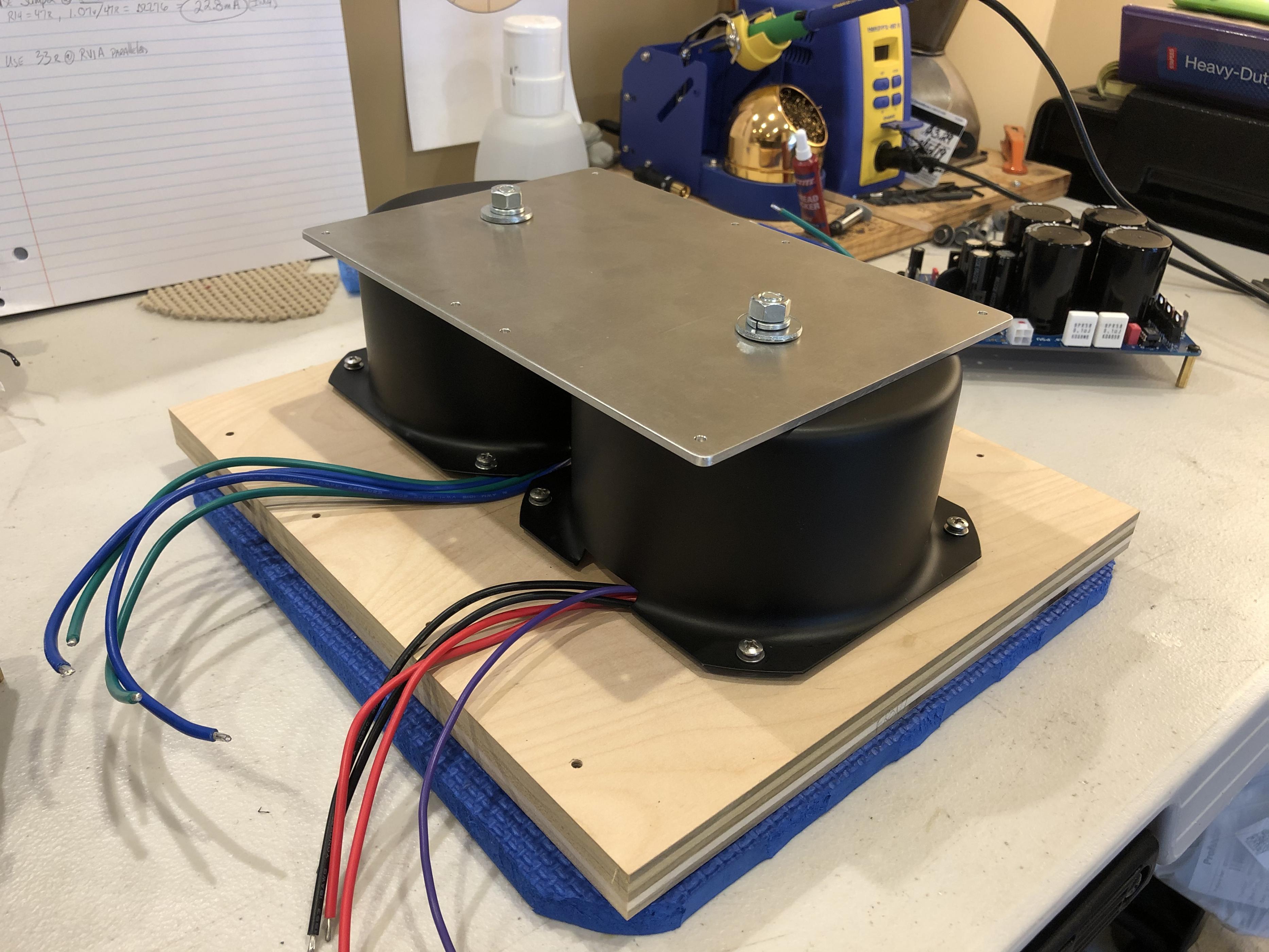

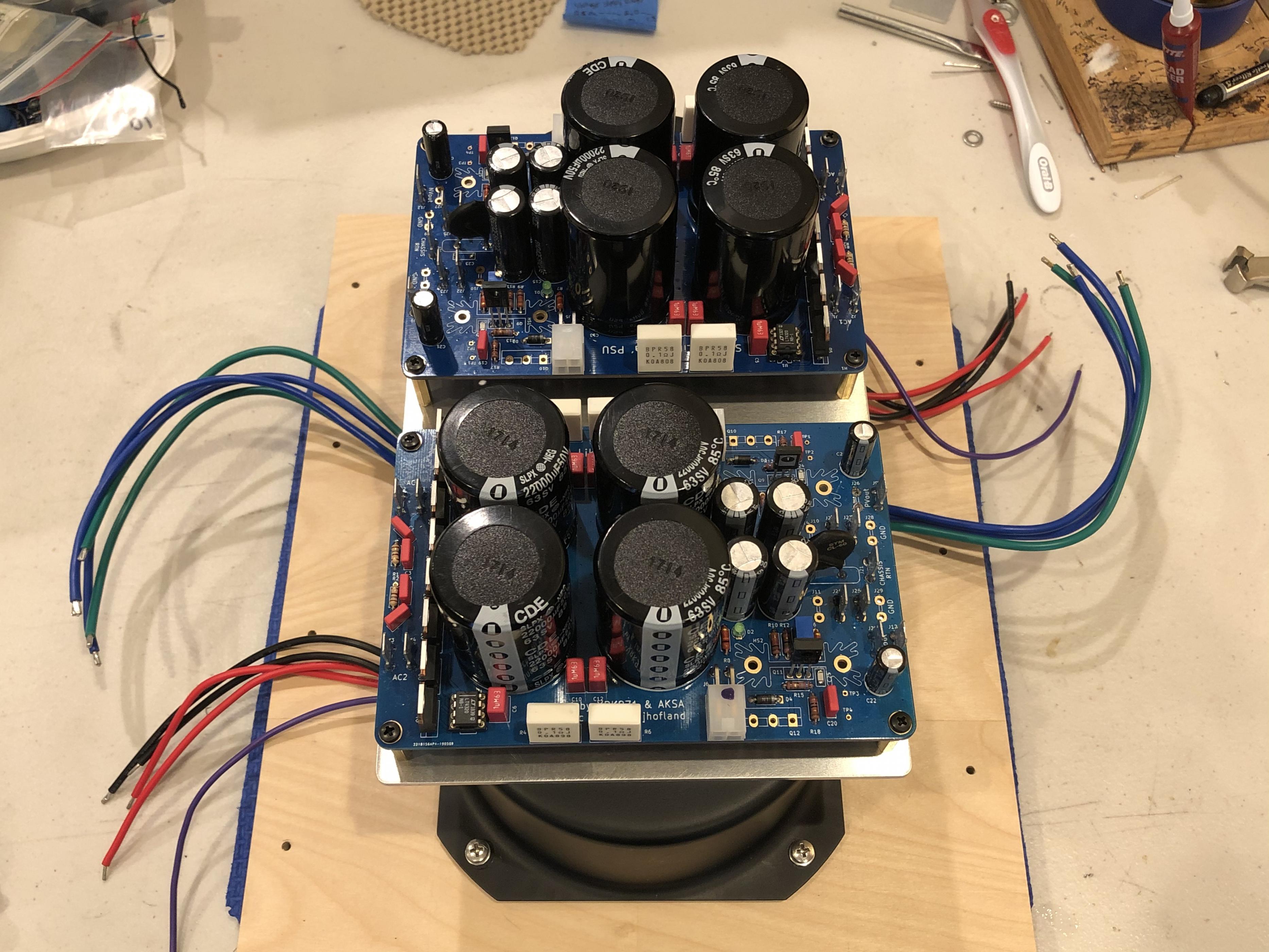

A scrap metal yard was closing down to make way for a free way. I offered them $70 for copper off cuts, that they had thrown in a box. They agreed thinking that I would not be able to lift everything that was in the box. The copper was in my car before they could blink. 😀😀😀
I had some time for more progress on my USSA5 build.
This is the amp base configuration.
Dual mono setup! (Thanks Greg 🙄)
