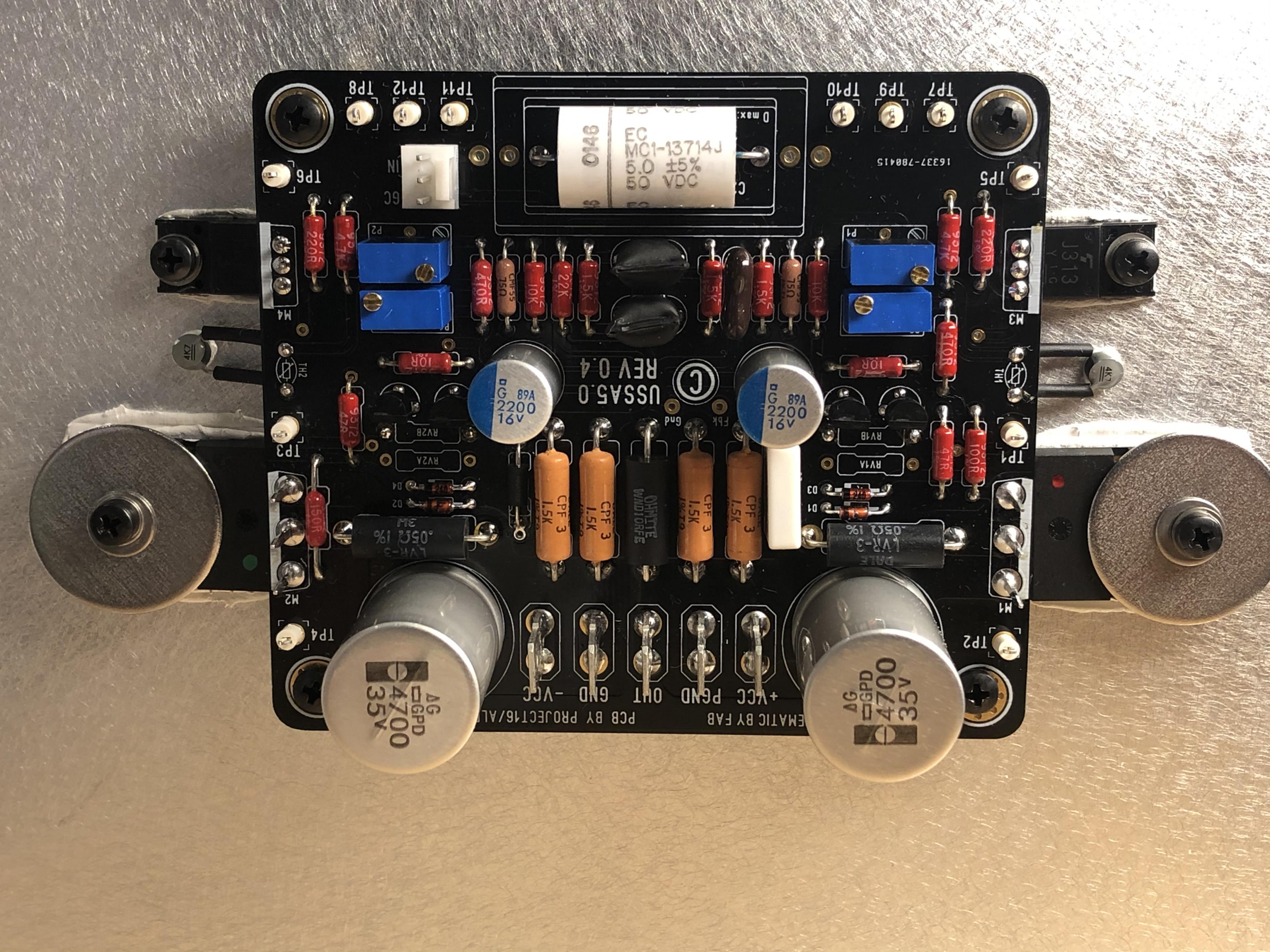

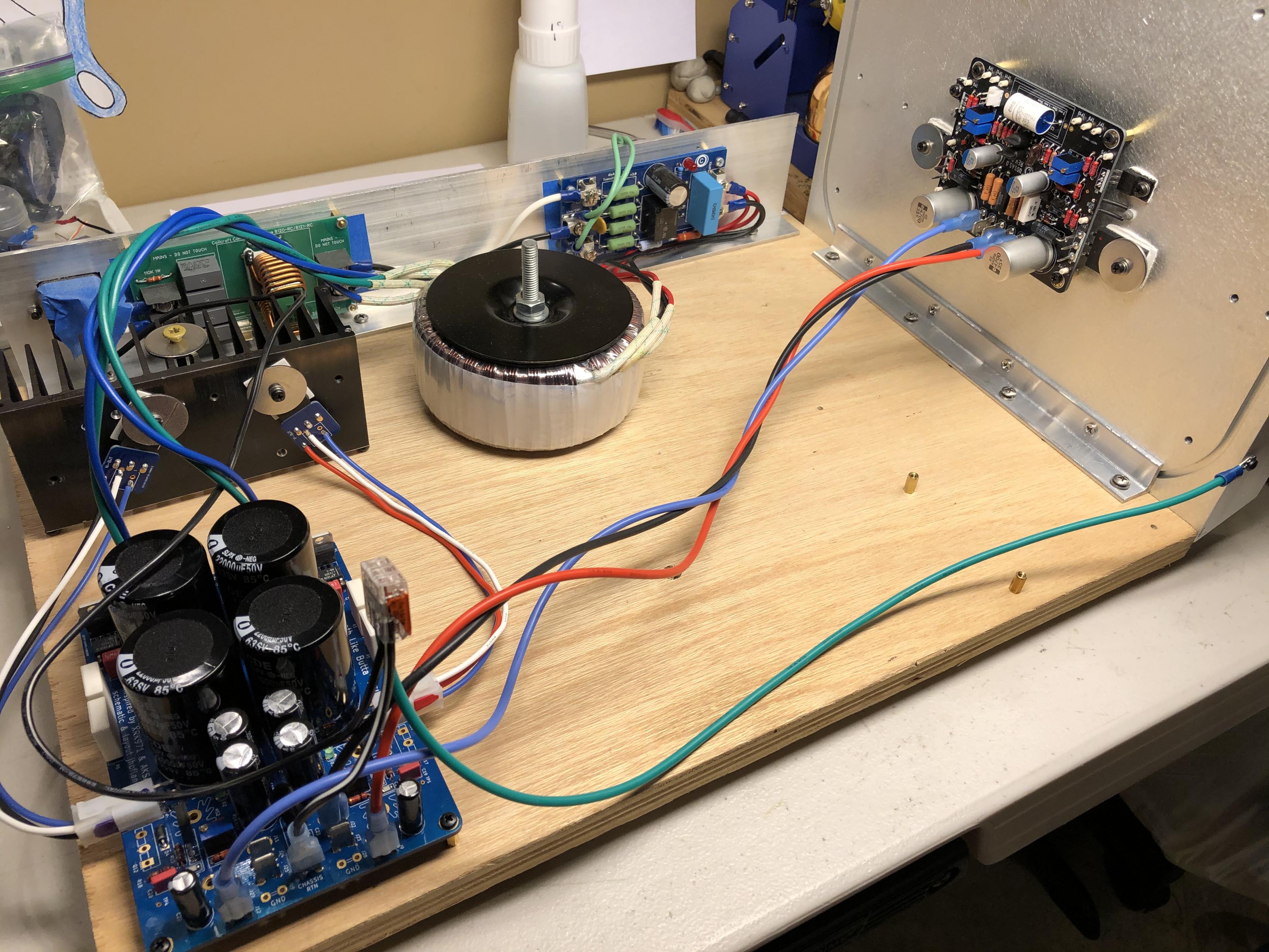

Thanks for the encouragement Fellas! I was able to make some more progress today 🙂
All previous measurements checked out fine, now my test bed is set up and ready for full power to set Mosfet bias and VGS measurements.
Question: Should the USSA5 PGND and GND tabs tie together at the psu GND tab?
Thanks,
Vunce

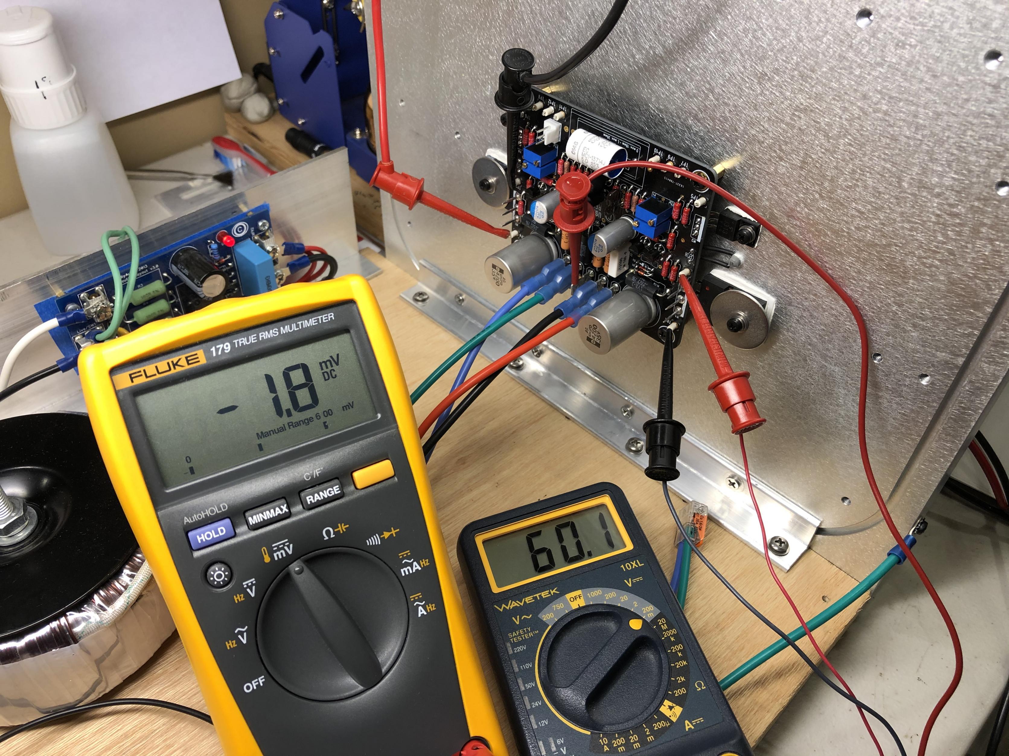

Powered up!
Running approximately 2mV offset and 60mV bias after 30 minutes.
RV1B = 100R
RV2B = 47R
These are mounted on the backside of the pcb.

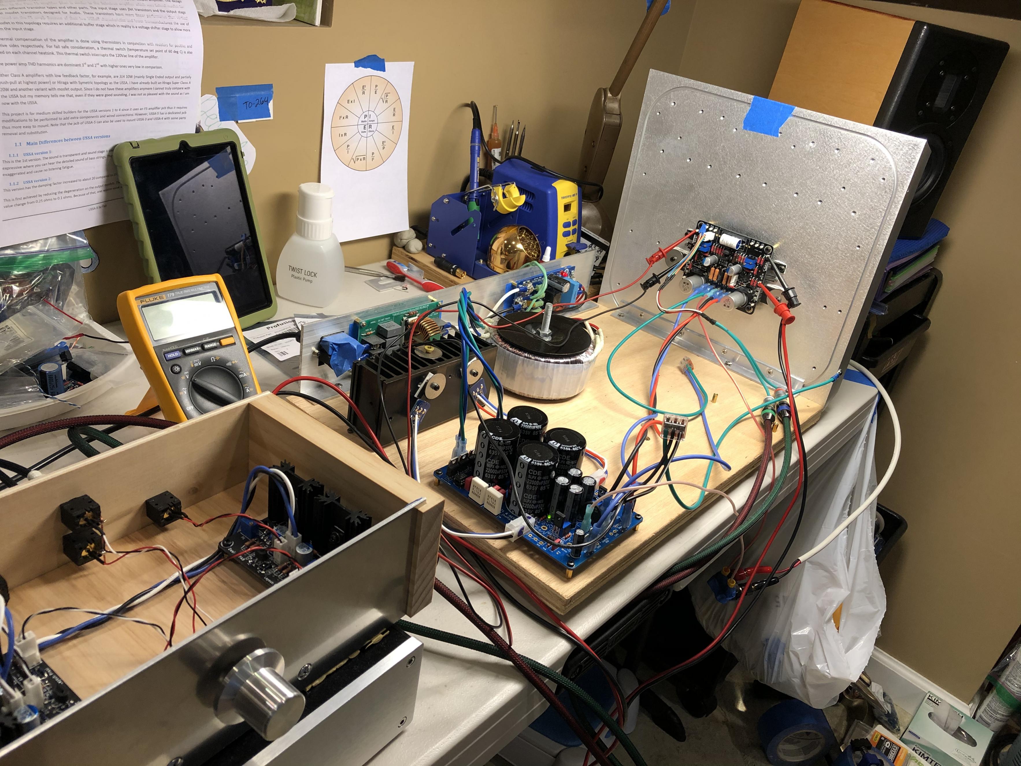

Hi Fab,
Success!! A single channel USSA5 is singing away 😀
Here are some of the vitals: Antek AN-2222 trafo, SLB psu, 26vdc @ 1.2A bias. The heatsinks are massive, there is margin to increase bias if needed. After 60 minutes the HS reaches 42°C
I’m happy to report there is an absolutely silent background at idle with this combination, also no power up/down thumps or noises. And if you look closely, it’s driven by a USSPA2 pre 😉
Next step will be to get the second heatsink prepped for mounting the USSA5 board. Final build will have a single SLB and Antek AS-4222 transformer.

Hi Vunce
Congratulations and you are welcome!
With the SLB you should have a clean PSU. Also, the AS transformer is quite good for the buck.You have quite a huge heatsink 😛 if you have 4 ohms speakers you can increase bias a little furthermore to increase the class A power envelope.
For the calculations, IM3= VGSP / (47+ RV1A ll RV1B) and similarly for IM4.
Good luck for the second channel.
Fab

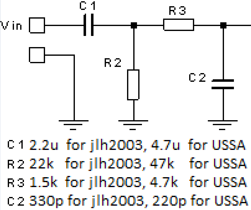

hello i am planing to direcly feeding ussa from a preamplifier, i think (C2 R1) at the input section is high pass filter. Cut of frequency is around 1.5 Hz i guess. I saw simillar topology in different amplifiers (exp jlh2003) before but i do not know what they used for and what if we do not used it?

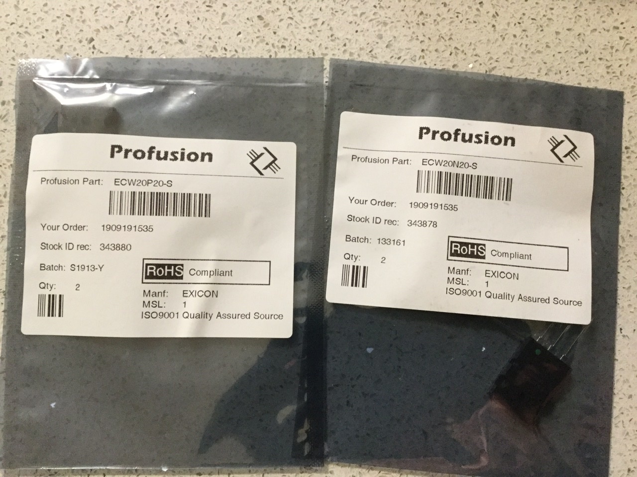

I got mail from the UK! The output stage laterals have arrived. I think I now have all the parts needed for the amp boards. I have a few options to consider for the power supply and chassis/heatsinks.
