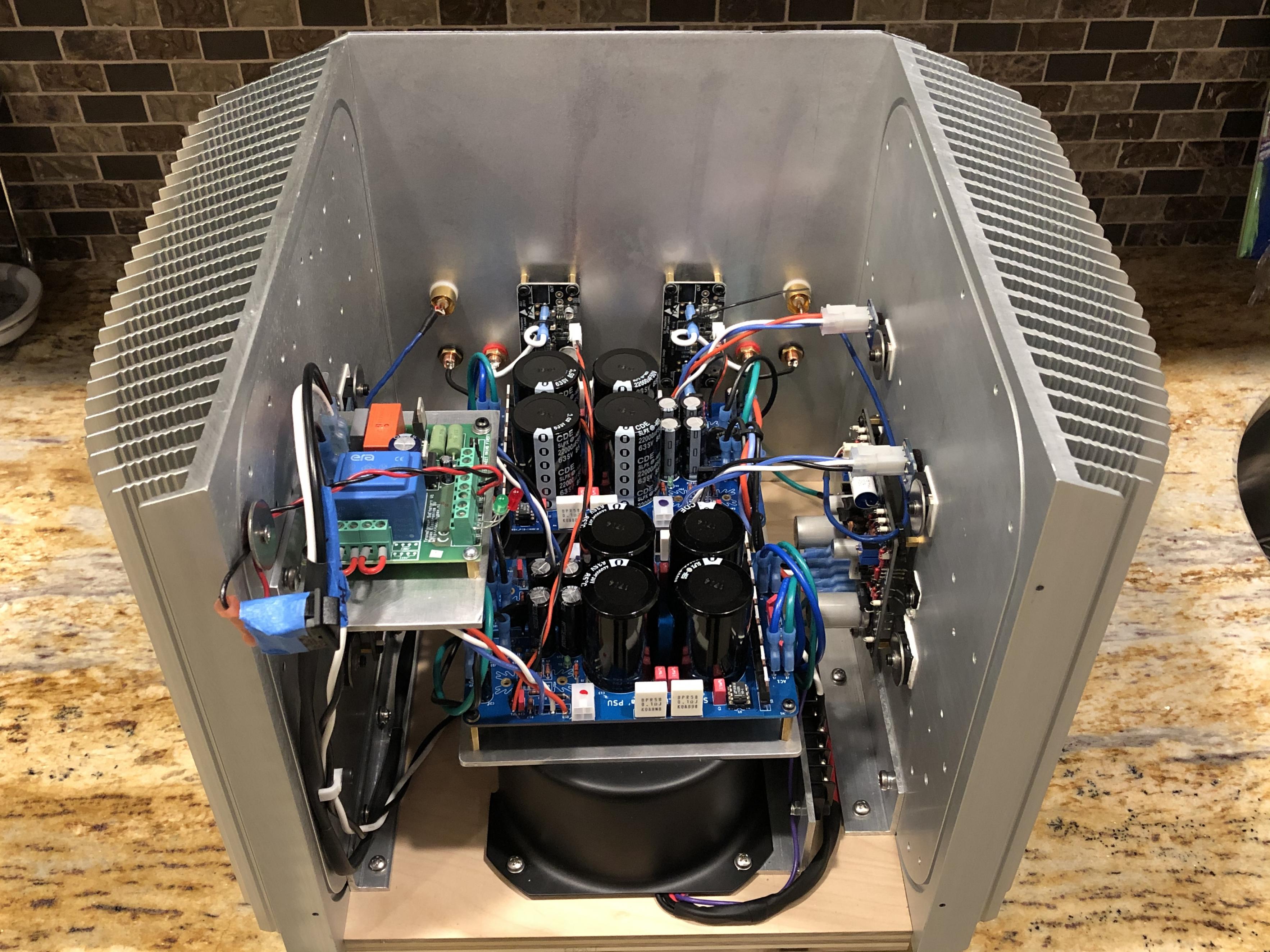

Congratulations - nice build you got there. Understand that your transformers and SLB are in stacked configuration (one on top of the other)?
Hi zman01,
Yes, Both transformer(300VA) and SLB are stacked up onto one another due to my compact chassis.
......Thank you ALL for the tips and help along this journey 🙂 The journey is not completed, but I can enjoy the USSA5 as the final details get buttoned up. Time to let the amp settle in and ENJOY 😀

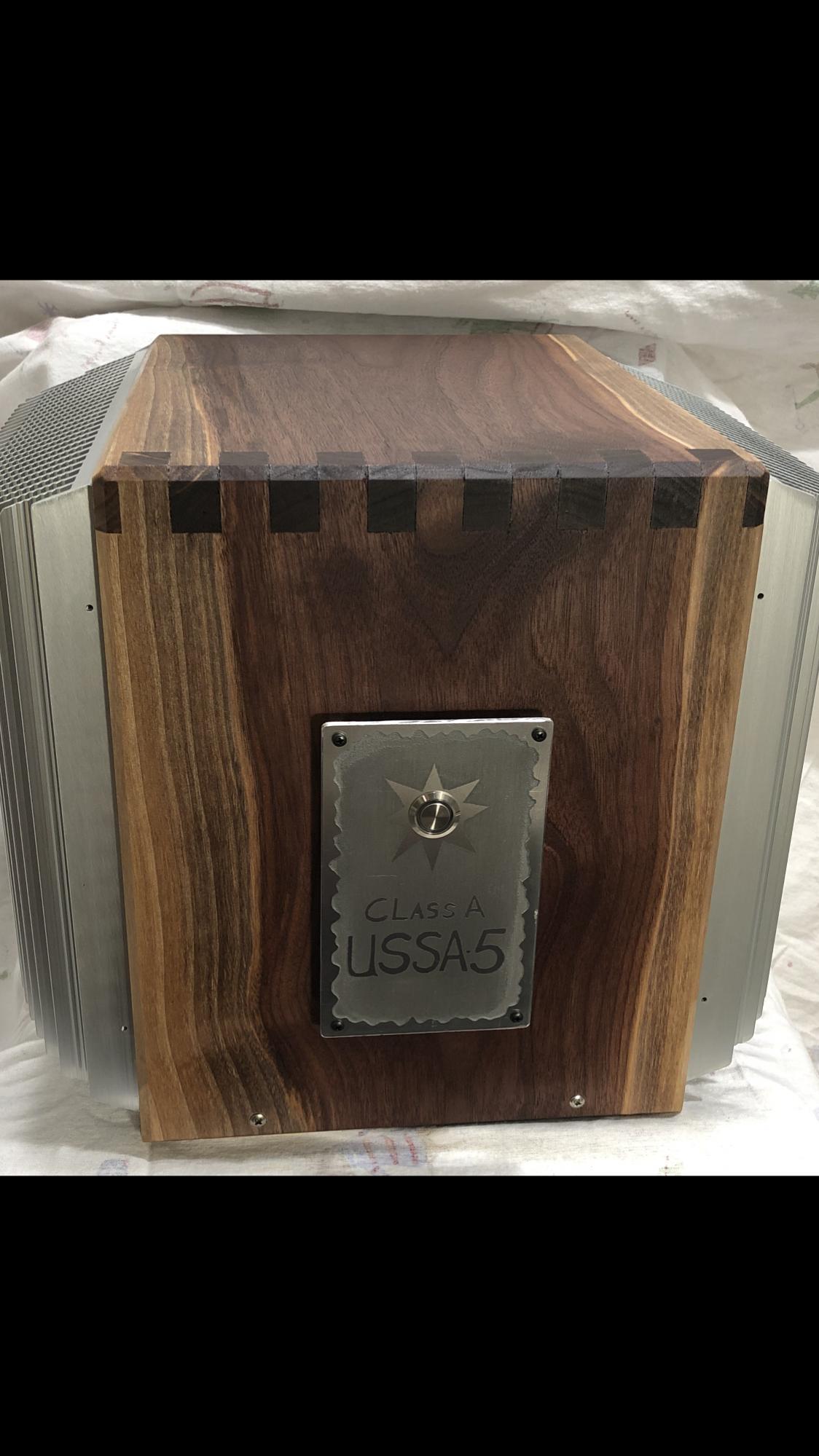

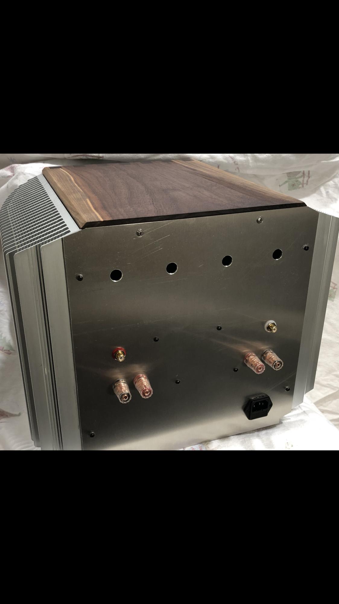

It’s been approximately 6 weeks and many hours of listening since the birth of my USSA5. I’m happy to report that I’ve been able ‘button up the details’.

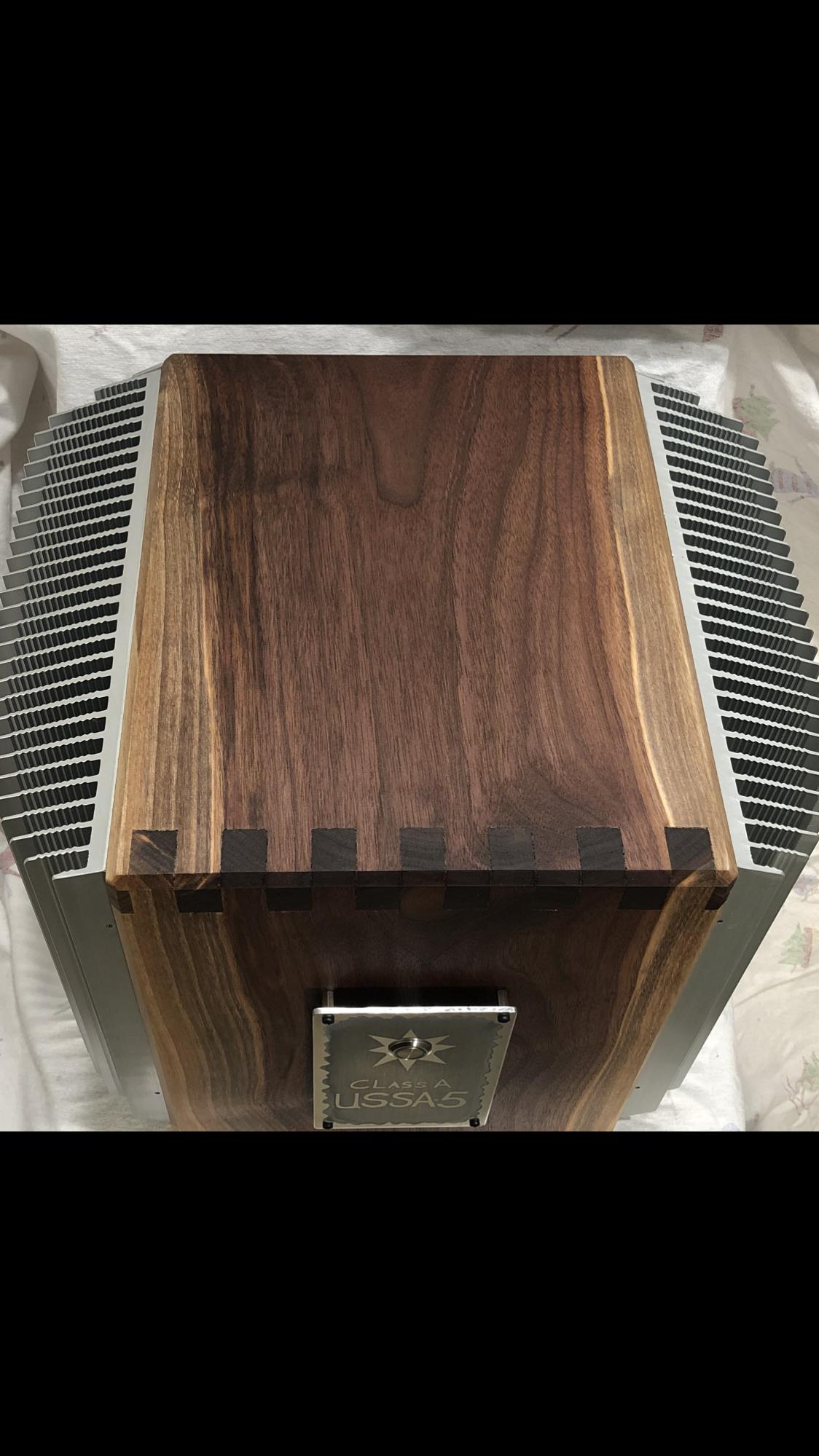

I used a 1” x 11.5” x 36” plank of walnut hardwood to cut the top and front panels from. I used my Incra box cutting jig, table saw, router w/chamfer bit and sanders to machine the two panels to 1” x 10.5” x 12.5”. A bit of gorilla glue and clamps permanently bonded the two pieces together. Sanding and then 3 coats of Tung oil to finish.

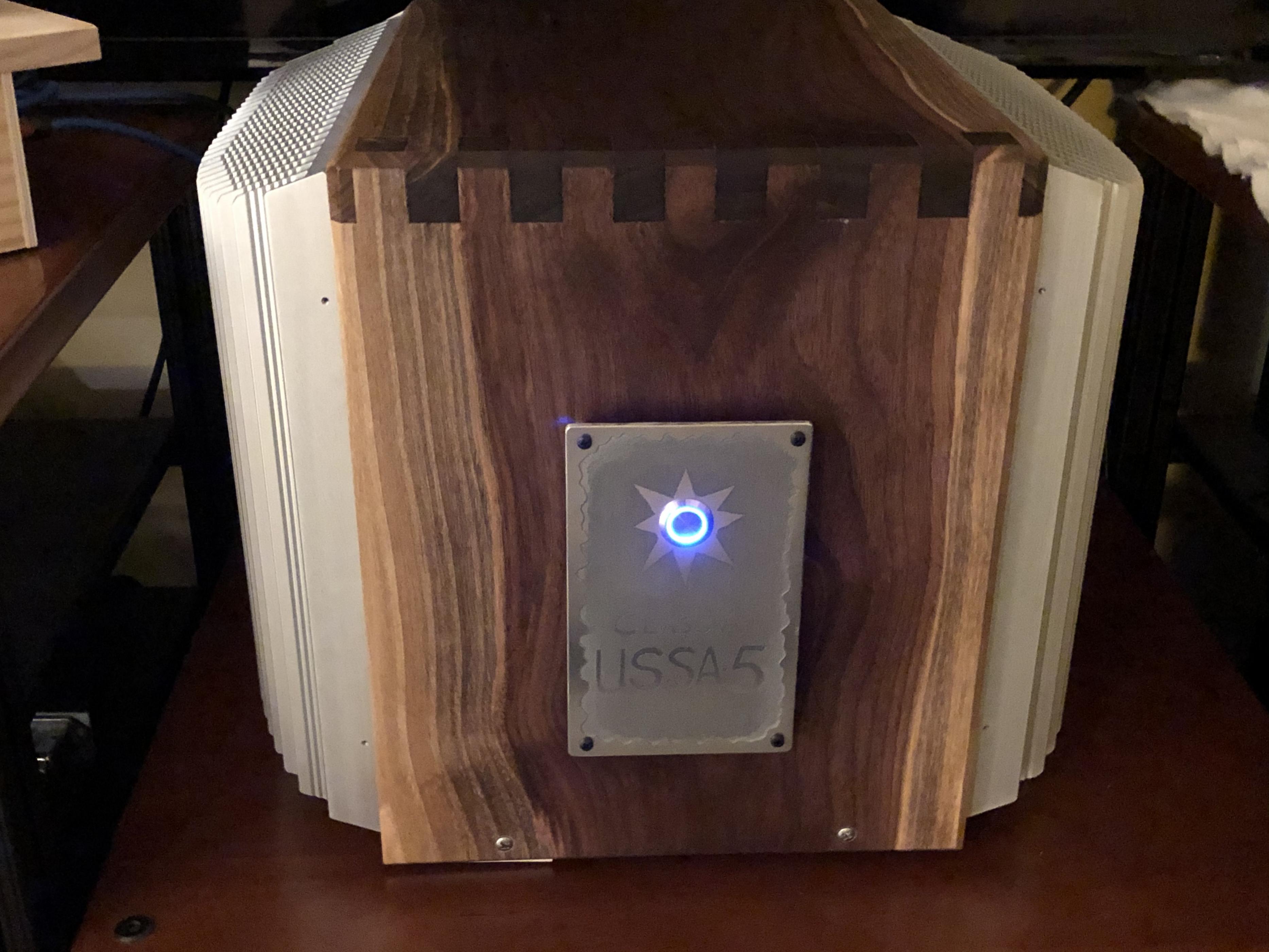

The badge was a home brew attempt at aluminum etching with salt water and DC power 😱 This one was the best of several tries.

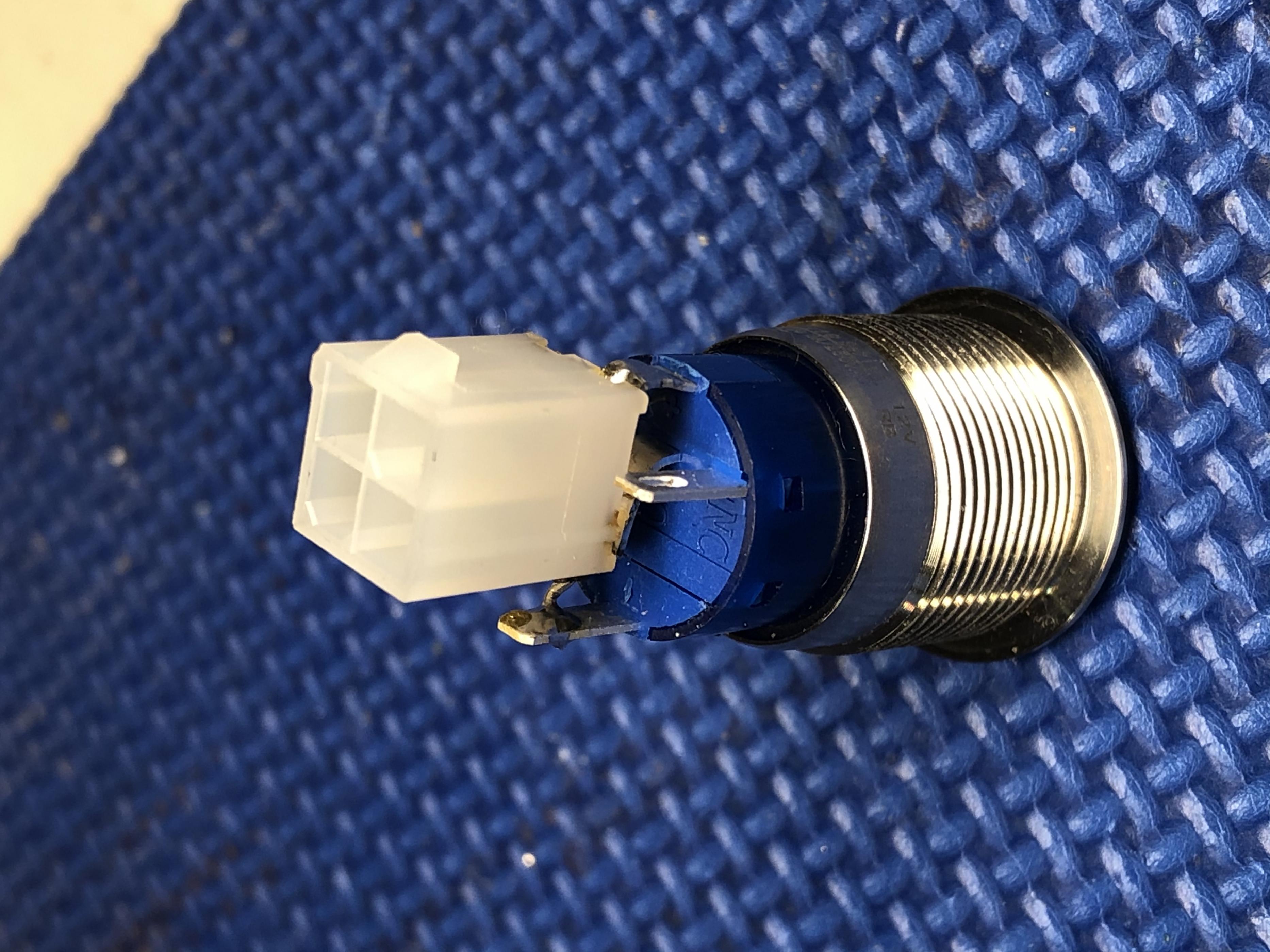

The power push-button switch is from TE Connectivity pt# AV1910RB12Q04, it’s illuminated with a bi-color LED. (standby is red/power on is blue)
In order to attach the now one piece of wood to the amplifier chassis and have the power button wires easily accessible I soldered a Molex Minifit Jr. female header to the switch lugs and fabricated a wiring harness with the matching male plug.
The aluminum badge is mounted on 10mm standoffs to give this massive cube a bit of dimensionally to it.
And that’s pretty much the finishing details 😀

Vunce,
Congratulations!
Just as I had expected, you have a very distinctive looking amplifier.
Nice work with the wood panels; the finger joints add an extra detail that goes well with the overall aesthetic and dimensions.
Congratulations!
Beautiful job there Vunce! I love the wood panels and your badge (it turned out great!).
-Chris
-Chris
Thanks for the kind words Fellas, this was a unique and fun project to work on. In a weird way, I have an unsettled feeling that I do not have another phase of this amp to complete. But, I will get over that rather quickly by having the USSA5 playing in my system 🙂
