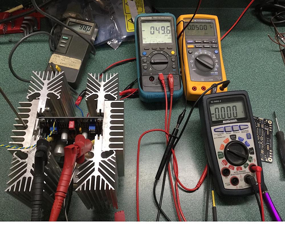

Hi folks
I am building a USSA5 from chassis and heatsink parts I have on hand. The result is unusual and is a very difficult mechanical assembly. Here is a photo of one channel assembly under test with bench supplies at roughly 25volts. Th heatsink assemblies are 5”high and about 7.5 inches long for each half of the output stage. I am testing this initially open air. The chassis these will be installed in will have about a 3 inch deep lower deck below the heatsinks where fans will be installed to provide cooling if required. I have 3 meters monitoring +- source resistor voltages and one for dc output offset. In the back left is a thermometer with the probe mounted directly behind the output mosfet. Right now it is up to 110F. DC offset is very stable with temperature shift. Hardly moves a mv from where it’s set. Perhaps that is helped by the regulated bench supply.

You have made good progress 🙂 and your implementation seems a challenge. I would pay attention to ensure to not put too much pressure on transistors leads while moving the heatsinks ...🙄
There is no change on the temperature compensation for the original USSA 5 version using the mosfet drivers. This version has been built so many times and without issues thus no changes needed.
The version 5.1 using bjt drivers is new but from latest implementation results the temperature compensation is perfect.

Ok, thank you Fab. The 2 heatsinks are joined on the bottom to 2 1/4” braces to keep them from shifting. The boards are mounted to the heatsinks with an angle bracket at each corner so the whole assembly is pretty rigid. It then mounts to the chassis via the braces.
I reached a temp equilibrium of 118F (48c) today at +-25volts 1.05 amps operating point. When mounted on the chassis I may get a slightly lower temp due to improved air flow. If it runs too hot I have fans that can be turned on to lower temp.
I was able to calculate the resistor values for the drivers and will install those and mount the assembly in the chassis and rebias to check the thermal performance again. I have the output mosfets mounted using Keratherm insulators purchased form the DIY store. These insulators are expensive but work really well and no mess installing them like thermal grease. I also drilled and tapped an additional hole on the heatsink above the thermistor. I placed a to220 insulator pad on the heatsink and then the thermistor with thermal grease. I then made a cover for it out of 1/4” phenolic that mounts like a transistor to the heatsink using the extra mounting hole and the thermal insulator pad. The underside of the phenolic has a hollow section for the thermistor. So the thermistor is in good thermal contact with the heatsink and is protected from air currents that could cool it. The insulator pad prevents any short circuits to the heatsink. I also put heat shrink on the thermistor leads to prevent any mishaps.

You appear to have figured out a well integrated solution 🙂 You effectively have created a stable heatsinks arrangement🙂
For the thermistors installation it may appear overkill but with the fan air flow directly toward it it appears a good solution 🙂
Keep us posted on future progress.
