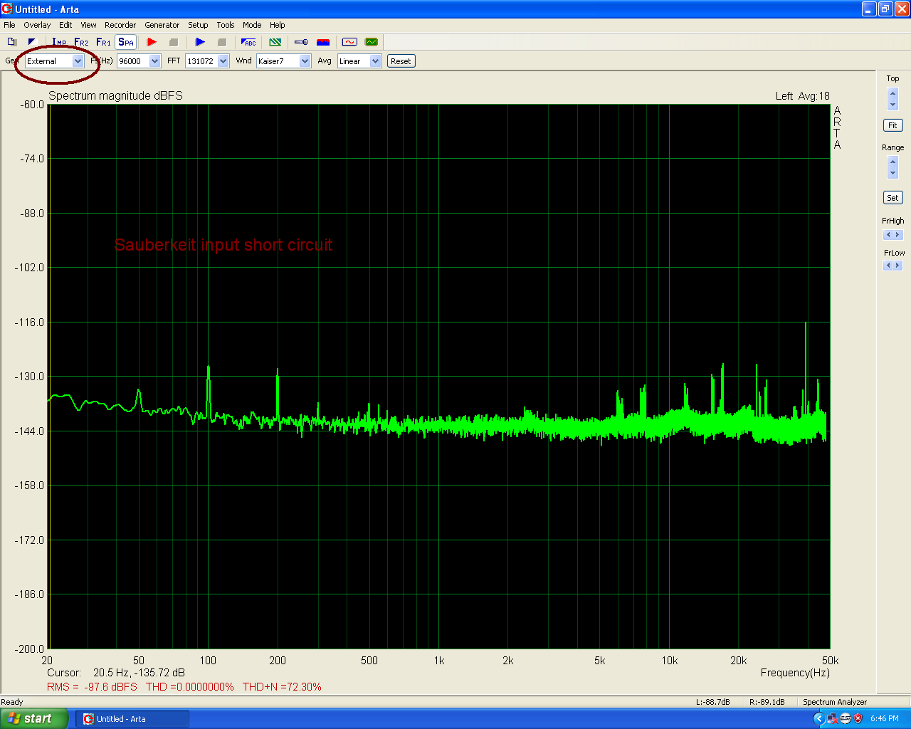

I haven't any low distortion source. I use sound card line out as freq. generator and amplifiers output via voltage divider to the sound card line in .In this case common gnd is more important! When i want to see noice figure i manage to connect amplifier's output only to line in.Using ARTA i adjust sig to External. Always i run three test. The first with shorted input.(see picture). Second with open input. Third with input connected to a source but no signal. The same set test using a scope.

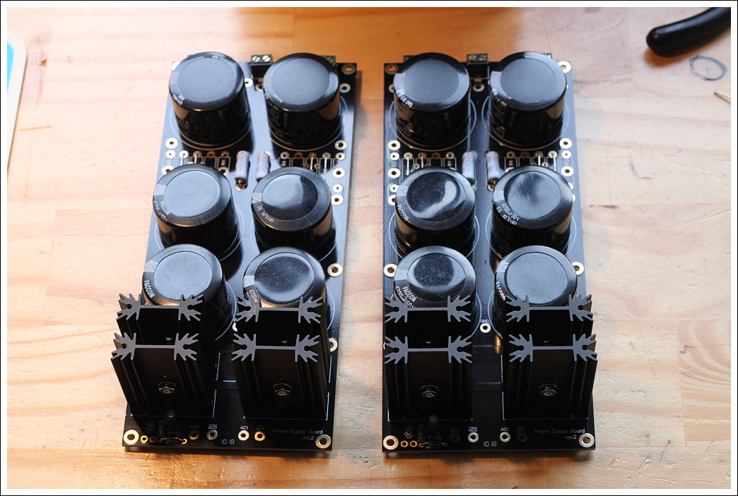

Only 4 caps per channel not 6 or 8 but still good and high quality

For USSA-5 supply voltages you can have up to 136000uF per rail with 5-leg capacitors.
5-Pin Elko Kondensator 68000mF 35V 85degC ; ESMH350VQT683MB80T ; 68000uF

Project16 designed those CRC boards with USSA-5 "in particular" and other /any class A/AB amps "in general". Post # 1 of "CRC Power Supply (Class A amplifier)" thread gives the info.
Like he posted, mammoth capacitance can be fitted along with normal to-220 or to-247 diodes😀. Also many options for resistors. In short a universal design.

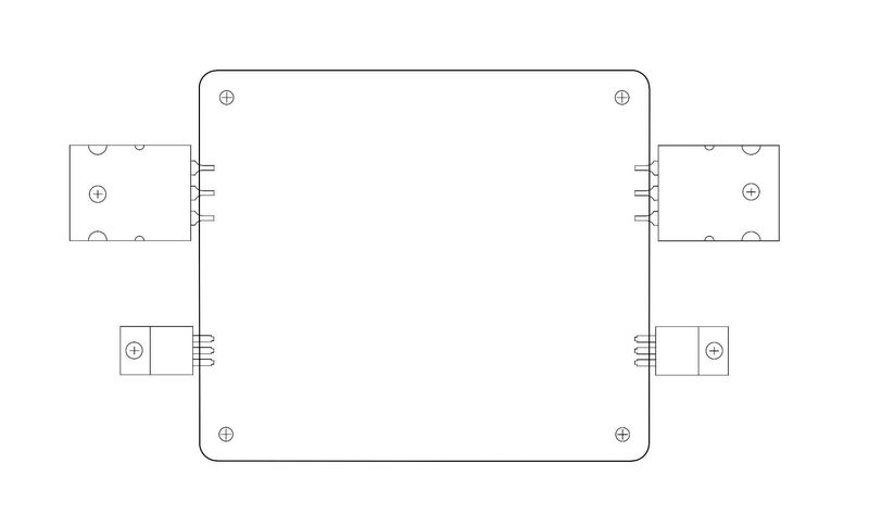

I’ve got some heatsinks I could probably use, please tell me the size of the pcb.

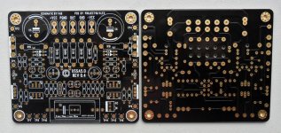

Hi

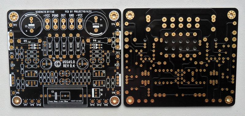

110mm is for pcb version 0.1 and 0.2 only.
Pcb version 0.4 is 97mm x 84mm. New group buy will use version 0.4.

Hi
Between +/-23 and 28vdc.
Output Bias between 1A and 1.4A. THD curves shown at post 108 and 116 with amp at 1.2A and PSU of +/-23.5vdc.
This is a "typical " PSU/heatsink requirement for most 20-25wrms class A amps into 8ohms.
For the same heatsink, if you have 4 ohms speakers you can also lower the PSU voltage and increase the bias proportionally to stay in class A at higher power.

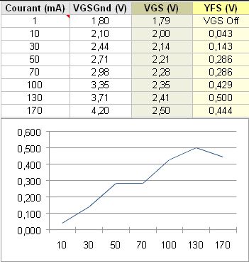

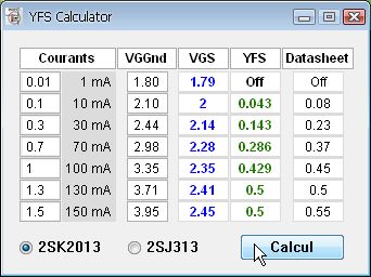

I also for those who would like to measure transistors drivers without going through the calculation phase a small program (Win) and a spreadsheet.
