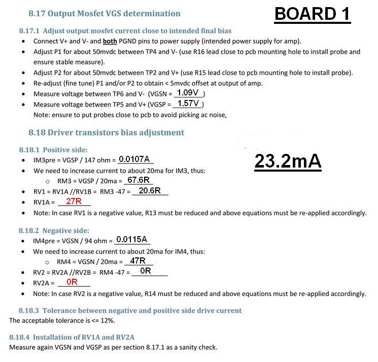

ggzetzoff ,
How did you came out with the values of RM3 and RM4 ?
