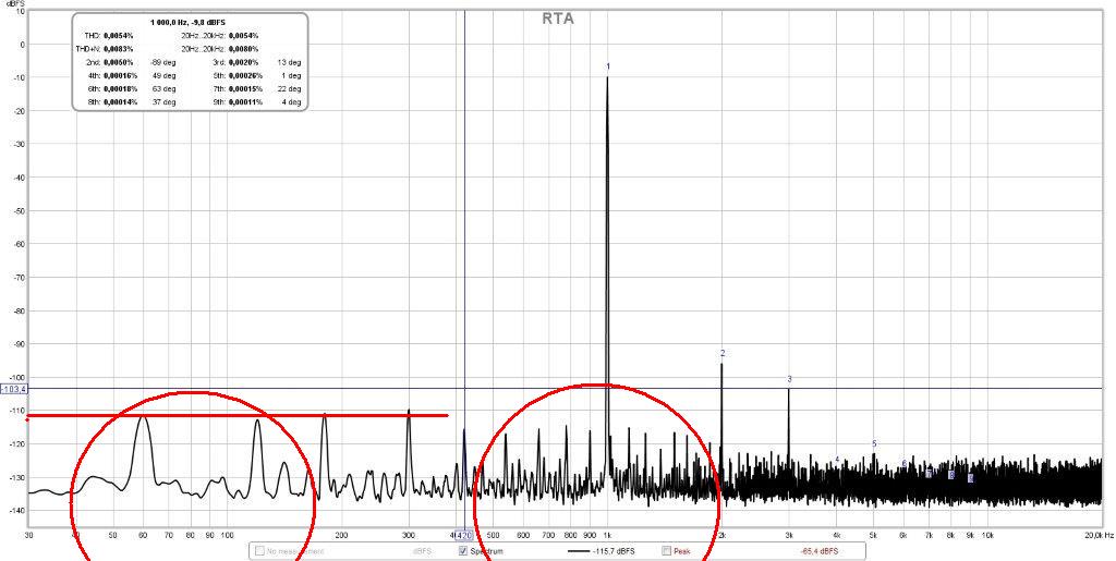

This is a measurement I have taken of the USSA-5 total THD at 1KHz under 1Wrms load (8 ohm). We know that the low watt power is the most important for listening.
Fab
What is your sound card?
Have you done a high watt measurement, have you done an IMD test?
What is THD at 10khz?
Nice THD profile!

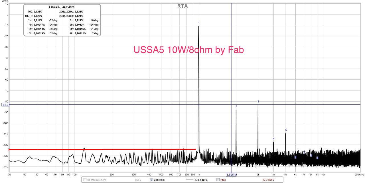

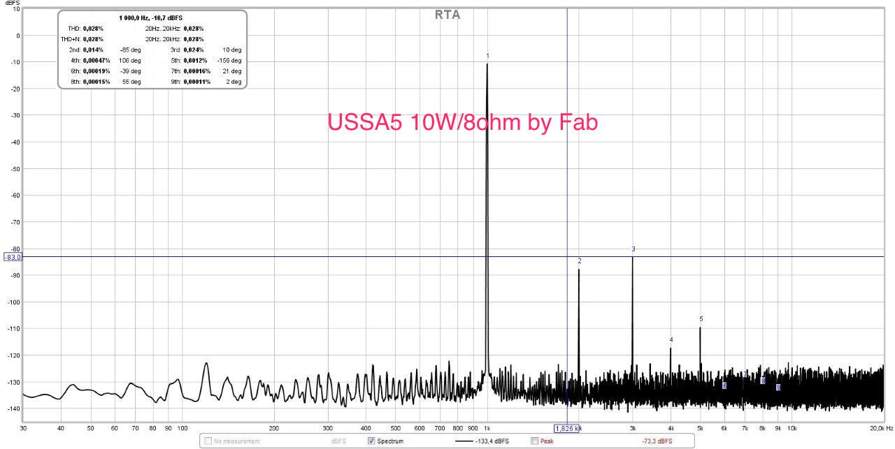

THD profile at higher power
As requested by Thimios
6Wrms into 8 ohms for 1KHz
10Wrms into 8 ohms for 1KHz
You will notice that at higher power 3rd harmonic gets higher compared to second one. More obvious if you compare with previous screenshot of 1KHz THD where 2nd harmonic was higher than 3rd (see post #108). This behaviour is typical in power amplifier.

Thanks Fab,a slightly higher THD but better PSRR.
Thanks Fab,a slightly higher THD but better PSSR.
In fact, the ripple of the PSU is more an artefact of the measurement system (amplification gain of focusrite thus low level of signal need higher gain...) and not the amp. Have in mind also that the ripple level is < 110db!
For the amp itself, a better PSU can reduce it furthermore if really needed.

Yes,yes i see,i learned lesson well.In fact, the ripple of the PSU is more an artefact of the measurement system and not the amp. Have in mind also that the ripple level is < 110db!
Fab
Always i have the same issue during test.🙂
You can get better results,during test, using a separate wire from signal gnd to a clear gnd and not using the gnd lift resistor(4R7).Then you will have on point gnd for signal gnd and output signal.
