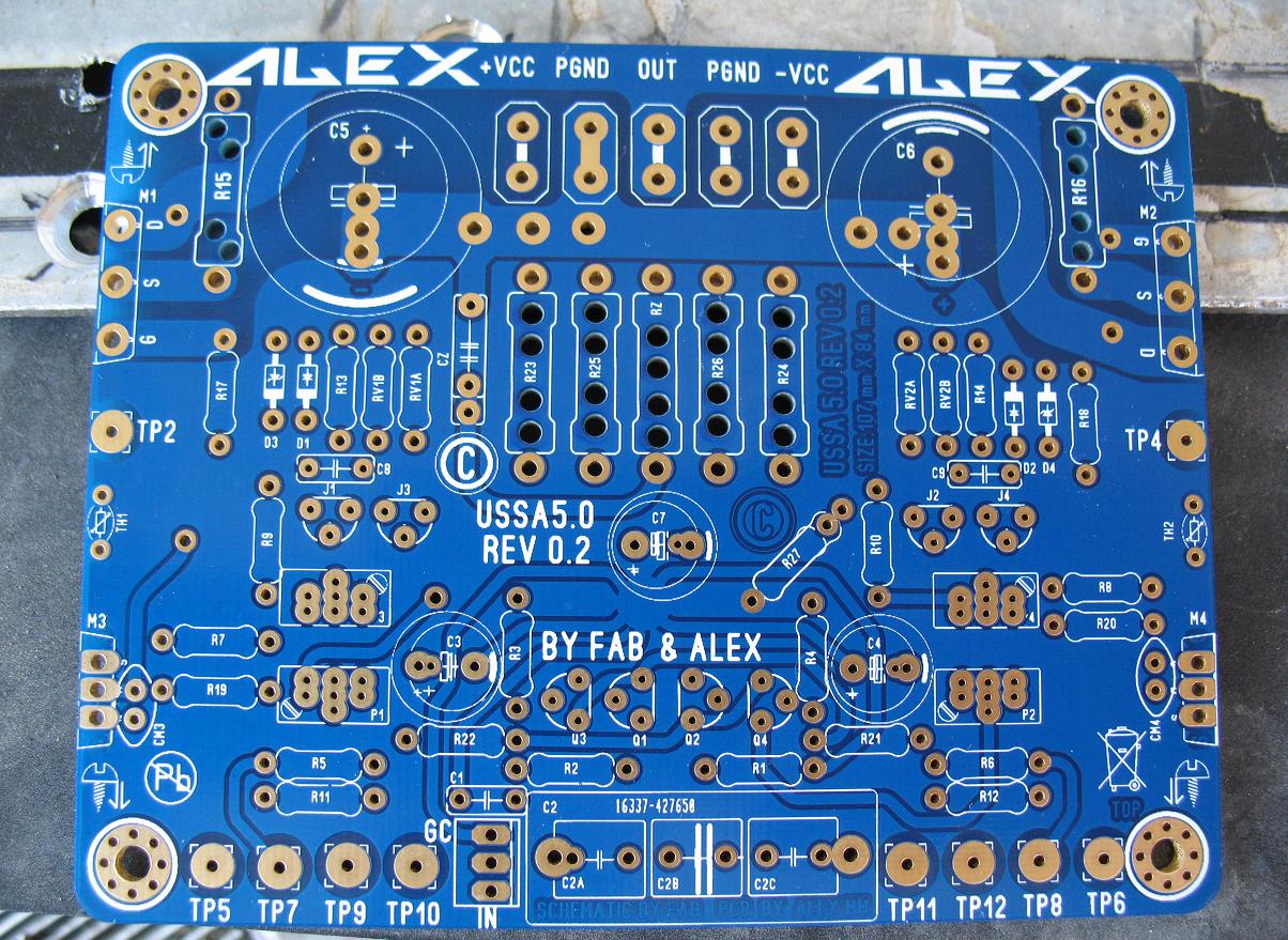

PLEASE, I need the parts list, especially the resistors values. The one I received from Fab does not match the PC boards I have!
That is with Toshiba power mosfets and in the bill, it says please purchase the PC boards from Jims Audio.
I have purchased the PC boards from Fab please take a look a the pictures!
Yes, Fab did send over 41page PD file but that is not for these PC boards.
Patsconnexion has a 25% price discount on resistors until today midnight , I really do not understand why NO one willing to help. To me because I live on DISABILITY SUPPORT 25% DISCOUNT is a lot. Please, guys, I need the resistors value for the amplifier PC boards attached.
I am unable to figure out some marks anyway because it marked like RZ, RV2A, etc please I beg for help now 3 for times.

Hi gaborbela,
That was probably a long time ago and for the USSA 1 or 2. At the time we used to buy that F5 PCB from Jim's Audio but the USSA 3 and 5 required way too much modifications to the PCB, the reason why there is an official PCB now, the one you currently have. I'm also using the red revision of the same PCB. The newer one is more compact and has been further optimized, but I don't think you'll hear a difference anyways.
Please PM Fab for the newer manual as I cannot send you a BoM without his consent. If you bought the output Mosfets, just send him a picture or any proof of purchase and he will send you the complete manual including the BoM for the version of USSA you wish to assemble. I believe at the moment people are assembling the version 3 or version 5.

Hi Gabor
To complete Pinnocchio response , ussa1 and 2 used Toshiba output mosfet with F5 pcb but Ussa3 to 5 uses lateral double die mosfet and they have a diffetent pin out compared to Toshiba.
I just sent you the manual of the ussa5 that fits perfectly for all designations with the pcb version you have.

Hi Fab
Thank you, I received it. I still have a little time to go over and place that order.
I believe I mixed up the different version and I printed out the wrong parts list.

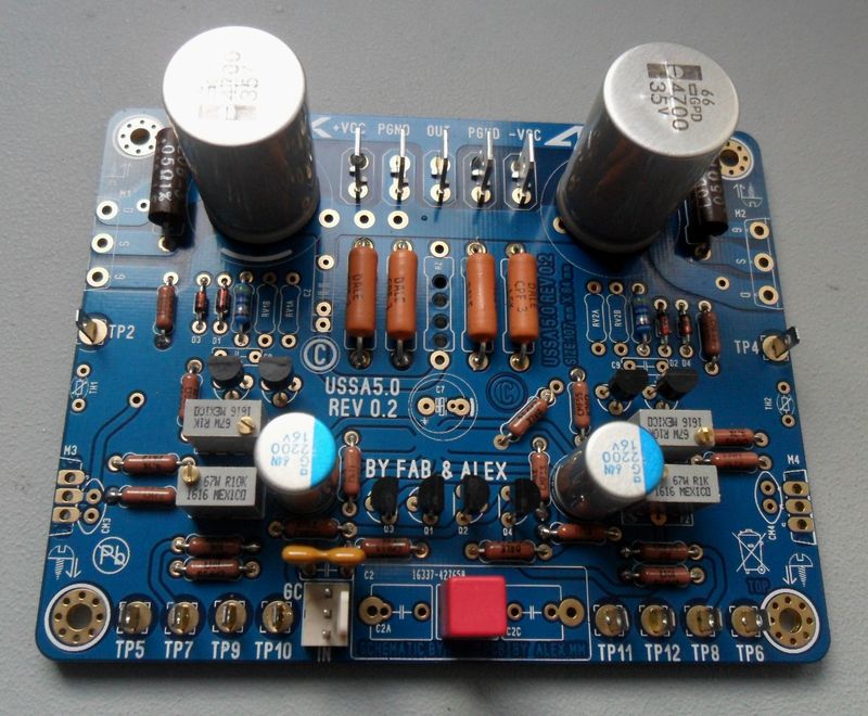

I can't find a source for the suggested C5-C6, P16 where did buy them?
Don't think that particular one is available anymore? Search returns nothing on that part number at all (unless it is a typo).
Mouser has at least 10 to choose from in those values; Farnell a couple.
The silver tin plus the values on the end that example you see in pics on this thread do make it look like a polymer cap (at least that was what I thought) but it's just an ordinary electrolytic.
EGVD350ELL472MMP1H United Chemi-Con | Mouser FranceI can't find a source for the suggested C5-C6, P16 where did buy them?

so it is just a standard electrolitic not a polymer type
Yes b/c I could not find such a high capacitance value and that voltage for polymer cap. Although this one has low ESR even at 100kHz and high ripple current. If you find another one with similar performances that should be ok for that cap C5/C6 purpose.
