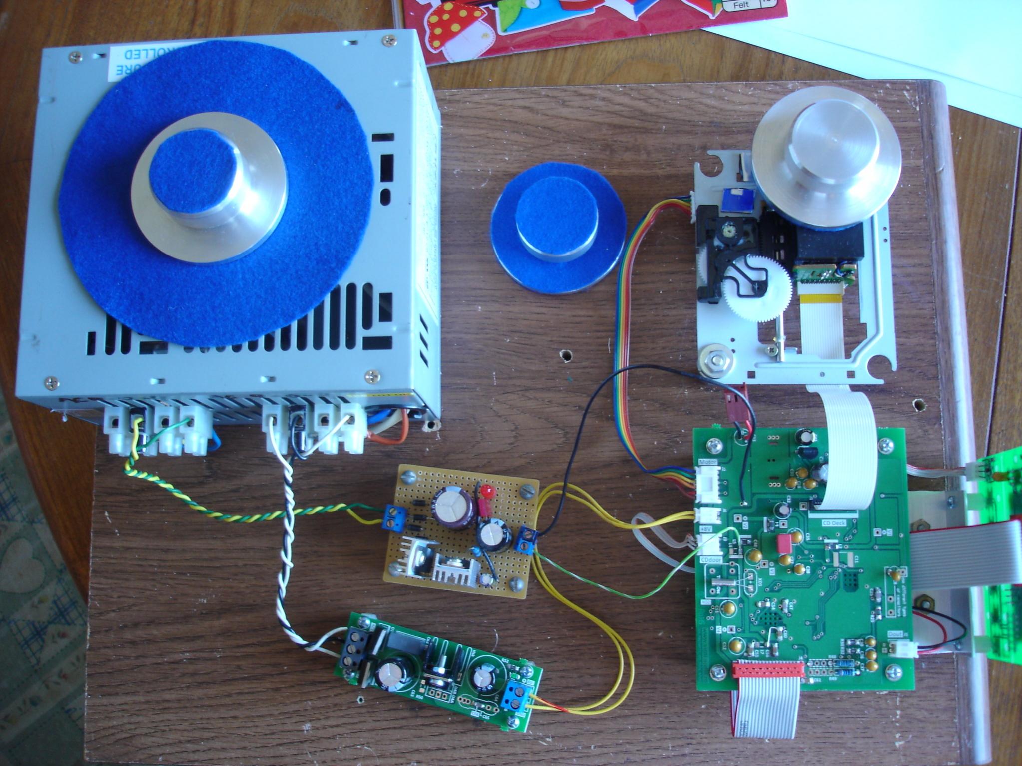

How would one do this? I looked at the schematic and couldn't see which bead(s) to remove to make a separate +5V for the clock but keep the rest of the voltage feed intact.
Is a separate +5V for the clock significantly better than a +8V feeding the mechanism only, and separate +5V for the rest of the board (including clock)? In all cases the +8V and +5V would be fed by separate transformers.
Yep. It is possible and very recommended.
Tibi
Remove L8 and use L8 PCB pad to feed +5V directly to oscillator can.
Try one by one. First power clock from a separate PS, than feed laser and ASP section with a better PS. Later on you can try also separate 8V for servo and 5V for DSP.
There are other many combinations and is up to you to try them all. 😀
Tibi
Tibi
You're no help! 🙂🙂🙂
I'm hoping that for my first attempt, separating out the 8V for the transport/servo and feeding the DSP and clock from the same 5V would be a better solution. I'm thinking getting anything having to do with the servo and motors away from the digital audio circuits is probably the best first step.
A few tweaks to try out tonight (see the pic):
- Split PS.
- Pucks with different damping.

For my custom model I'd like to use a power entry connector with a built in switch. The idea is that switch will control the power to the digital circuitry, besically keeping that on all the time. A second switch on the front panel will control power to the mechanism motors and the display. My experience tells me keeping the digital stuff cooking all the time makes for better sound.
What is the feeling on using a power inlet with built in filtering? Something like this
15CUFE1 - TE CONNECTIVITY / CORCOM - POWER ENTRY MODULE, MALE, 15A | Newark
Tibi, with respect to my plan of having separate 8V and 5V supplies, does the 8V feed anything besides the mechanism? I'm trying to decide if I want to keep the 8V and 5V powered on all the time, and add a switch for the display only, or add that "run time" switch for the entire 8V feed and display. If the 8V does not power anything on the main PCB that "needs" to be on all the time then I'd make that part of the switch to throw when wanting to play a CD.
