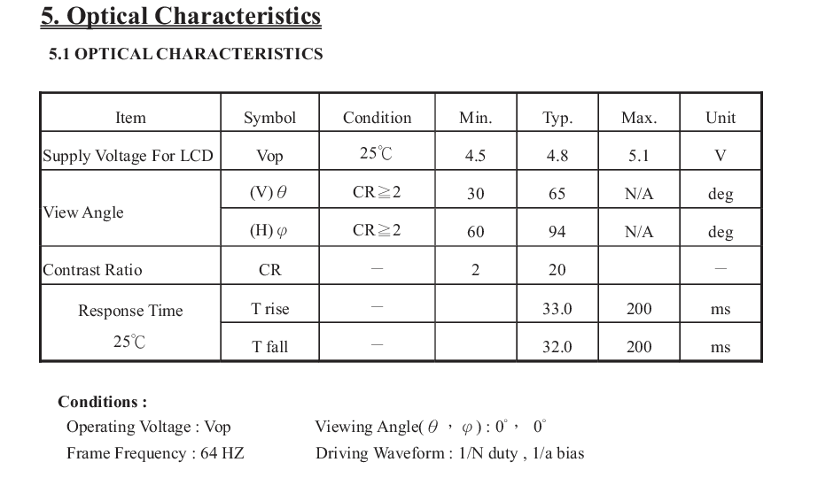

Tibi, I'd like to discuss this further. I measured 4.89V at the referenced point on thr PCB. Yet my vertical display angle is still not great. On your website you describe the LCD as having multiple bias points. What does that mean? Can I "change" to one of these other bias points?
You can adjust further. Datasheet value is 4.8V, but you may adjust up to your best view.
The LCD is multiplexed on each segment and for this the LC78601 is using 3 bias points between 0 and 5V.

These bias points can not be changed. Some time ago I posted some graphs and oscillographs.
If fact, this was the main reason why this project took so long, as we had to design and manufacture a custom LCD.

Would you be able to advise as to how I would do this if I need to increase the vertical display angle?
You can increase vertical display or horizontal viewing angle up to a limit, as this is limited by crystal type - nematic - and manufacturing process. See below image from datasheet.
You can only force LC78601 to work LCD matrix at a lower voltage as I described in one of previous posts using median pin on a 2K pot connected at +5V and gnd.

So if my voltage at Pin 40 is already 4.89 volts, it looks like I'm already at the maximum vertical viewing angle (assuming CR>=2). I'm not from the looks of this there is anything I can do.

LCD can operate between 4.5 and 5.1 V.
You may try to adjust between these margins to get the best contrast and therefore viewing angle.

How do I make the voltage go up?
As far I undestand you power this section from a separate LT1086, therefore you may increase his output. This can be achieved by changing R50.
The mathematic relation is on LT1086 datasheet page 9.
Vout=Vref(1+R50/R51)+Iadj*R50
5.1=1.25(1+R50/120)+0.00005*R50
R50=(5.1-1.25)/(1.25/120+0.00005
R50~372ohm
