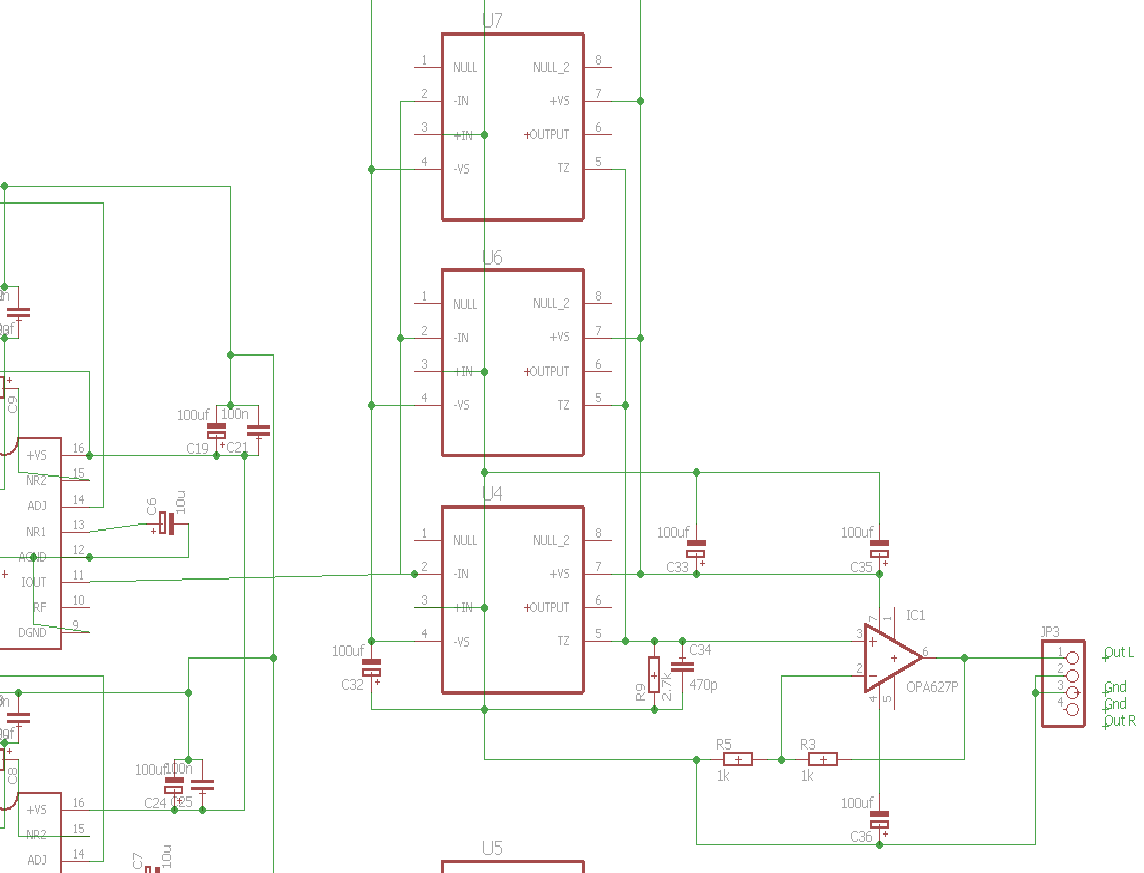

Could someone tell me if this is correct for the output of an AD1862?
Would I be missing some components here?

I'd use separate bypass caps on each power pin of AD844 & OPA627 instead of one large cap. I used 0.1uf~0.22uf C0G/NP0 ceramics, and they are quite good.
Where do you source those caps? C0G caps are hard to find with such large value.
I just use multiple nichicon muse kz near to the chip. So far I am happy with the sound. C0G are very good but sometimes when I mix different types of caps in parallel the sound may become uneven. For example if i use PPS cap in parallel with black gate on the supply pins of TDA1541a it worse than black gate cap alone. On the othen hand pps caps are very good for decoupling the current divider pins of tda1541a
Yes, they are hard to find and expensive. It happens that I had a chance to buy a reel of C0G at a very good price. The only place I'd not use ceramic is the power pin of AD1860. Yet, this is on my DAC. Ceramics may be still good on yours.
Yes I can do that the same as you can see on the +VS of the AD1862 100uf bypassed with 100n. Is there anything else. I noticed in previous diagrams there is a capacitor from pin 2 of ad844 to ground. Is that needed and what size should it be?I'd use separate bypass caps on each power pin of AD844 & OPA627 instead of one large cap. I used 0.1uf~0.22uf C0G/NP0 ceramics, and they are quite good.

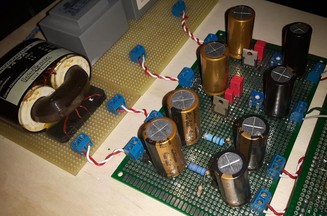

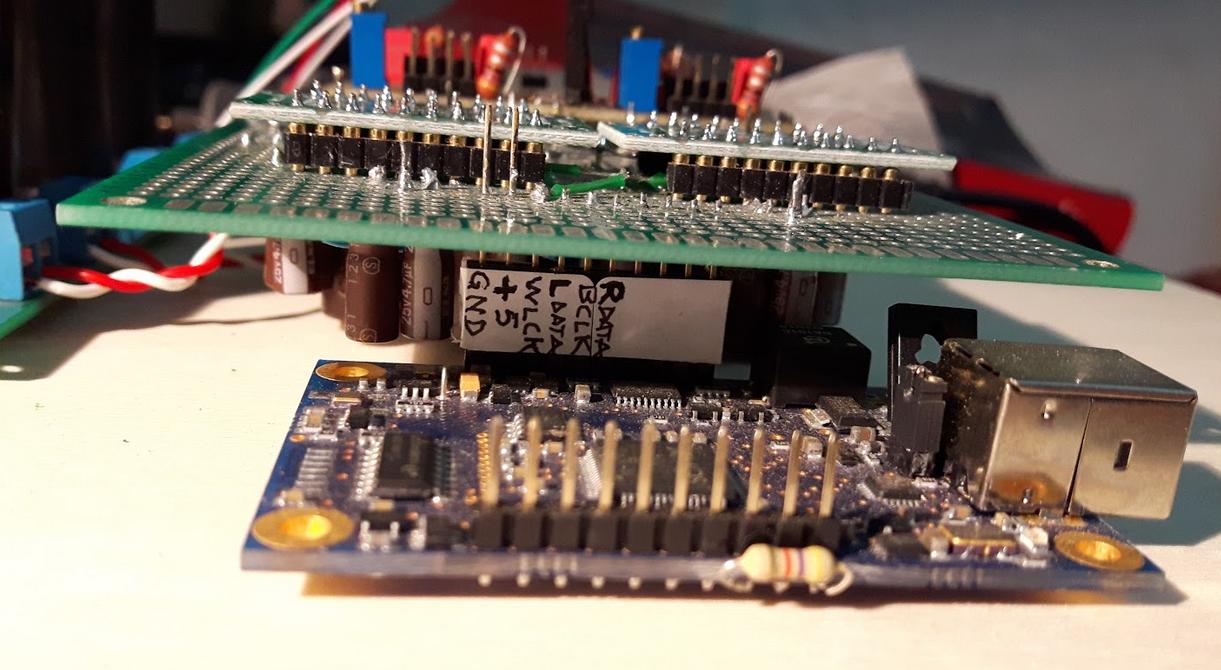

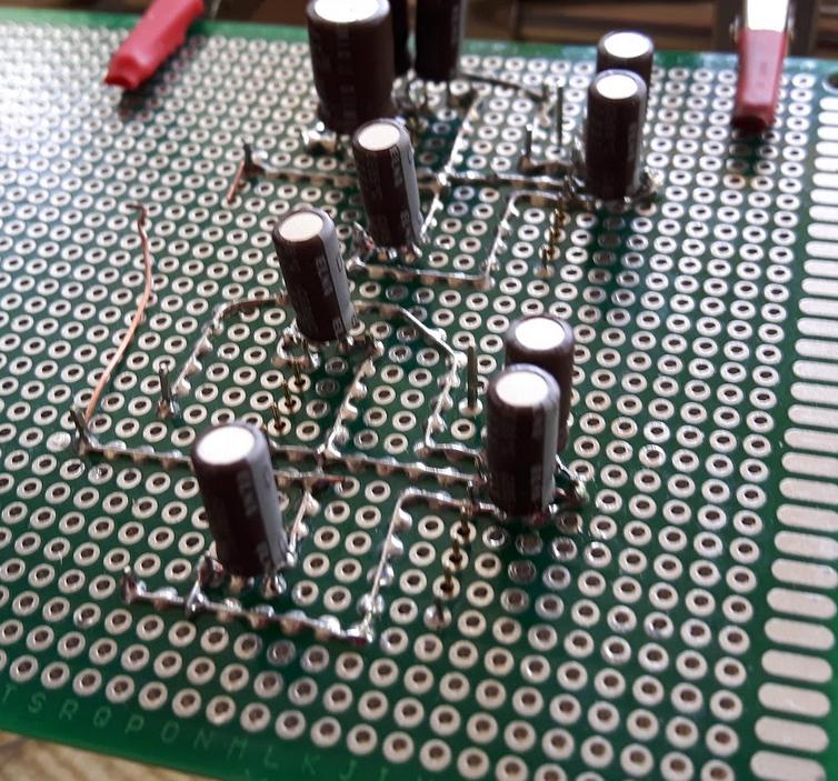

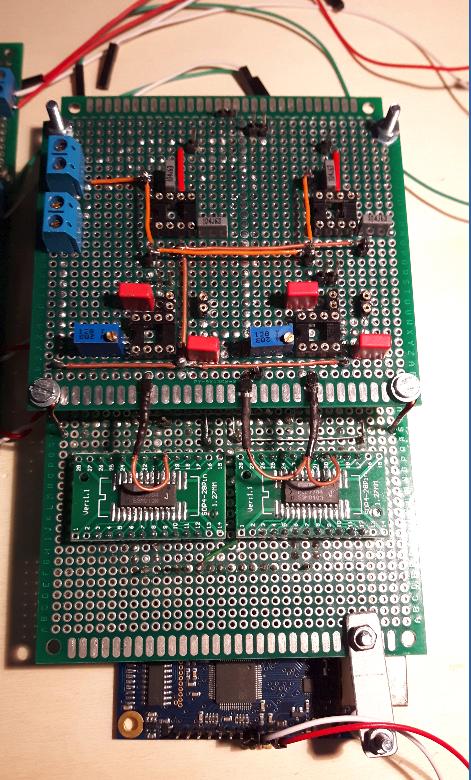

I built completely from scratch using matrix board cards (Eurocard double face) my new DAC with PCM1704 and IV AD844 with how
he was treated in this thread from the suggestions of George and Torchwood treasuring all the relevant post.
My DAC is NOS. I give the signal I2s in the format used since 1704 by means of JLsounds I2SoverUSB card configured for this purpose.
The signal goes direct to the two chip-dac.
For the supply of 1704 I used a shunt power supply based on the TL431.
the IV supply for + and - 15V with separate power supplies based on the LT3080 regulator.
Only for the galvanically isolated region of I2SoverUsb a supply with the TL431, the rest is fed from + 5V of the PC via USB.
I fetch the out of the IV from the internal buffer. I also tried out directly by TZ. In this situation the sound of this machine is the best I've ever heard.
Simply magic. Sound concrete, rich, holographic. Wonderful.

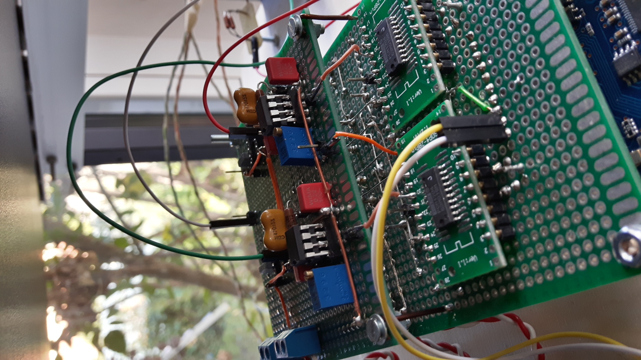

These days I wanted to try to put two parallel 844 again using the internal buffer of one only. The improvement was very significant and tangible.
It seems to me that they can not go back.
Strangely, however, 'it is occurring, only when I put in dip socket stack of 2 x AD844, and not always of continuous, a noise, pop, as if burning wood in the fire.
As soon as remove the stack and put it back one 844 . OK !perfect silence.
Can you help me understand
What happen? I like too stacking.

In the meantime, I solved the problem of Popcorn noise. To me it seemed triggered by an unstable contact of some pin 844 into the socket, perhaps for the tightening of the pin subjected to welding with the superimposed exemplary. I unsoldered all pins, cleaned up the pins and redid the welding by moving a bit higher up the mutual contact point. Repositioned the stack into the socket. Complete disappearance of the noise. It's working 24 hours and not more is resubmitted.
The suggestion by abraxalito of ceramic capacitor between the two supply rails I plan to put it into practice given the positive experience reported by some members.
TZ pins are welded like most 'sometimes suggested in this thread. In other words the pins 2,3,4,5 and 7 are welded
