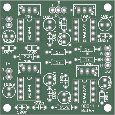

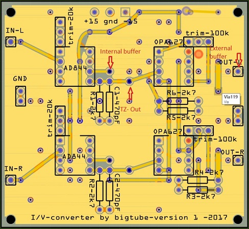

Have just ordered 10 of these from dirty pcb. 50x50 prototype pack.
Simon
Looks good. If one needs stacked AD844's, I would make them parallel to each other and having independent local bypass caps on each power pin.

my friend I do not sell anything 🙂. After tested it well, I can also share gerber file and so you can carry in your own.very nice, can you also provide/sell a sample PCB?

thanks, waiting for the gerber file thenmy friend I do not sell anything 🙂. After tested it well, I can also share gerber file and so you can carry in your own.
I've not been following along very closely here, are we talking about decoupling for the AD844? If so then I'd use several 10uF/1206 X7R between the pins as 100nF isn't nearly enough to be using for decoupling a classAB output stage (such as found in AD844).
abraxalito,
Today I tried 10uf/1210 X7R on the buffer op amp and the result is great. Many years ago I used 10uf electrolytic but it did not satisfy me. 100nf film or C0G is still better than electrolytic here. However, 10uf X7R is different story. The bass is clean and powerful. After few hours of run-in, mid and high improved, they are now equal to the effect of 100nf C0G. Thanks for the tip.

Yes, I finally paralleled another 100nf C0G to further improve the HF. I'm still evaluating this combo. Having listen to various albums, so far so good! BTW, my 10uf X7R is from TDK, 1210 rated 100V.

Thanks for sharing your feedback. But don't stop at just a single cap, try adding two three or four 🙂 I have some circuits where I've piled up caps atop a chip to about 10mm height.
The weakness of a 10uF electrolytic is going to be its high ESR. Typically will be an ohm or so. 10uF ceramics have ESRs considerably lower.
I am thinking about stacking five 2.2uf X7R instead of one 10uf. I am not sure if this will further lower the ESR, since MLCCs are multi-layered. One thing about 100nf C0G. I found it sounds more balanced when soldered on both rails (one end at + and the other at -). According to some datasheets, this will improve distortion and PSRR.
