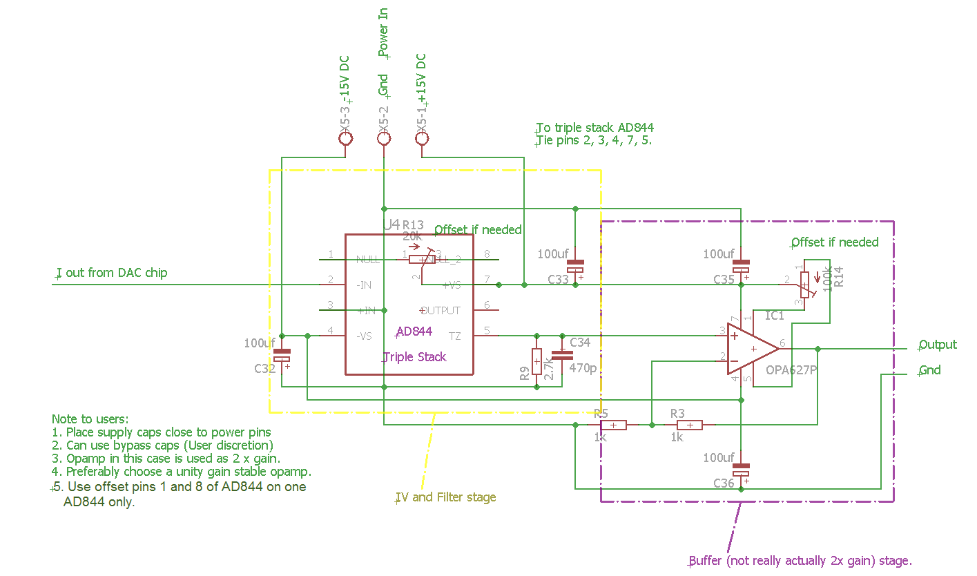

Schematic for AD844 + Buffer(gain stage)
After trawling through this thread for too long I have come up with a schematic diagram which may help others. This shows how to use the AD844 triple stack with buffer (2 x) as suggested by the OP Georgehifi. hopefully link this to the opening post.

Just realized, that the AD1862 also put out around 1mA, and you used 2 x stacked AD844's. You should up this to 3 stack, as there was a marked improvement again with 3 of them with the PCM1704, as it will lower the input impedance as see by the 1864 to around 10ohms which is better for a current output dac and gives it more current headroom as well.
Cheers George
Cheers George
George if "you" refers to me because I use the double stack of 844 want to clarify that I run it with 1704 .... anyway if you refer me feel very recommendable upgrading to triple stack .... an improvement it seems incredible .... but I am ready to rearm the welderJust realized, that the AD1862 also put out around 1mA, and you used 2 x stacked AD844's. You should up this to 3 stack, as there was a marked improvement again with 3 of them with the PCM1704, as it will lower the input impedance as see by the 1864 to around 10ohms which is better for a current output dac and gives it more current headroom as well.
Cheers George
Sorry no I mean Niss_man he uses the AD1862.
Cheers George
ok ..... it seemed that niss_man adopts the triple stack in the schematic in attachment ... but you believe the triple stack a serious improvement for 1704?Sorry no I mean Niss_man he uses the AD1862.

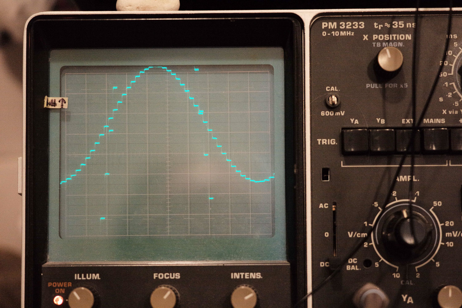

Some results: PCM1704 @ 44kHz, 24 bits depth, IAN PCM with JTAIL; NOS (no digital filter); double AD844, BUF03: it is 1,95 V RMS (on my B&K).
A perfect signal without pre or post echo
The staircase, I have a small cap 150 pF mica between PCM104 and AD844, and 245 pF mica on pin 5/TZ, with 2k7 (3k//10k); output is 1,95 V RMS (B&K)
Of course I can decrease the TZ frequency roll-off, but it is OK like this, I have no super tweeter, can't hear above 13 KHz anyway &I have a tube amplifier where driver and output both roll off at 50 KHz..
Comment - The steps on the staircase seem not equal, slanting, this is due to my old Philips scope, on which the DC/DC takes a long time to settle.
So that looks great!

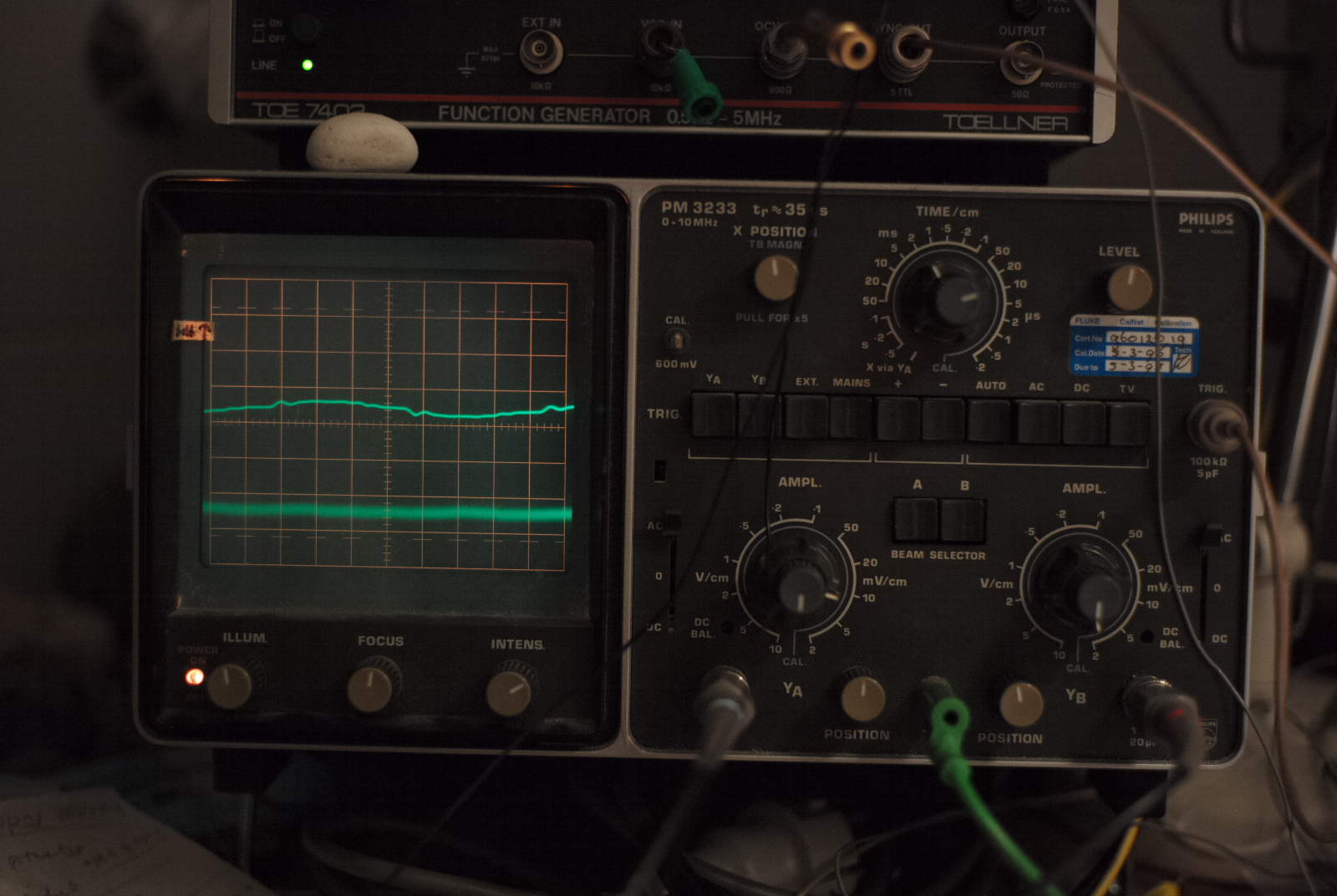

What sort of noise (level and frequency) are you getting at 2mV per div with a scope shot from the buf03 output?
Cheers George
Cheers George
Cheers George
With iTunes turned off, the USB connected, the output of BUF03 is flat, is a bit thick. When I connect my B&K, it measures 0,09 mV in the audio band.Same for pin 2 TZ.
The scope is a thick line (using a 1:1 probe) and there is a little 100 Hz jump but this varies in time, maybe an artefact from the dangling wires.. I have 100 ohms out, cabon composite.
(Pin 6 is 0,15 mV again maybe a ground loop issue of the measurement).
The thick line does not trigger the locking even when the timebase is turned to min timeframe of 0,2 uS, well just a slight tick, that I also have seen on my shunt of one side of the PCM1704.
So not bad at all.

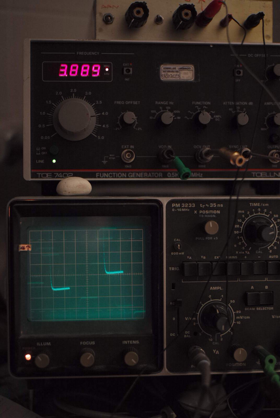

Are you getting the funny spiral on the 20khz sine wave (above link)?? as I never did get around to see if it was my smp bench light doing it?

Yes. I will use triple stack. My circuit isn't together yet, just parts at this stage. But thought diagram would help others.Sorry no I mean Niss_man he uses the AD1862.
