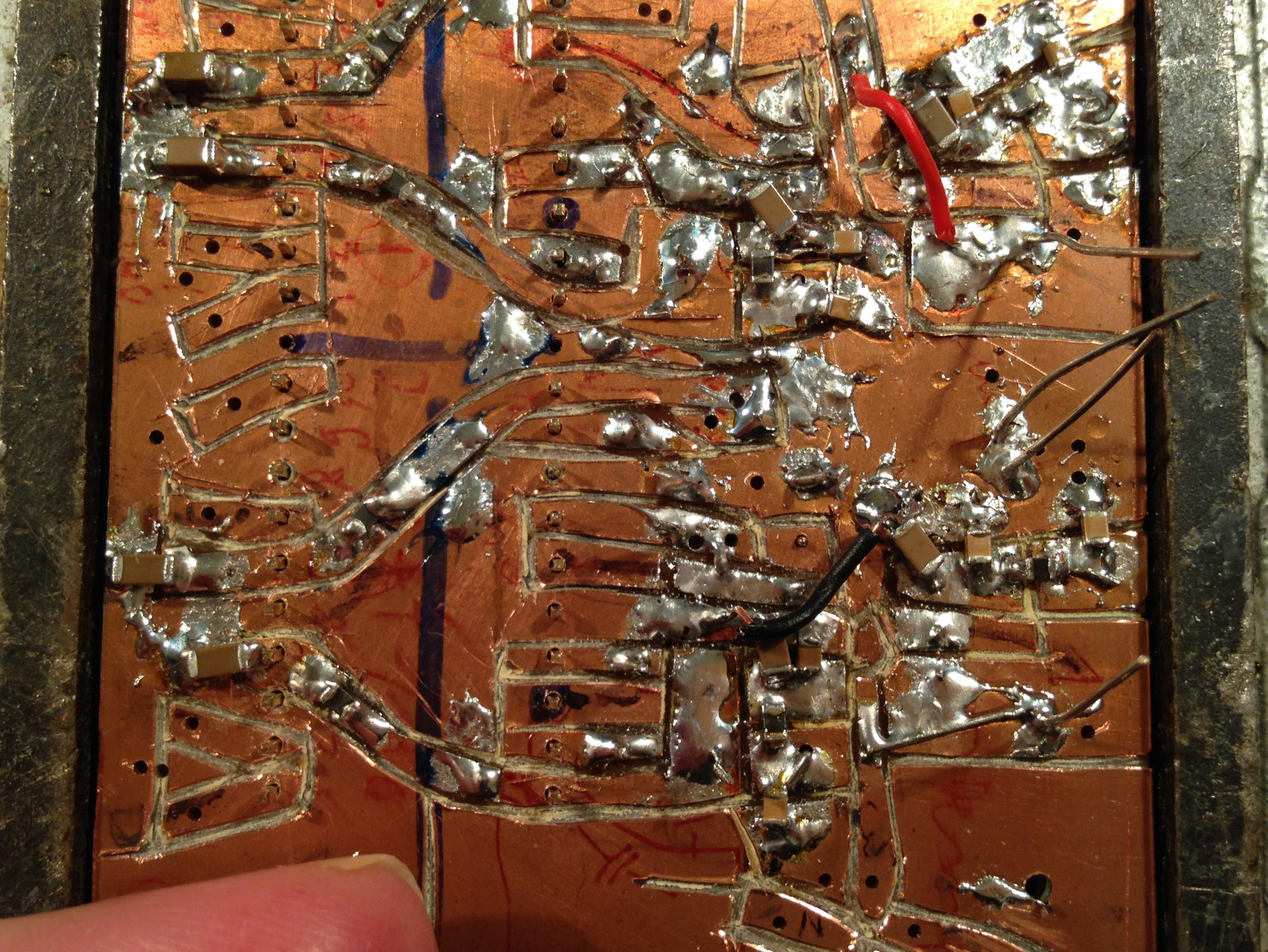

as I am building now I am all on to this I can react a bit but not with as much insight as George -
Abraxalito gave some hints how to handle the power lines to the 844s.
I have:
a small (X5R footprint) Murata bead in the +/- supply, right after that a 10 uF in X5R and a 4.7 uF in in X7R ceramics too. Almost soldered on the pins.
I have, in case the chip oscillates, a plan to: solder a 10 uF on the case between pins 4 & 7. And add a snubber there too: 100 nF + 47 ohms.
Pin 5 in my view reflects anything it sees, sort of. So keep the outward inductance low. Right after the resistor and capacitor I have added a stopper resistor of 200 ohms, just like as if pin 5 were a grid of a valve or a gate of a fet.
So here my home brew. Jou can see the caps spraied around. Albert

Thank you. I'll try those and the snubber is a good idea, maybe also a load on pin 6?
I may also try removing the .47uf dc blocking capacitor between pin 5 and the opa627 transformer driver. (I tried an op134 in case the 627 was part of the problem but made no difference).
I will also increase the capacitor to ground on pin 2: it was 10n, currently 1n.
With no capacitor, the oscillation amplitude drowns the audio, leaving noise and hum.
Ian

10 nF on pin 2 is way too much, pin 2 is input isn't it? The output impedance of the DAC chip will give a low cut-off, drowning dynamics.
The DC cap should not influence it. Try that stopper resistor. And specifically ensure the OPA is heavily decoupled from the AD. My AD844 has 10.000 uF, the BUF03 100.000 uF (wow). The PCM has a shunt (by Abbas, I'm lazy, and that sounds good).
See that the returnpath from the input to the next device exists. No loops in the eaurth, no potholes, or that will give garbage.
10n didn't sound dull. As the TDA1541 is current output (what is its output resistance?) and the input impedance of the 844 is 50r, 10n should not be too high surely?

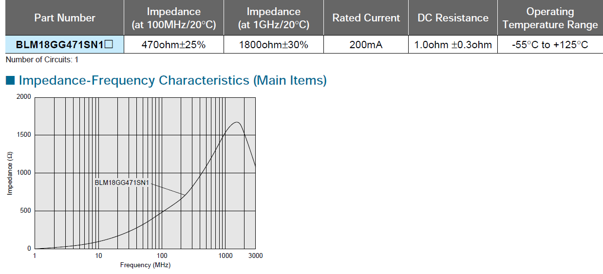

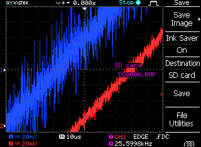

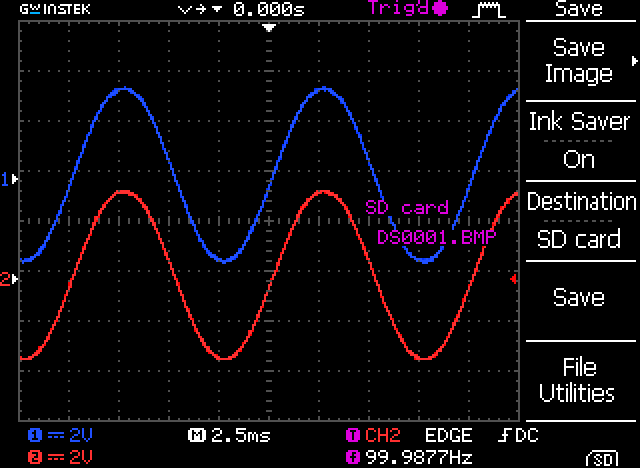

Hi guys,
I just want to report that I've improved my I/V stage again. My current setup is based on OPA861, but I am sure it will work on AD844 also. As some of the experts here had mentioned that HF garbage from R2R DAC is unwanted and could upset the op amps easily, so I decided to do some experiment myself. I searched the catalog of Murata ferrite beads and found this special BLM18GG471SN1 is worth a try. To my surprise, the result is phenomenal. The smoothness is improved and more details is revealed. No side effect is found. As a ferrite bead could add 1 ohm DC resistance on signal path, but I think it's absolutely worth it. Here are the signals on my oscilloscope (GDS-1062A with 500Mhz probe). As for comparison, one channel is fitted with BLM18GG471SN1 and the other is from original circuit. The effect is pretty obvious.
Test signal: 100Hz sine 0dBfs
Result
BLM18GG471SN1

The ferrite bead is connected to the tda1541a output pin at one end and to the ad844 at the other end.

The screen shorts are not mine. They are Canvas's measurement. His chip is AD1860, if I remember correctly.

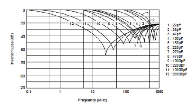

Did you add a 1-2 nF (such as film!! not ceramic) in between the two? Should improve too.
And then - - it should also be possible to bridge this nascent filter to have a minimum at double the clock frequency. At least I once made it for a TDA1543 and it worked like a charm. That said, I should revisit this old idea.
No cap between them, but I not sure if the extra capacitance will affect the distortion. I will try that.

I was thinking of using Murata's 3 terminal (LCL) capacitors in the dac to 844 and also on all power supplies close to the chips.
eg:
DSS6NF31C223, (22nf) which is -20db at 2Mhz and -70 at 20Mhz for psu decoupling and possibly a DSS6NZ82A103 (1nf) -20db @ 6Mhz in the dac outputs.
Its not helpful of Murata not to state the inductance although it can be calculated I suppose.
