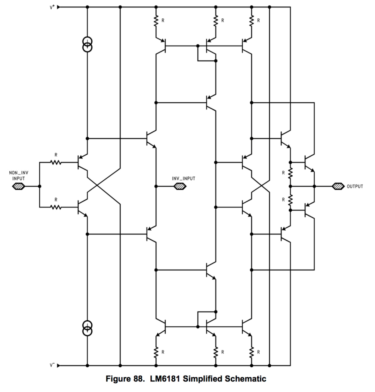

The LM6181 to me (which isn't much) looks good also on paper, but it doesn't have the magic TZ (pin 5) that the AD844 has that allows one to use it without feedback.
I feel this is one of the reasons the AD844 sounds so good. It's as though feedback in an I/V stage is a big no no, as it can get corrupted with all the HF glitches and stuff comming out of the dac chips. Please correct me if I'm wrong all you I/V aficionados that know better than I do? Because I'm going more on what's sounding better, rather than what's measuring better.
Cheers George
I saw the LM6181 in Farnell, popped up sidse to side with the AD844.
Indeed the TZ pin is missing.
attachment.php
- Pedja inputs in his discrete configuration to the inverting input. The compensation is on the input (1,8 nF). So this configuration might be possible with LM6181 too imho. Specswise: The inverting input current capability of 15 mA looks promising - quite a quantum leap over the AD844's 800 uA.

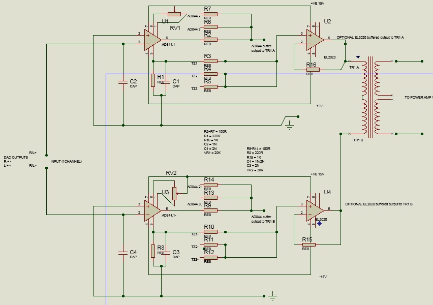

I have a Raindrop-hui dual 1541A dac reconfigured for differential working by the simple, although not perfect, method of supplying one dac with inverted data.
For the last few years I have used 100r + Sowter 9545 transformers to perform IV and convert to single ended output.
Running in NOS mode with the (SAA7220 removed) with no other filtering I am always drawn back to this dac compared to an Audio Note Dac 1 (AD1865), an ES9018 Sabre dac and a Teac PD H01 with a PCM5102 dac.
So after reading the posts in this thread I am tempted to use 4, AD844 ( 1per dac output) with (1-2n on pin 2) for IV, with pin 6 driving the transformer, 1k//470pf on pin 5.
As the primaries will be connected between the True and Inverted outputs, the 1541's 2ma offset can be ignored provided I can adjust the 844 outputs to the same value so no DC flows through the transformer. Does that sound feasible?
The next step is to connect ADEL2020s to the tz outputs and compare. (I'm not convinced a micropower opamp like the OPA627 will be ideal for driving the transformer).
Finally, stacked 844s, again comparing pin 6 with pin 5 buffered with the 2020s.
Ian

Couldn't edit my earlier post. Attached provisional schematic.
The pin 5 resistors have been reduced to 220r to reduce the voltage swing across the transformer, may need reducing further as the transformer is not 1:1. I think I'm correct in saying that the no signal volts on the tz pin will be approx .44v so provided both + & - outputs are close, DC flowing through the transformer will not be an issue. (ignore the blue line)

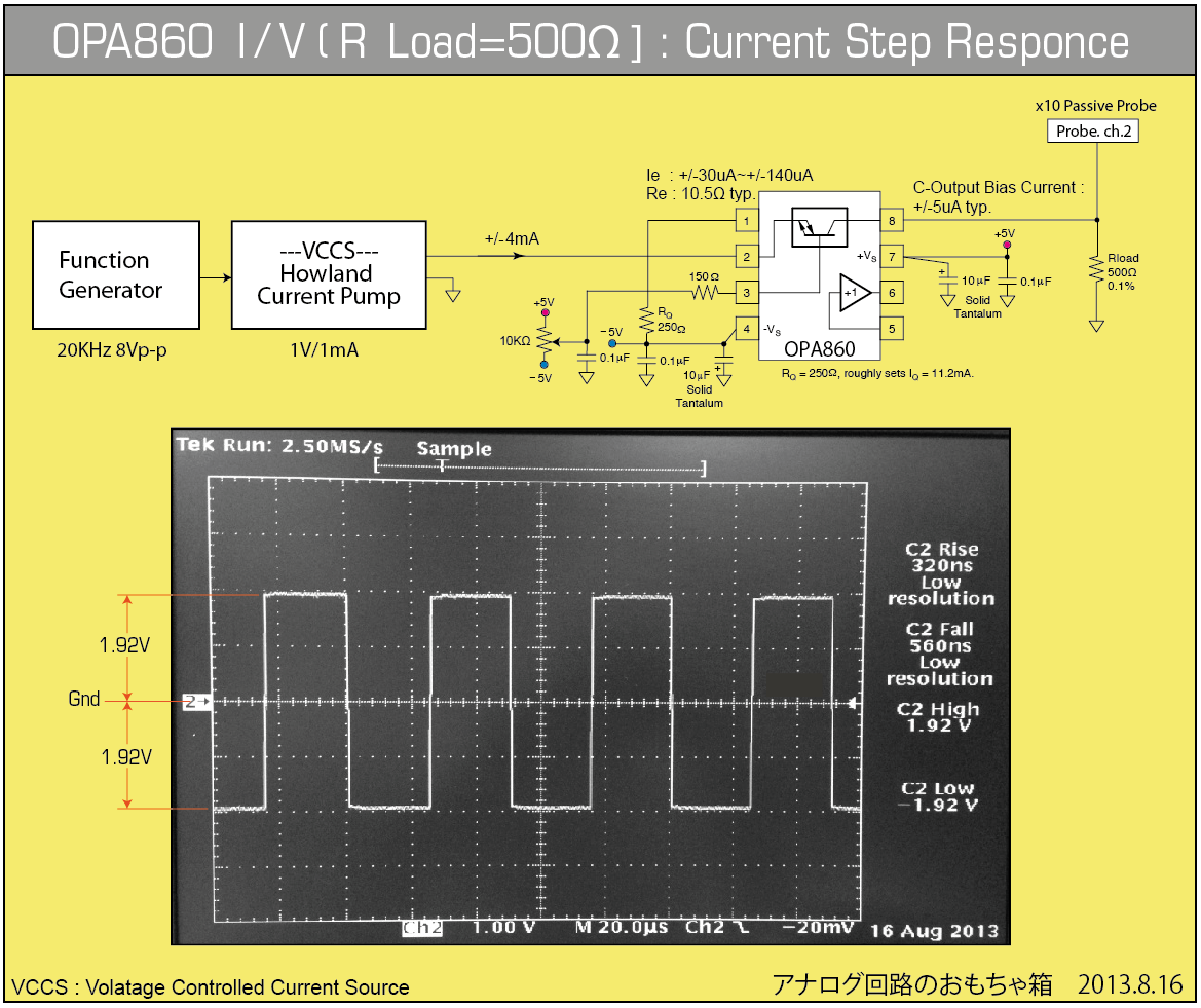

Pin 5 of the OPA860 (typo?) is the Input to its buffer ... in that it equals the AD844
Could it be that sectioned areas are externally accessible on both but one has the connections separate in/out on two pins, rather than in/out on one conjoined pin?
no typo! The OPA860 comes with buffer, the OPA861 without.
In contrast to the AD844 the OPA860s buffer input (pin5) is fully separated from the current conveyor output (pin8).
The TZ pin (pin5) of the AD844 is the common joint of the current conveyor output and the buffer input.
From the DS the OPA860/861 are the better performers with lower input resistance at the "Emitter" input and higher and tuneable bias current.
They are good for ~2.5Vrms of signal output voltage running on +-5V supplies.
Adding a external discrete Buffer to either of them -You know which one I would recommend 😉 - offers higher flexibility regarding load requirements and acoustic performance.
