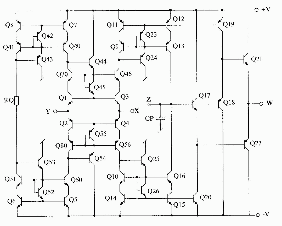

Hi again, just to double check, is the 'trans-impedance pin' on 844 same as 'external IQ pins' on other chips?
in short: No!
Pin TZ (5) of the AD844 equals Pin C (8) of the OPA860 and the OPA861, its buffer-less brother.
Pin 5 of the OPA860 is the Input to its buffer ... in that it equals the AD844.
The Iqadjust Pin of the OPAs is Pin 1
Compared to the simplified circuit diagramm of the AD844 (p13#20) its an additional input that would define the value of the ib named current sources and hence it'd set the idle current of the whole Transconductance stage.
The Q implies that the circuit function is not fully understood.
So let's go back to the AD844's datasheet, p13#20 again.
As the lower half of the circuit is the exact complement of the upper half, its sufficient to analyze just one of the halves.
The emitter of a NPN is connected to Pin2.
The idle current flowing through the NPN towards +Vs is mirrored by the four PNPs, a (full) Wilson Current Mirror, into Pin TZ(5).
The idle current is defined by the Vbe of the NPN.
Now the NPN's base is connected to the base of a second NPN whose emitter is then connected to Pin3.
Let's assume now that Pin3 will be connected to 0V/gnd.
As the NPN at Pin3 is connected as a Diode (collector-base-joint), the current source Ib forces a current through it that results in a corresponding Vbe.
At the same it forms a simple current mirror with the first NPN, connected to Pin2.
The same applies to the complementary half.
If all transistors and the complementary-half ones are matched, then it is logical that the idle currents through the Pin2-connected transistors and their associated current mirrors must match also and that Pin2 settles at the same value as Pin3.
As the emitters are low-impedance nodes, Pin2 forms a virtual 0V/virtual gnd.
So, the value of Ib defines the idle current of the whole circuit.
It is fixed with the AD844, but variable from the outside via Pin1 with the OPA86x.

Hey Calvin, WOW!! where did you get that from??? You must know someone.
I've asked Barrie Gilbert designer for it from AD for it, but he said it was lost in his archives somewhere.
Cheers George
Cheers George
I found it on my computer ... don´t know how or when it got there 🙄

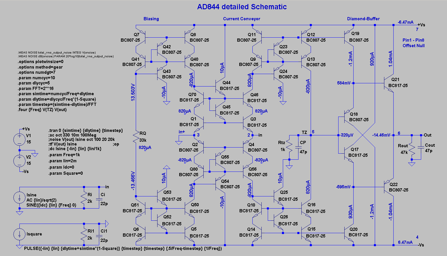

Based on the above schematic I simmed the circuit.
According the DS the overall idle current of the AD844 is 6.5mA.
The current consumption of the simulated circuit gave that value when the input transistors and current mirrors idled at 820µA (RQ=33k).
That´s lower than the +-1mA peak-peak signal current a TDA1541 produces in the upper, resp. the lower half of the circuit (we had expected that already, didn´t we?).
The THD-sim resulted in a 3rd harmonics dominated spectrum (0.0249%).
Doubling the current by halving RQ (as a equivalent for paralleling devices) reduced the THD to 0.0081% and changed the spectrum to 2nd harmonic dominated.
Reducing the CM´s idle current to 200µA (I think I remember to have seen that value claimed somewhere in this thread before, RQ=135k) raised the THD to 0.226% and the spectrum shows the uneven harmonics (up to the 9th) higher than H2.
Btw. simmed with 1mA idle current Zin was 15R, with 200µA it gave~50R, the value stated in the DS.
The harmonics distribution due to the transistors running into class-B/cutting off could explain the sonic differences between single and paralleled AD844s.

Seeing the elaborated current mirrors I at least wouldn´t want to build those in discrete fashion (pic shows a more detailed circuit of the AD844).
You need to be as hardcore as a Paradise Phonoista to put up with the transistor matching requirements. 😛
On the other hand of course the low current limits of the integrated circuit imho seriously limit the range of applications.
Paralleling whole circuits seems a rather ´plumb´ workaround.
But then from my numerous smulation runs, it seems that the CMs don´t need to be so elaborated.
They don´t improve numbers as much as expected, but are much more sensitive to matching and more prone to oscillation.
Supply voltages and level of bias currents play a more important role THD-wise.
And sonically it more than once seems that simpler can be better. 😉
