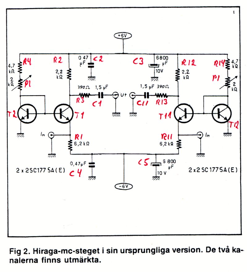

As an N-pseudo transistor device, I might suggest the N-version of Jean Hiraga's Le Prepre for using the OPA860. It would imply having the input on the emitter, and that "should have" a low impedance - lower than Hiraga's transistors (with an Rbb of 2-3 ohms the 2SB737/2SA1775 already is capable of loading a PCM1704 anyway I think in such a configuration.)
my 2 ¢
with a CFP Darlington in place of T1 and T11 You can achieve "Emitter"-input impedance values in the mOhm range using standard small signal transistors like the BC327/337.
For current sourcing DACs like the PCM179x series a PNP transistor results in a more efficient circuit (lower idle currents, lower heat power losses).

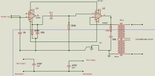

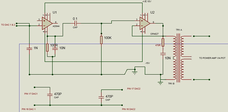

My IV converter works very well using the AD844 and OPA627 as shown below.
There are paralleled TDA1541As which are now working with none of the noise initially experienced once the dem oscillator was connected as shown.
see thread http://www.diyaudio.com/forums/digital-source/163971-parallel-tda1541a-dac-noise-new-post.html
As you can see 100r is used on pin 5, which gives a no signal volts of ~.4v (hence the need for the 0.1uf cap on the input to the OPA627 to avoid DC through the transformer.

With my paralleled dacs, as each 1541 has a 2ma offset, with no signal there is 0.4v across the 100r resistor on pin 5.
You could get rid of the of the .1uF coupling cap if you use the dc offset nulling pins 1 & 8 on the AD844.
Also you should try it without the output transformer and take the output straight from pin 6 of the OPA627, as transformer coupling will colour the sound somewhat.

I didn't think the offset nulling would work with that size of offset.
The transformer is an effective low pass filter but I intend to try without it connected, however it has a 1:5 ratio so I will need to change the gain of the OPA627.
Thanks, Ian

Yes the nulling pins will work, but look back through these pages for a post I did regarding this, as what's on the data sheet for the value of the nulling pot (20ohms) is a typo, and I gave the correct value somewhere, and I can't remember now what that was.
You also have dc offset nulling pins 1 & 5 on the OPA627 you can use. Maybe use a little on both the AD844 and OPA627
As for the transformer being a LP filter yes, but you have one already on the TZ of pin 5 on the AD844, as you have it now with 100ohms and 10000pf it's -3db at 160khz, bring this down to -3db at 80khz by either making the cap 20000pF or raising the resistor to 200ohms.
And adjust the total gain using the feedback resistor of the OPA627.
