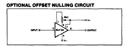

Hi George, Torchwood
Need a little advice. I can't seem to null the dc offset.
According to the schematics that I have, the trim pot is 5K
pin 1 of trim pot is connected to pin 1 of Buf , wiper of trim pot is
connected to pin 7 of Buf & pin 3 of trim pot is connected
to pin 5 of Buf. Is this correct ? Or have I mistaken it & that wiper
should be connected to Ground ?
Many Thanks

Sorry guys just to confirm does the input have to be shorted
when adjusting DC Offset ?
Thanks again

Pins 1 5 and 7 on the Buf03 is correct, wiper to 7
Thanks again
Shorted or connected to the TZ of the AD844, not open circuit.
Cheers George
