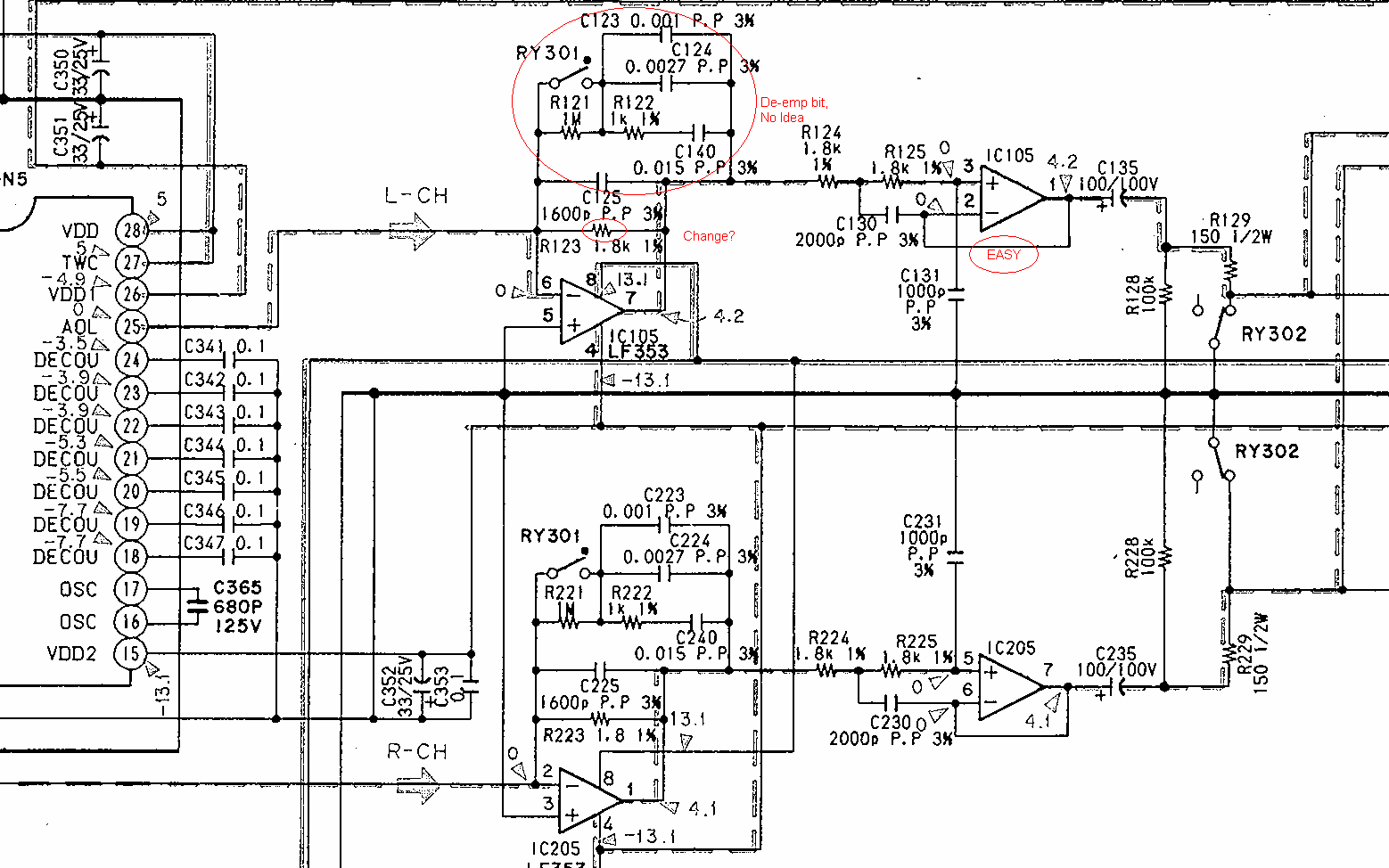

Hi, yes the 844 DS isn't very implicit at all
More questions,
1. Does a current conveyor behave like a valve in terms of saturation? (overdriven creates 2nd order harmonics)
2. What is the purpose of the second 861 in the AYAII, dedicated buffer perhaps?
3. Is 2658 direct replacement for LF353 VFB in socket? Both are Dual-Dip-8.
Dual or single regardless, if one used the existing circuits that follow a TDA, i.e. the I/V etc... In attached schematic there is the usual feedback around 1st stage but there are other resistors in series. With CFB, a specified RFB resistor is required for optimal performance. Can one swap the resistor, or does attention have to be paid to the combined resistance around entire set of components (De-emp EQ etc).
Further along, there are also relay's in the signal path, I seen mentioned they are detriment to sound.

1) tubes generate more higher harmonics than just k2.
The nice thing about DACs is that the maxmum output is well defined, so that saturation of the following stages can be avoided under all circumstances.
2) Yes
3) No, the LF353 s a rather slow voltage feedback OPA, the OPA2568 a fast current feedback OPA.

BUT the data sheet reads "output stage has been optimized to drive low resistive loads" Does this statement necessarily mean it's high-z output?
It normally means that it can source appreciable current to drive the low impedance load. It doesn't say anything about it's Zout. With the buffer and feedback, Zout is very, very low.
The 'open loop trans-impedance' of the 2658 is 180kohm. Which I think translates to "you well need a buffer unless your power amp has input impedance of more than this value".
The OL transimpedance is the impedance seen at the internal compensation cap node and is not accessible from the outside in this chip (in contrast with the AD844 wehre this 'Tz' node is accessible).
The transimpedance is important for the open loop gain but not for Zout (which, again, is low due to the output buffer and feedback, if used).
Jan

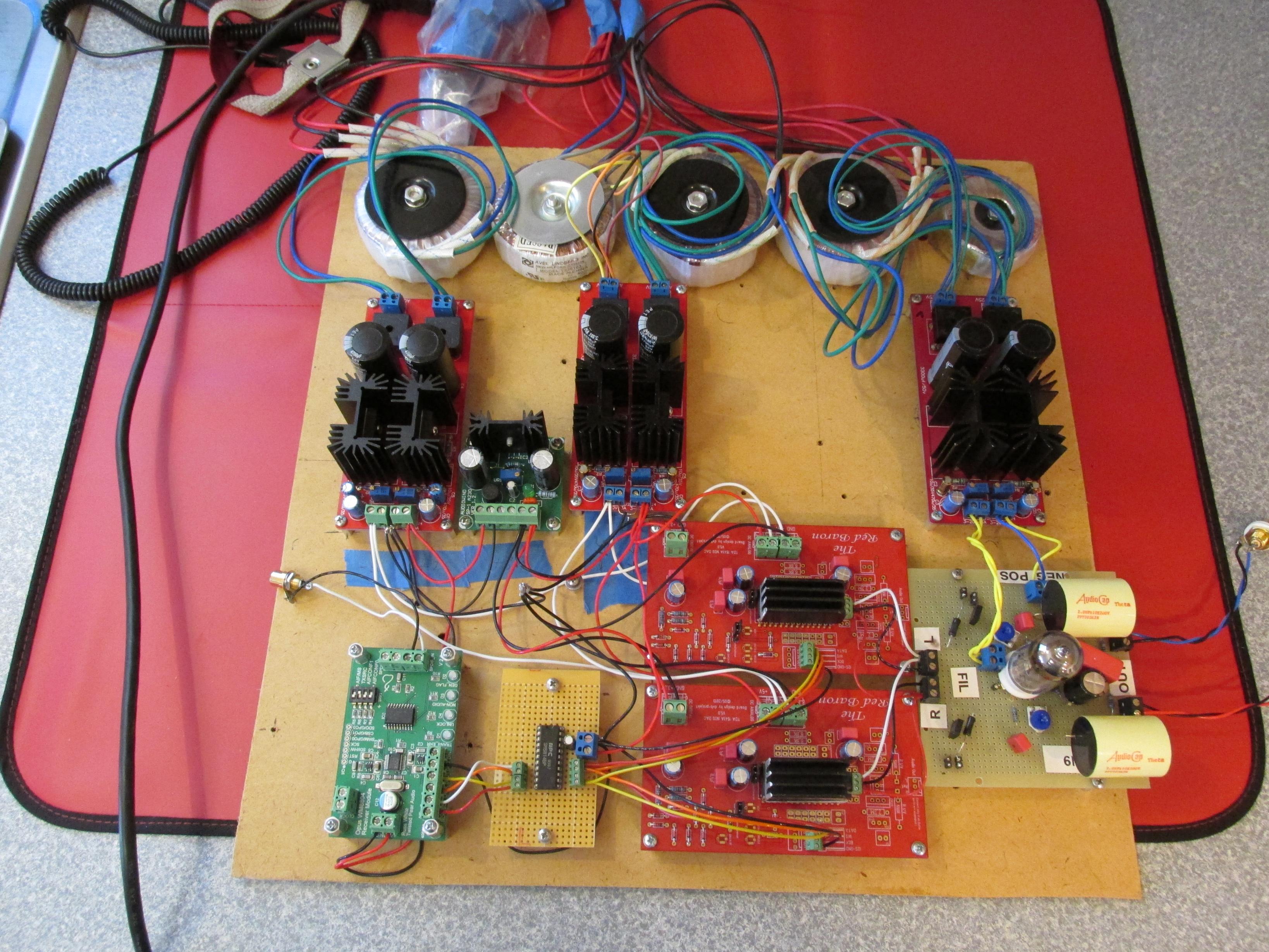

M3 Parallel DAC with tube
Hi giro, I kind of wonder what your chasing here. Tube stages are known to give richness to digital sound. An example of that is my M3 prototype. I wonder if in a sense your chasing tone. Speaking as a guitar player, every player I have ever met was chasing a particular sound. I recently pulled the M3 back into play. My interest is in finishing it someday soon. So... What does it sound like? Well I really like it's smooth play back. It has the smooth quality of the triple stack AD844 + Buffer. In fact I was a little surprised by that. The M4 (1704 + DDNF+ OPA627) has a very different sound. M2 and M4 share the commonality of the DDNF stage. So they have the same basic tone if you will. The M3 has a parallel TDA1541A S1 crowns into a simple resistor I/V (25 Ohms). The tube stage is based on a 6N27P tube in SRPP with a 2SK170 from a Swedish DIY thread. Nothing is running in saturation, plenty of head room. Yet the tube circuit is rich and enjoyable. Really sings on guitar solos. My point is you get pretty close with the triple stack AD844 + BUF03 in my case. So it is possible to get a similar sound as the tube although not it's equal.Thanks jan for clearing those confusions.

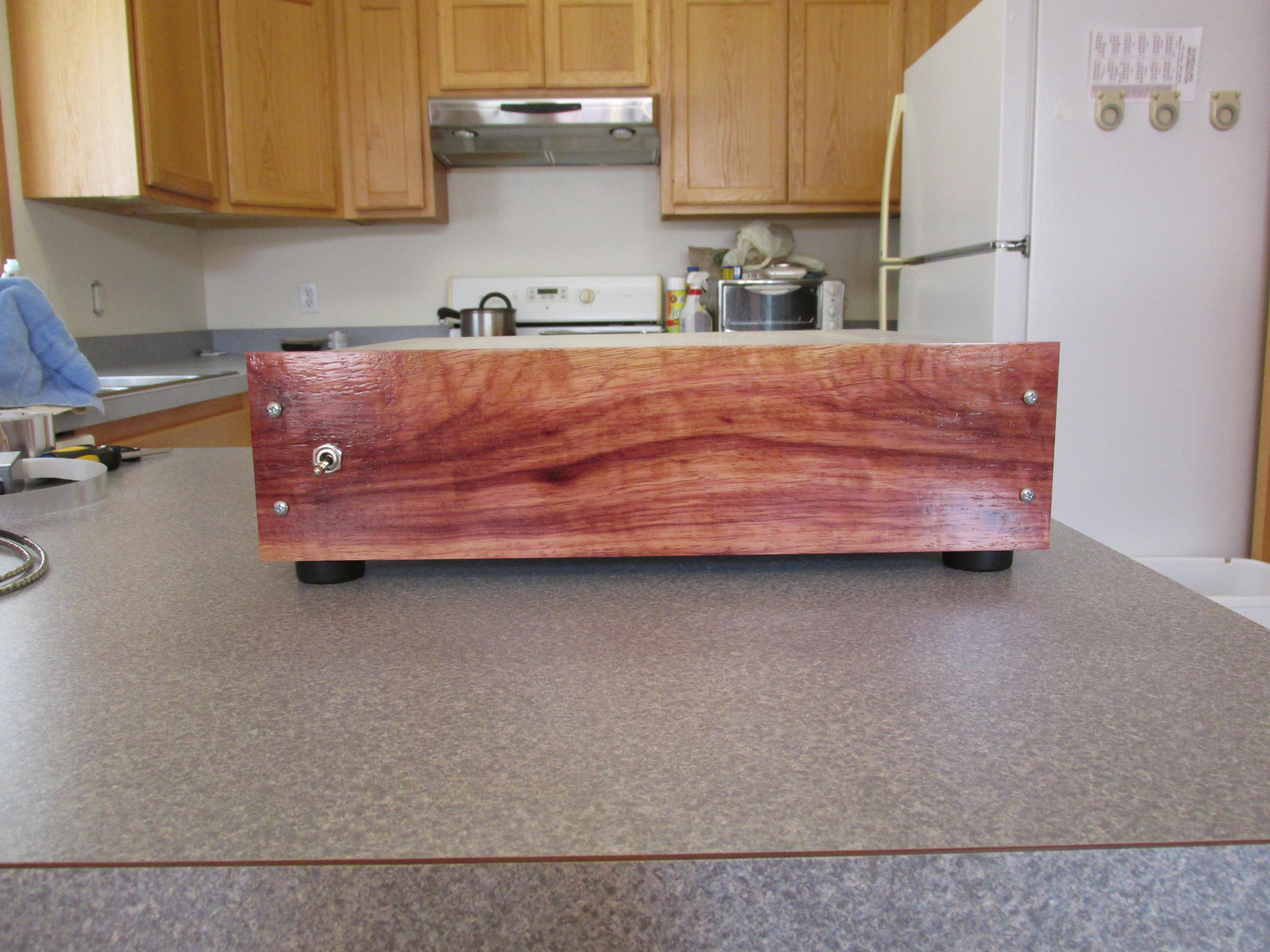

Looks great!Finished the dac today. Used a gloss finish on the African Paduk. Beautiful grain and color. Nice to be done. Can move on to the other prototype the M3.
Myself, I planned this week to alter the TDA1541A S1 setup of my CD player. No too exclusive parts, but a nice AD826 for each channel, along with some other mods collected from this forum.
Resistor I/V
In my experience, the I/V resistor is critical. ECDesigns championed the Moebius resistor and hand wound them in a non-inductive manor. The next best that I could find was the Rhopoint Econistors. That is what I used in the M3. Making my own non-inductive resistors is not something I would attempt. I'd love to see someone do a study of I/V's with test results. I don't have a device for spectrum analysis or a distortion meter to attempt that. So all I can do is use my ears. Thus expressing an opinion based on what is available to me.
