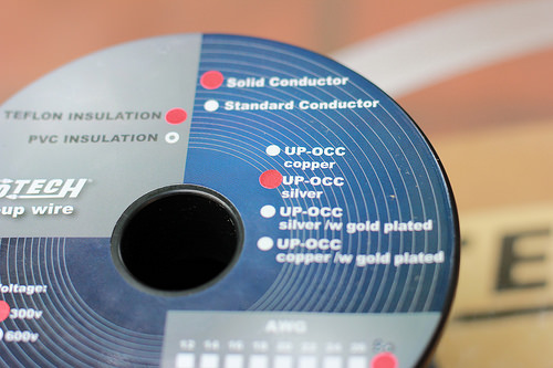

I'm trying to find a way of making up a pair of interconnects for my turntable, also would like to try some digital cable. That RG179U Silver Teflon FEP seems impossible to source unless you want to buy a whole reel. The RG179U Silver has a copper plated steel core, is that right?
Thank you all for your advice on hook up wire. I found two types that I can obtain
20awg tin plated ofc inteflon jacket
30awg pure silver OCC wire in teflon jacket made by neotech
both are solid single core
Already order the first one but the silver wire looks interesting too just a bit small.
