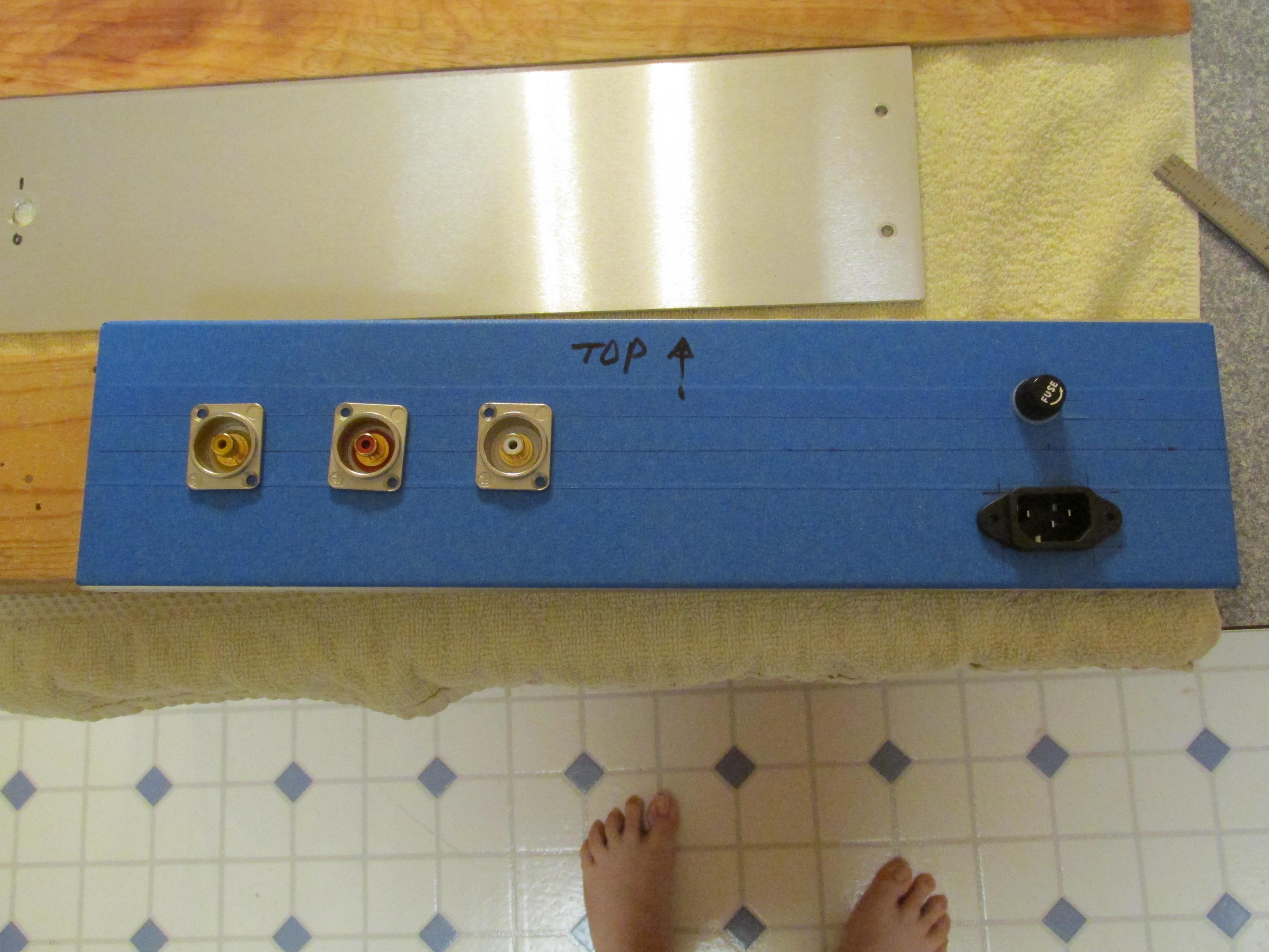

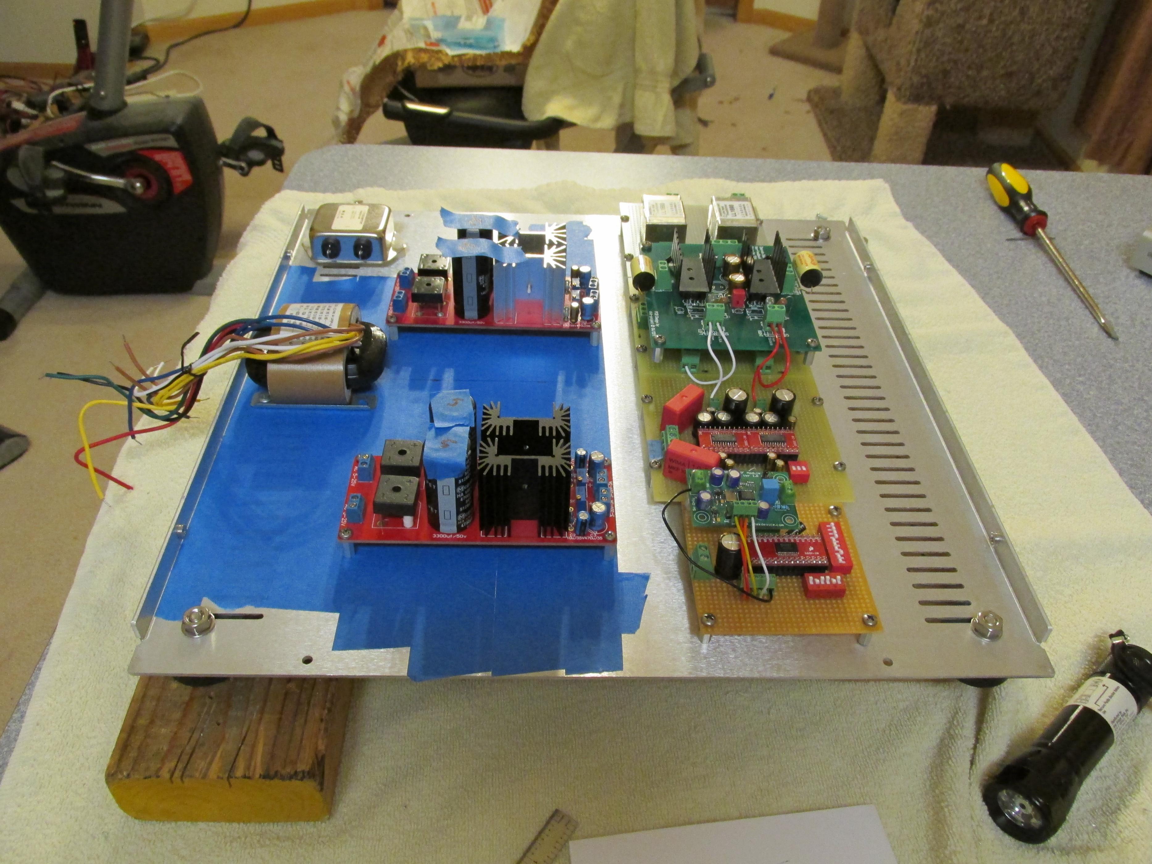

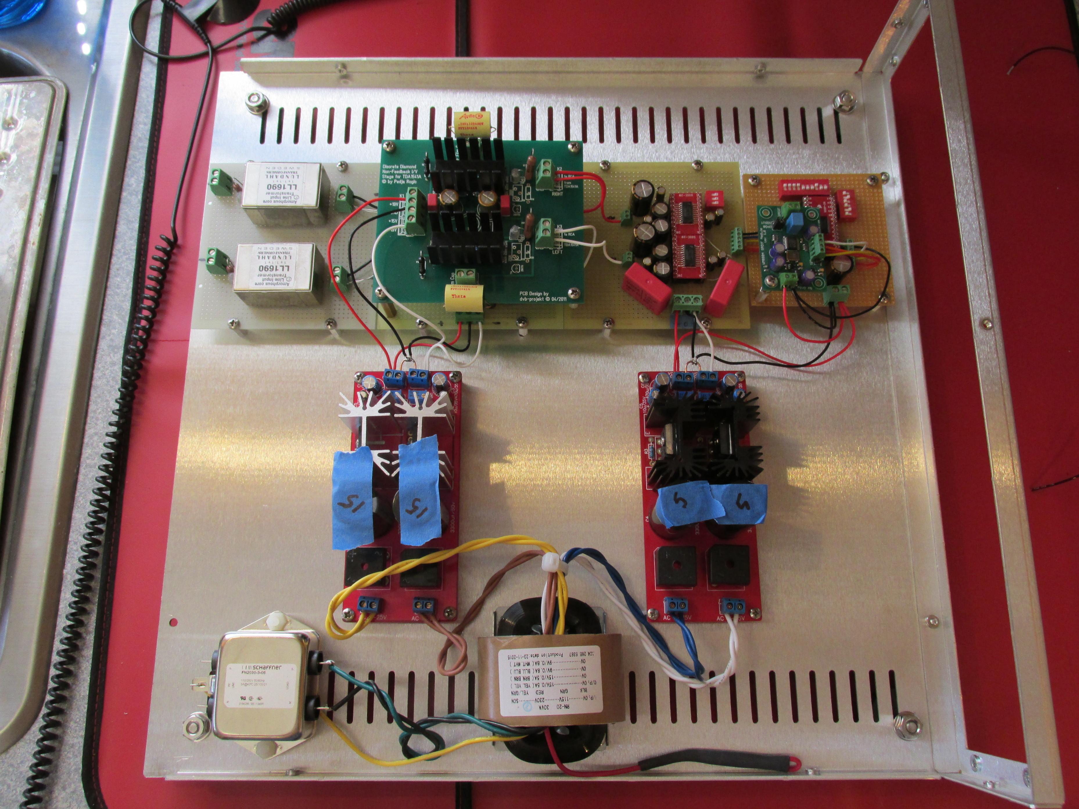

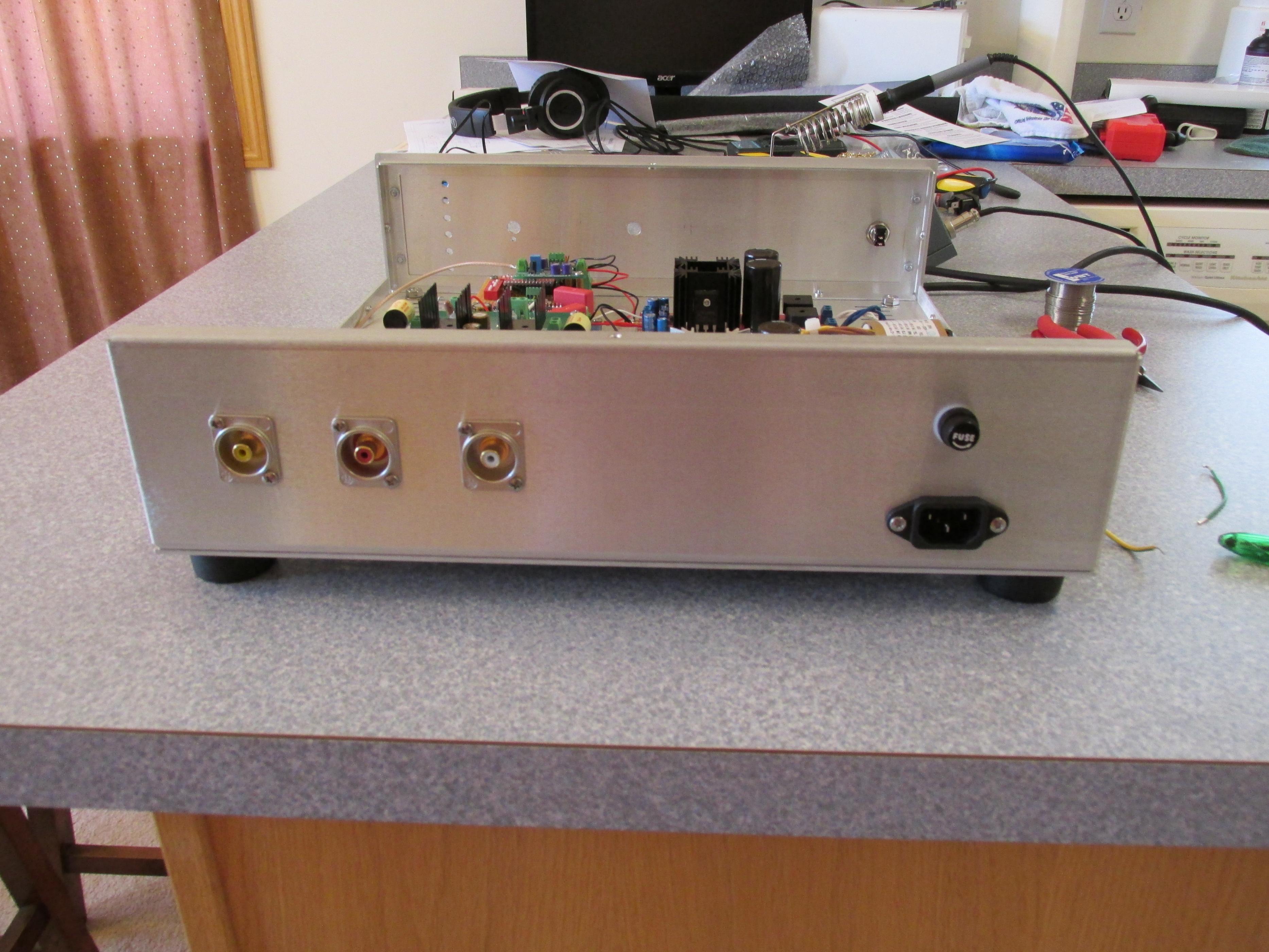

Some progress on the final build. Estimate 30% complete. In case anyone is interested. Big sucker like most of my builds.

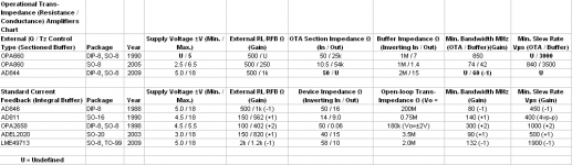

Impedance is tricky to discern from datasheets, for example I might try OPA2658 in place of a common dual NE opamp, perfect fit, low-Z input, ok current handling (for 1541). BUT the data sheet reads "output stage has been optimized to drive low resistive loads" Does this statement necessarily mean it's high-z output? The 'open loop trans-impedance' of the 2658 is 180kohm. Which I think translates to "you well need a buffer unless your power amp has input impedance of more than this value".

Here's a Tz-Amp spreadsheet which should prove useful for DAC matching, if anyone spots discrepancies on it please feel free to correct it. It's an Microsoft .xls attached in the ZIP. The top three OTAs were tricky to define.
Hopefully I am right in thinking they are the same basic topology with External |Q control.
