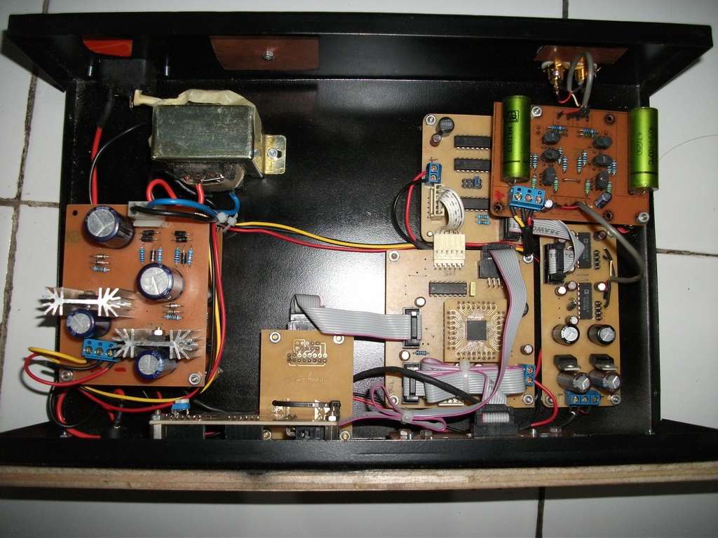

Yesterday I finally found the time to perform surgery on my CD player, a CD880.
Among the NE5532 opamps I exchanged for the AD826's (and sockets!) also other work was done. Decoupling by chokes instead of resistors, increased caps (Vrefs of the TDA1541A S1 now have 3300uf muse gold caps) and a DEM-mod (thanks to the excellent thread by John of ECdesigns).
I choose the approach of listening, implementing a single mod and listening again and kept record of my findings.
Work sequence:
1) SAA7220 powersupply modded. Cleaned up some mess and relaxed the soundimage somewhat.
2) DEM-mod. Added more subtility and detail to the soundimage.
3) Power supply TDA. Losing some of the harshness and a more coherent sound image.
4) AD826. Game changer... soundimage now is dynamic, relaxed and "analogue", no harshness at all.

Hi esgigt, That is excellent. Make a change and then a listen. That is what I do as well. John ECDesign's has done use all a great service. I use his decoupling method. John actually moved away from locking the DEM to the bitclock. Myself I use 120 pF between pin 16 and 17. That puts the DEM at 705 Khz, and that will sync up with the bitclock. However there is nothing wrong with his earlier DEM mod. Power supply is critical because the SAA7220 is actually rather poor. Sadly the only game in town in a CD player. AD826's are an excellent choice. I'd let things kind of settle in before making any other changes. Enjoy! 😀

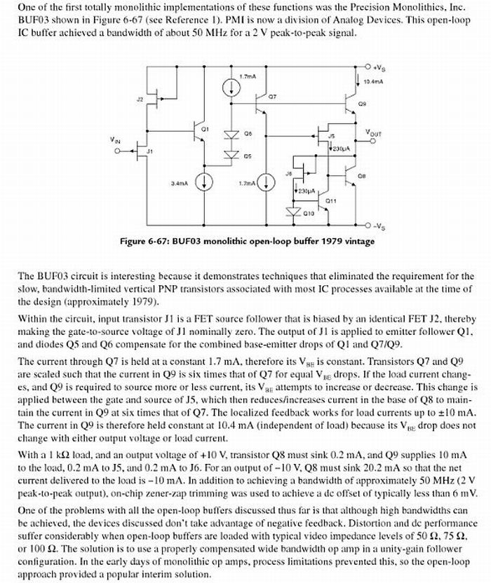

Eh, I think the point was missed completely.
When transistor is overdriven, the wave clips (approaches squarewaves).
I presume VFB OpAmps do this. What about current mirror section on 844 OPAmps though? Does it show 'gradual' non linear distortion when driven to extreme, similar to some certain tubes do? Apologies I was not clear enough earlier in my question.
