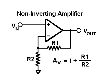

Hi, Buffer function is a non-inverting connection. So in pin 3 (+ in). Feedback resistor pin 6 to pin 2 (- in) and a resistor from pin 2 to ground. I used 2K Ohm as I had some in my parts bin. So you need a total of 4, 2K Ohm or similar equal value resistors. I'd use as series resistor going into pin 3, 100 Ohms to 1K ohms. Think of it as a gate stopper. Let me know if you want a sketch... 😀this thread is very interesting to the point that I also am going to experiment with the use of AD844 so as it developed in the thread along with the chip 1704. A question. If I wanted to use the OPA627 as a buffer with gain = 2 what schematic should I use?
I need details. Pin 6 excluded. Output on Pin Tz. I think I understand it must be placed a R 200 K .... what Pin of OPA627?
I understand now G=2.Easy picture. Reference datasheet for pin outs.
From the formula Av = 1 + R1 / R2.
then a R1 much more 'high may be used.
And of course R2 = R1.
Many thanks Torchwood
