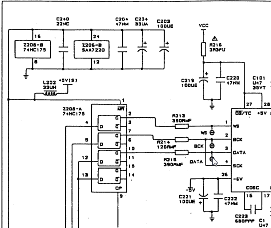

SAA7220
NOS is a good work around for the really bad SAA7220 filter. I use the NPC SM5814. I am still able to use Pedja's developments to good effect. My current experiment the PCM1704 + DDNF + BUF03 is the most natural you are there experience to date. Some can get away with minimal filtering. It is really system dependent. George can take advantage of that. My system doesn't really sound good with just a 6 db / octave roll off. My speakers have rather large ribbon tweeters and so I am forced to use a passive 2nd order filter. Usually based around a Cinemag 600/600 transformer. In my experience the passive filter does less harm then putting it through some active op amp based filter. Those color the sound more then I like. Of course your experience may be different as no 2 systems in my experience are the same. 😀Hi Torchwood

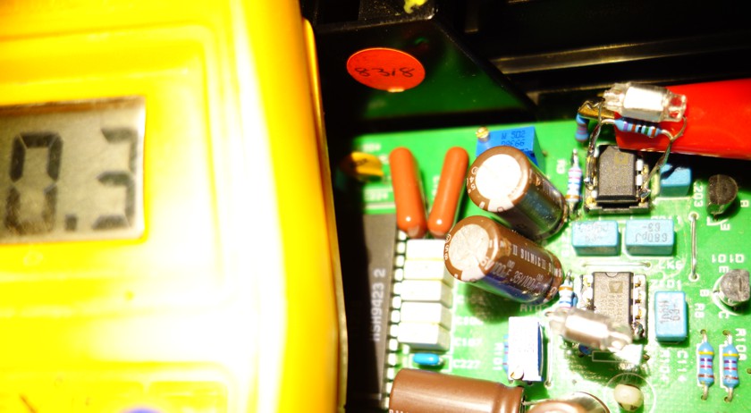

bias and pilot test w single AD844
well checked the existing bias now. The voltage divider resistors let approx 1½ mA through to the TDA1541A out. No measured offset at current opamp input (due to virtual ground). BUT approx -0.6V across the 1k feed back resistors. So looks like the opamp is supplying the remaining bias to the DAC.
So exchange the lower 4.7K voltage divider resistor w a 5K fine trimmer. Should always be able to bring me back where I were - but also be able to open up the current by lowering the value. Monitoring the feedback resistor voltage I am able to null it. Good. Sound now? only subtle change - if any thing bit leaner bas and slightly brighter top = wrong way !
Now clipping the feedback resistor open & soldering 1.5K + 1nF across pin 3 and 5 of a single AD844 = drop in package. test the input offset now (as rtreimed previously w the LT1028 in place) = 0.3mV not too bad -> then fine trim to 0 (see attached photo of PCB)
Initial sound impression single AD844 = body in bas is back! = good. mid and top similar to LT1028 (maybe little more held back). SO resolution is similar but air and space a little less than LT1018 - also slightly less involving (bad!.. but ok I'll let it sit and burn in)
Next step make a 3 stack drop in package and see if that makes it better. If that works, see if can route pin 5 over to pins 6 (wrt drop in to the socket).

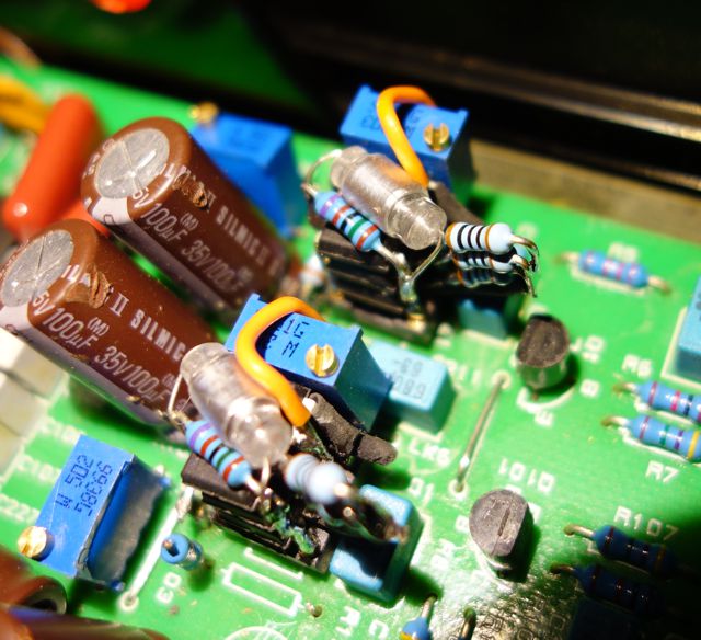

'ratpack' a 3-stack?
so just had little time yesterday to 'weld' a 3-some package together = full drop in on the opamp socket w all the support netw needed (only chnage to original is cutting feedback resistor open). See photo.. not beautiful, but compact
Had no time to adjust the trimmers etc as I was packing for a 1week trip to cottage - anyway had a quick listen - and compared to the single ad844 = yes more air and top refinement .. still bodyful bass.. so is in the direction of sound picture I want, good
Now your discussion wrt caps/active filter or not.. the ARcam 5+ does have 3-4 high quality PP caps w filter coef adjusted for the 4x OS .. so don't think they will bother in the audio band really (compared to my amps: Exposure VI/VII & super VIII, which are 'voiced' deliberately w lytics and tants in the signal path to get its sound..yes I like color and these amps make the feet stomp). ANyway I will try to wire the pin6 directly to the RCA and see/listen
AND later pin5 through the output chain of the Arcam (deemp+filter and all)..might remove the big coupling cap if dc-trim is effective (but not so critical as amplifiers as ac-coupled). The only low input impedance opamp in my collection is the LT1028, the other BJTs lt1357 and 1363 are 5-20Mohmish ..the FET a lot more..so for buffer/filter I will roll between these ones (OPA1611 might be the closet to the OPA627 you talk about)
Now the dig filter SAA 7220 being so bad? - well seems a lot to do w its current demand (->dirt on power lines) and non optimal 'hook up' in traditional designs. The arcam 5+ has a separate clock split to filter and dac - and the SAA 7220 output gets gated/reclocked before going into the tDA1541..so don't think it is all that bad. Yes I might clean the supply lines little more - might tune the impedance from reclock to TDA.. and read something about reclock DEM? (pin 16-17 on TDA1541, what ever that does?)..
but is this really worth the bother? (well as no higher quality drop in filter replacements boards are available for SAA7220, are there?)
/Patrick
