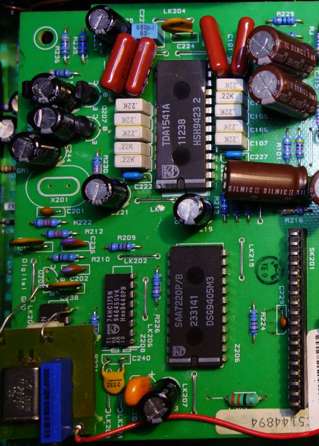

Hejsan Mayday, är i min stuga i Värmland nu så inte så långt bort i värden (sorry folks a little 'hillbilly talk')- yes if your board is a drop in sense that it has a pin out that could just mount in a socket the saa7220 occupies now = yes I would be eager to try (and thus buy board form you if any available)..as I don't think i want to go the NOS route
tack (again 'hillbillysh')
/Patrick
DEM
Hi Patrick, DEM... The capacitor at pin 16 and 17 are for the internal DEM oscillator in the TDA1541(A). The frequency of the DEM clock is dependent on the capacitor value. I use 120 pF PPS or silver Mica so that gets me a lock with the bit clock around 200 Khz. ECDesigns at one time championed a method where the clock was locked to the bit clock. He has abandoned that these days. He is using a very large capacitor value. You can find all that with the search function on this forum. I still like the 120 pF high DEM oscillator frequency. Some think that locking the bit clock and DEM clock are a bad idea. There are some papers on that subject as well as a Swedish man's website. Easy to find with a Google search. My take is why throw samples away? SAA7220... It is bad however if Arcam has cleaned up the supply it might be passable. I have yet to see a good implementation of that chip. Arcam's are not common here or at least I have never seen one. My big issue is it really isn't 16 bit, 12 more or less. So I opt for the better math precision in the SM5814. 18 bits.... It isn't something you can pop into a CD player. A standalone dac, yes. Drop in replacements for SAA7220... No. It is I2S in and I2S out. No digital filters have that except the SAA7220. The SM5814 is rare in that it can output I2S. Needs Sony mode in. 2's complement, MSB first, right justified data. In the old days we delayed the signal like 17 clock cycles and inverted another signal. Trouble is it is easy to hear. Not in a good way. 😱so just had little time yesterday to 'weld' a 3-some package together = full drop in on the opamp socket w all the support netw needed (only chnage to original is cutting feedback resistor open). See photo.. not beautiful, but compact
Had no time to adjust the trimmers etc as I was packing for a 1week trip to cottage - anyway had a quick listen - and compared to the single ad844 = yes more air and top refinement .. still bodyful bass.. so is in the direction of sound picture I want, good
Now your discussion wrt caps/active filter or not.. the ARcam 5+ does have 3-4 high quality PP caps w filter coef adjusted for the 4x OS .. so don't think they will bother in the audio band really (compared to my amps: Exposure VI/VII & super VIII, which are 'voiced' deliberately w lytics and tants in the signal path to get its sound..yes I like color and these amps make the feet stomp). ANyway I will try to wire the pin6 directly to the RCA and see/listen
AND later pin5 through the output chain of the Arcam (deemp+filter and all)..might remove the big coupling cap if dc-trim is effective (but not so critical as amplifiers as ac-coupled). The only low input impedance opamp in my collection is the LT1028, the other BJTs lt1357 and 1363 are 5-20Mohmish ..the FET a lot more..so for buffer/filter I will roll between these ones (OPA1611 might be the closet to the OPA627 you talk about)
Now the dig filter SAA 7220 being so bad? - well seems a lot to do w its current demand (->dirt on power lines) and non optimal 'hook up' in traditional designs. The arcam 5+ has a separate clock split to filter and dac - and the SAA 7220 output gets gated/reclocked before going into the tDA1541..so don't think it is all that bad. Yes I might clean the supply lines little more - might tune the impedance from reclock to TDA.. and read something about reclock DEM? (pin 16-17 on TDA1541, what ever that does?)..
but is this really worth the bother? (well as no higher quality drop in filter replacements boards are available for SAA7220, are there?)

If it is a CD player it won't work. Standalone dac you can make a work around. See my other response. My name is Dave...😉Hejsan Mayday, är i min stuga i Värmland nu så inte så långt bort i värden (sorry folks a little 'hillbilly talk')- yes if your board is a drop in sense that it has a pin out that could just mount in a socket the saa7220 occupies now = yes I would be eager to try (and thus buy board form you if any available)..as I don't think i want to go the NOS route

Hi Dave
thanks for clarifying. OK see, so its a BIG board/work if anything would have to be made wrt true SAA7220 drop in : first a I2S to Sony (2s compl.) conversion -> then into SAA7220 + possible extra support/conversion stuff (same or different logic 5v TTL?) and pack/map all that into a footprint w a SAA7220 pin-out to the outside world. Well is way beyond my skills and time. So I stick w the BAD and maybe do a little more clean up around it to 'beautify' it.

Hi there fellow norseman 🙂
Or whatever they called us back in the "day".
No, it's not compatible as a drop in replacement in the socket.
I don't know of any IC that would fit the bill for that, Dave might though.

Hejsan Mayday
if I understand you correctly, the board you have now has it own interfacing..but 'piggy backing' that on top of a bedding board w the SAA7220 pin out might be possible? The 2x+ and 2x- supplies you talk about is another board right? . The CD player has enough free volume behind the drive to put a dedicated PSU in.
Your 5cmx5cm board should fit and even your 9.5cmx8cm board might fit (see photo) as I could lay surrounding lytics down (and if same was possible on your board) - it being elevated by socket (not done yet) and a bedding board. Quess I have about 3-4cm free height above socket (will measure when I get home next week).
So If I understood you correctly and you think it is a feasible task for PCB design beginner to draft a bedding board layout -> SAA7220 pinout = then I am still in wrt your board (assuming reasonable cost so it does not 'drown' all the other parts I have in now)

PS I just now notice I have P/B version of SAA7220 which should be the better (sounding) one as designed w only 0.5% bias (P/A was w 5% bias) and this put less stress on the interfacing to TDA1451. SO maybe that's why it really sounds pretty good as is. But since I now have rolled the sleeves up wrt modding - might go all the way possible w/o splitting the current Arcam audio board to pieces.
I'm sorry, I think I need to write after my coffee kicks in.
No, unless you can "hack" the signal from whatever IC(s) are between the transport and the SAA7220P, and make it compatible with 16-bit right justified (IIRC), you won't be able to use the sm5814.
Atleast not to my knowledge, limited as it is.

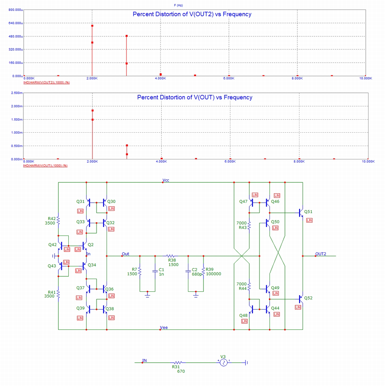

Very good work Torchwood, I can't remember where I got it, (maybe Borboletti??) but here is a discrete version of the 844 if someone has the time to play around with it.
Cheers George
Cheers George
Cheers George
Very interestesting, I'll have a look at that schematic.
Any idea which BJT's are used?
that's a rather basic schematic, good for circuit analyzis.
There are several points this schematic may be more elaborated, starting from omittance of -for many applications- unnessecessary filter parts, decreasing the stage's input impedance with a CFP, or adding dc-trimming or dc-servoes, or changing to cross couling the output buffer, etc etc.
One could use the dual matched BC847(suffix BS or DS) from Diodes, NXP etc. throughout or dual matched versions of the BC807/817 for the current mirrors.
If one needs more power for Q51/52 the Zetex/Diodes FZT651/751 are fine.

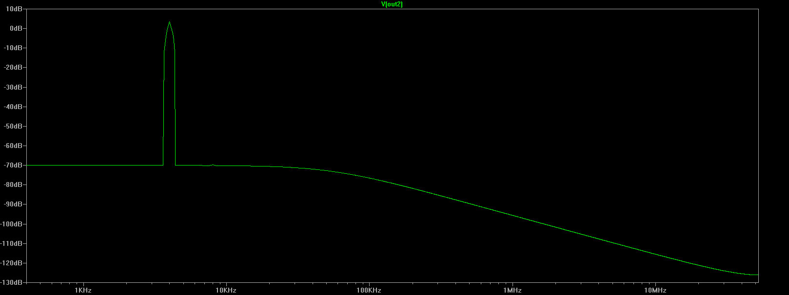

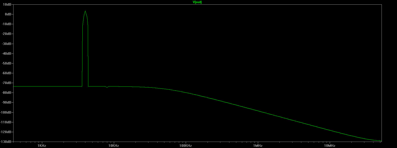

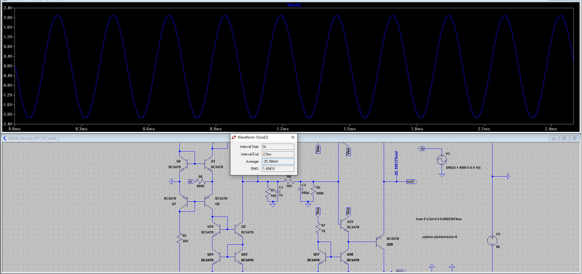

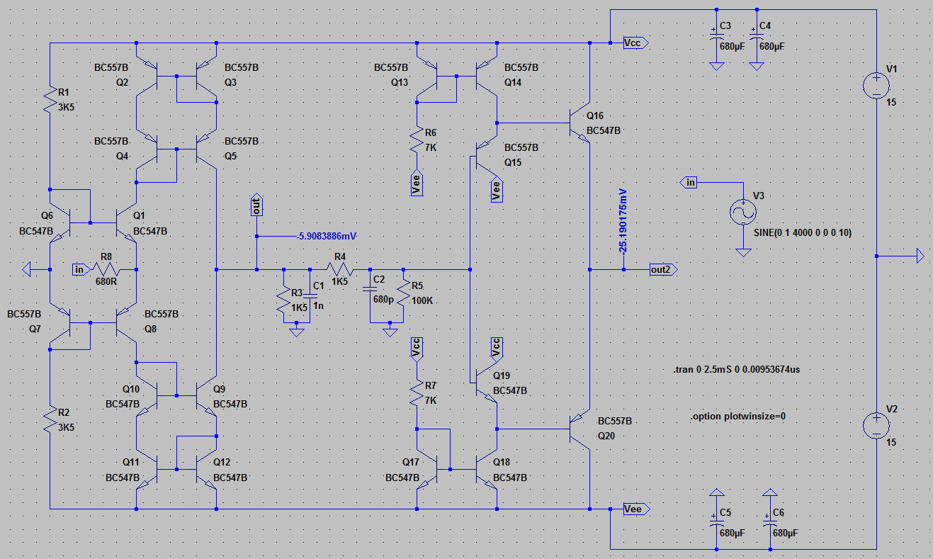

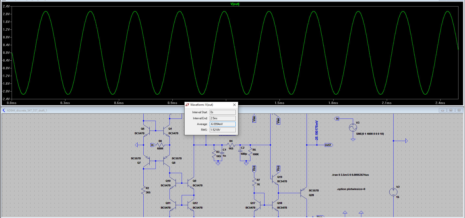

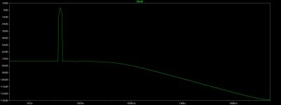

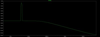

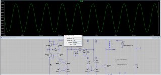

I simulated the circuit more or less as is. I did swap 670R on the input to 680R and added 2x 680uF per rail.
I used BC547B/557B for BJT's.
Rails: +/-15Vdc
I did transient and FFT for out1 and for out2, assuming out1 would be TZ pin of the IC?
Rails: +/-15Vdc

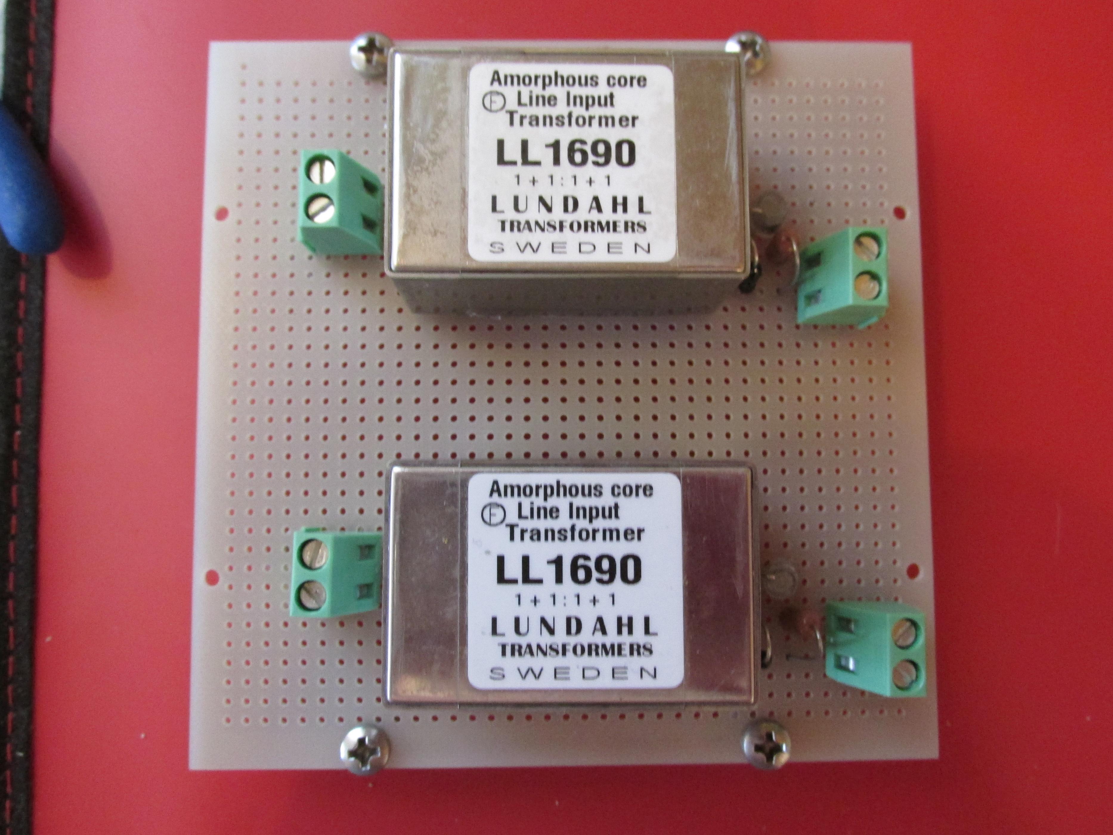

Lundahl based filter
I was wrong about the Lundahl LL1690's. Had to adjust to 3n3 Polystyrene capacitor. It is better in every way, clean, loud, dynamic and more resolution. I had to figure out how to get a 2:1 step down. Funny thing is it seems just as loud as the Edcor's at 1:1. 😱Took the dac over to my cousin's on Monday. We listened to it for several hours. He has the Acarian Alon 4 loud speakers, Bride of Zen balanced pre, and a B&O Cold amp with input board revisions. The sound was very much what I heard in my system. Always nice to get a second data point. Ordered an R core power transformer and looking at enclosures for the new dac. I changed the output tap on the transformer based filter so the Edcor is doing a 2:1 step down. Sound quality remained and level dropped to what I need in my system. Considering trying Lundahl LL1690's this week from my defunct CS4398 dac. Actually I can't think of anything that would improve it in all honesty. 😉
I told you I thought they might sound better.
I guess there's a reason people like them, I'll have to treat myself to a pair of Lundahl's one of these days.
