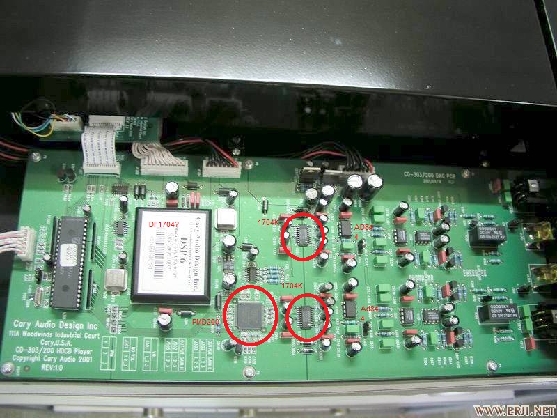

I prefer the PMD200 on HDCD recordings. (is this nos as the upsamling light is not on just the hdcd light)
On standard redbook I just prefer the upsampling mode which the upsampling light comes on only.
As far as doing NOS I would not know where to start or if it is possible attached is a pic of the board.

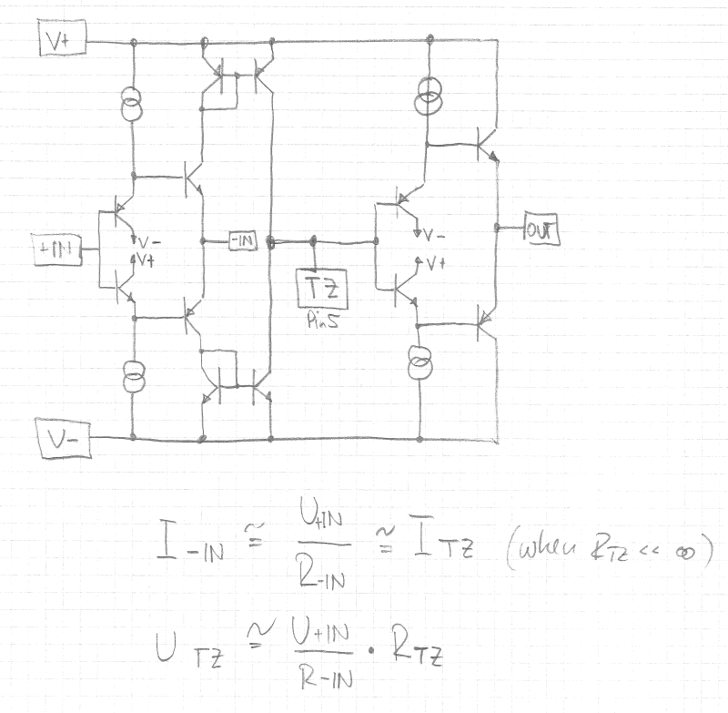

He goes on:
Carlos, yes I will look at input network. Charles gave the hint that input offset currents may be an issue with this chip (it has no differential input, and is bipolar). So, a current injection/sinking will be required too...reminds me of your AD815 and the issue is essentially the same.
Jam, what do you mean with "a buffer after the pot"?
There is one, the internal diamond buffer of AD844. It could be replaced by an external one though, as PMA explained.
If it could be done as I have drawn, the potentiometer is in fact "isolated" from the input as well as from the output. It essentially only loads the TZ node, which is no longer a high impedance node and therefore gain of the op amp is reduced. When the TZ node is at 0 Ohms to ground, the output voltage is zero...

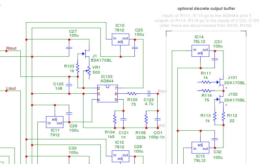

And here's a fuller schematic of Pedja's 1541 AD844 IV with buffer:
And George, note the simple buffer! It's the classic dual 170, start with something like that instead of trying to fix/upgrade that internet crap buffer.

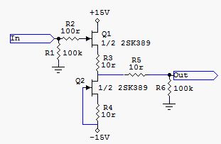

I like this one (classic Curl buffer?):
Tweeking R3 you can get very low DC offset (20 ohm good trim pot) . And I just got some SOIC LSK389! 😎
And here's a fuller schematic of Pedja's 1541 AD844 IV with buffer: He is using pin 6 for the output which is the internal buffer and he has it capacitor coupled which I don't need
I use abrax alitos circuit for nulling the dc offset and it hold perfect to .1mV Cheers George
I see now I was looking at the wrong side. But what I have now is there, I'm just trying to get the most out of it with making something from scratch.

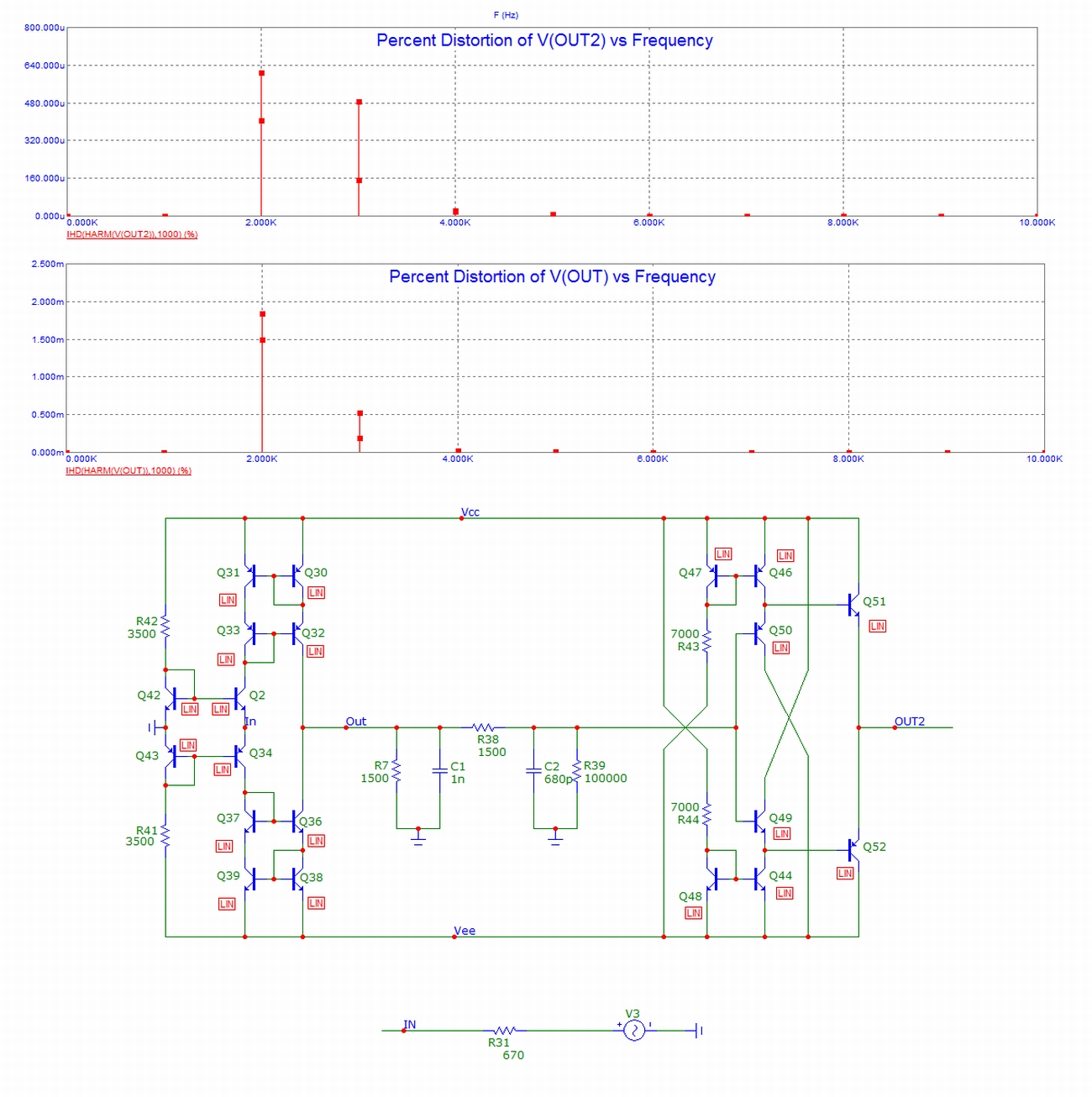

Y is in milli/micro percent. The top THD chart is for I/V + buffer, the bottom one is for I/V alone. There is some distortion cancellation happening, at least in the sim thus allowing us to get a better 2nd/3rd of the circuit. As i look at it... the first stage performs rather close to original 844 so it's doubtful whether the discrete will benefit from anything but low costness. The "double dot" bars are for 20c and 70c temperatures to see the temperature stability. The 20c is the lower "dot".
The THD could go lower on 15v/18v rails. A bit of current would do the same - but i have no clue how much current won't overheat the stuff. I have thermal compound ordered to cover the PCB + heatsinks + thermal matching of transistor pairs/whole circuit.
I hope to get away without degeneration resistors as i don't like 'em - they take too much space on the PCB - long traces, lots of EMI pickup.
Measured at 1kHz sine, 4mA swing (tda1541).
There should be a servo to keep everything in place and DC-coupled.
