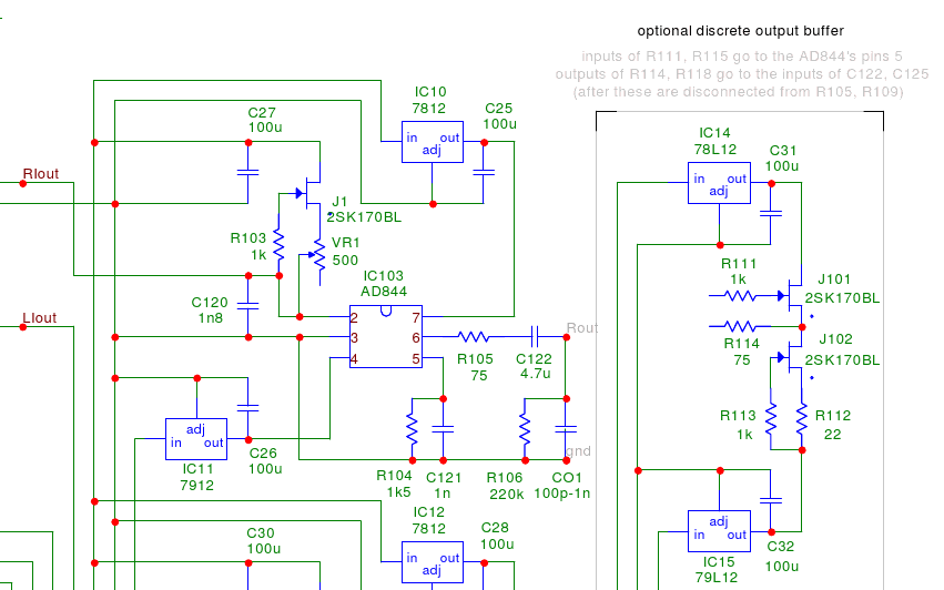

TDA1541 resources from the thread:
(I'll be lookin' into this soon ...)

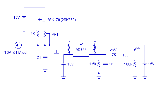

I'm not sure what to set the current source at for the 1st hookup? 1/2 way?
Circuit to try after the AD844:
http://www.google.com/url?sa=t&rct=...RlHNoW8V3Xgq5Er4eTSsg&bvm=bv.1357700187,d.aGc
PS Hey Dirkwright, can you post that ad844 tina file? Thanks!

Is the quality of i/v resistor important in these schems in relation to a full passive i/v shem with one resistor just after the dac chip?
Is there need to a little value resistor in serie to the input of ad844 for damping even with the low current output of the tda1541 ? (rhopoint wirewound or good surface mount?)

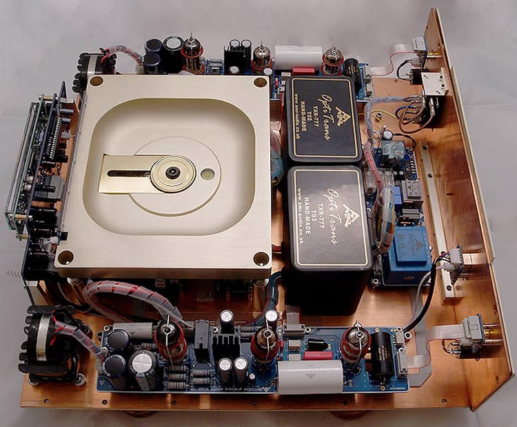

Hmmm, ya that's why I asked. I don't know the details of the tube output stage of the AMR but tubes sometimes have trouble with under 10k and may even want 20k.
The AMR has 100ohm output impedance this should have no trouble right down to even 1kohm, and I maybe wrong but it may have a solid state output buffer and the tubes are just for I/V duties.
Even if the output buffer is tube they are specified by AMR at being 100ohm output so no trouble driving anything.
Cheers George
Just found this, yes it does look to me as, tube I/V then then tube L/P filter then tube output buffer, with a couple of massive coupling caps on the output and between the L/P filter and buffer. Doesn't look like there is a coupling cap between the I/V and L/P filter unless it's one of those electros?
Cheers George
