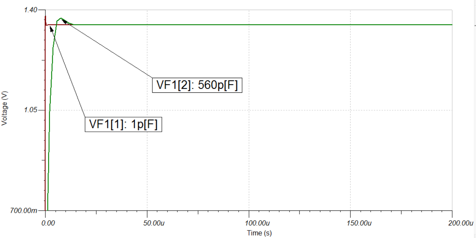

Thanks Jeff, but I have my doubts whether siming it will show anything, as I think it's a stability issue only under musical dynamic conditions. As it looks perfectly stable on the crow with all test waves either way. I believe the 570pf is sending it into slight ringing, as audibly it 's giving the opposite to what you would expect, sweeter without the cap. And I forgot to mention with the 560pf capthe DC offset absolutly stable to within .5mV Without the cap it can wander just a touch more, still very good.
Cheers George

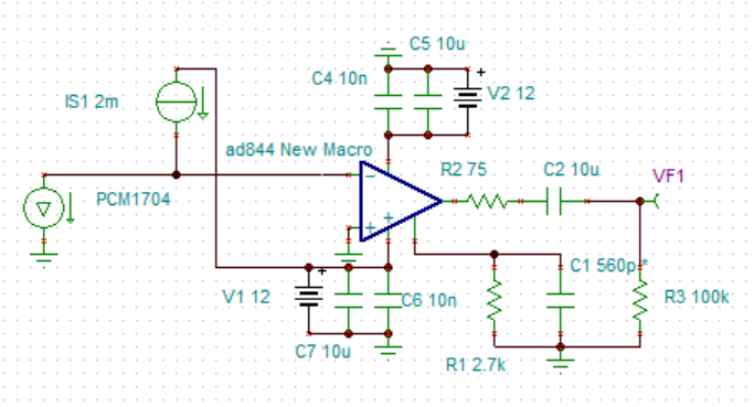

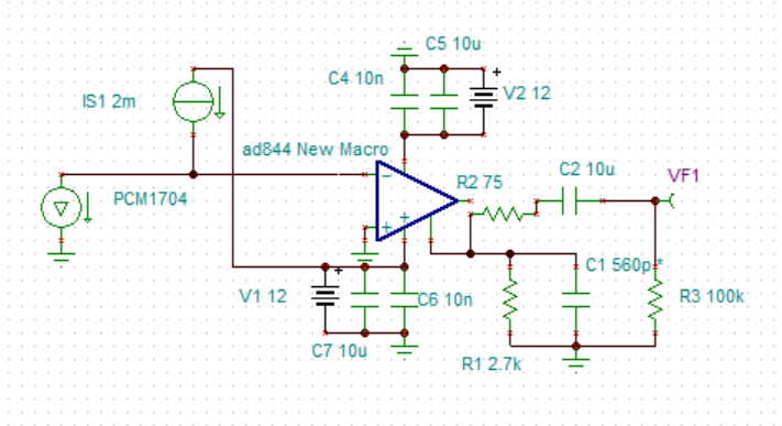

PCM1704: current output DAC, dual mono, single ended, 1.2 mA full scale current, 0V reference voltage. I'm not sure how much current offset it has but I left it as 2mA and cancelled it with the external current source (IS1 2mA).

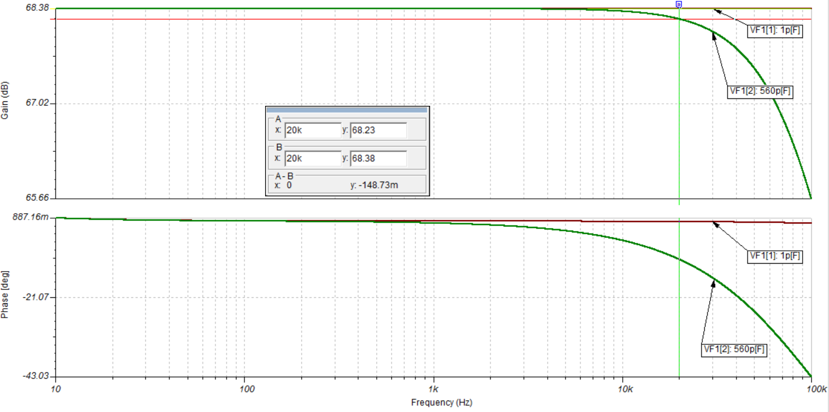

2.7k with 560pf and 1pf

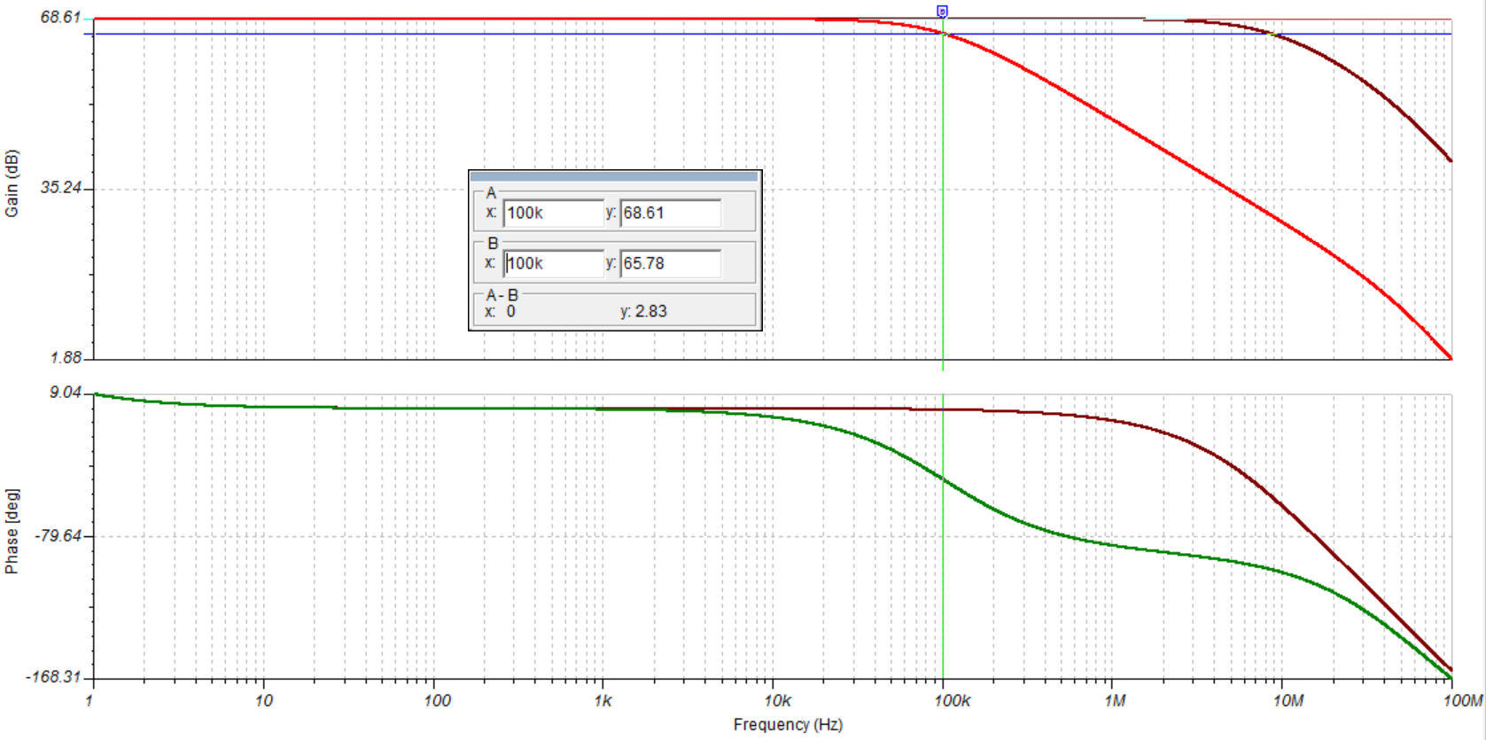

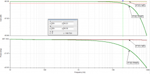

Actually I take it back, maybe this would affect high freqs ...
Thanks Jeff.
I take it
The brown in both graphs is 2.7k no cap
The red in the top graph is 2.7k with 1pf
The green in the lower graph is 2.7k with 560pf
I also noted that your taking the output from pin 6 and not pin 5?
Cheers George

Speaking of sim, all I wanted to show was the basic freq changes. I'm a bit leery of trying to connect even something that seems so basic as higher roll off = more highs :usd:
If this was basic filters maybe .... but this is a wacked out IV 😱
Again, I don't understand enough about the common base configuration to know if the cap is required ...

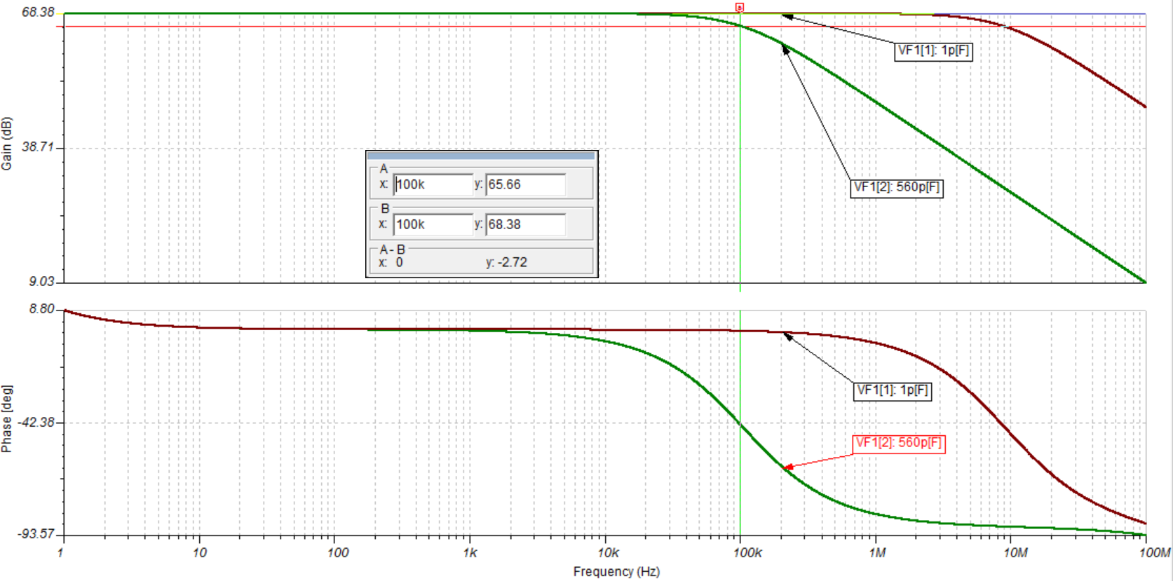

What we do know is at least what the sim is telling us:
A lot more hi freq gets to the next stage with no cap ...
And there is some change to audio freq (I'll zoom in for you)
Seems minimal but you should know whats going on ...
Thanks for all this work Jeff, judging by all these sim's it's good with or without the cap, up to the individual what he like the sound of.
But I can't believe I'm hearing a few degrees of phase shift from 5khz to 20khz. It's one of those mysteries of audio where a 1st order HF roll off filter at 100khz sounds for some reason a tad brighter than no filter?
Cheers George

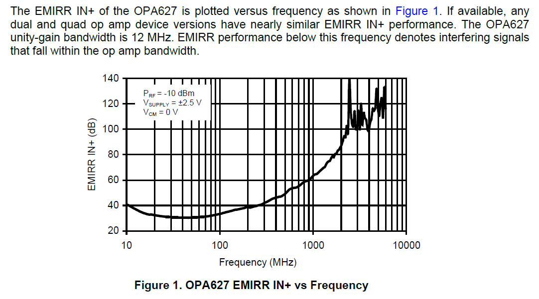

What this means for us is that you get copies of high freq Mhz stuff all over the place and some can mix down quite far when (f1-f2) is large and the multiplier is large (20x) and the copies are ... loud. What this subjectively sounds like is more difficult ...

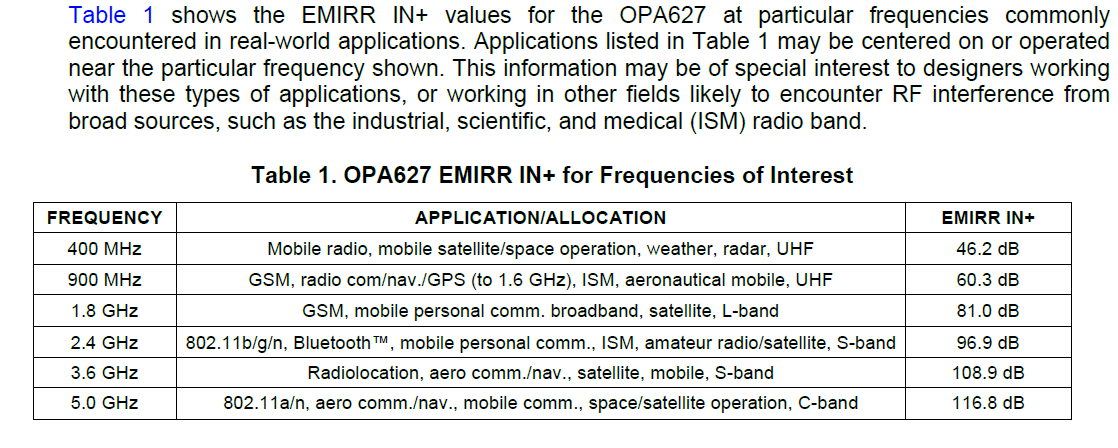

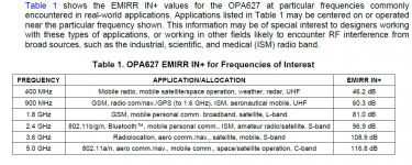

Here are a few danger freqs of interest:
http://www.diyaudio.com/forums/anal...-phono-preamp-open-project-5.html#post3357184
So you can see why RF and EMI is so nasty and PMA keeps harping on about it.

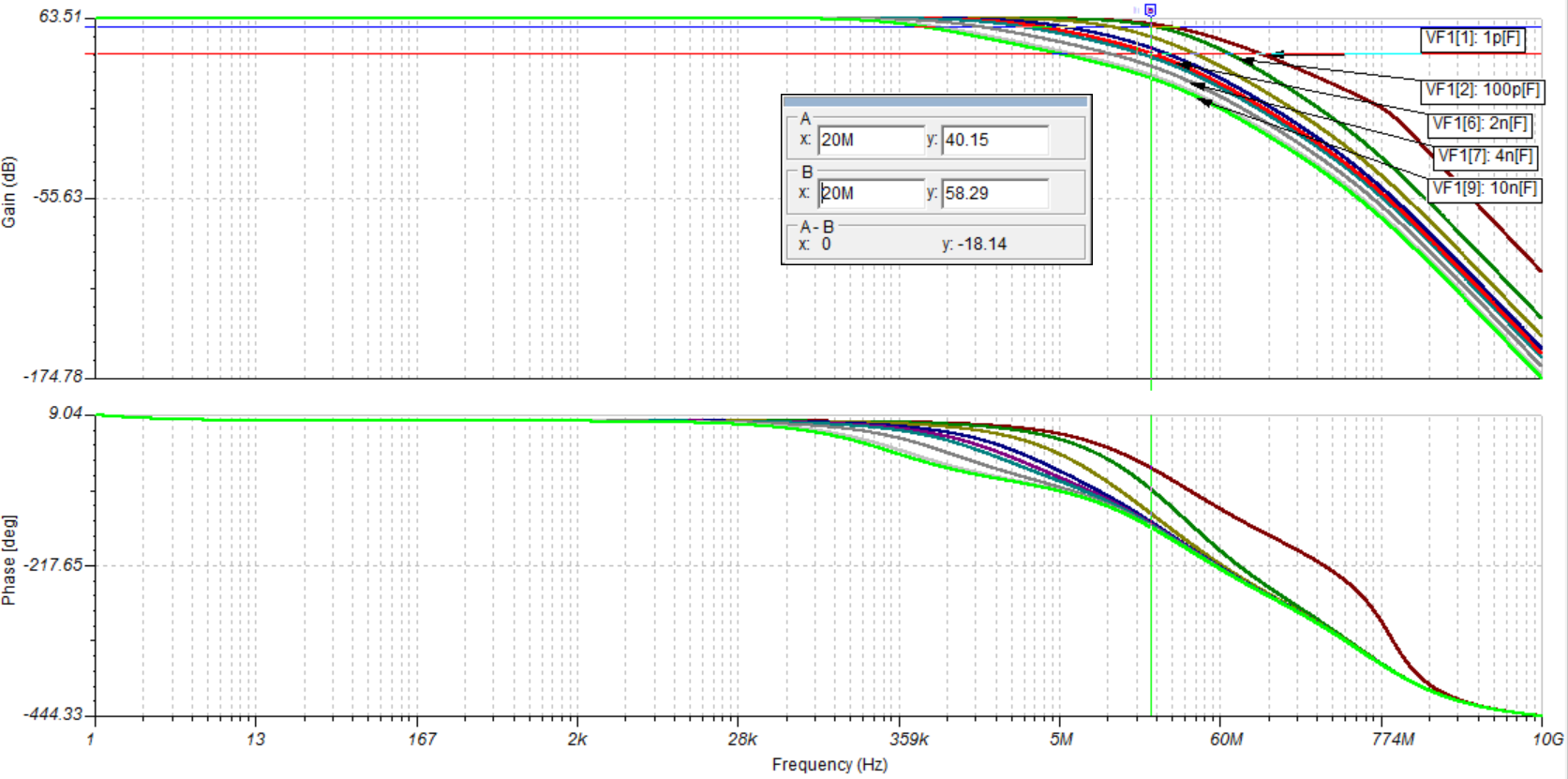

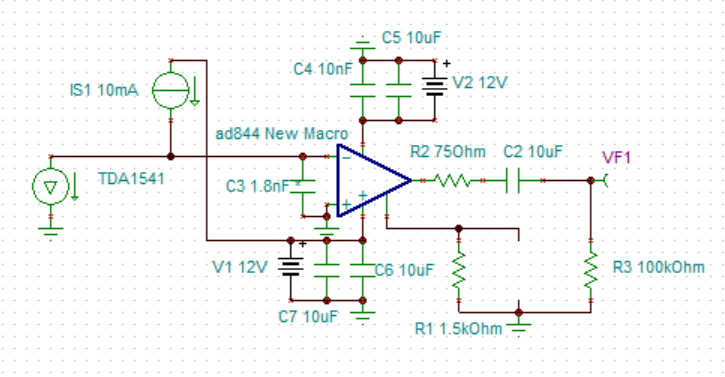

Which brings me to the difference between your 1704 circuit and the 1541 circuit.
It has a sort of input filter cap (only):

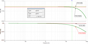

Which shaves off some RF and lots of EMI before it even gets to the 844 let alone your 3rd order filter!
We'd have to figure out a good value for your circuit.
Here's why your 3rd order filter may have trouble with RF/EMI:
... and things get even stranger because you've probably got multiple feedbacks going back to both the pos and neg inputs ...
c o m p l e x :usd:
Remember the previous chart, sources at .4, .9, 1.8, 2.4, 3.6 and 5GHz

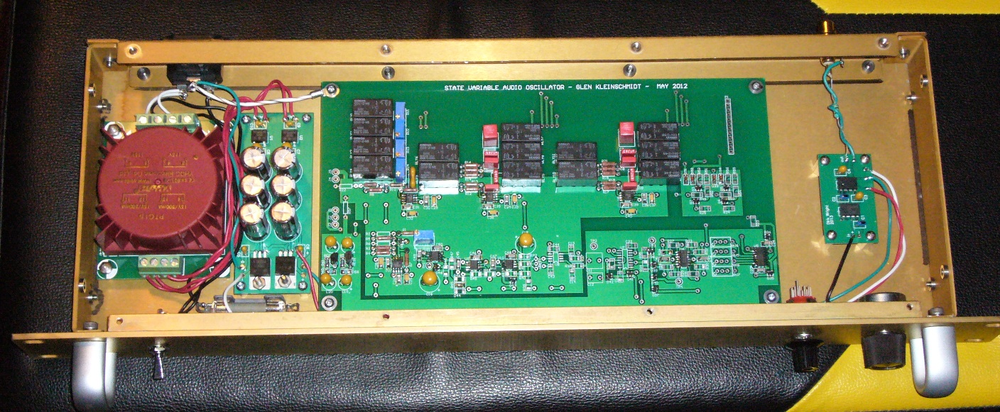

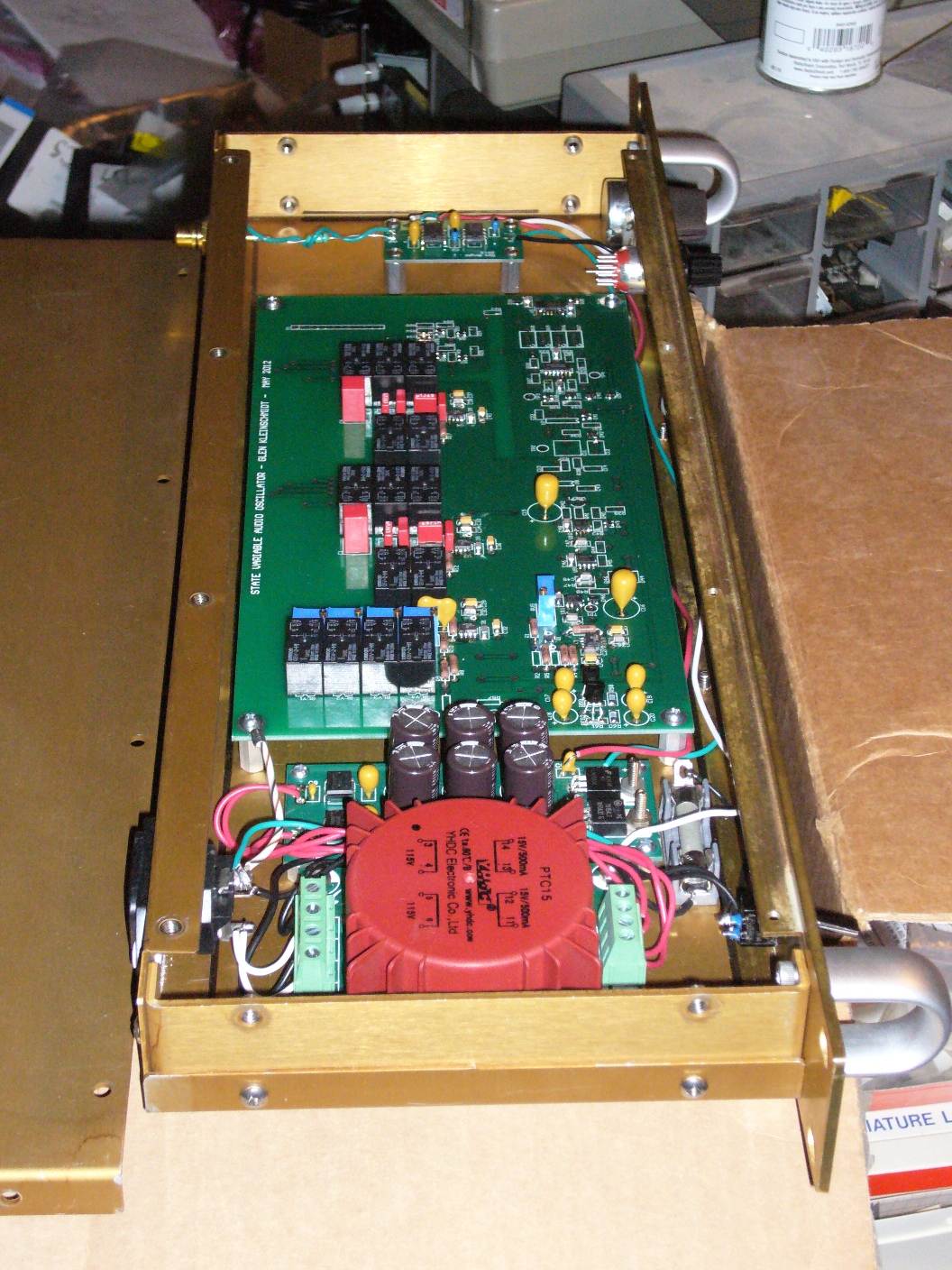

Yet another reason to put your gear inside of RFI resistant metal boxes. Most of those "pretty" boxes they sell to hobbyists do not shield RF because they are anodized aluminum. Here's what a more professional RFI resistant box looks like. This is from Par-Metal (I am only a satisfied customer) and contains a SV oscillator (not quite finished yet).
Par-Metal
