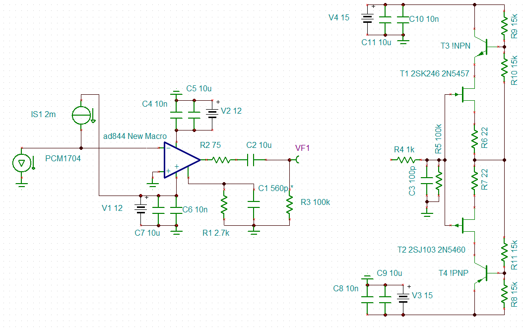

Hmm, TINA doesn't have the 2SK246 or 2SJ103 FETs
2SK246 Semiconductor (Transistor, diode, IC) Cross reference
Lists 2N5457, 2SK330 as replacements for the 246 and 2N5460, 2N5463, 2SJ105 as replacements for the 103
TINA does have the 2N5457 (for the K246) and 2N5460 (for the J103)

If you can find the Spice model for those transistors, it's easy to create a macro for them. Let me know and I can help.
TINA has no 2SC2240
Replacements: 2SC2362, 2SC2389, 2SC2459, 2SC2631...32
BFR86 2N2509
TINA has none of these 🙁
TINA has no 2SA970
Replacments: 2SA1038, 2SA1049, 2SA1123, 2SA1136
2SB789 KT632B
Other replacements for the 2SC2240 NPN and 2SA970 PNP?

Dear sir, where did you find these fine models? 🙂 Teach a man to fish and all ...
Extensive Google searching. A lot of them are right here on DIYAudio, but buried deep...
That will improve matters for the signal cables I agree, assuming you're using 360 degree termination at the shell of the XLRs. However a chain is only as strong as its weakest link - what kind of cable are you using for mains supply? I see no mains inlet filtering.
I checked the output from the regulators I am using and there is no line noise that I can see. There's just a tiny amount of clean residual on the outputs. So, no special cable is required in my application.

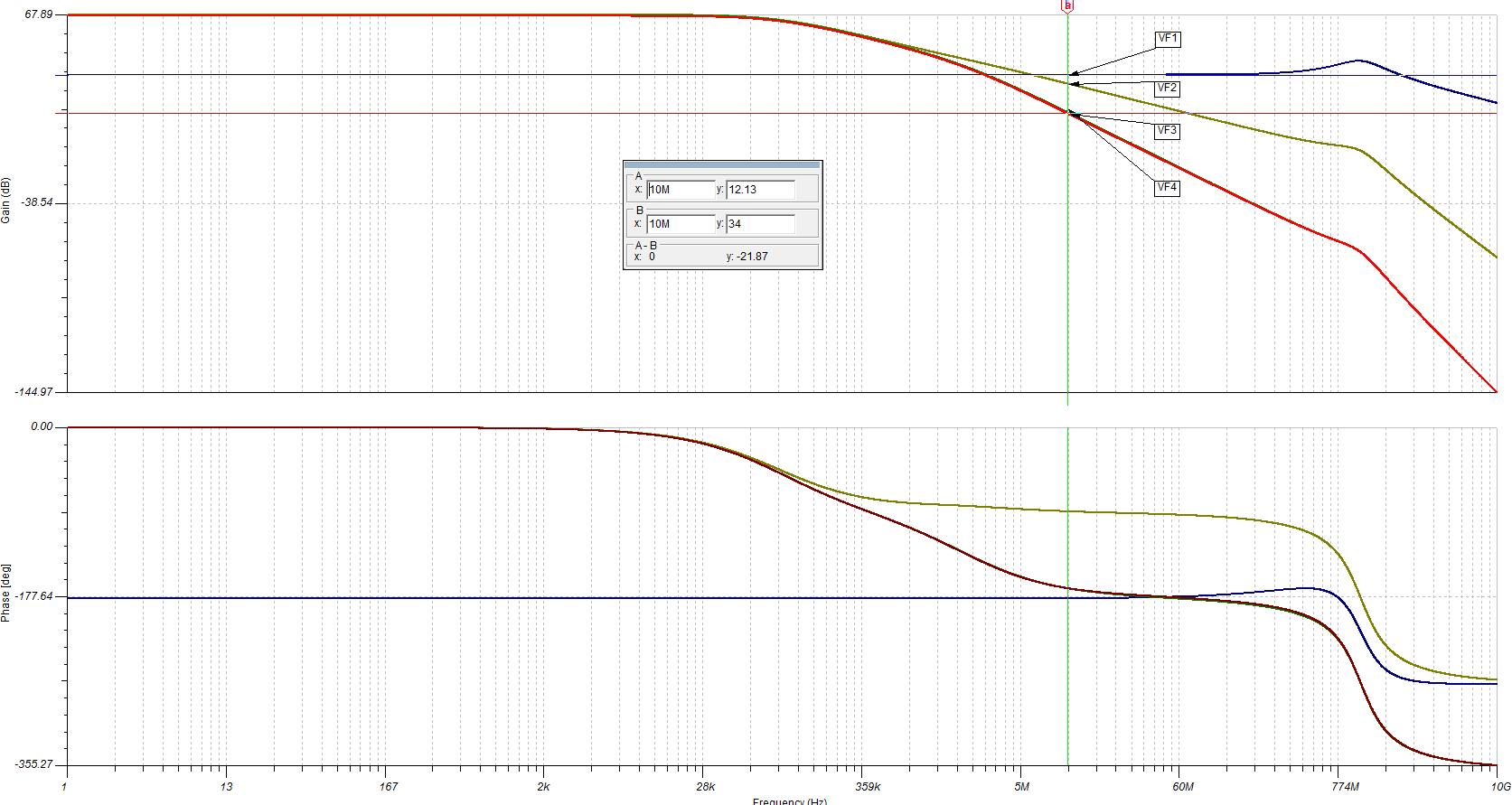

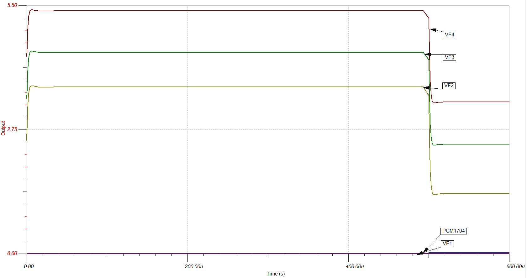

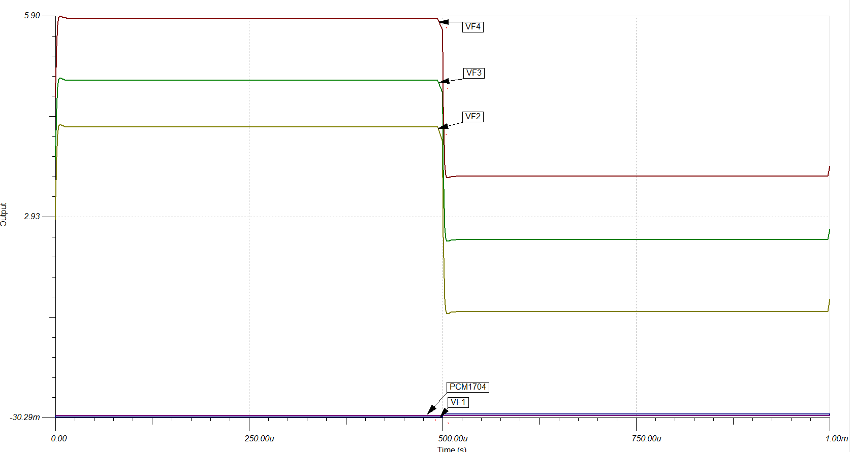

Ok, imported the transistor files and added a few more test points
1: PCM1704
2: AD844 Pin 5
3: buf in (sort of, to see the roll-off of the buffer input filter)
4: buf out

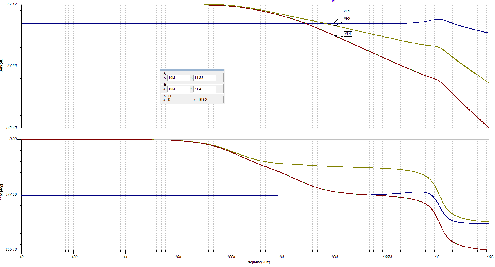

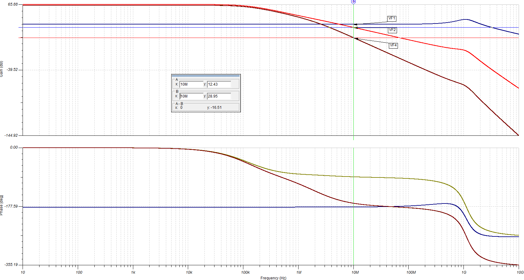

And here's what you get to 10GHz
And here's an audio friendly 10 to 10MHz
And here's a 1kHz square wave, 0.6mA pk, 1ns rise time
Hmmm ... note different 'dc' levels ...

I was hoping you knew some magic site ...

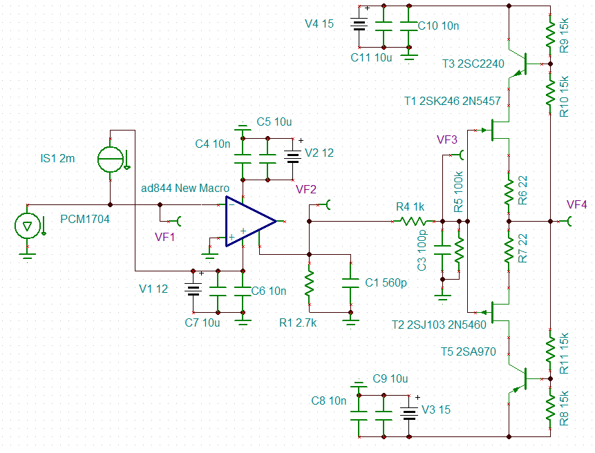

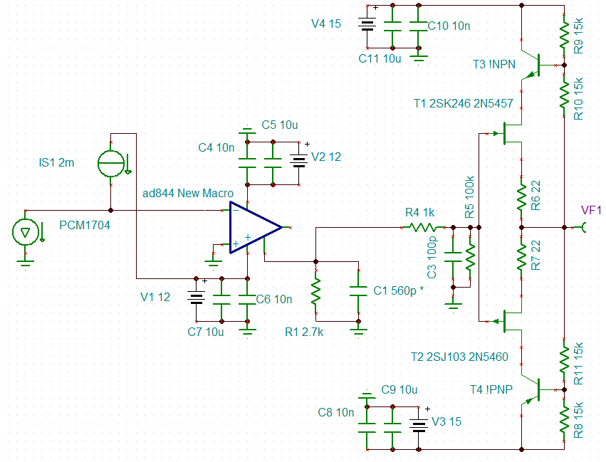

Would imported spice models of 2SK246 and 2SJ103 FETs be more accurate than the "equivalent" FET models (2N5457 for the K246 and 2N5460 for the J103) in TINA that I'm using now?
Jeff
Jeff
I don't know, but it's worth a try. The included models have a bunch of parameters that you can compare with the .lib file you get on those transistors. I don't know what a lot of it means....
You can also grab all of Bob Cordell's models as well. Maybe there's something useful in there.
There are some things in Tina that I've never figured out how to use. The digital storage scope, for example. It confuses me and the help menu is poor as far as I can see.
Come see what I caught! First time fishing and I caught 4 big, fat JFET spice models!
They were T H I S big, I swear!
Hi Giovanni,
J-fet models as per your request...I would use 2SK170/2SJ74 cascoded by 2SK246/2SJ103(Erno Borbely style)...and use low Cob transistors instead BD139/140 (like BF472/473 or better)
.model 2SK246 NJF(Beta=1.07m Rs=56.76 Rd=56.76 Betatce=-.5 Lambda=2.8m Vto=-2.638 Vtotc=-2.5m Cgd=10.38p M=.4373 Pb=.3905 Fc=.5 Cgs=6.043p Isr=112.8p Nr=2 Is=11.28p N=1 Xti=3 Alpha=10u Vk=100 Kf=1E-18 Af=1)
.model 2SJ103 PJF(Beta=2.197m Rs=76.76 Rd=76.76 Betatce=-.5 Lambda=735.3u Vto=-2.037 Vtotc=-2.5m Cgd=18.95p M=.5045 Pb=.3905 Fc=.5 Cgs=17.02p Isr=38.48f Nr=2 Is=3.848f N=1 Xti=3 Alpha=10u Vk=100 Kf=1E-18 Af=1)
.model 2SJ74 PJF(Beta=92.12m Rs=7.748 Rd=7.748 Betatce=-.5 Lambda=4.464m Vto=-.5428 Vtotc=-2.5m Cgd=85.67p M=.3246 Pb=.3905 Fc=.5 Cgs=78.27p Isr=129.8p Nr=2 Is=12.98p N=1 Xti=3 Alpha=10u Vk=100 Kf=26.64E-18 Af=1)
.model 2SK170 NJF(Beta=59.86m Rs=4.151 Rd=4.151 Betatce=-.5 Lambda=1.923m Vto=-.5024 Vtotc=-2.5m Cgd=20p M=.3805 Pb=.4746 Fc=.5 Cgs=25.48p Isr=84.77p Nr=2 Is=8.477p N=1 Xti=3 Alpha=10u Vk=100 Kf=111.3E-18 Af=1)

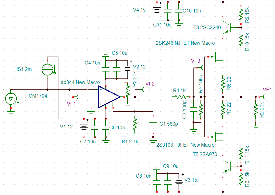

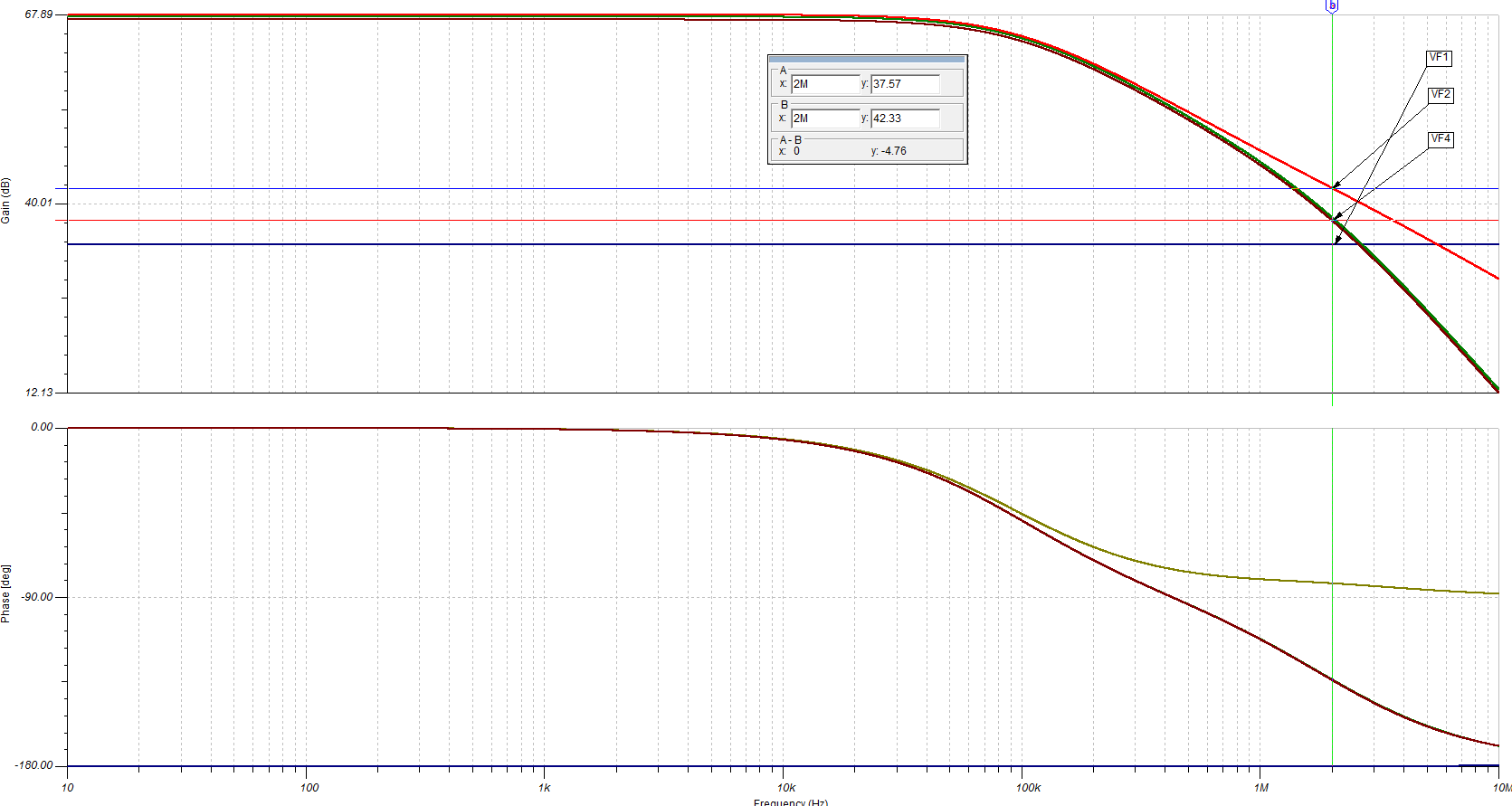

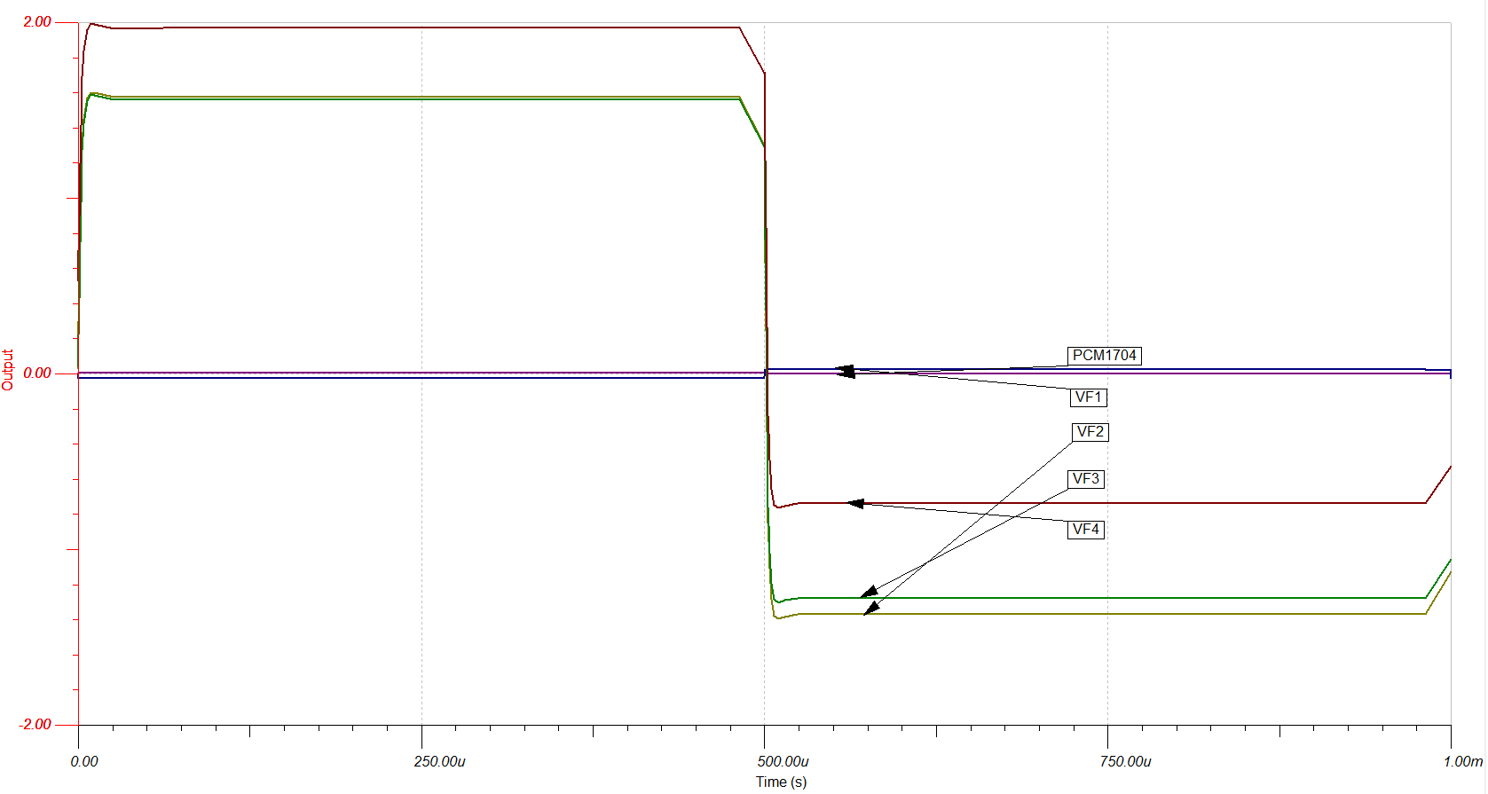

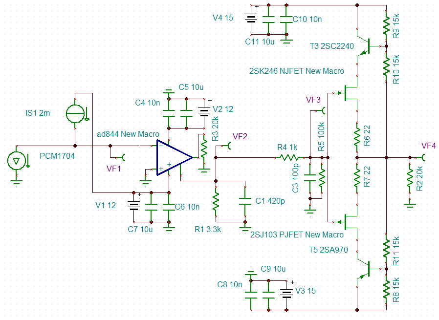

Here's George's updated circuit with the spice models of the real 2SK246 and 2SJ103 FETs rather than 'replacements' that just happen to be in TINA.
(I added 20k load to the ouput of the JFET buffer and also added 20k load to the output pin 6 of the AD844, should pin 6 be loaded in reality too?)

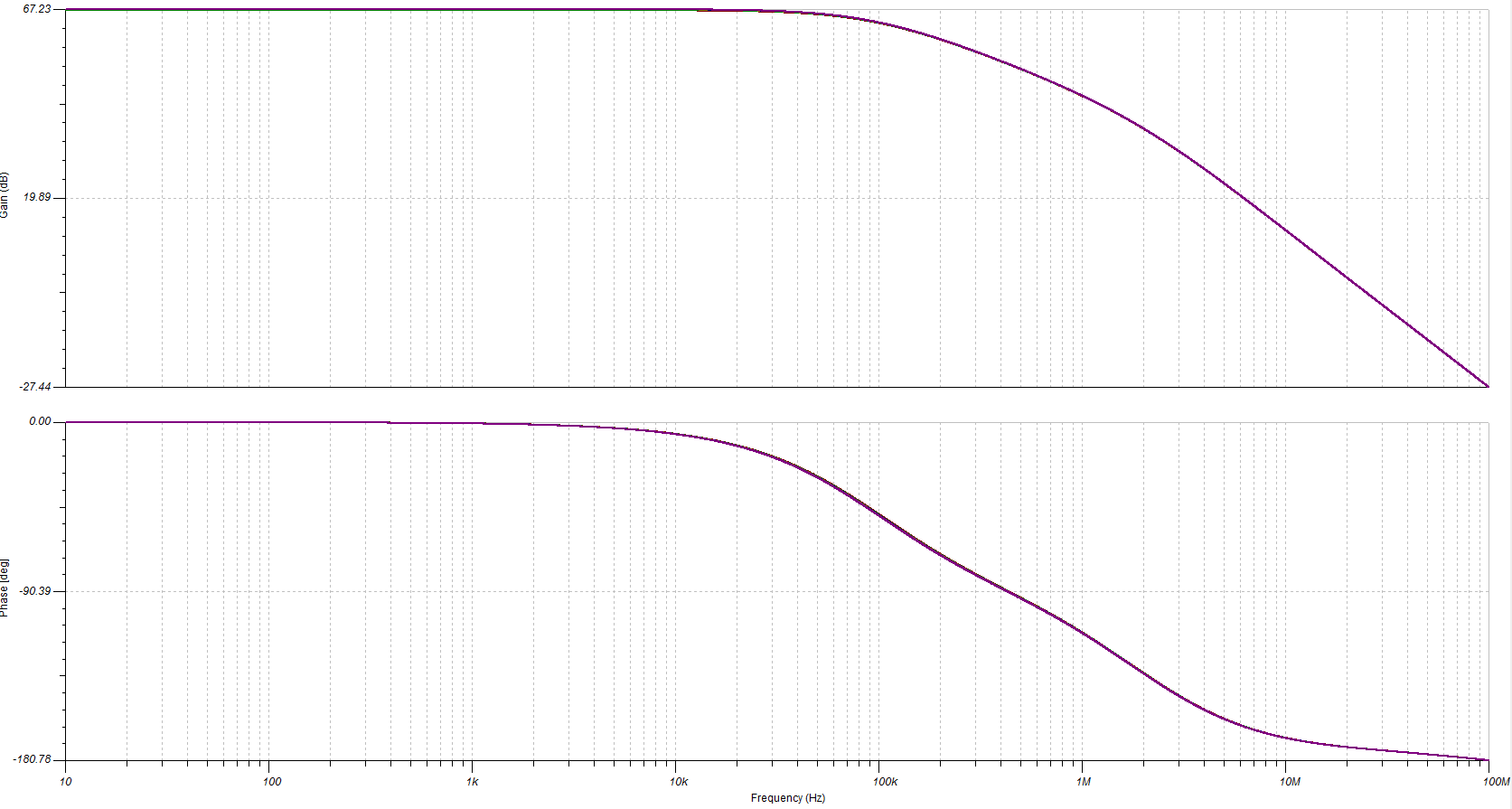

The freq from 10 to 10GHz
And the TINA schematic
View attachment ad844 IV PCM1704 + FET buffer.zip
Cheers my friend!
PS Now if we could just figure out how to do all the fancy sims and tests, we'd really harness the power of TINA!

OK thanks Jeff, while you were tampering with Tina (hope she's a good looker) I was instaling the discrete buffer. It's hard to hold back but I will wait till I listen more over the weekend, but the AD844 holy grail has just shifted to another level.
This discrete buffer was also looked at by John Curl and he liked what he saw and said that it was a good design. I had to change TZ resistor and cap to 3.3kohm and 420pf because I needed a touch more gain from the I/V.
Cheers George
