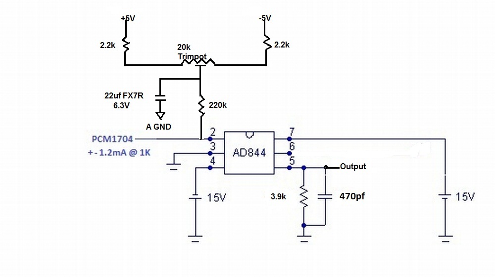

Hmm ... I should add your current source to the sim. It will probably affect the input a little. Any idea where on 20k trim you are (measure)?
A touch to the - for the left from middle, and I would say half way between mid and - for the right, as the right dac had about +30mV dc offset and the left about +10mV from memory.

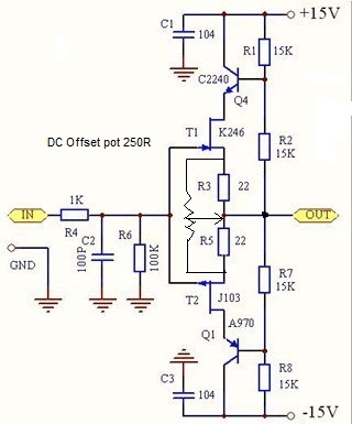

Can anyone say if the output of this buffer (attached) I'm using could handle a muting relay, which shorts to ground for 2 seconds during switch on and switch off.
As the buffer has a 1 volt dc offset on it's output for 1 second during switch off and on, then quickly settles to 1mV
Cheers George
Cheers George
You can use a double relay, and also short to ground the gates of the jfets, to make sure the maximum gate current that is 10ma is never reach. Or If you use 1k6 in R4 is impossible with + - 15Volts sources to reach the maximum gate current.
Thanks Sergio, so what your saying as it is, if the output is shorted to ground even for just 2 seconds during switch on or off it will blow the buffers output?
Cheers George
The gate and source (channel) of a jfet forms a pn-junction like a diode , if the voltage at the gate is higher than 0.6 volts this diode start to conduct , the problem is that this junction is week and only withstand 10mA in the case of 2sj103.
If one connect the source to ground , the gate of the Jfet starts to conduct as long the input is higher than 0.6 volts (n Chanel) or lower than -0.6 volts (p Chanel) ,R4 limits the current.
I don't say that in this particular case it will blow the jfet. But is important to understand this potential damage mechanism . I always like to do things safely 🙂

But at the moment I have just done some more experimentation with the AD844 and it continues to amaze me.
I just put in a 4.7kohm for the TZ resistor to ground but with just 350pf across it to keep the 1st order roll off similar (around 100khz -3db), and yes on the scope I got a good increase in gain again from what the 3.9kohm gave, hardly any exrta noise, and dc offset still below 1mV, and adjusted out to a stable .1mV
So now I have an abundace of gain at TZ from a 1mA p/p output from the PCM1704. I listened to it and I believe it's as good or even better dynamicly and just as smooth maybe smoother.
How high can one go with the TZ resistor before things start to fall appart sonically and the gain stops increasing?
Because here's a thought, this resistor can become a volume control, if the cap can be eliminated and the filter put down stream on the output buffer, or in front of the I/V. I'm ok as I have a digital domain volume that's being used in the top 1/10 of it's full output range.
