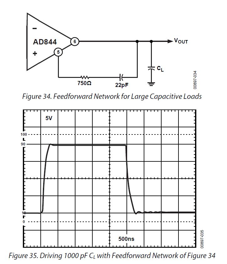

More education if you could guys, looking at the AD844's buffer that can have feedforward around this output buffer from pins 5 to 6 so it can drive high capacitive loads, is it possible to reconfigure the feedforward to become a low pass filter instead of what AD did? Cheers George
" DRIVING LARGE CAPACITIVE LOADS
Capacitive drive capability is 100 pF without an external net-work. With the addition of the network shown in Figure 34, the capacitive drive can be extended to over 10,000 pF, limited by internal power dissipation. With capacitive loads, the output speed becomes a function of the overdriven output current limit. Because this is roughly ±100 mA, under these conditions, the maximum slew rate into a 1000 pF load is ±100 V/μs. Figure 35 shows the transient response of an inverting amplifier (R1 = R2 = 1 kΩ) using the feedforward network shown in Figure 34, driving a load of 1000 pF."
